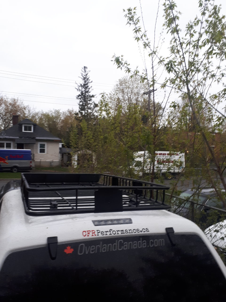

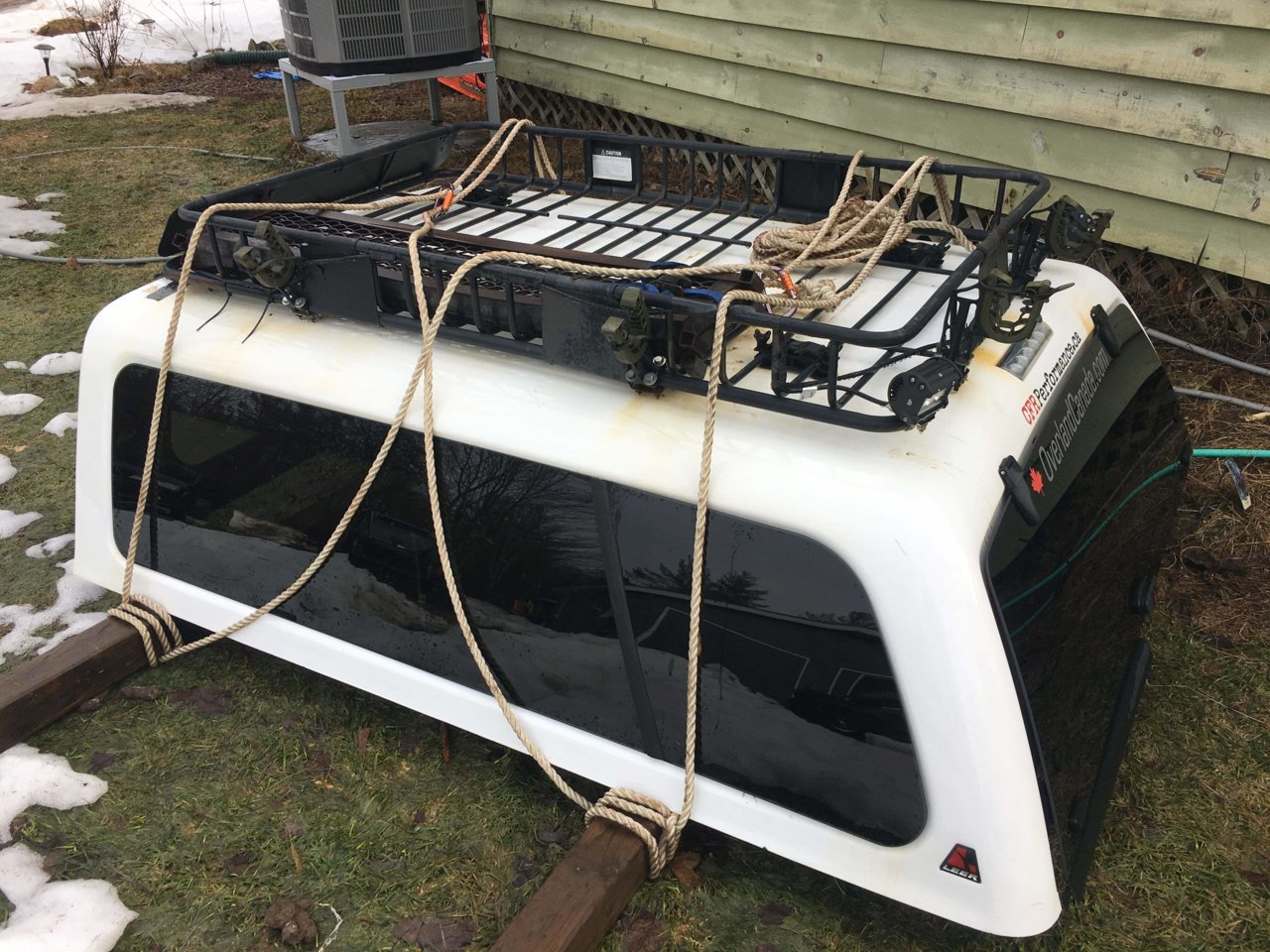

    SO I did a thing this weekend. I drove out to Pembroke and bought a CAP! picked it up for 400$
    It was in pretty damn good shape, new locking mechanism and window seals were replaced last year. The screens were dirty as hell and one was ripped. the bottom trim is broken on the back glass, there was rust marks all over the the cap from the roof rack. there was A LOT of dog hair on the inside and dog slobber on the windows hahahaha
    I took the roof rack off and gave it to my buddy to re powder coat it. I washed the roof and all the rust off as best as I could. I will be re-designing the way the roof rack mounts onto the cap to make it more water tight. the PO didn't do much in regards to keep water out other then a little white silicone. Once I get a few things back from PC and im ready to mount the rack back on I will post up pictures of the new mounting.
    So, aside from cleaning the hell out of it, and getting the roof rack re-powdered, I also replaced both screens. I did order a new trim piece for the back window but it wont be in until probably the end of May. I also got a quote to get it colour matched but wont be done until the end of May
    P.S I can not believe! how damn HEAVY! my tonneau cover is!! god damn, I swear to god it weighs just as much as the cap does!!!
    the tonneau cover will be going up for sale soon enough, im hoping to get enough out of the sale to pay for most of the colour matching paint job.

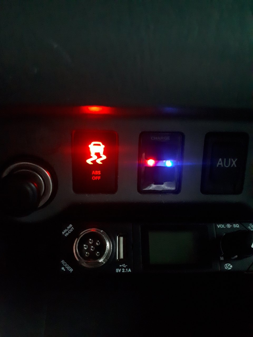

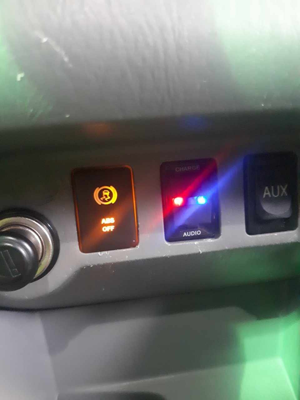

    I changed out the AMBER illuminated ABS kill switch for a RED one to better match the OEM dash lights.
    BEFORE
    AFTER
    I also got my CB mounted in place, its not wired in yet but it's where I want it to be.

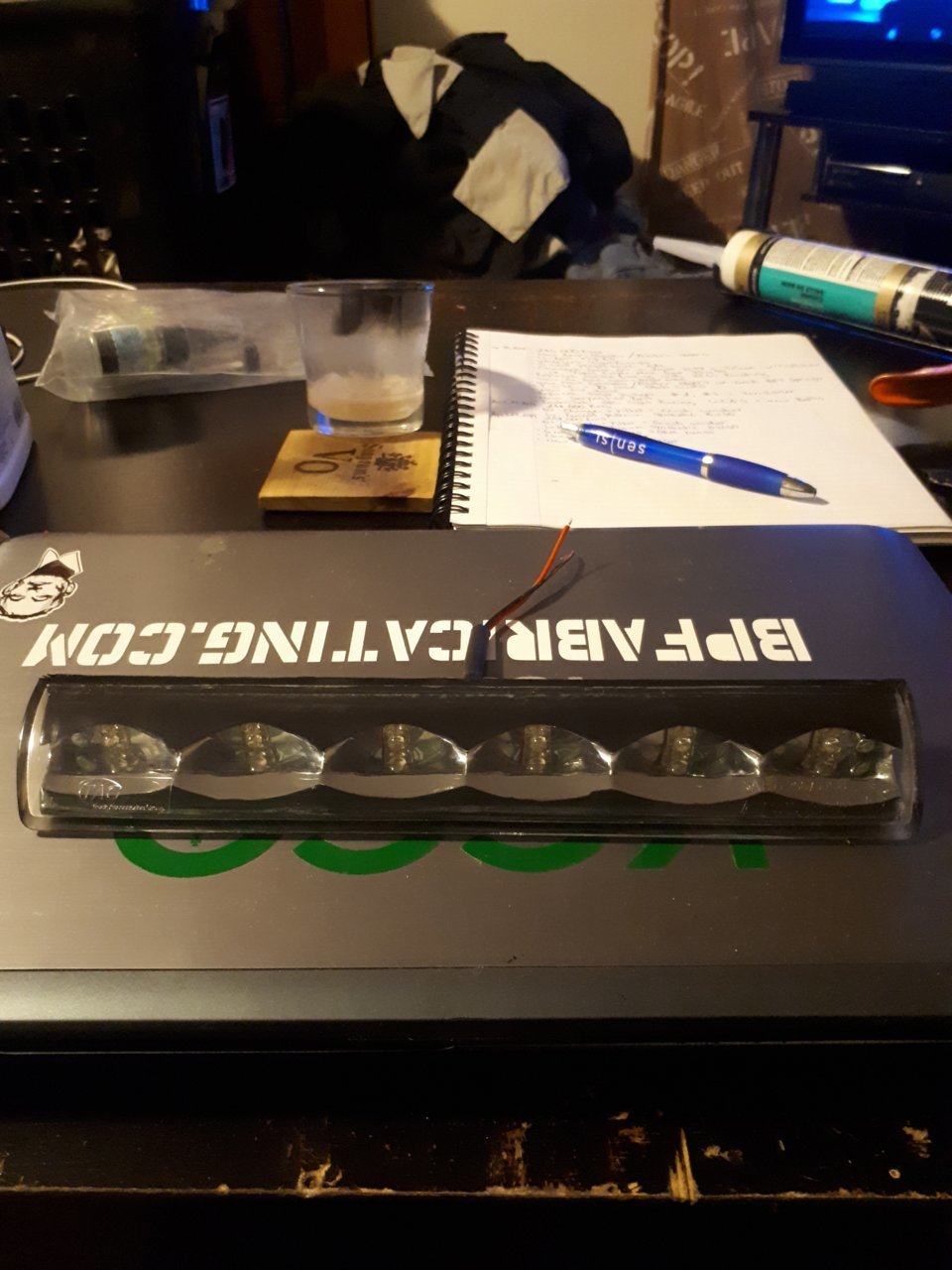

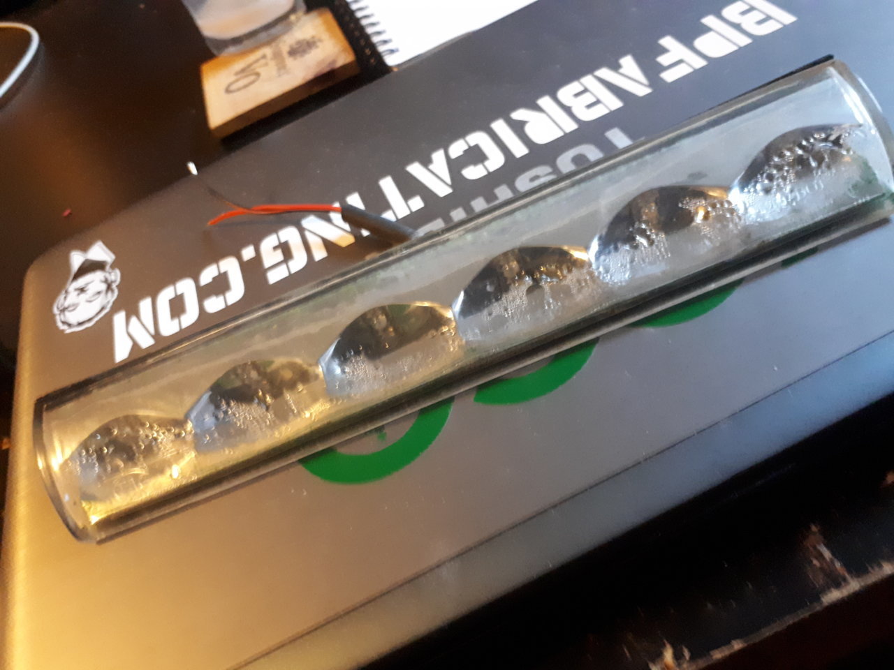

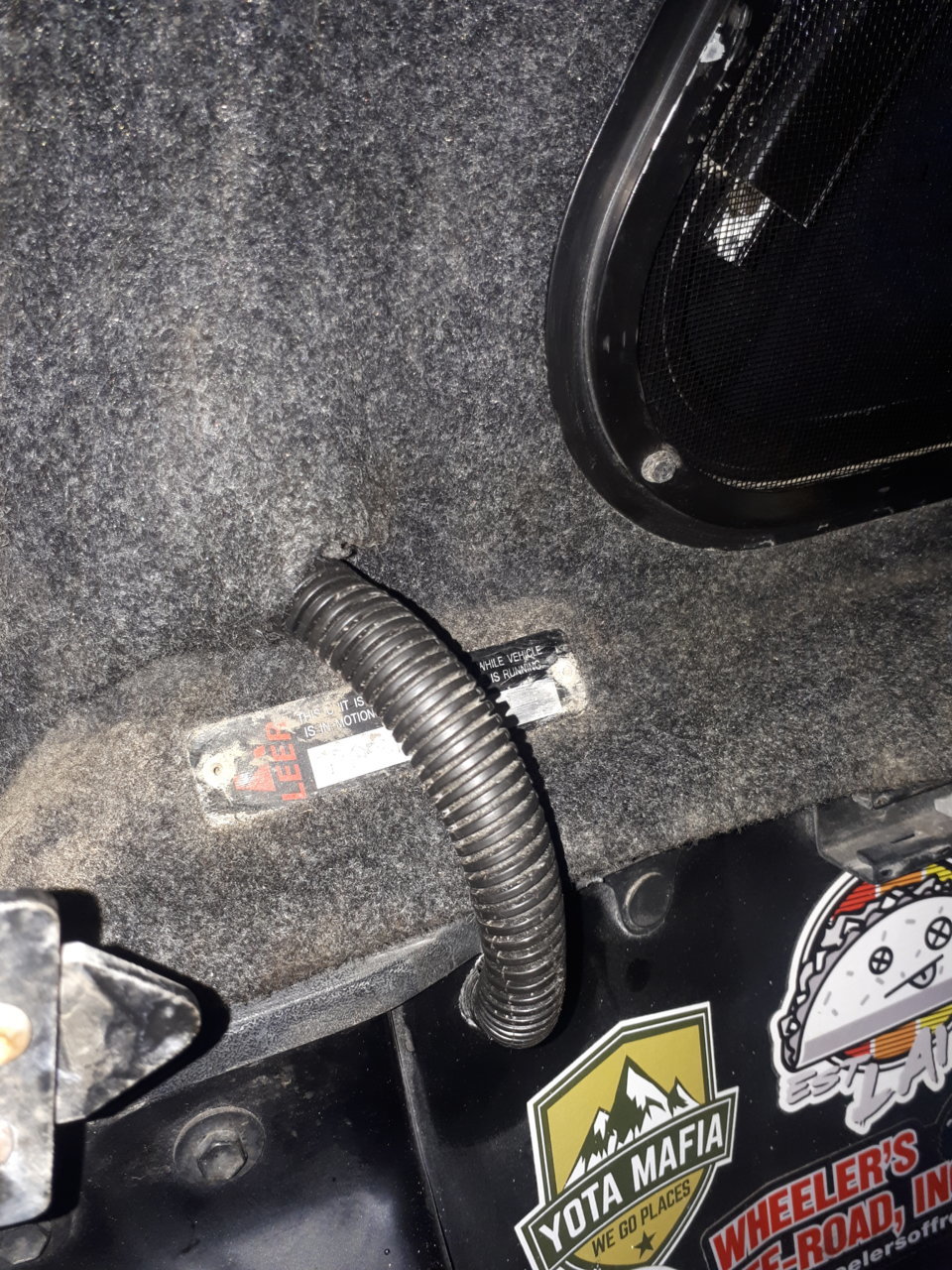

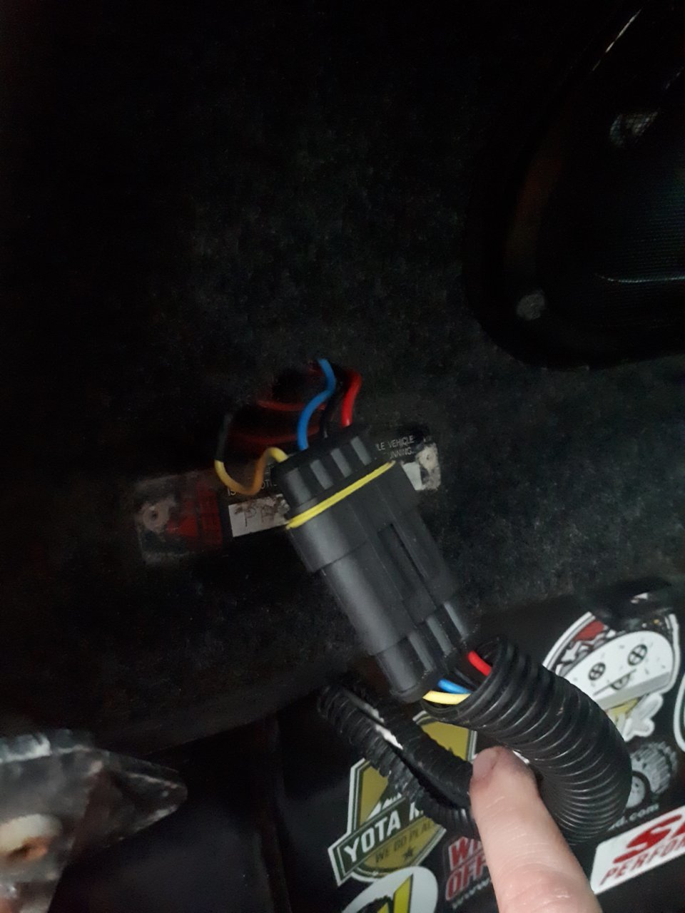

    I got some work done to the cap as well. I replaced the wiring plug thing with some water proof ones I got off Amazon. I wired the third brake light into the brake lights obviously hahaha I wired the dome light into my bed lights, which I like because now it turns on with the remote. I ordered the upgraded LED dome light and I'm waiting for that to come in.

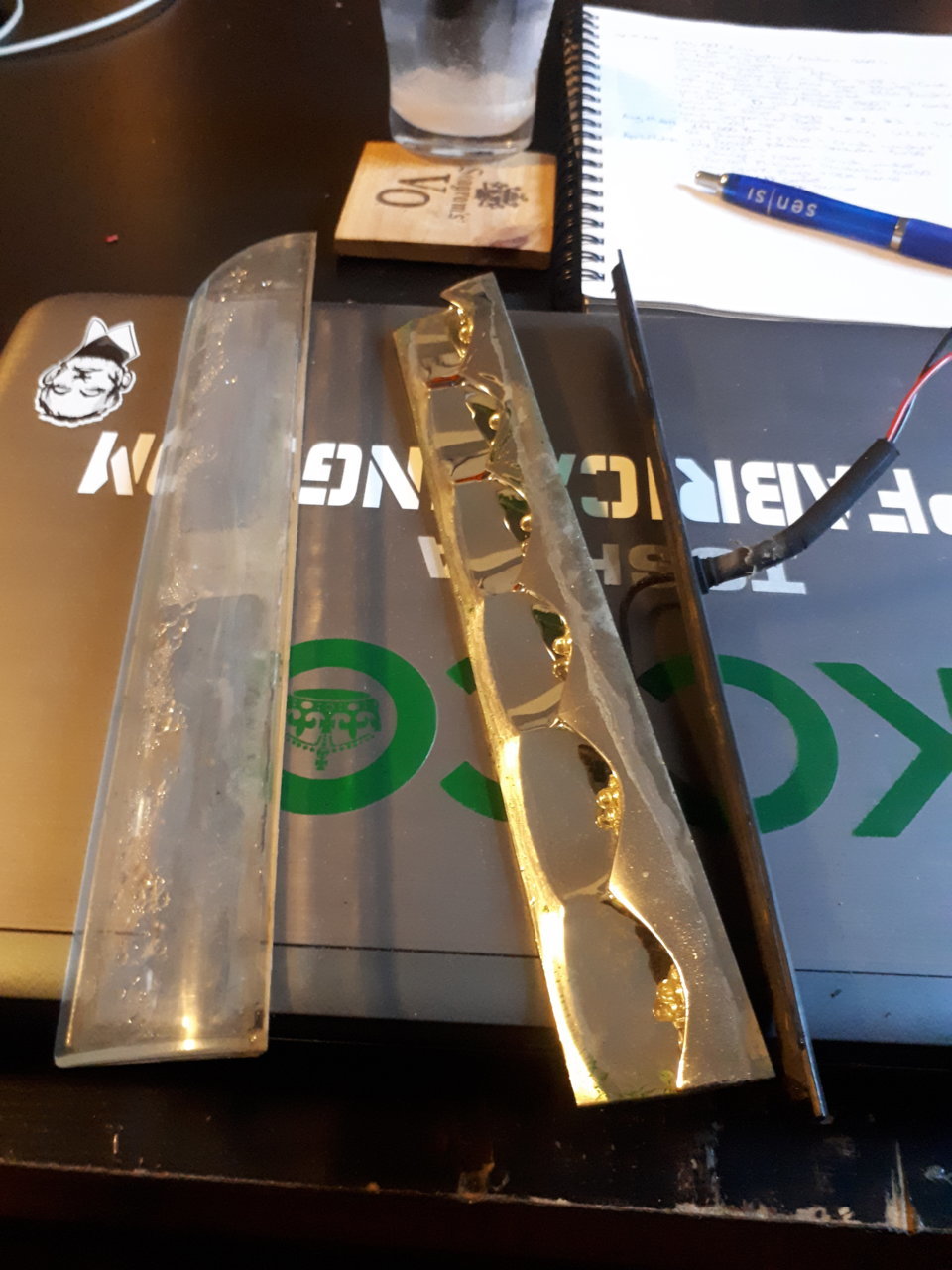

    The condensation was pissing me off in the 3rd brake light. soooo I took it off, tore it apart, cleaned it up, painted part of the chrome bezel black, put it back together, sealed with silicone, used Gorilla double sided tape to mount back on. the rubber the wire passes through was cracked to I shrink wrapped it and RTV silicone the hole the wire passes through on the cap. yeah, the condensation was back the next day hahahaha

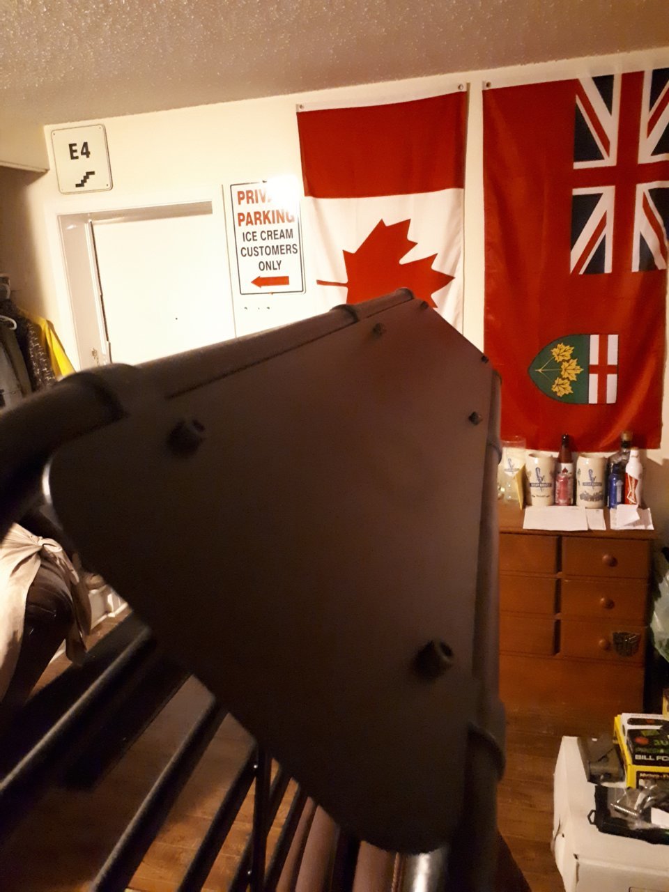

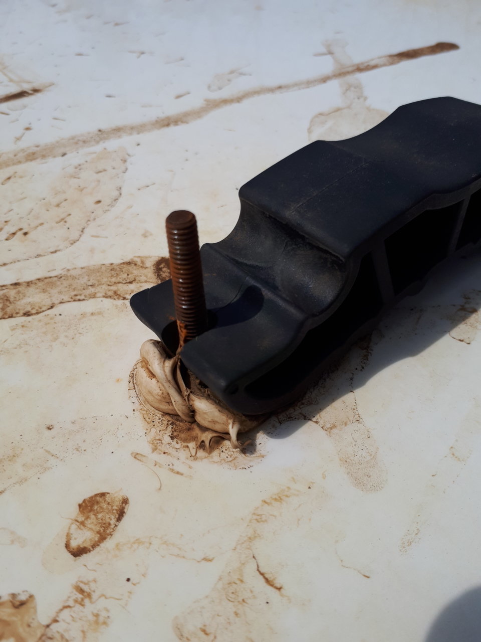

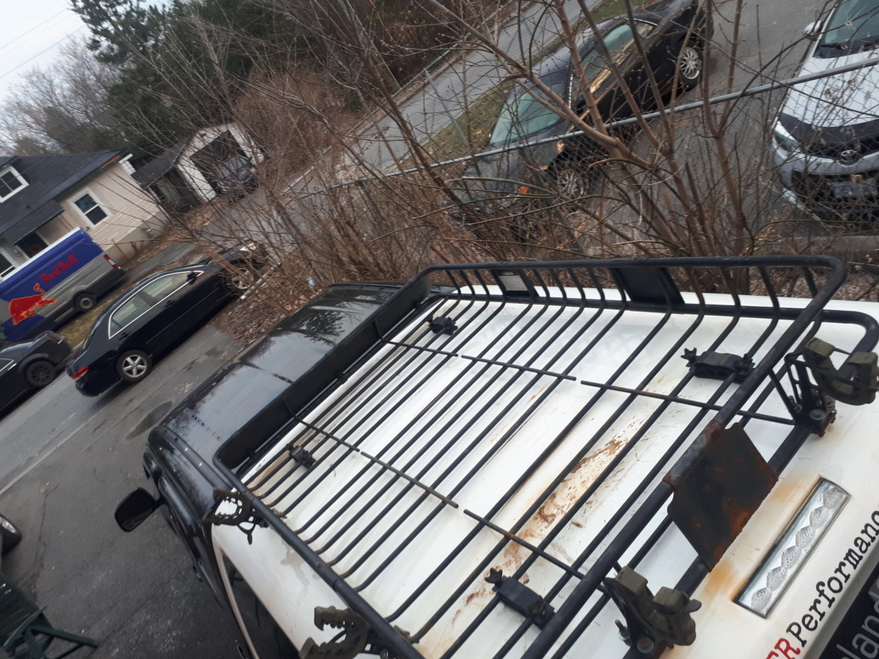

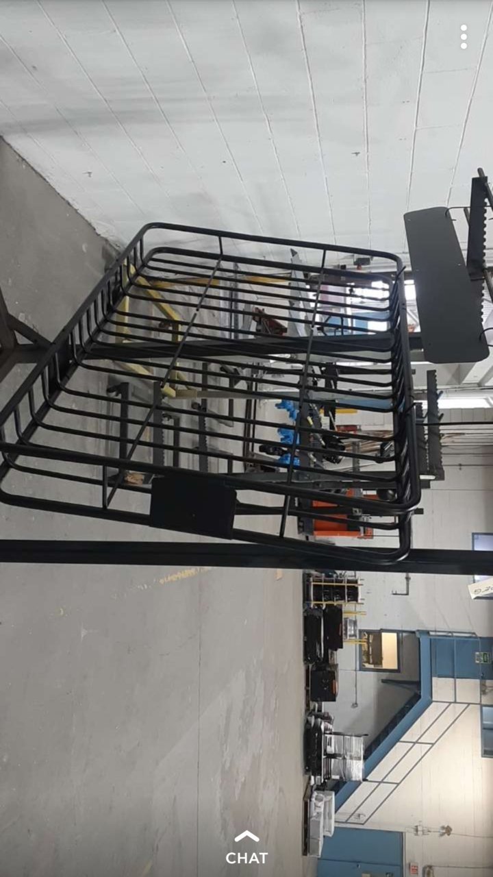

    I got my cap rack back from powder coating which turned out great.
    I took it apart into the 3 pieces, I dumped out all the loose rust! I sprayed some fluid film into all the tubes as best I could before putting it back together. I replaced all the rusted hardware with some black machine screws.

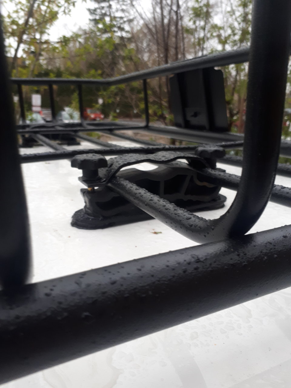

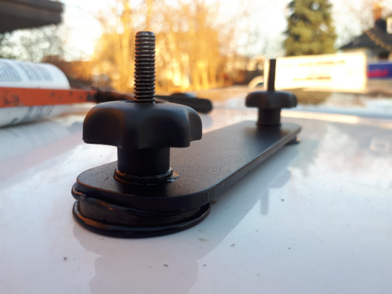

    soooo I didn't like the way it was mounted to the roof, I felt like water could get in pretty easily.
    I made some aluminum brackets for the racks mounting system to sit on and put some 1/4 thick rubber washers underneath and RTV silicones everything.

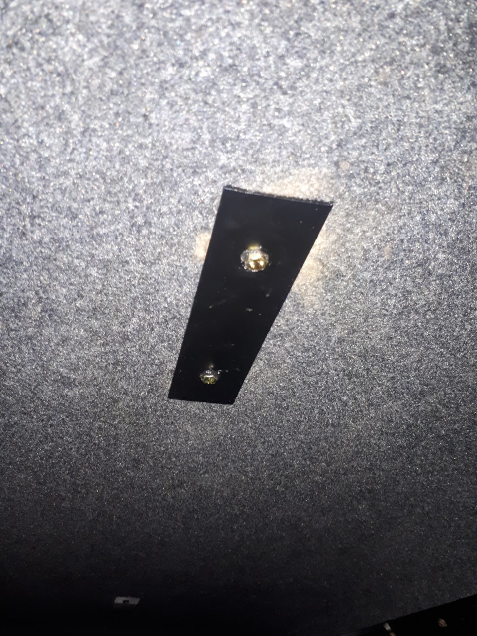

    on the inside of the cap the PO has stacked washers inside and they were all rusted and looked like crap, so I took some steel flat stock and made some brackets.
    BEFORE
    AFTER

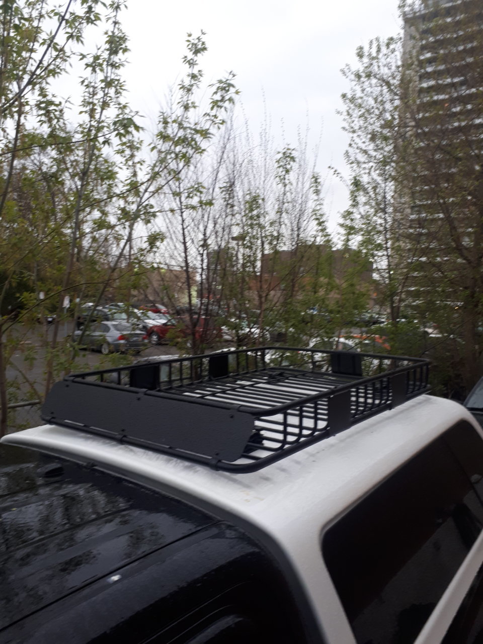

    Then I got it all mounted back up
    BEFORE
    AFTER
