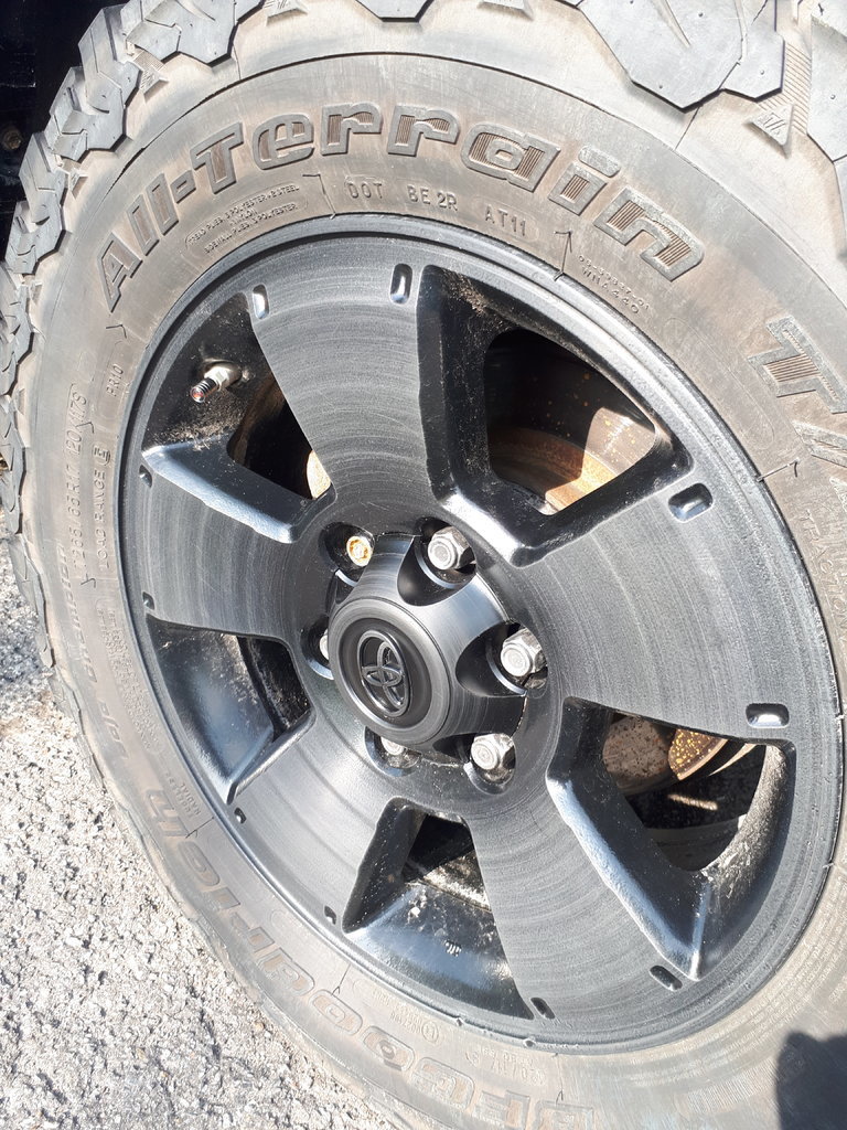

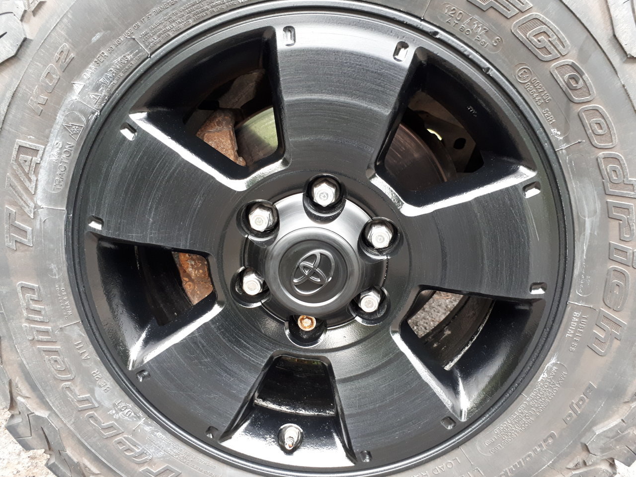

    Bummer about the rim, maybe try a drill with polishing ball?
    Justanotherhemi and Kemosabe like this.

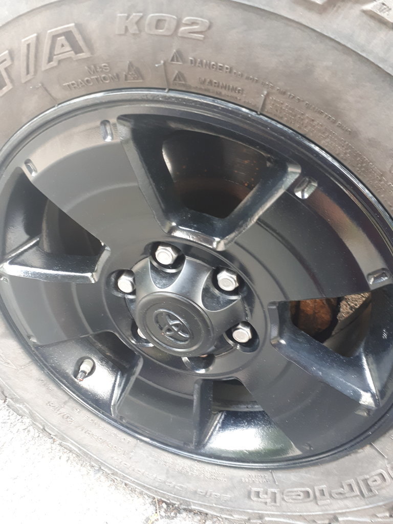

    I think you did a great job on the rims. Have you thought putting paint over the powdercoat? After the winter you could give them a good was and paint all 4. The pc will still protect from chips and you'll be good to refresh them with a thin coat of paint every now and then?

    thanks man haha never thought of it to be honest, but not sure I would want too. I never have much luck when it comes to painting haha not sure how well it would stick to the pc

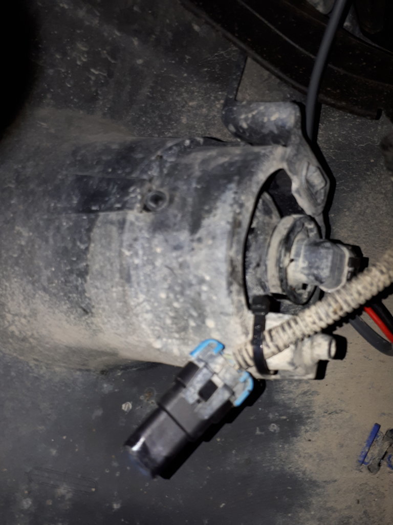

    alright so. a while back I purchased a custom wiring harness so I could do the Ultimate Fog Light Upgrade
    https://www.tacomaworld.com/threads...-upgrade-not-led-or-hid.435419/#post-12592662
    I had everything I needed so I went ahead and ran the wiring harness where I wanted it. I went to hook everything up and realised my fog light bulbs were actually 9005 bulbs and not the H11 hahaha so I have been holding off doing anything until recently.
    a couple days ago I pulled the wiring harness out, bought some 9005 connectors. took the molex pins out of the connectors and hooked them up to the harness. I always forget to take pictures while I'm doing something so I do apologize haha. I spoke with crashnburn80 and he pointed me in the direction of some good bulbs compatible for my application. I ordered them and am waiting for them to come in the mail.
    http://www.rallylights.com/vosla-9011-hir1-9005-65w-halogen-infrared-bulb.html
    once I have the bulbs installed I will post some good before and after pictures so stay tuned!

    did my oil change today with Penzoil Platinum Synthetic 5w30 w/ new filter and crush washer.
    I also finished up the wiring harness for my fog light upgrade. currently running the stock bulbs with the upgraded wiring harness. I'm waiting for the new bulbs to arrive.

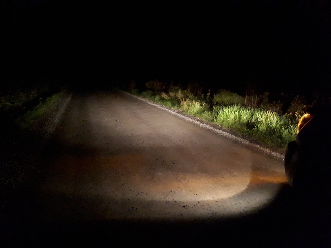

    Here is a photo of the completely stock set up.
    I do not have a similar picture with the upgraded wiring harness w/ stock bulbs but I will get one this weekend when I'm in a similarly dark location and update it here:
    One thing I did do a little different.
    I did not want my OEM fog light connector just sitting there to collect full of dirt and grime so I purchased an extra male connector, pulled the wires out, filled the holes with silicone and plugged it onto the oem connector.

    now here is the million dollar question. after I installed the harness and got everything back up and running, I turned on my fog lights and noticed they are aimed differently from one another, but I am unsure of which one is correct and which one needs to be adjusted. If any of you fine folks know which one needs to be adjusted, feel free to let me know. in the mean time, the searching begins.
    In the pictures below, my truck is parked about 6 feet away from the concrete curb you will see in the picture. my passenger side fog light is aimed to shine further away from the truck then the drivers side.
    Drivers Side
    Passenger Side

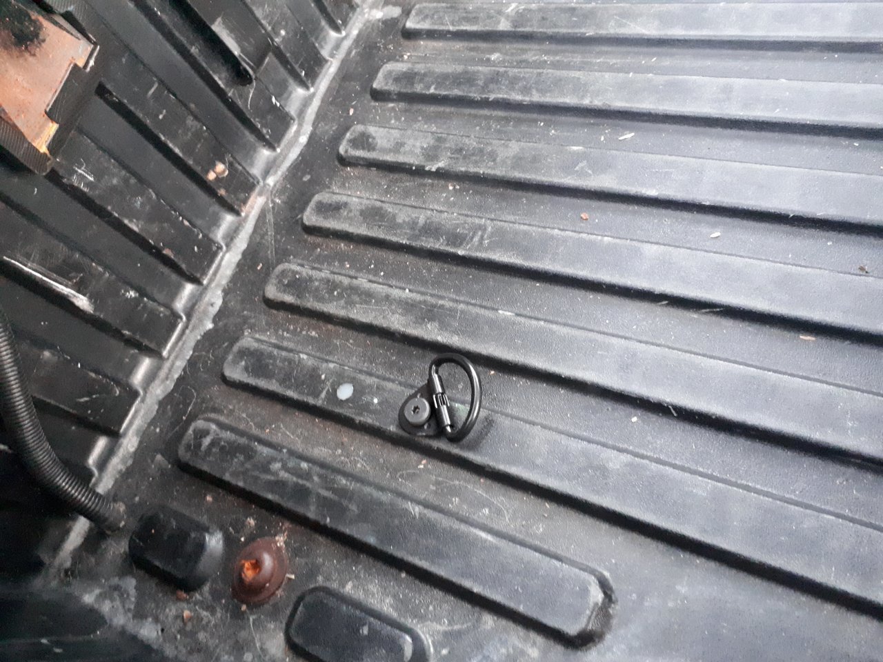

    oh and I installed some extra OEM Bed Tie Downs near the cab. The bottom support was too wide to fit into the grooved portion of the bed but, nothing a grinder couldn't fix lol
    and don't mind the hole with silicone in it :anonymous:
