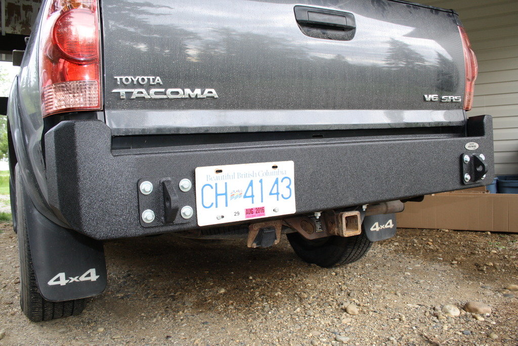

    Due to all of the mixed messages on this thread I thought I'd throw in my two cents. My stock rear bumper was badly dented and rusting in several spots so I purchased and installed the Body Armour. I personally found the instructions adequate although I did struggle with getting the stock one off as all of the bolts had 9 years of salty winter roads worth of rust built up on the threads. All of the holes lined up and I was able to adjust the bumper to fit with everything looking balanced on each side to within 1/8". Contrary to what someone on here said, it is not necessary to remove the two bolts on either side of the factory receiver hitch. I accidentally did... but as the instructions state, there are only 10 mounting bolts that need to be removed/replaced. The rest are minor fasteners for the stock bumper skin. I'll be installing some LED license plate bolts in a few weeks when they arrive in the mail. In time I may also replace the 8 exposed bolts and washers with stainless if the included ones begin to rust up. Overall considering this bumper cost about 1/3 of what my next best option would have been I have to say I am very satisfied.

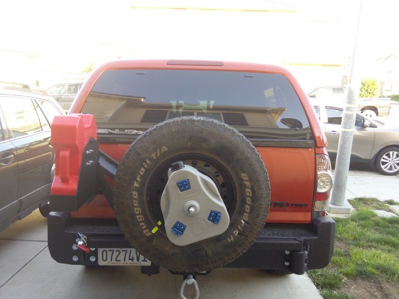

    Running the tire swing out does not put the spare tire up to high. Probably 6-7 inches above the top of the trail gate. See attached pic to get an idea.

    Yeah, Im running 33s though on stock TRD wheels and I have a very tight window (approx 12in) or I will rub the under part of the RTT. I was hoping that maybe someone with this setup would be able to measure and give real world measurements. Thank you though gilpin!

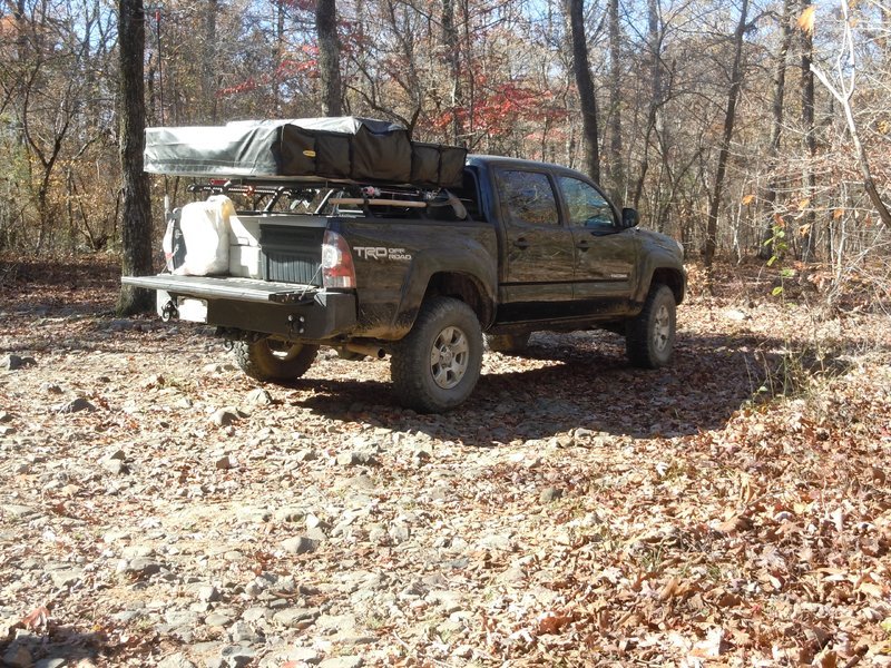

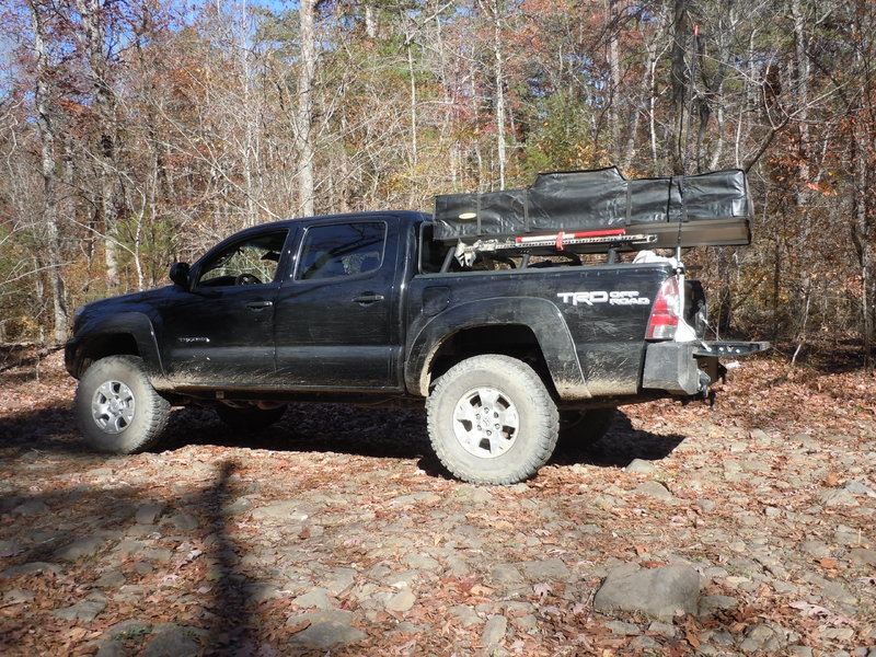

    Well, I finally got my bumper installed and looks great no issues whatsoever. For a cheap replacement bumper I would highly recommend this one (less than $400 to the door). In my case I had a hit and run driver and the insurance replaced it for free. You can tell the weight difference as it is very heavy and well built and its even a little bumpy driving down the road, so keep that in mind if you are running a stock rear suspension. (I am not and still noticed it)

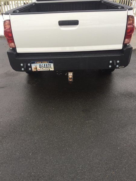

    IMG_4180.jpgInstalled a few days ago by a body shop that was painting driver side bed from being " keyed" 5 years ago .Fits fine. !
