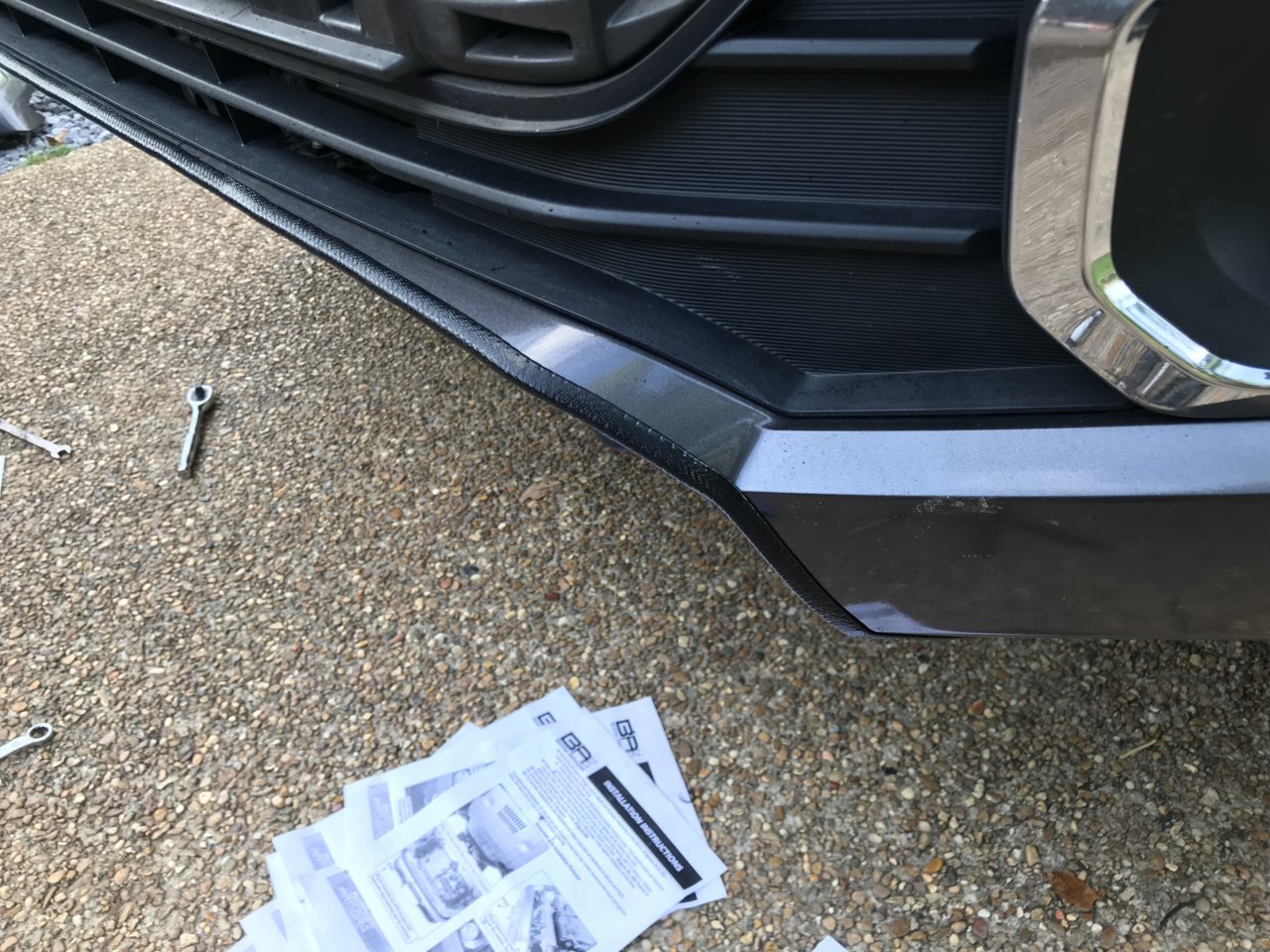

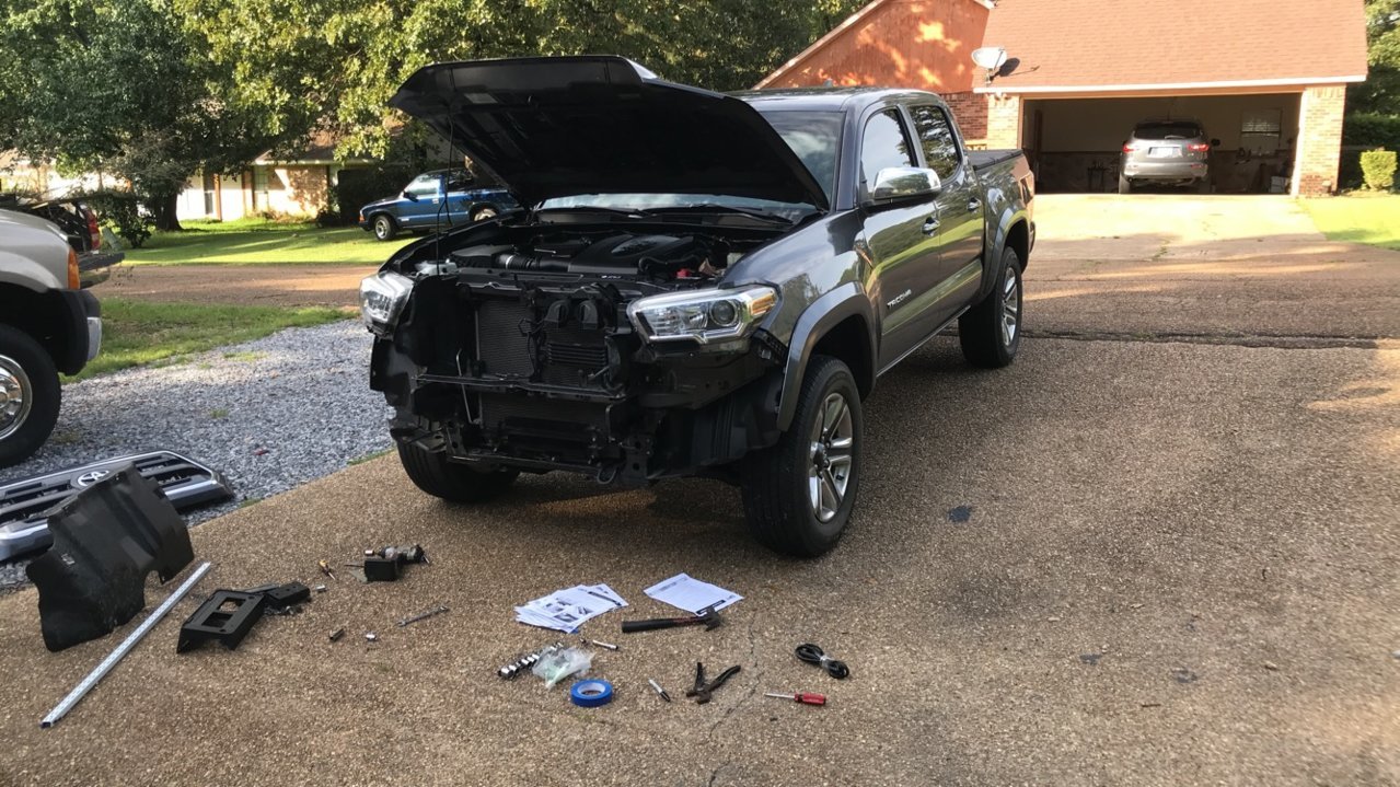

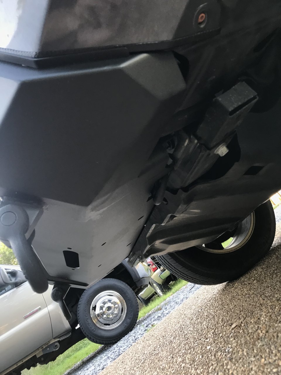

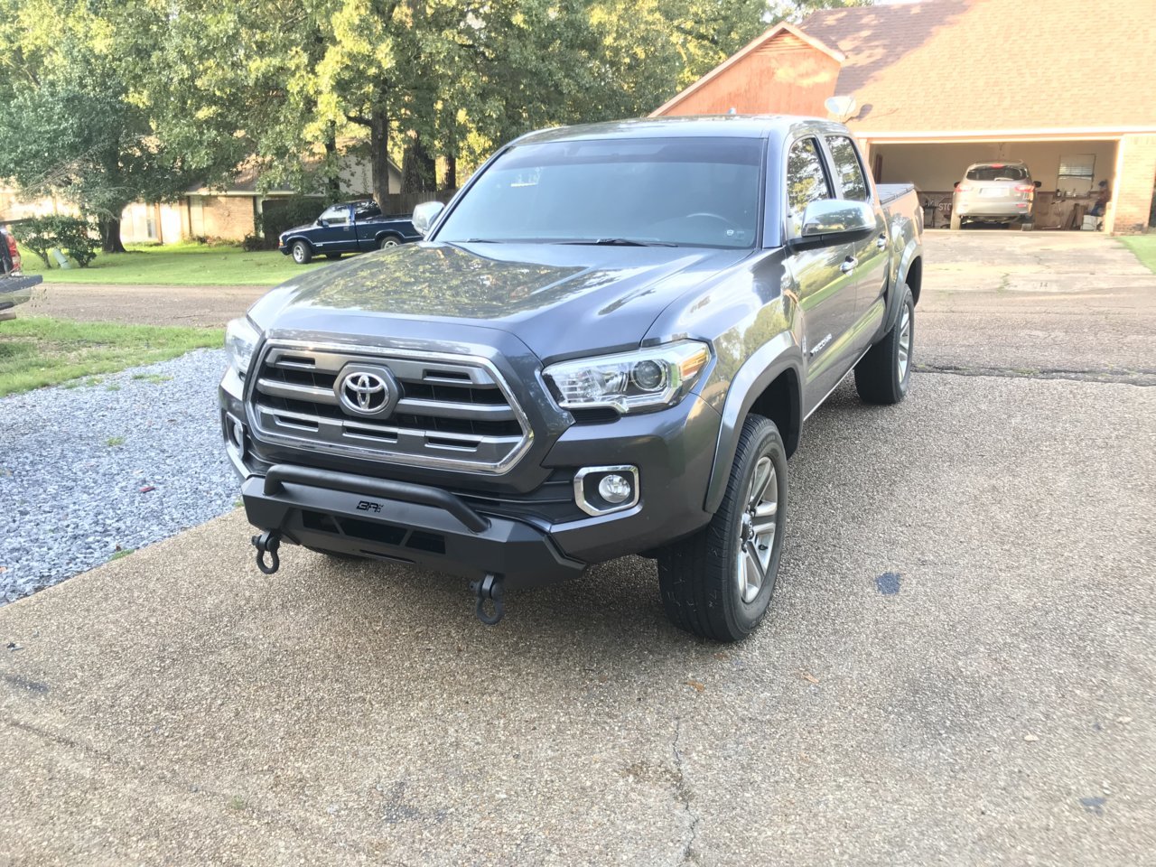

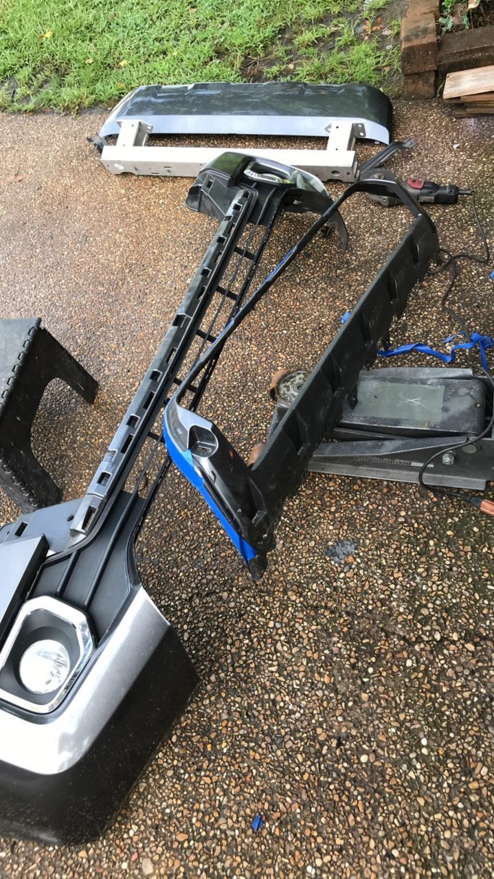

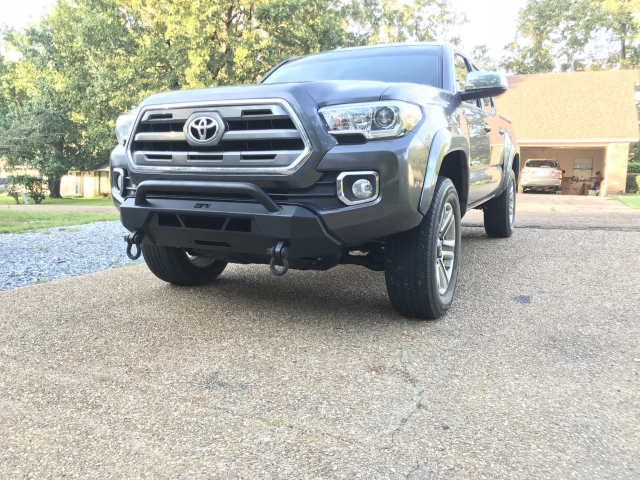

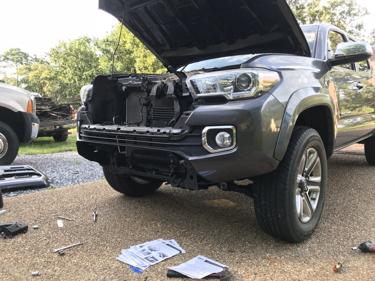

    Picked up a Body Armor Hiline bumper through Tacomabeast and it came in today so I threw it on the truck. Very happy with how it came out. Fitment was really good and the instructions were really good. Love the new look. Took some pictures along the process. Could prolly do write up if someone wants but here’s about how it went. I’ll be getting a winch and light bar for it at some point but I need tires first. If your not installing a winch this can be done by one person all day long.
    Cutting the bumper was way easier than I thought it would be. As long as you follow the instructions the cut lines come out great and fit the bumper well. I used a cut off wheel on an angle grinder to cut it. Instructions say knife or hacksaw but I feel the cut is much straighter with the grinder.

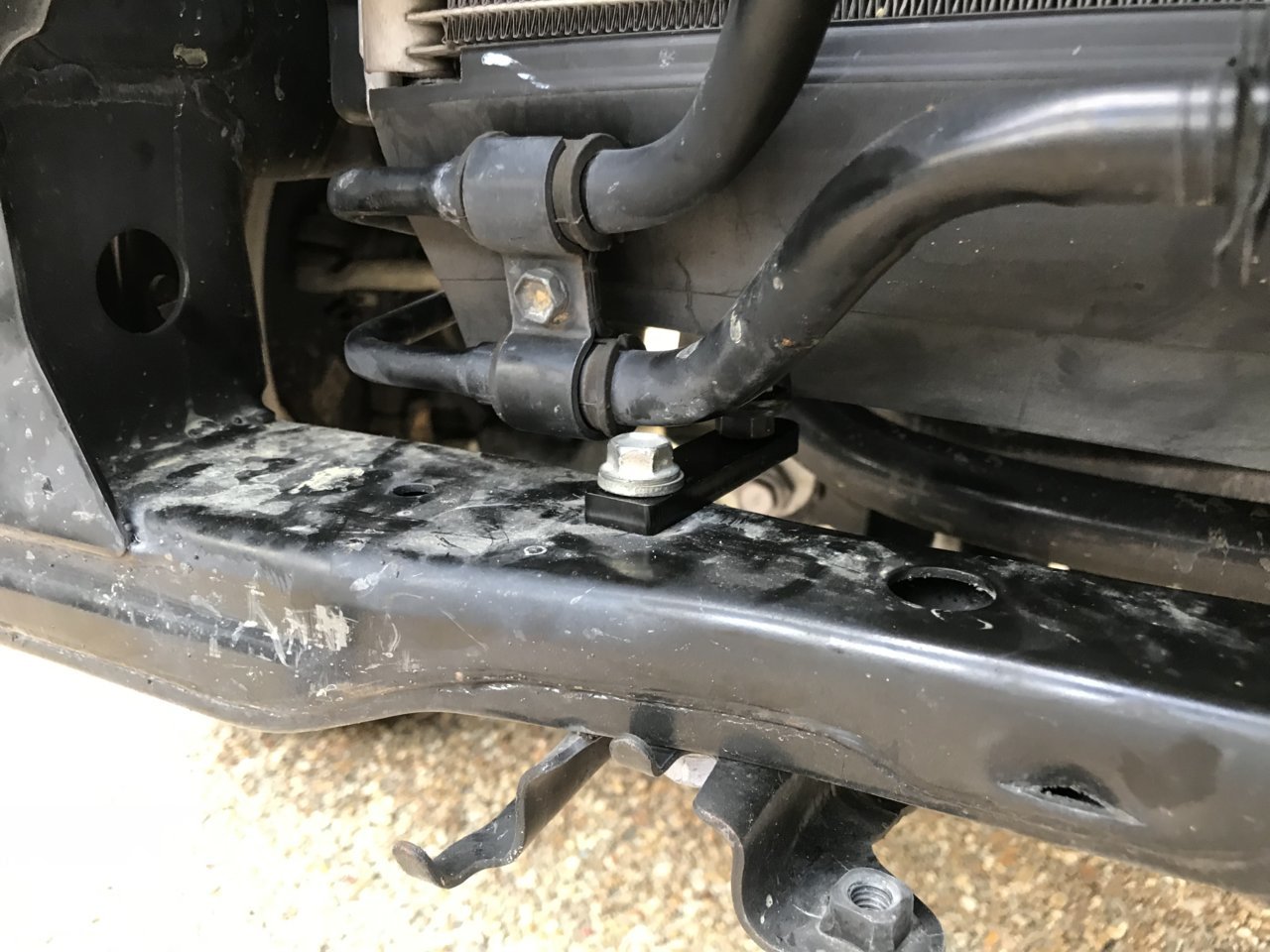

    It came with power steering cooler relocation brackets to set the cooler a little further into the truck. Just make sure once they are installed the cooler isn’t rubbing the condenser. Mine was and torquing the oem mount a little fixed that.
    The included edge trim is actually really nice I had more than I needed.

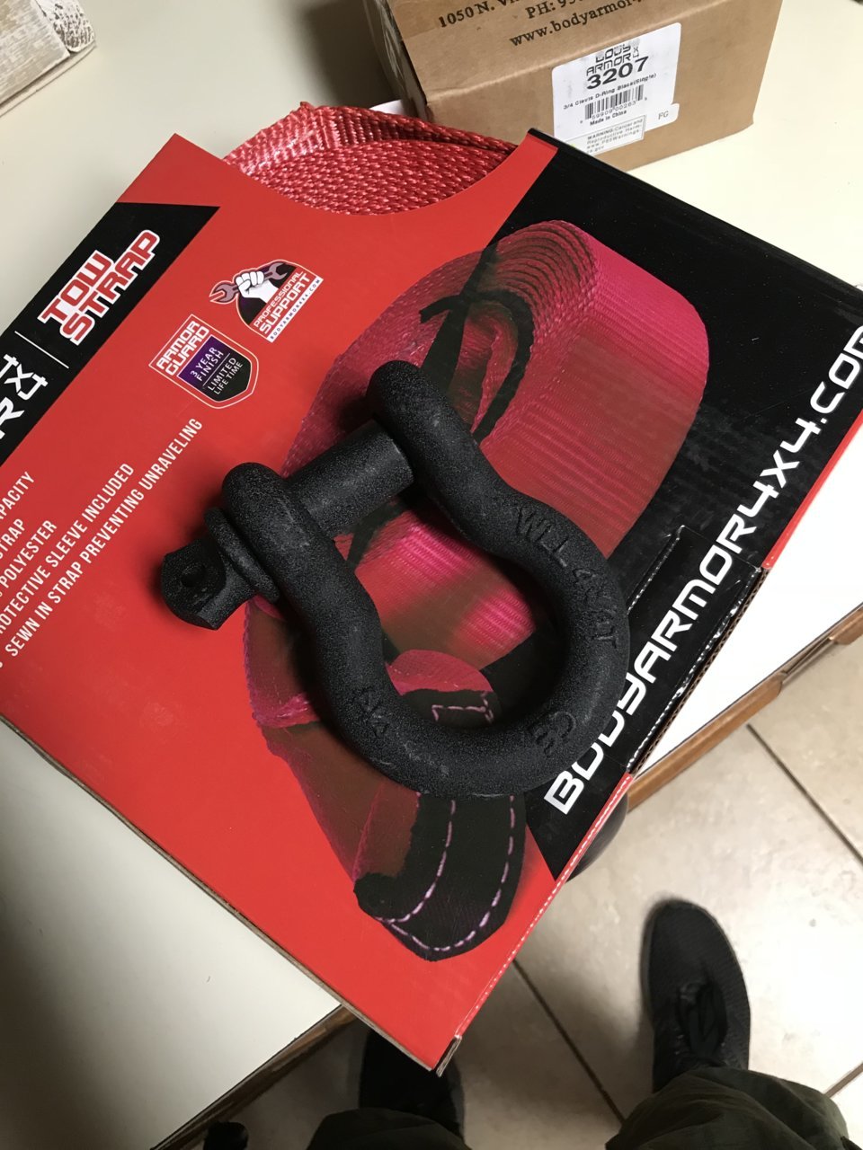

    Since I bought it through Tacomabeast I got a 30’ BA tow strap and two shackles as well included.

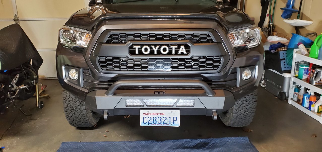

    Just installed the same bumper with a winch and light bar and it looks awesome only down side is I don’t have anywhere to put my front license plate so it’s ziptied to the grill as of now if anyone wants pictures just lmk!

    Mine came with a bracket plate that bolts to the fairlead hole that allows you to run a tag. If you didn’t get that I would call them up and ask about it

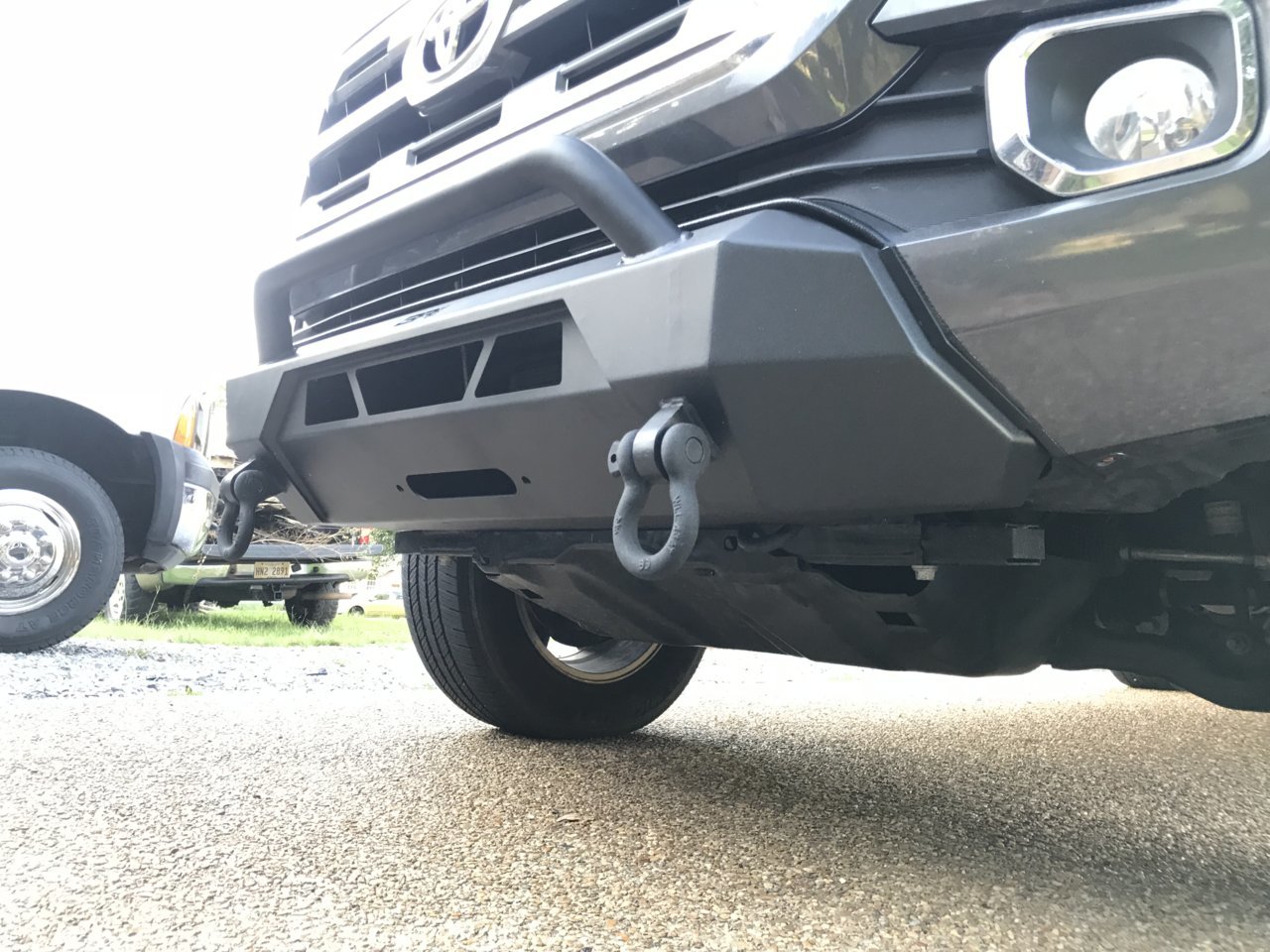

    Looks great! Could you possibly take a pic from the side so I could see the side profile please?
  15. Nov 13, 2019 at 4:26 PM
    Zgriff
    Zgriff [OP] Well-Known Member
    Aug 4, 2019
    #301221
    83
    Zach
    Mississippi
    2016 Magnetic Grey Tacoma Limited 4x4
    yea here ya go
