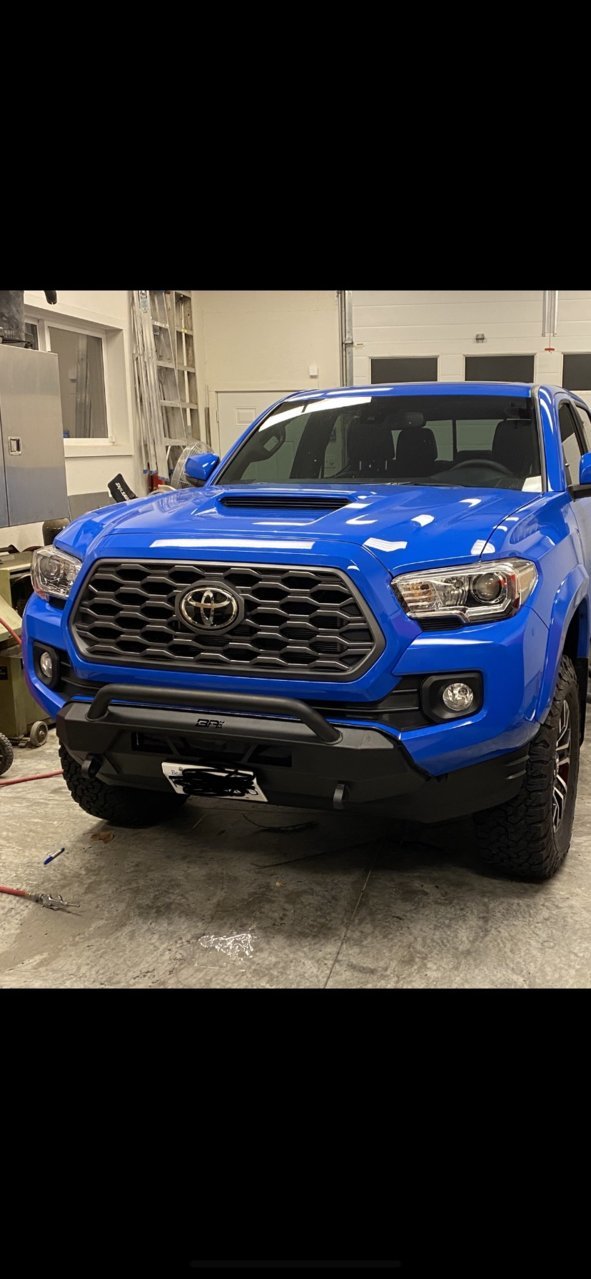

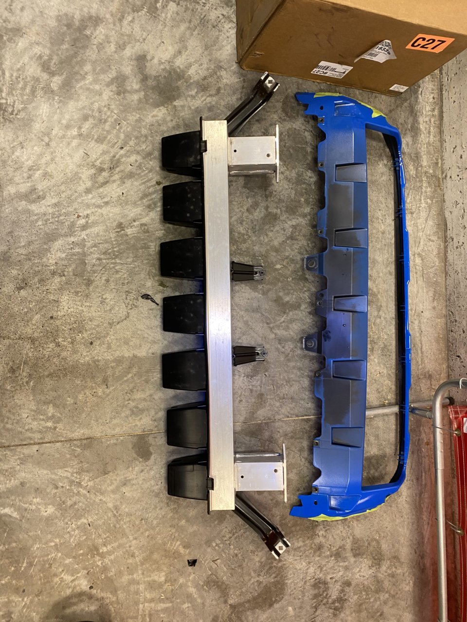

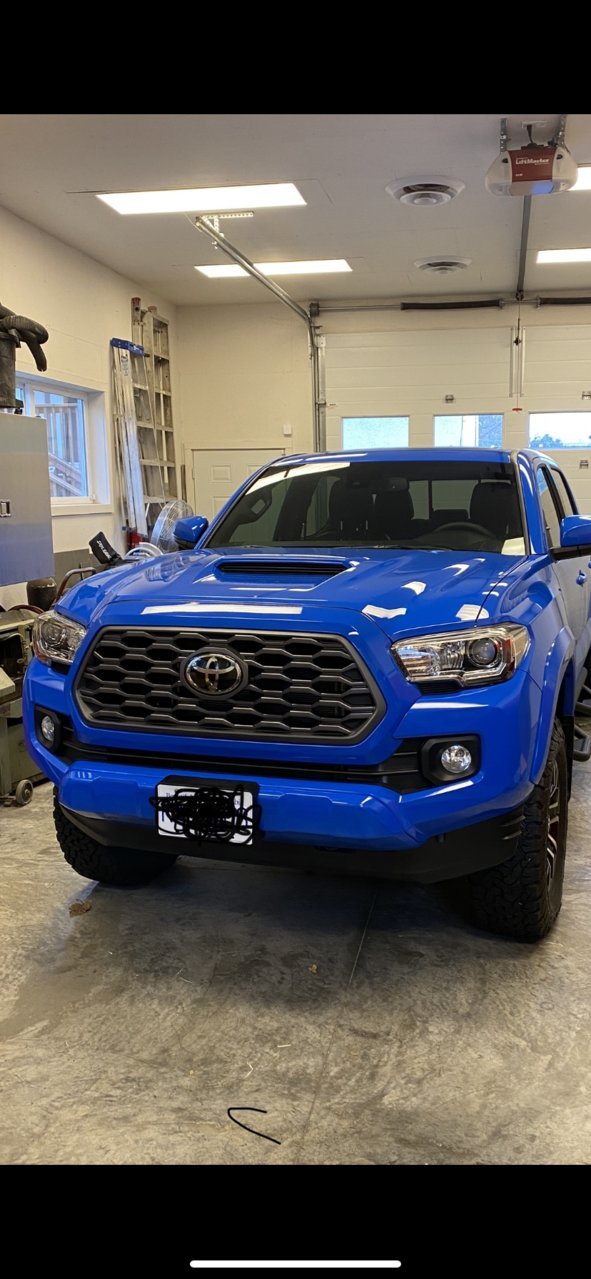

    Finally installed mine.
    FYI if you make your cuts first you can pull the crash bar out all in one piece and real easy. Also I did not take off my bumper at all nor did I loosen the fender flares.

  17. Jan 8, 2021 at 12:03 PM
    #197
    doc76
    doc76 Well-Known Member
    Dec 12, 2020
    #349361
    216
    B.C. Canada
    2021 Tacoma Sport, 2020 Honda Pilot Black Edition
    Do you mean the long black bolt they send with it?
    If so yes it’s the lowest point and I would think it’d be important if you ever pull or winch.
    It’d spread the stresses out more during those actions. It simply slides through the through-hole in the frame.

    One more question sorry. I am just preparing for the install tomorrow. How do you get to the bolt that is screwed on to frame thats holding the lines to the cooler?
  20. Jan 8, 2021 at 1:11 PM
    #200
    doc76
    Dec 12, 2020
    #349361
    216
    B.C. Canada
    After you remove the grill it’s right there. Use a wrench or small ratchet. It’s pretty simple.
    Like I mentioned above I did not loosen my fender flares at all or remove my bumper. Not a fan of removing panels unecessarily. Like to reduce chances of breaking clips ;)
    I removed the bumper insert out front first (the piece the license plate mounts to) Then make your marks and cut THEN remove the crash bar after all in one piece. It was way easier than the videos on YouTube.
