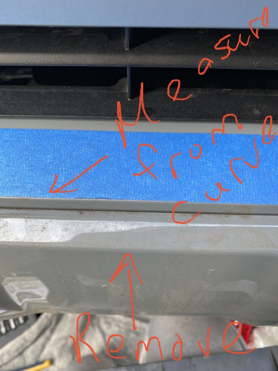

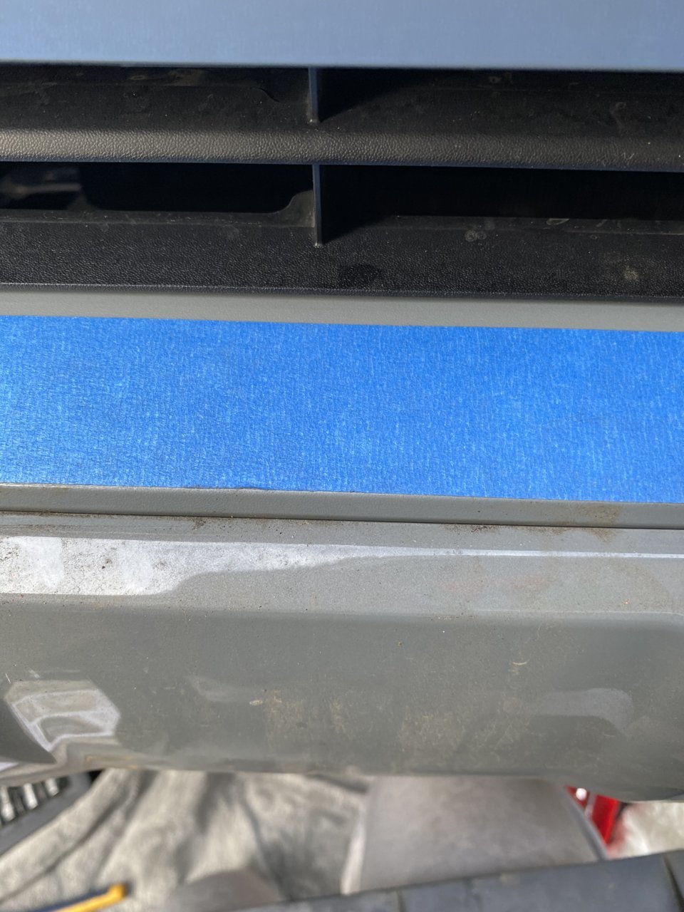

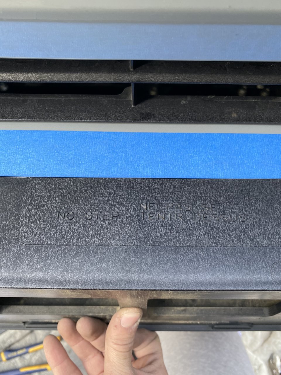

    Need help! Do i measure 20mm from the license plate bracket or edge of bumper? Pics attached.

    No take the license plate mount off. Measure from the curve where the insert fits to the bumper

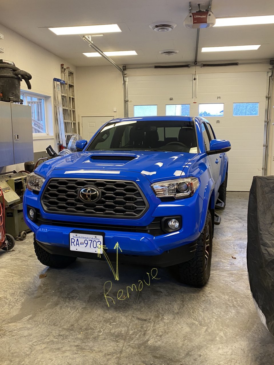

    If you’re still having trouble I have a spare bumper at home I will take a picture and send it to you as to where exactly to measure off. Can’t on mine cause it’s already done

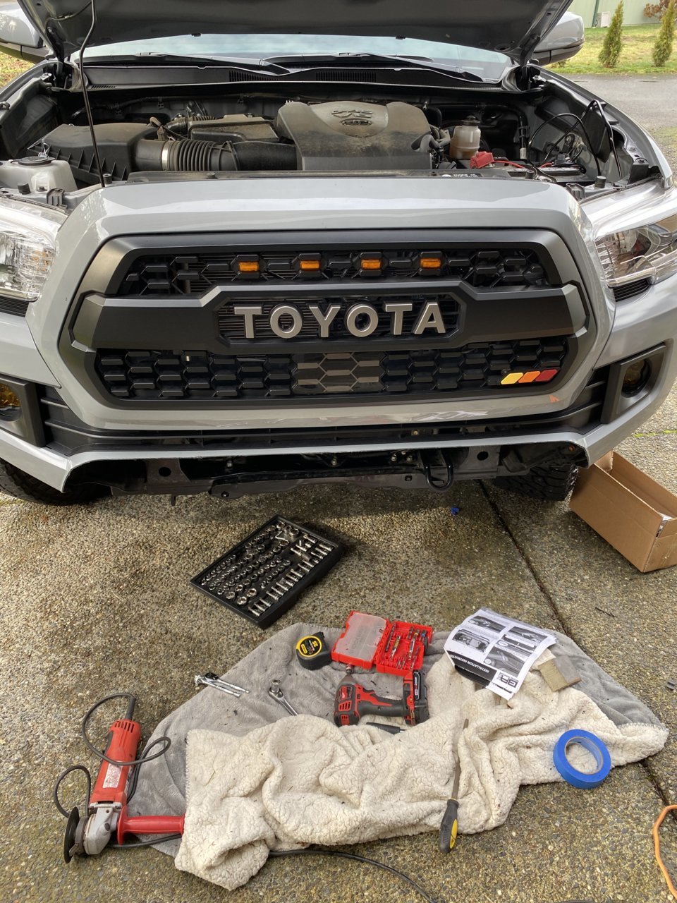

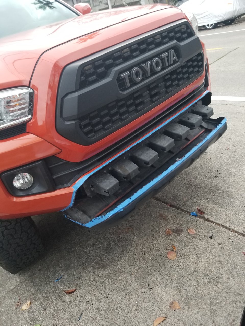

    Got it cut now! Just waiting on my dad for space hands to attach the bumper. Did you put in the 4th supplied bolt or i will be fine with 3 factory ones? Also I didn’t remove the grill, should i remove it now when attaching the bumper? Or there is ways to tighten the nut without taking the grill off?

    Good job on the cut. Remove your grill. You’ll need to for access mounting the bumper.
    yes use the 4th supplied bolt. It’s crucial as it’s the lowest mounting point so is very important if you ever pull or maybe even winch

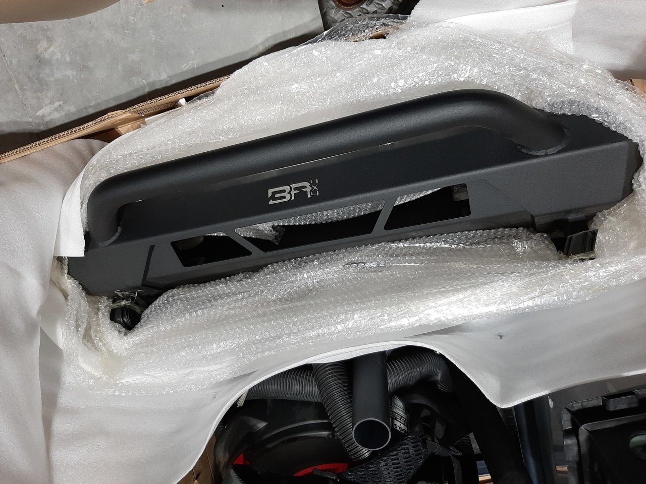

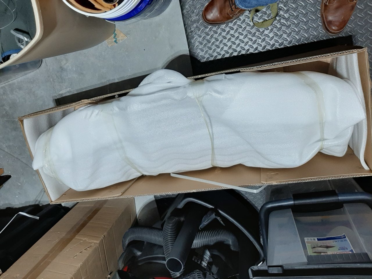

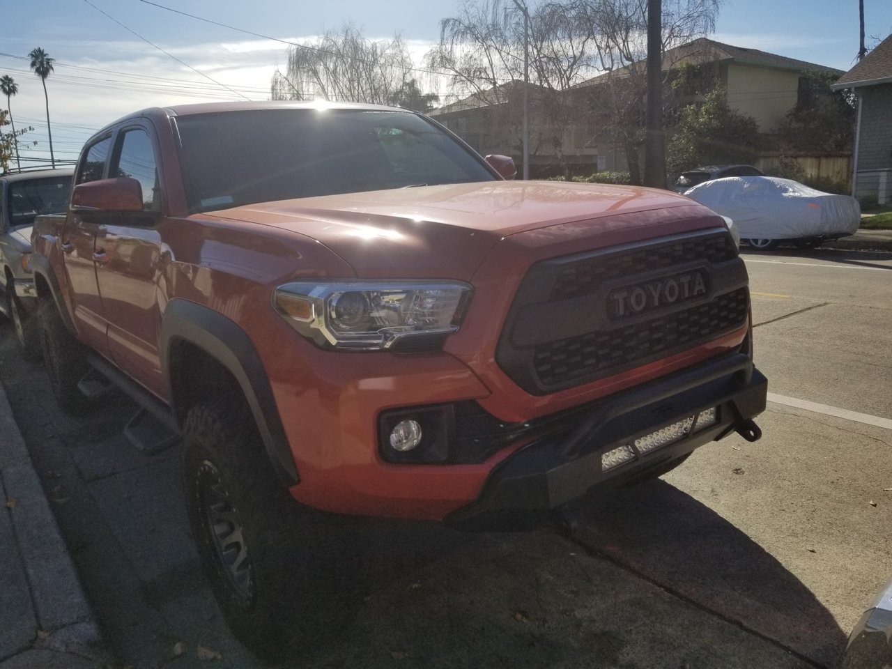

    So, truck doesn't come in until next month, but I'm racking up the accessories. I have a Diamondback bed cover, Predator rails, and interior odds and ends in the garage. Hiline bumper showed up today.
    Pretty impressed with the packaging. They wrapped it in a thin bubble wrap, then wrapped it again in foam wrap. Definitely helped it against dings because the box was a little beat up.
    Bumper itself is great quality. Scanned through the instructions also and install seems pretty cut and dry. Add all the great info from this thread and I'm looking forward to adding this on the truck.

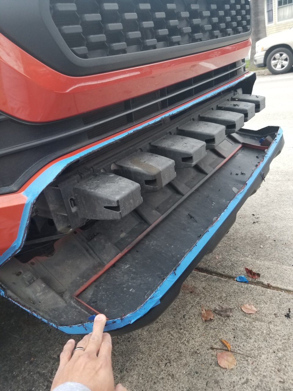

    Ok from reading the posts I went straight to it and cut the front off without removing anything. I used an oscillating tool. Any advice how to get this crash bar off. The bolts are off but crash bar has a little wiggle but not breaking loose.

    There are clips on the crash bar to remove this piece. Just clip them off.

    Yup if I remember correctly there was a fastener on each underside that pin the inner fender to the bumper and that attached on the inside to the black brackets that come off each side of the crash bar

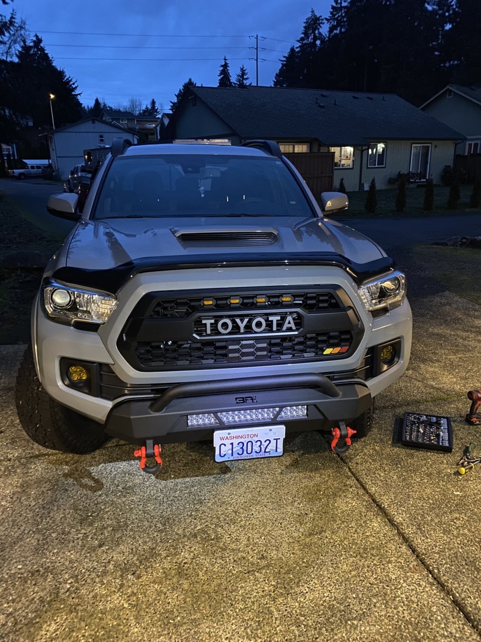

    Got it done
