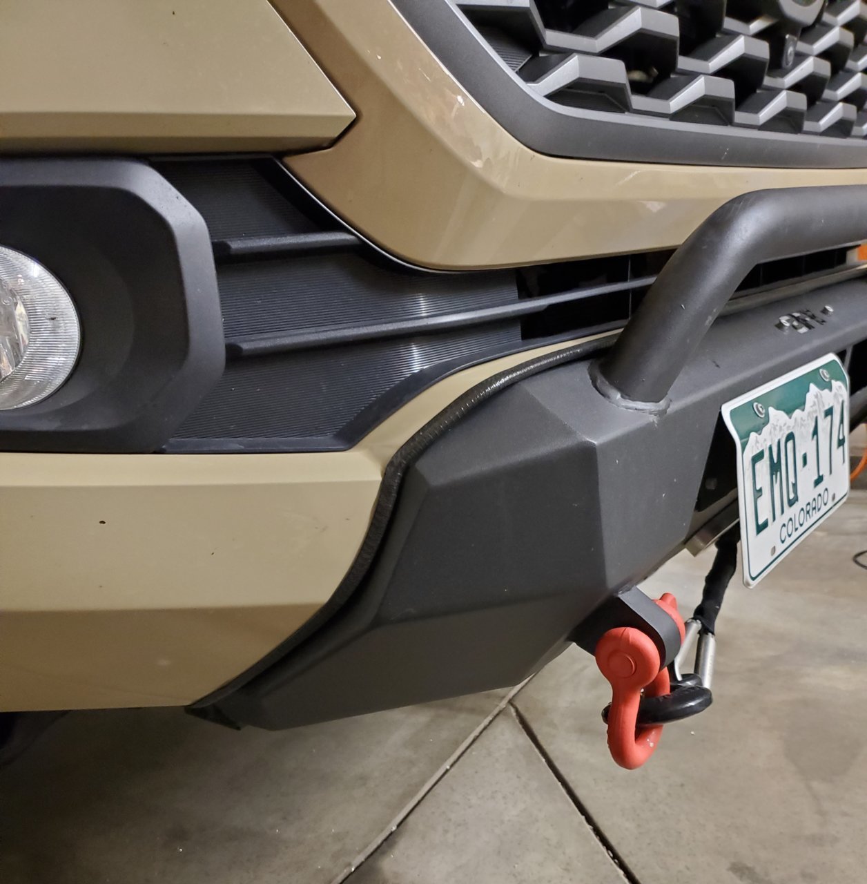

    I just looked and it doesn’t really show it either way, but if you cut the amount off it says to, it looks like it would go behind the plastic.
    There was another guy that put it in front of those small strips of metal but he said his truck had been wrecked.
    Here is the instructions for reference
    https://www.bodyarmor4x4.com/wp-content/uploads/2019/08/TC-19339.pdf

    well obviously, I didn't get to see the videos!:rofl:
    Here's a good pic of mine, went on easy enough and I think it looks clean, too. Looks like tabs in front is correct though? Oh well...I'm NOT changing it now! :crapstorm:

    I think the tabs should be in front of the plastic bumper to help hold it in place since you remove all the support structure down the middle but I don’t know, just a guess

    Funny! I seem to recall I put the tab behind for the very same reason; to support the plastic. Oh well...vive la differance! :cheers:

    Yea I don’t care either way. I just want to do it the way it was intended. When you cut the top and down the sides it removed that whole center section. By pressing the lip up against the front of the bumper skin I would think it would hold it in place better than on the back side but I could be wrong. I scoured the body armor Instagram page and as people posted pictures most of them seem to be on the front side of the skin where you can see the lip. It will be interesting to see what body armor was thinking on this as clearly it doesn’t say in the Manual

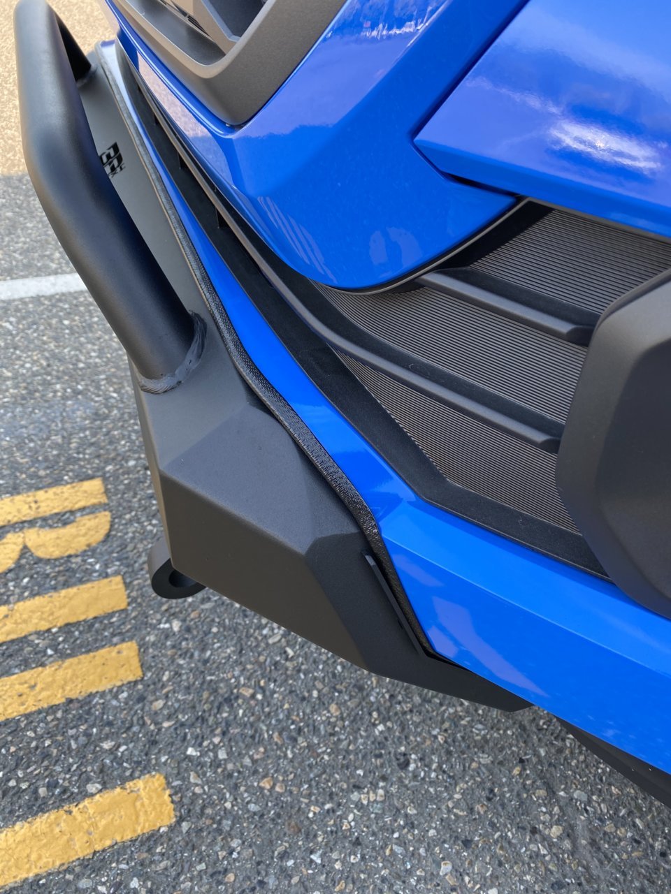

    So I went to great lengths to understand this too. Turns out the fitment of the bumper is designed to tuck behind that tang. It works to retain your plastic. I tried mine both ways cause I feel it looks way better hidden HOWEVER I found that my plastic did not fit correctly and my black plastic inserts were gapping out all weird if you looked close. As a result I called BA and they confirmed the fitment and purpose.
    If you think about it and are backing up with anything that snags underneath, we have now cut away plastic and fasteners that were designed to provide integrity to the facia.
    I didn’t like seeing the tangs but am much more comfortable with the fitment result and purpose

    In front is correct
    In behind looks better
    Dawelda likes this.

    Great, thanks for the heads up and clearing this up. I thought that was the case. Once you cut that lower valance you lose some support so pushing those tangs up against the edge guard you place on the bumper cut and then bolt it at the back it should hold it in place. Should be putting mine on in the next couple days with a Warn EVO VR 10S and the body armor light bar.....

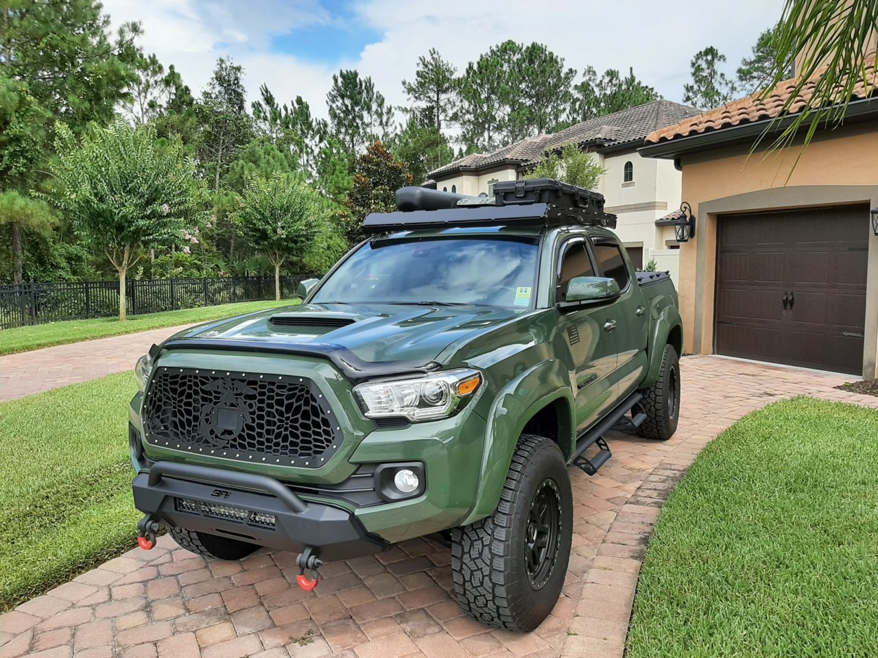

    I had no choice with mine. I screwed up the cut a little bit that made it so the tabs had to go in front of the bumper. It actually hid my terrible chop job.

    Those look like some pretty cool horns.... what are they?
