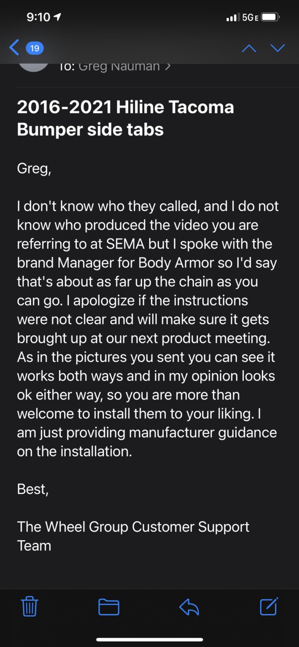

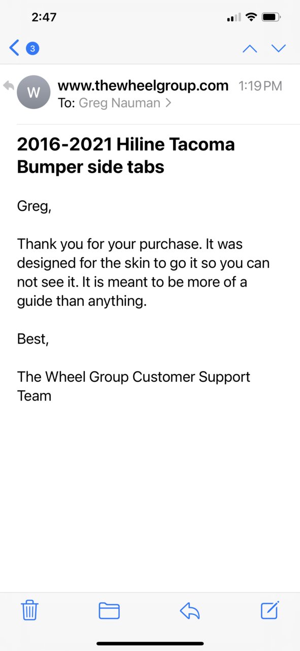

    Well I had emailed Body armor. Here is a screen shot of what they sent back.LOL
    It is a mystery LOL Good grief!
    I guess just choose the way you want to do it and go with it. LOL

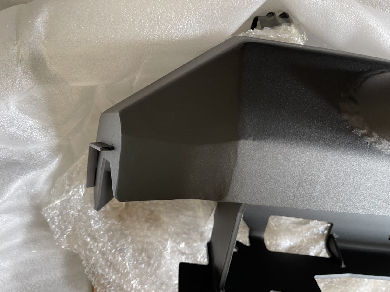

  5. Jul 19, 2021 at 3:45 PM
    #365
    doc76
    doc76 Well-Known Member
    Dec 12, 2020
    #349361
    216
    B.C. Canada
    2021 Tacoma Sport, 2020 Honda Pilot Black Edition
    Yup that’s par for the course with the product quality I got after 2 defective bumpers so it really does not surprise me at all that their customer service team cannot agree on correct installation.
    Like I mentioned I think it looks way nicer with that tang in behind and hidden but mine wouldn’t fit. It had to go in front. My bumper facia simply wouldn’t fit back on with that tang sitting behind.
    If I could do it all again I most certainly would NOT install a BA bumper again.

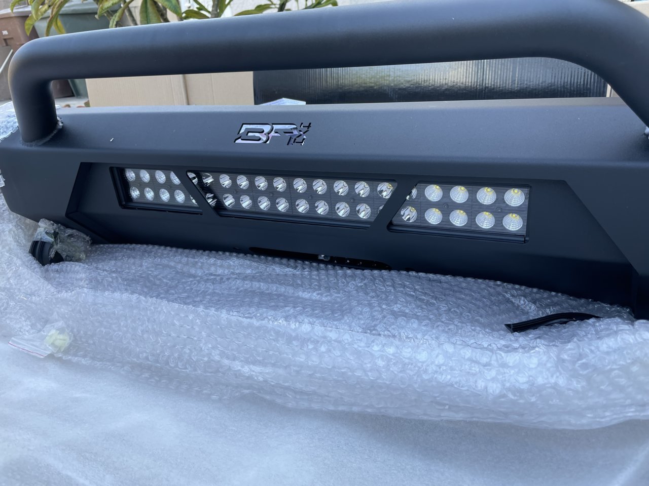

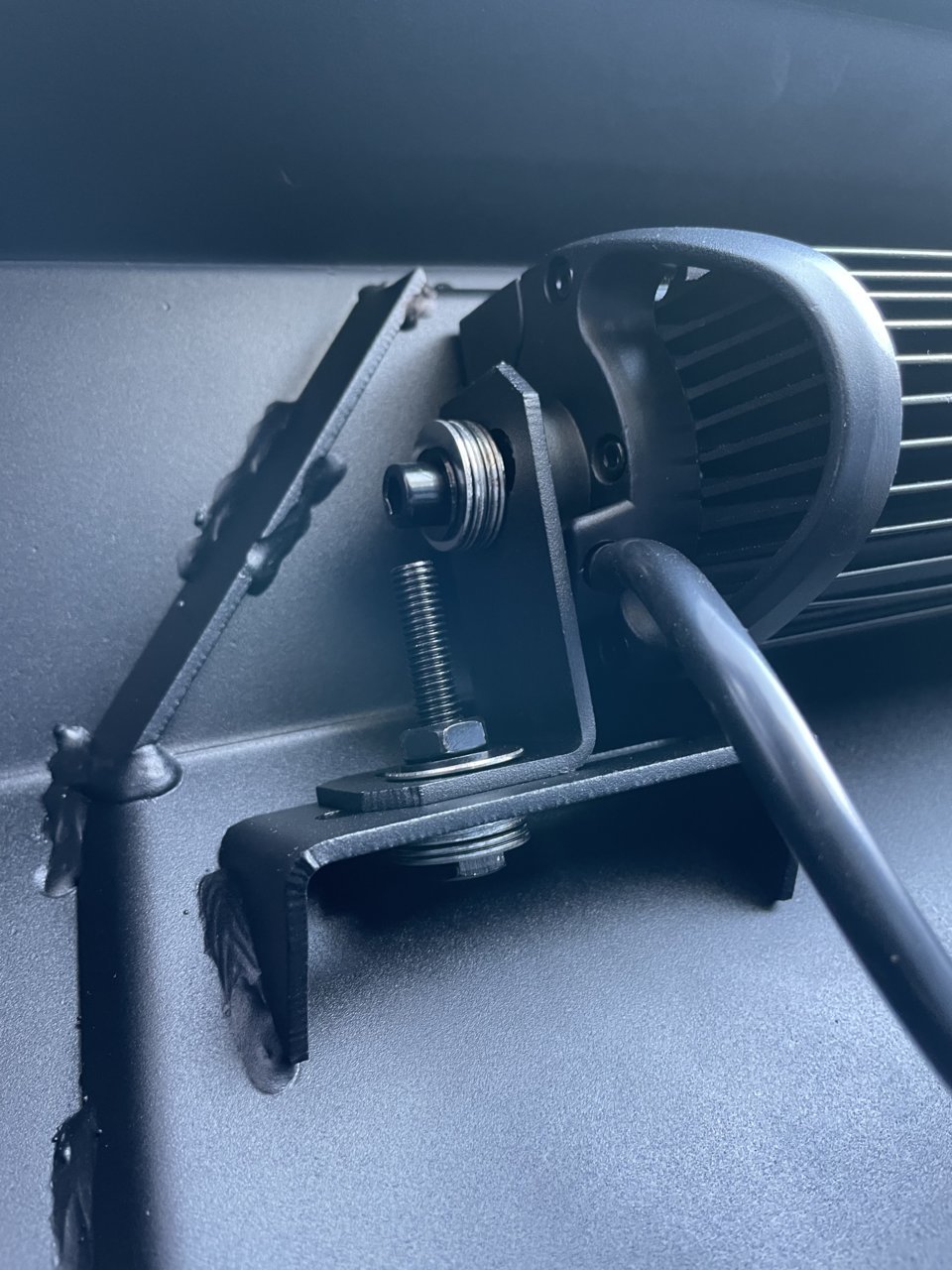

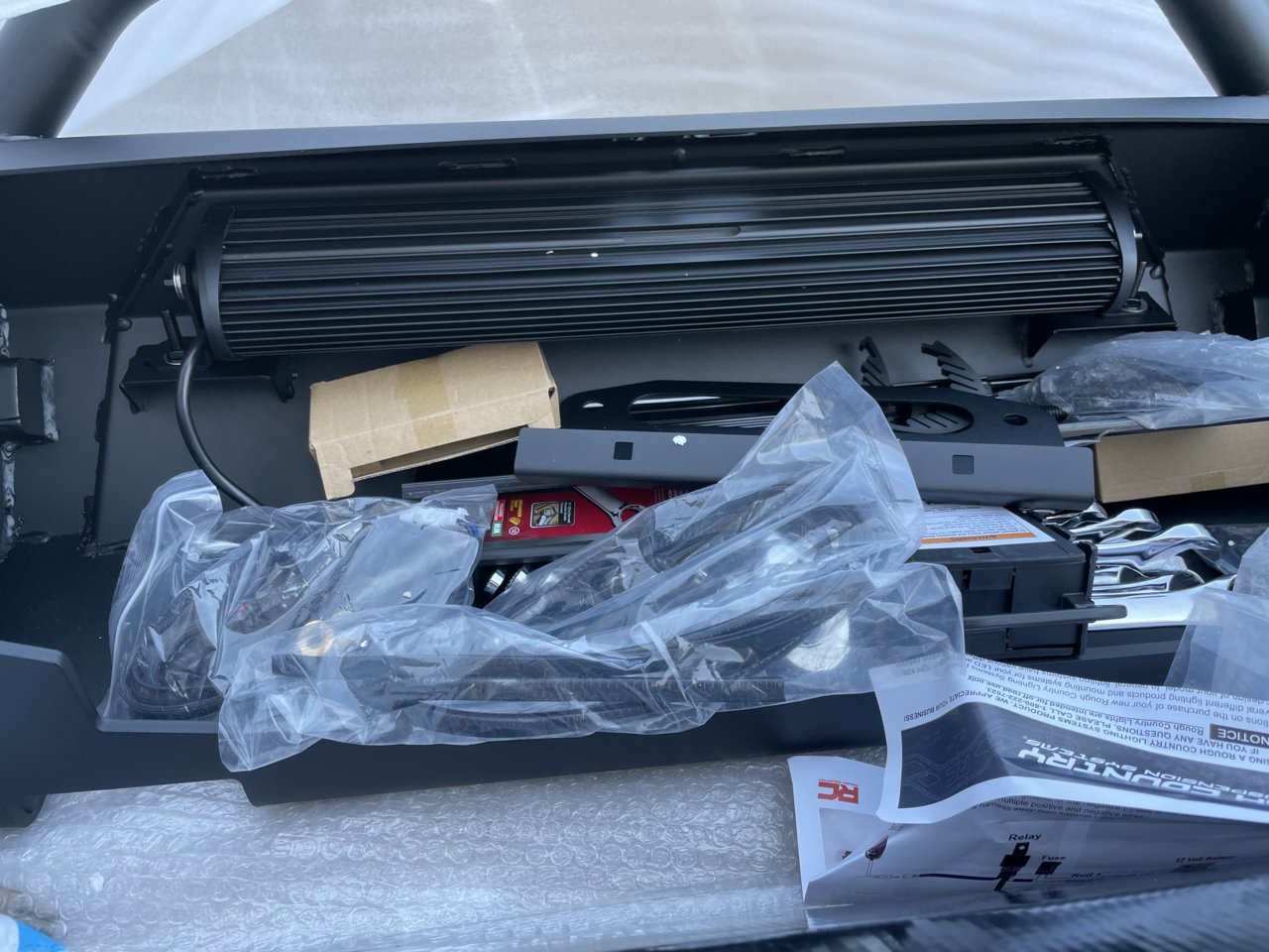

    I just installed my RC light bar to my hiline bumper. The bracket from the light won’t work. Use the L bracket provided by hiline and bolt with the bolt supplied by RC. You will need about 10-12 washer per side to make it work.
    i haven’t read the instructions from hiline yet and stop at the light installation. Not sure if I need that L bracket later or not. Guess I’ll read later tonight and find out. Hopefully I don’t need that L bracket ….

    Doc they responded to my response LOL

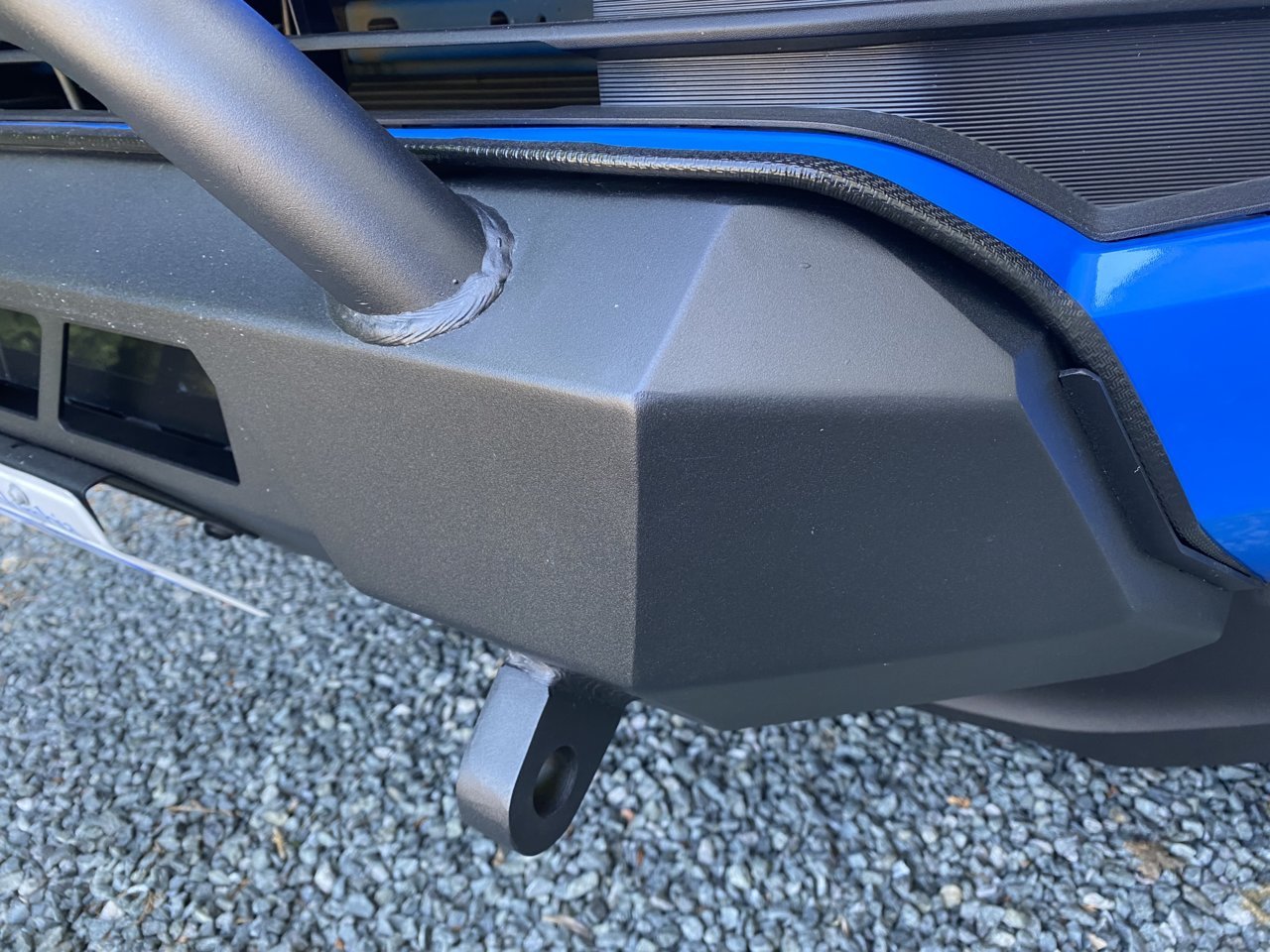

  12. Jul 21, 2021 at 7:58 PM
    #372
    gregnauman
    gregnauman Well-Known Member
    Jul 2, 2020
    #333209
    472
    Greg
    2020 Tacoma TRD Pro
    None

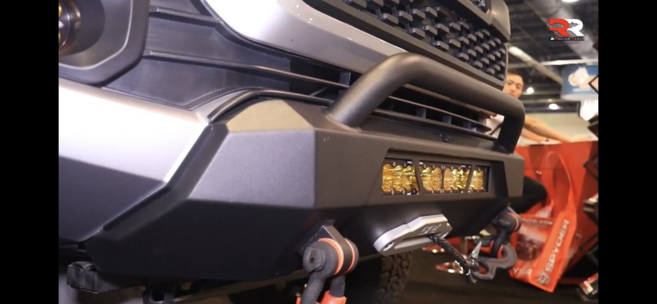

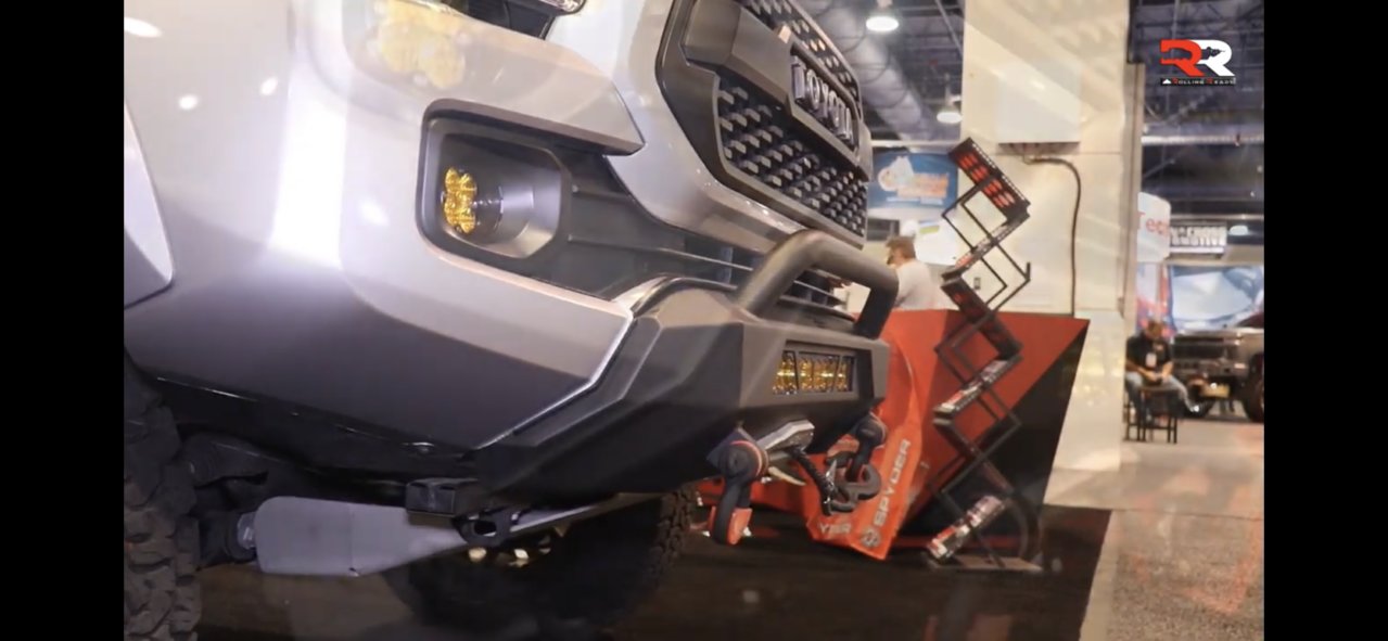

    Here ya go. A video by rolling ready at the BODY ARMOR BOOTH at SEMA 2019.
    The tabs are in front of the bumper skin LOL
    Cracks me up….BA told buyers multiple different things regarding the tabs and right in their booth at SEMA 2019 it’s the opposite of what they told me in the emails LOL
    https://youtu.be/h4nfFQx7yKc
    ORtoCOTaco likes this.
  13. Jul 21, 2021 at 9:25 PM
    #373
    doc76
    Dec 12, 2020
    #349361
    216
    B.C. Canada
    Just sharing my experience with this product and yes, I am typically one of the unlucky few. I see it as a big deal after what I had to go through to get one decent bumper for $800 CAD.
    When I had problems after opening the box on the first bumper I received due to unbelievably poor workmanship, my local distributor completely agreed and was really fantastic to deal with, 4WP, they hooked me up but it took four bumpers. I took the original one back to pickup the replacement. We had to dig through 3 more new ones to find a good one. The second one was full of porosity in the outer visible welds. When I tipped it back a whole pile of rust fell out of the drain hole on the top pipe. The third was legit laughable and finally the one I picked, the last one available, was good quality welding and even had rust inhibitor used inside the top pipe along with rubber plugs to keep moisture out of the pipe. It also had a significantly better powder coat finish.
    All four bumpers side by side varied widely in weld, powdercoat finish & packaging quality.
    If I couldn't have found one in the four I would have gotten my money back.
    Even the guys at the shop couldn't believe it and called in their area rep to discuss, for all the good it probably did ;)
    BTW I never did get a response whatsoever from Body Armour regarding quality issues when I tried to contact them first. No email reply. No returned call to my phone messages......nothing. I have worked in the steel fabrication/manufacturing industry for more than two decade and have never received such uncontrolled product quality followed by such a low level of customer service from a manufacturer.
    If I had to guess they are not doing the manufacturing themselves and are nothing more than a reseller hence cannot control their quality and don't know how to even address it.
    Its a bummer because its a great looking bumper.
    Would I buy one again.......not a chance given the time I had to spend to get a good one.

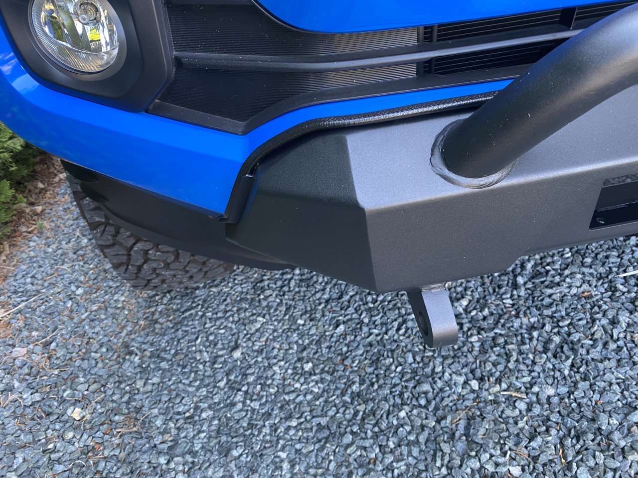

    Looking good! Thanks for sharing. I did not know that these kits came with the edge trim to clean up the look. Did you notice any degraded performance with the extra weight?

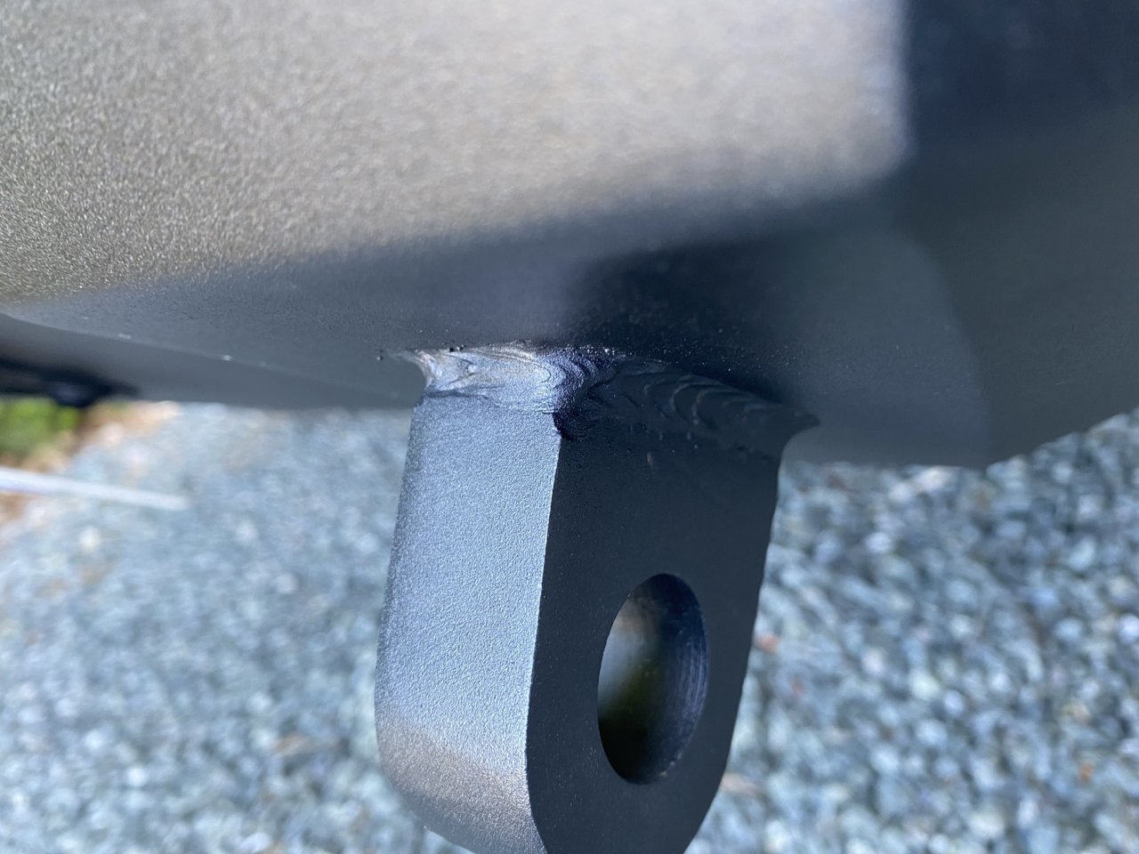

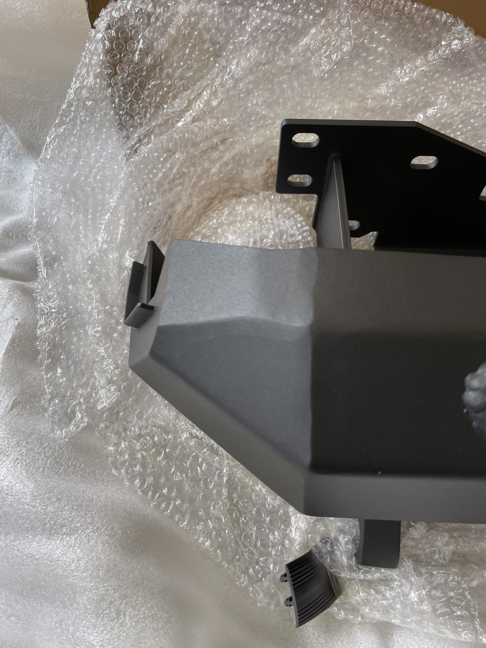

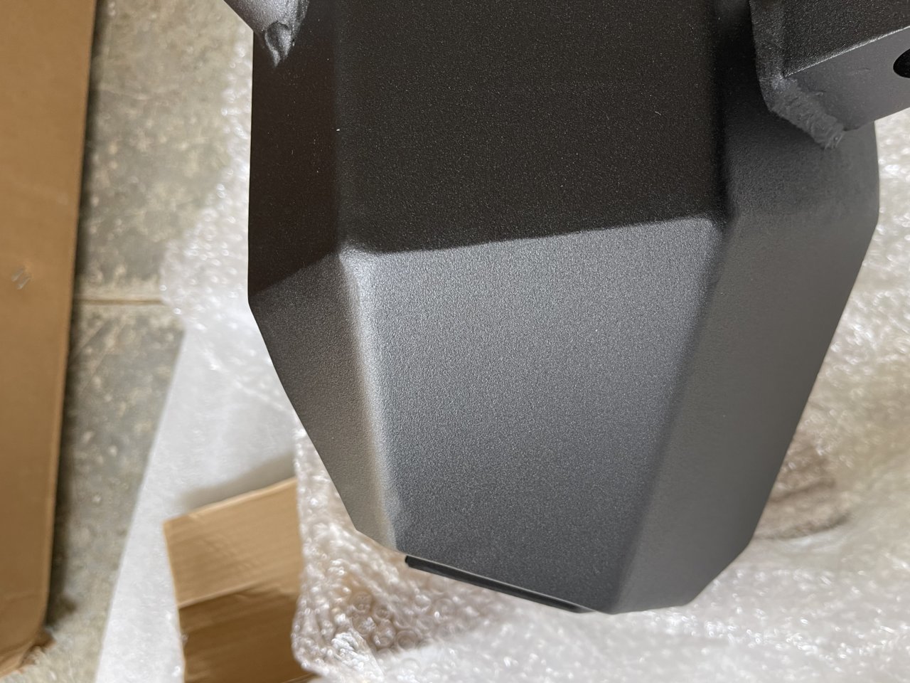

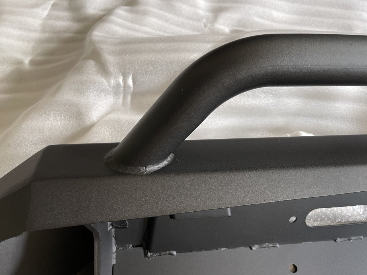

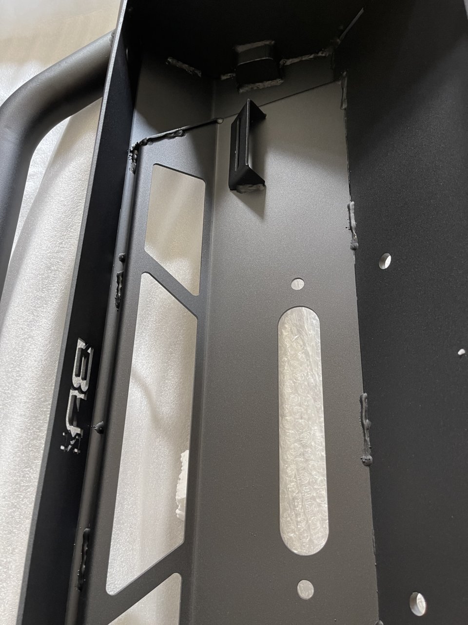

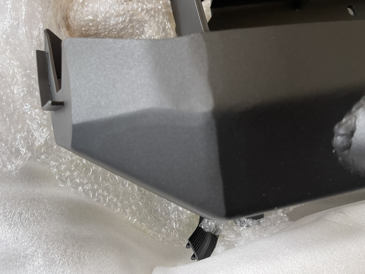

    Ok this is my second bumper. This looks way better than the first one I received but wondered what you all thought In comparison to what you received.

    1F877F58-2F76-4F6A-97FD-62A8179BE3F0.jpg C8292333-60DB-41B2-8492-AD4E4088A0F0.jpg 8B27D77E-9A5C-42CB-8D0F-B9A8493E02BF.jpg
    For me that would certainly be unacceptable.
    My forth bumper was best. Even then I would not do a full pull on the D-ring lugs
    Mark77 likes this.

    :welder:To be fair, the undercut on the d-lugs LOOKS pretty bad. Is undercut at the weld always rejectable, no. From a judgement point of view? It's not under cyclical (vibrations) stress or high load impact and would surely require more than 12K pounds (steel is really strong) of static pull to shear it, honestly. And remember it's pushed through and welded on the other side, not just that single crappy weld holding it to the surface. The section it's welded to will fail first. That said, it's probably way over built and the last thing that will fail on this under normal use. Some of the welds on the Toyota frame likely aren't any better. I wouldn't think twice about hooking up to it as long I'm just pulling a truck out, if that were the only issue.
    The intermittent welds inside are too cold and are a legit liability under normal loading. Also, the grinding is some of the worst I've ever seen. Ever. I would return it for that alone. I think it's likely structurally suspect and cosmetically objectionable. :cheers:
