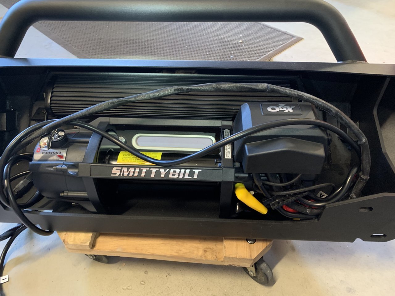

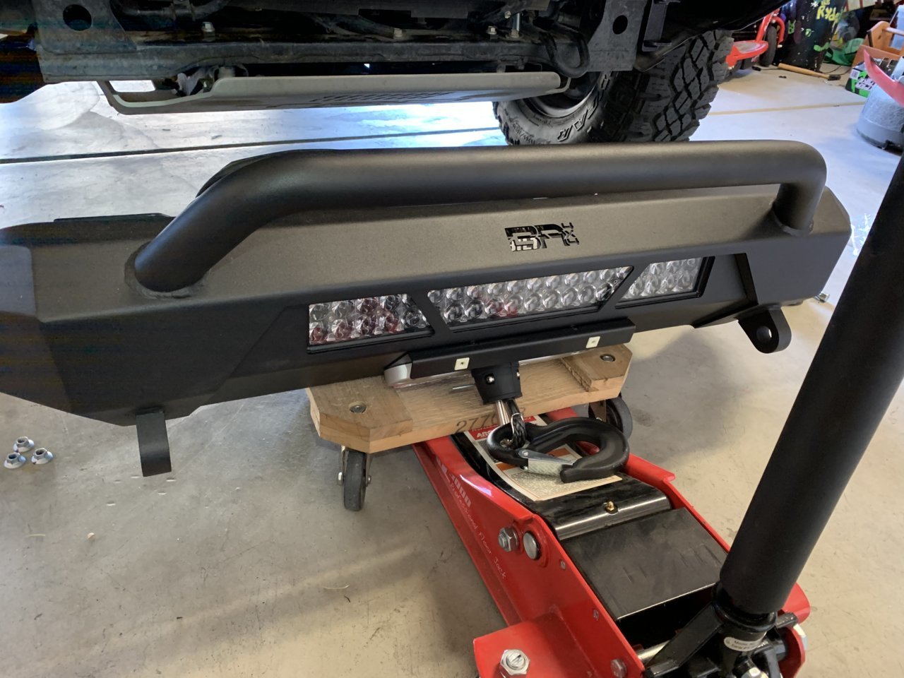

    I used this guys install instructions in conjunction with instructions from body armor and did not remove the front bumper or skid plate which saved a lot of time and made it easier.
    Body armor doesn’t mention it but when you move the power steering lines back towards the condenser you have to remove one other bolt on the frame that holds power steering lines on the passenger side.. easily accessed through wheel well if you remove one clip holding the mud flap in there.
    I installed on my own by moving it around on a furniture dolly and then jacking it up while on dolly as seen in pics below. Worked like a charm!

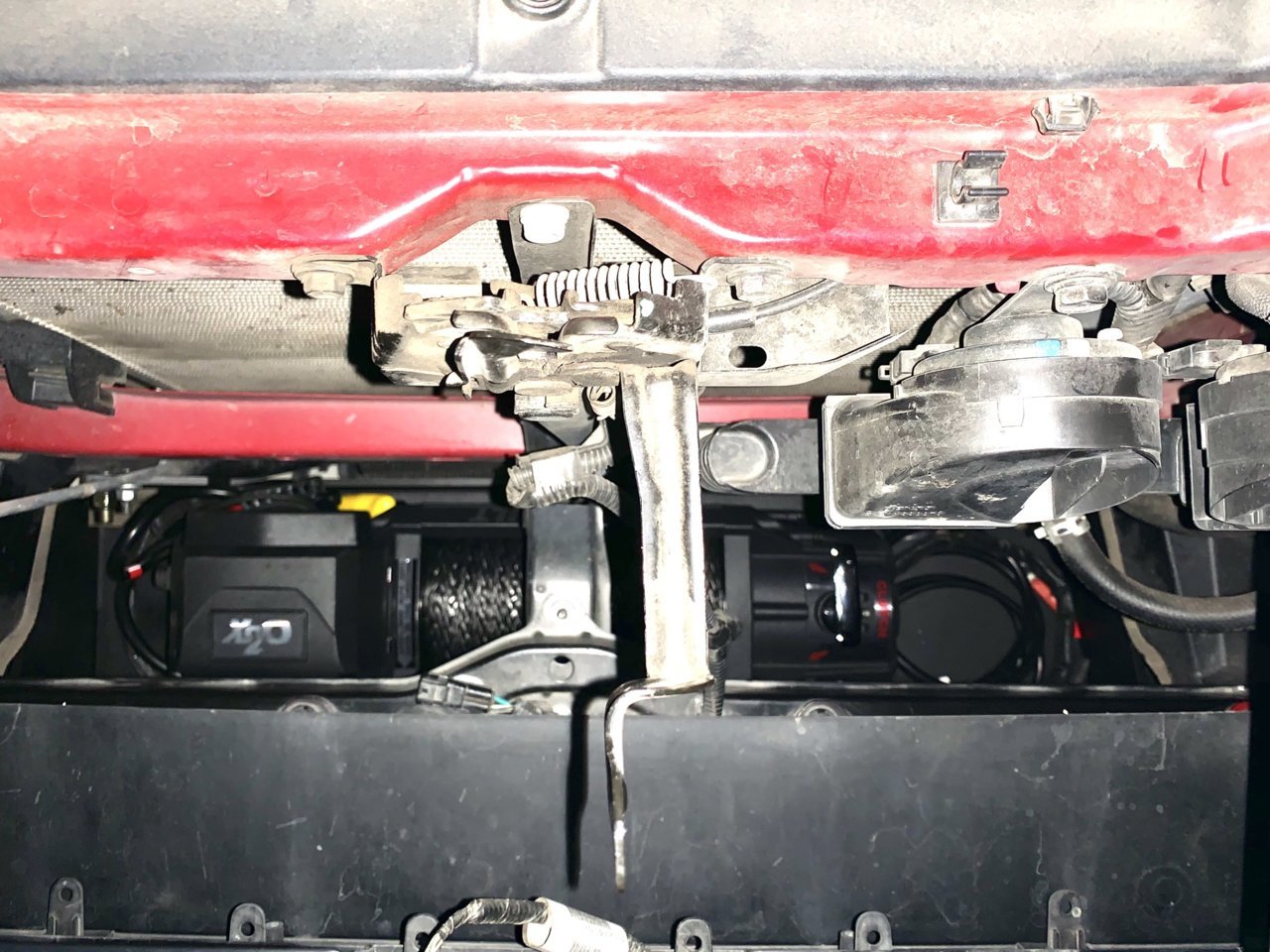

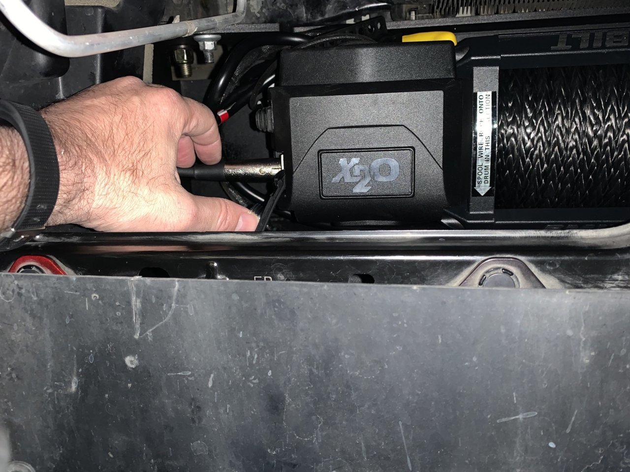

    With a light bar and winch installed is there an access port on the bumper to hook up the winch remote? Would you be able to take a few pictures of how you are able to access the winch?

    Pop the hood and you have easy access to hook up the controller although mine is wireless but that’s where the switch is too if you want to run it wireless. You can also reach the clutch lever through the hood. Not the ideal setup if you use the winch often but if it’s for occasional use it’s not bad. It’s also well protected from theft this way.

    Thanks for the explanation and for taking the time to post pictures. That was my final concern so I'm on the train, I'll be putting that bumper on with a winch (as soon as I've got some scratch).

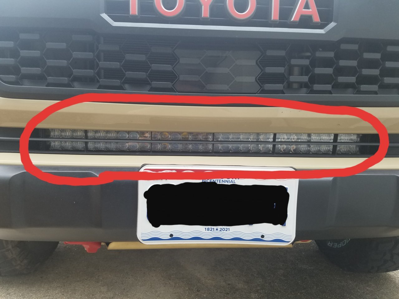

    Hey guys just bought the BA rear bumper so next is the front. I do have a question regarding the bullbar. Can someone take a direct, same level front pic of that area for me? I have the 32" Caliraised hidden led bar in that grill area just above the bumper and in between the bullbar. So want to make sure the bullbar doesnt block that lower grill completely.

    haven’t installed mine yet, but this video gives you a good head on view.
    https://youtu.be/h4nfFQx7yKc
    And this one the guy has a hidden light bar like you, about 12min 30seconds in he shows the front with the hidden bar in there too.
    https://youtu.be/rFCKEgkEPW0

    Thanks man, looks like he is running a single row. So my 2 row, the top will be blocked by the bar but bottom row is fully open to shine. Just did a test blocking the top row and there is still plenty of light displayed.
