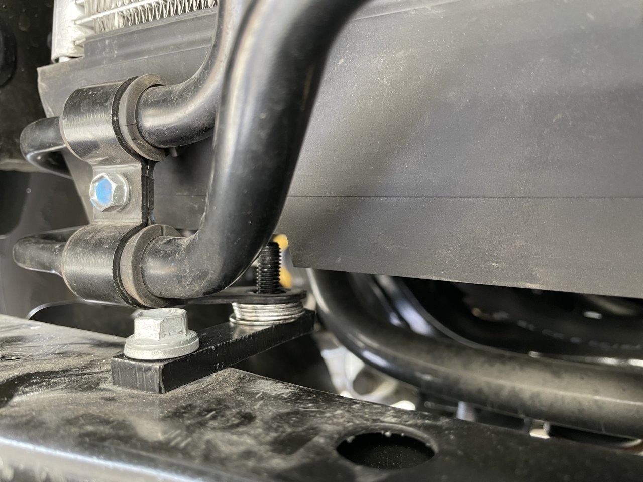

    Another issue I have is, the piece to move the power steering line, it doesn’t really fit properly. I have to add 5washers each side to raise it up so the line won’t crush against the bolt. To me that wasn’t a bit deal. Also, the 3rd bolt on the side that hold the power steering line, after moving it back, there is no way to install that bolt back due to the alignment of the hole. So I just leave it there. But hopefully the replacement bumper is fine.

    My power steering cooler would not fit either using the kit. I too had to use stacks of washers to clear the bolt heads.

    Instructions with the BA Bumper kit say to use the extra nut included as a spacer, if you need to raise the supplied power steering cooler bracket relocation kit.

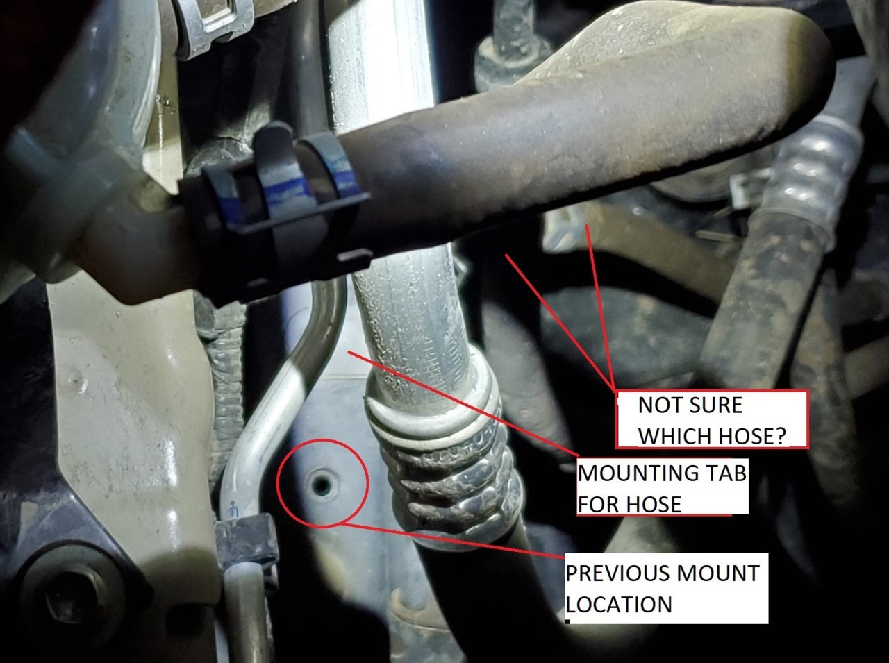

    This is inside engine bay, top of frame member, passenger side.
    Okay, now I know why I forgot about it...I don't even think I can get in there to re-mount the hose! I would have to remove so many things just to get access to the frame:frusty: I could barely even get this picture but, I wanted others to see what we're talking about. The hole in the frame is the original threaded bolt hole for the tab attached to oil cooler hose. You can barely make out the tab I have identified, you can't see it but it has a hole in it for a bolt to pass through. I'm not sure which of the hoses is the one in question, runs either to or from oil cooler.
    I had to un-bolt this hose from the frame to be able to move the cooler back and relocate it. The instructions say nothing about the line having to be free or, about re-mounting it. It is still loose. :annoyed:

    What 3rd bolt? Remeber, it's been since December when I did this. Yes! This IS the frame bolt for the cooler line.

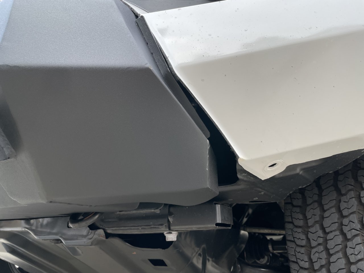

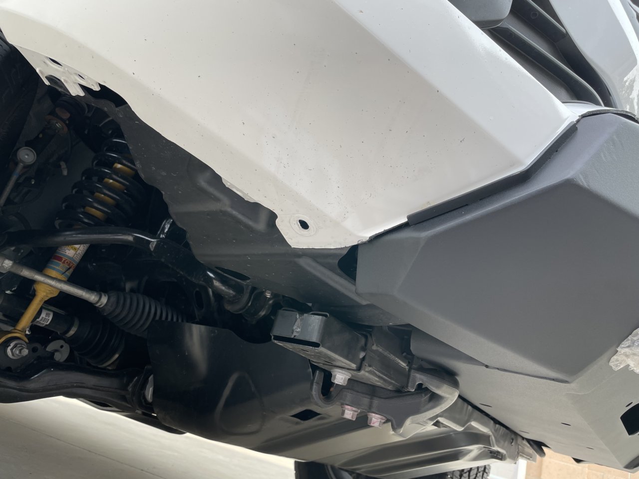

    Well guys an Update and a HUGE SHOUTOUT to Body Armor and the store I purchased from, Clint at https://wheelsplusmore.com
    So as I said I received my second bumper this week similar to Doc's experience it had some imperfections. The first one was damaged in shipping and it also had some imperfections. So I contacted WheelsPlusMore and they had the second one shipped out.
    The one I just received in the pictures above was just cosmetically not very good in some areas so I sent pictures to Clint again and asked him what he thought. I just wasn't sure what to think and thats why I had asked you guys for some more pictures.

    Yeah. If I didn’t unbolt that, there’s no way I can push the line back on the left side. The bumper itself is bent at the corner. They are sending me a replacement.
