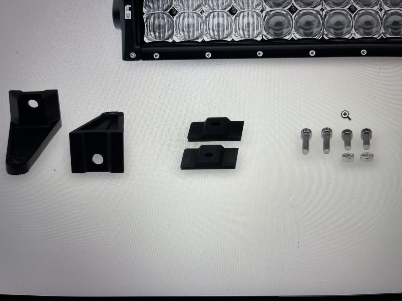

    For those that installed the Body Armor light bar with the Hiline bumper, which brackets did you use for the light bar mount? Bumper has some and so does light bar.
    The hardware that came with the light bar was a silver allen head bolt and a nut with nothing else.....

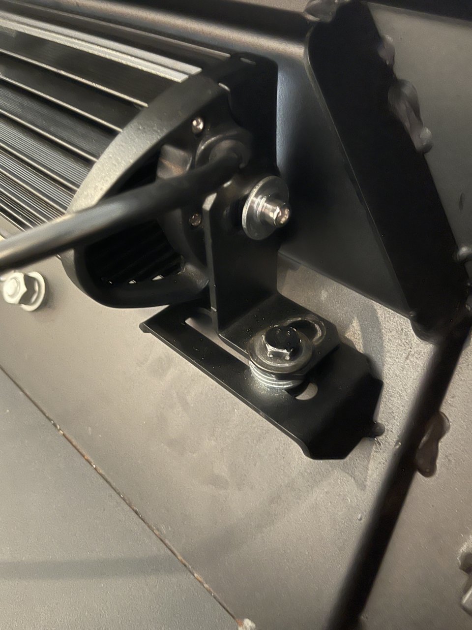

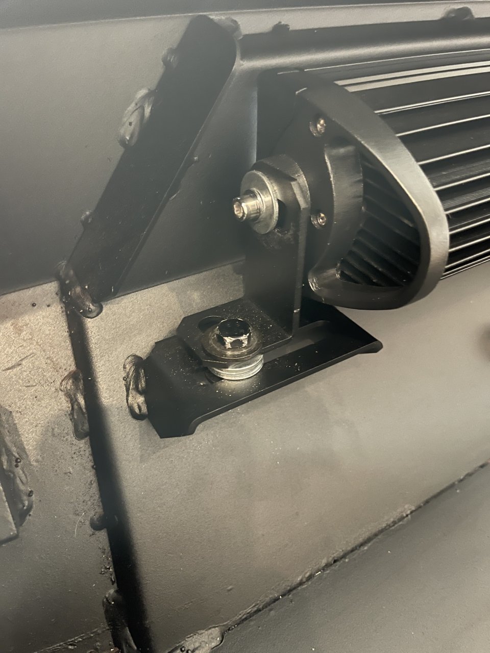

    Well I got it mounted. I had to use some spacers washers and then I found a couple other washers I had for the small bolt tha goes into the side of the light bar
    ignore the damage to the bolt head my socket slipped off with my impact. Oops

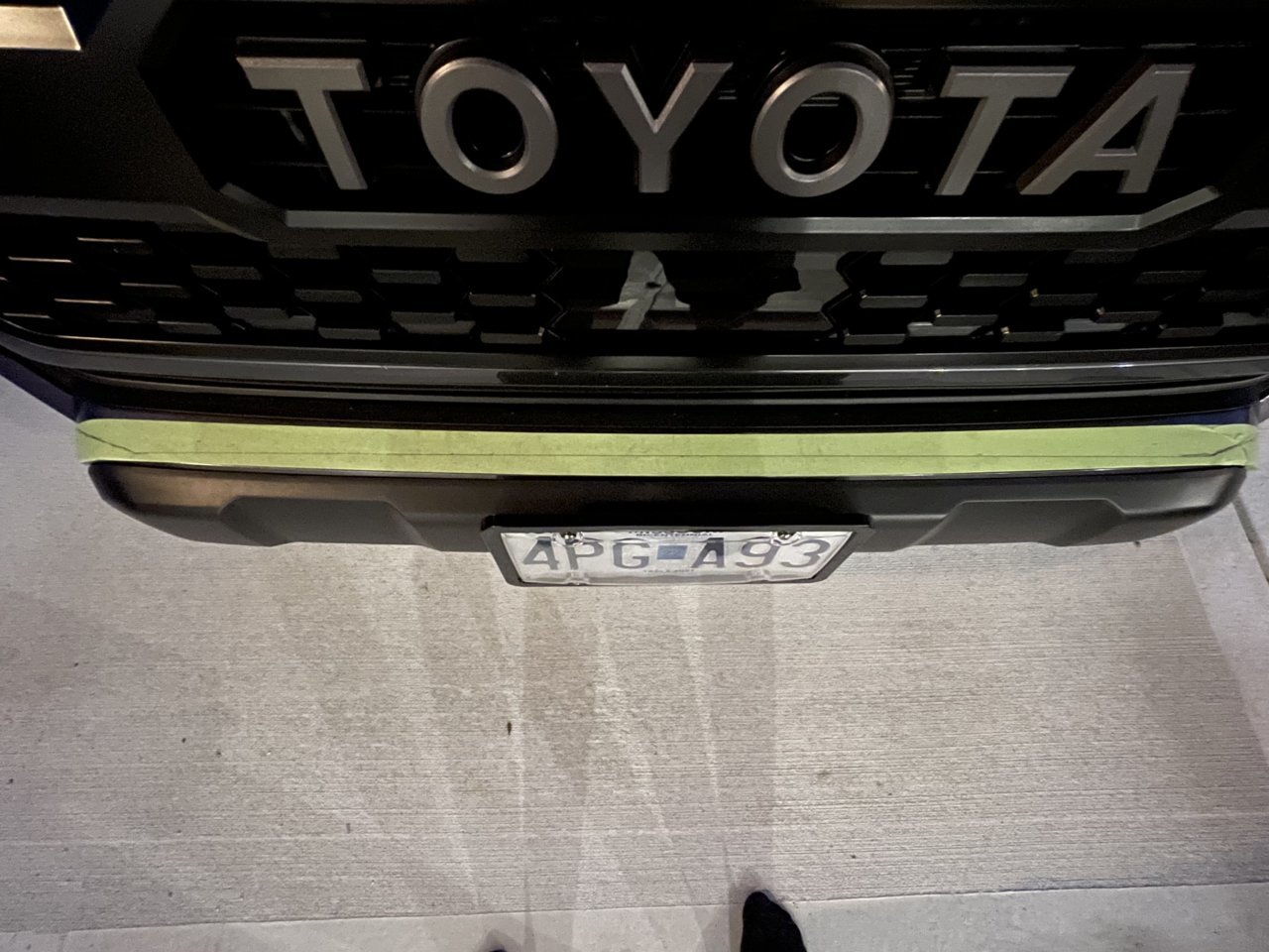

    For those that have made the bumper cut as I look at the front bumper it does curve. The instructions say make a mark 20mm from edge of the bumper right in the center and then draw a straight line. So that is what I did. I then drew an angled line to follow down to the bend in the bumper skin
    This look right to you guys?

    yup

    looks pretty close to what I did.
