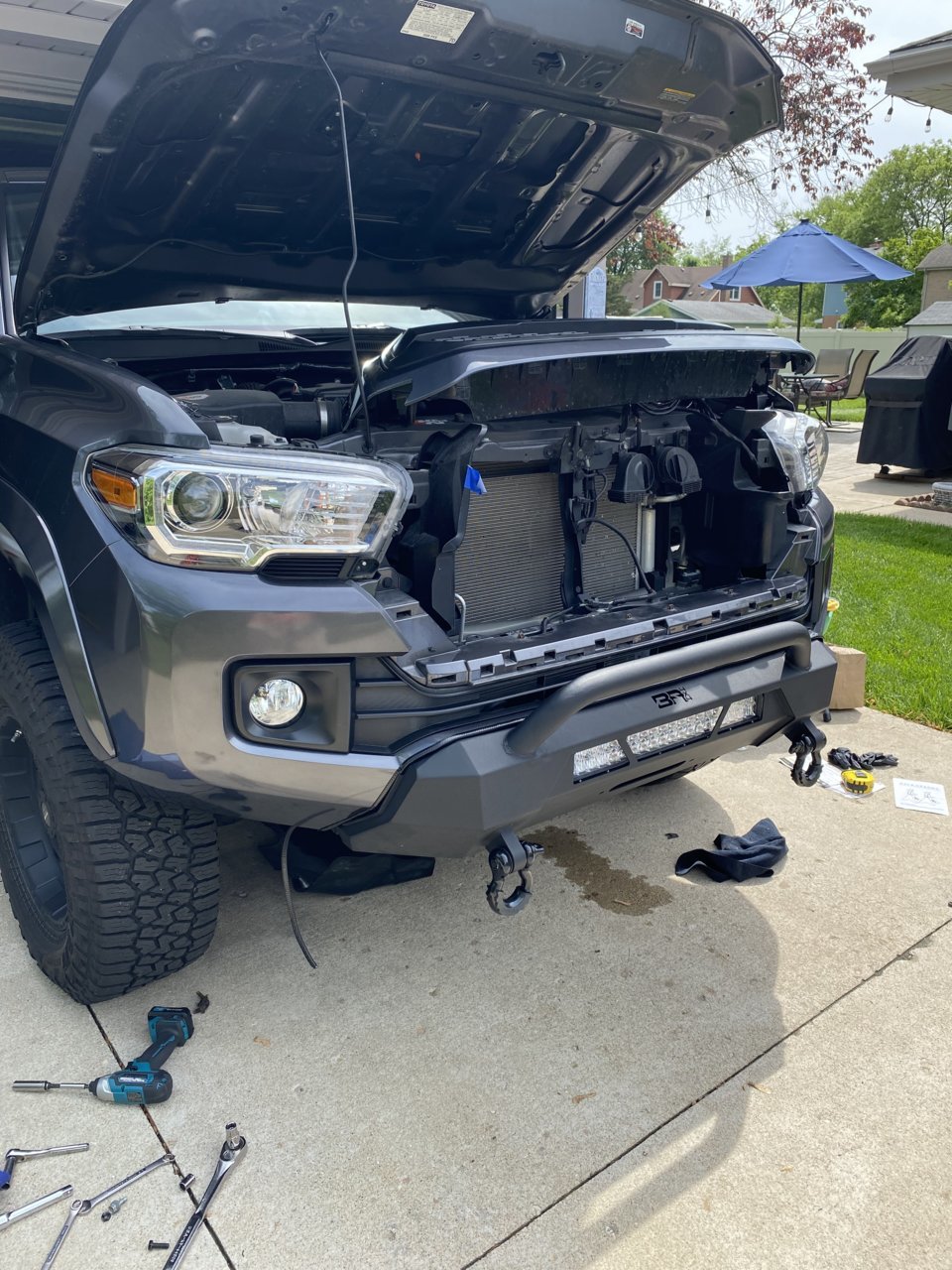

  1. Mar 31, 2022 at 3:56 PM
    #461
    orangeracer
    orangeracer Well-Known Member
    Jun 18, 2016
    #189889
    645
    18' DCSB TRD OR 4x4 w/6spd MT
    Which would you guys recommend is easiest install/least amount of modding needed, C4 or BAMF?

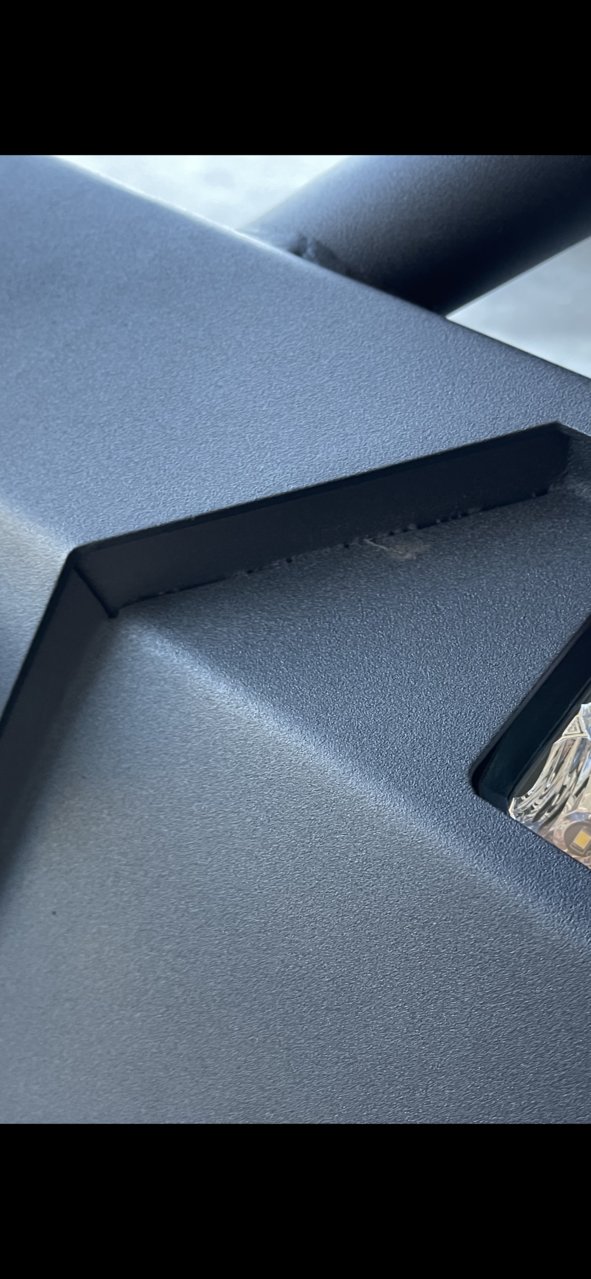

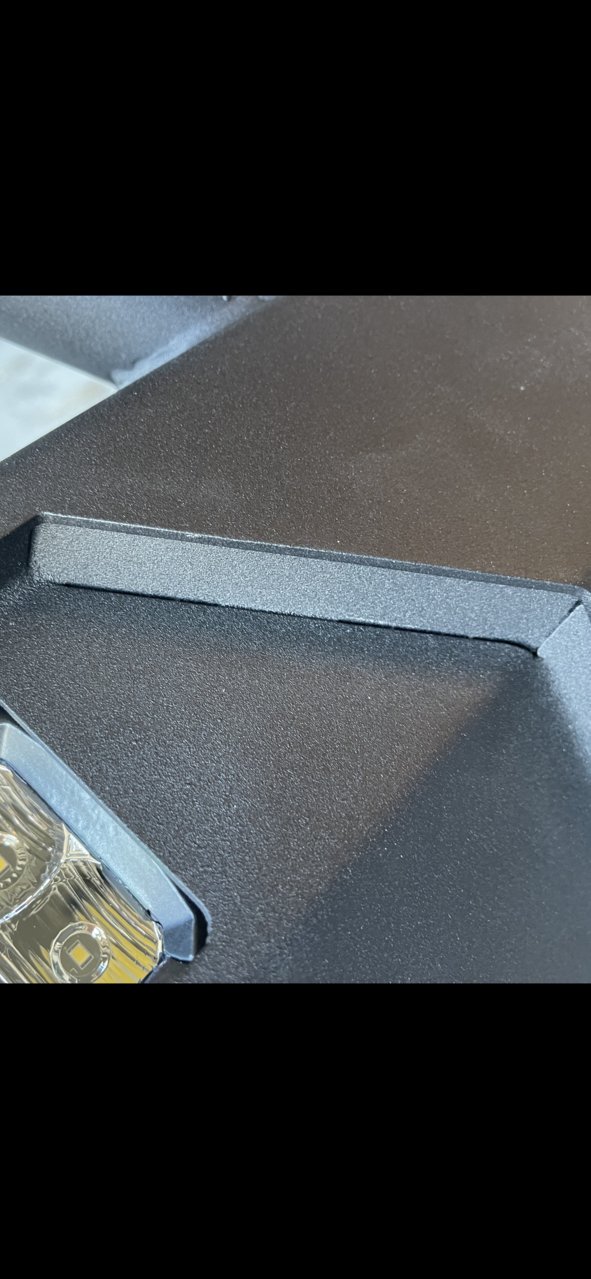

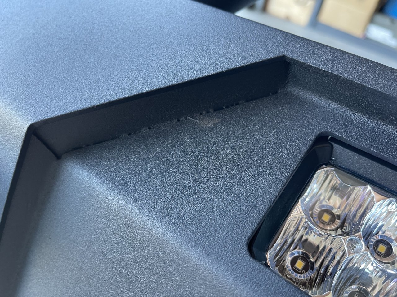

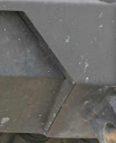

    I was in the process of installing when I noticed some fairly significant gaps in some welds does anyone have pictures of this exact area for comparison.
    EB0CCBAC-6D6C-4D37-A2D8-59328704830D.jpg 77D3FD55-93D6-43B0-9B8B-2C429FE5C4B4.jpg

  12. Jul 19, 2022 at 7:35 AM
    #472
    DosTacosPorvor
    DosTacosPorvor Well-Known Member
    Feb 1, 2021
    #354703
    126
    Brad
    Midwest
    19’ TRD Sport Dbl Cab M/T
    5100’s w/AAL, Dobinson's 314 coils. 285/70-17 BFG KO2's, 17X8 Pro-Comp 89's 0 offset, BA Highline Front Bumper, K&N FIPK CAI. N-Fab Podium steps, Gatorz Low Profile Hard tri fold Bed Cover.
    You’re good. Mine is the same! And Bonjour from France!

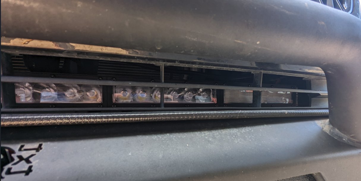

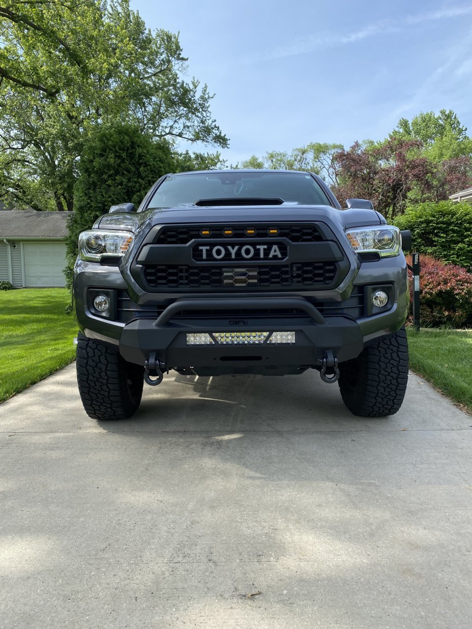

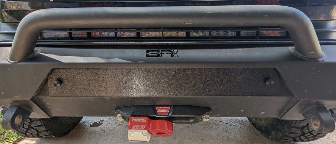

    Before I put this bumper on with a warn evo 10k winch, I was running a caliraised hidden light bar. The winch control box was too high and would not allow me to keep the light bar, so I bought a cheapo 22 in light bar to put in the bumper. I was never happy with the output.
    During the Diode dynamics 4th sale I picked up some new light bars to replace all my cheap ones. I completely forgot about the top bar on the bumper, until I went out to test fit.
    To my surprise the the light bar fits perfectly on the brackets and clears the top of the winch.
    The top bar on the bumper seems to impact the light output less than the grill itself. I have the combo, so the wide pattern is a little behind the legs of the bar but the output does not seem to be impacted very much.
    The output of this over the cheap 22 inch light bar and the cali double row is amazing. Still need to get the angle dialed in a little but am very happy with the set up so far.
    I did not like the opening on the bumper where the lightbar goes so I did a quick ghetto fab of some textured abs plastic, popped in a couple of 1/4 20 rivnuts and mounted the plate using some thumb screws. I will redo the cover plate at some point but am pleased with it thus far.

    looks good, how is it holding up, it's got good and bad reviews from what I read.

    The bumper is ok, it is holding up well for what it cost. There is some fading/discoloring on the powder coat seems to be the only issue, but it doesn't bother me that much. The bumper has been on the truck since 4-20-20.
    I will end up replacing it at some point in the next few years with a different style bumper.

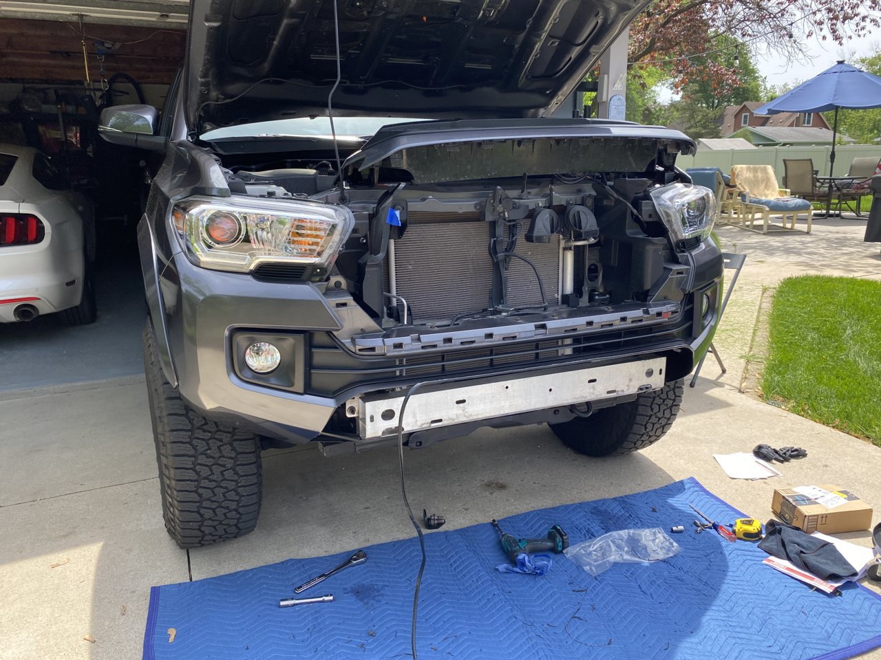

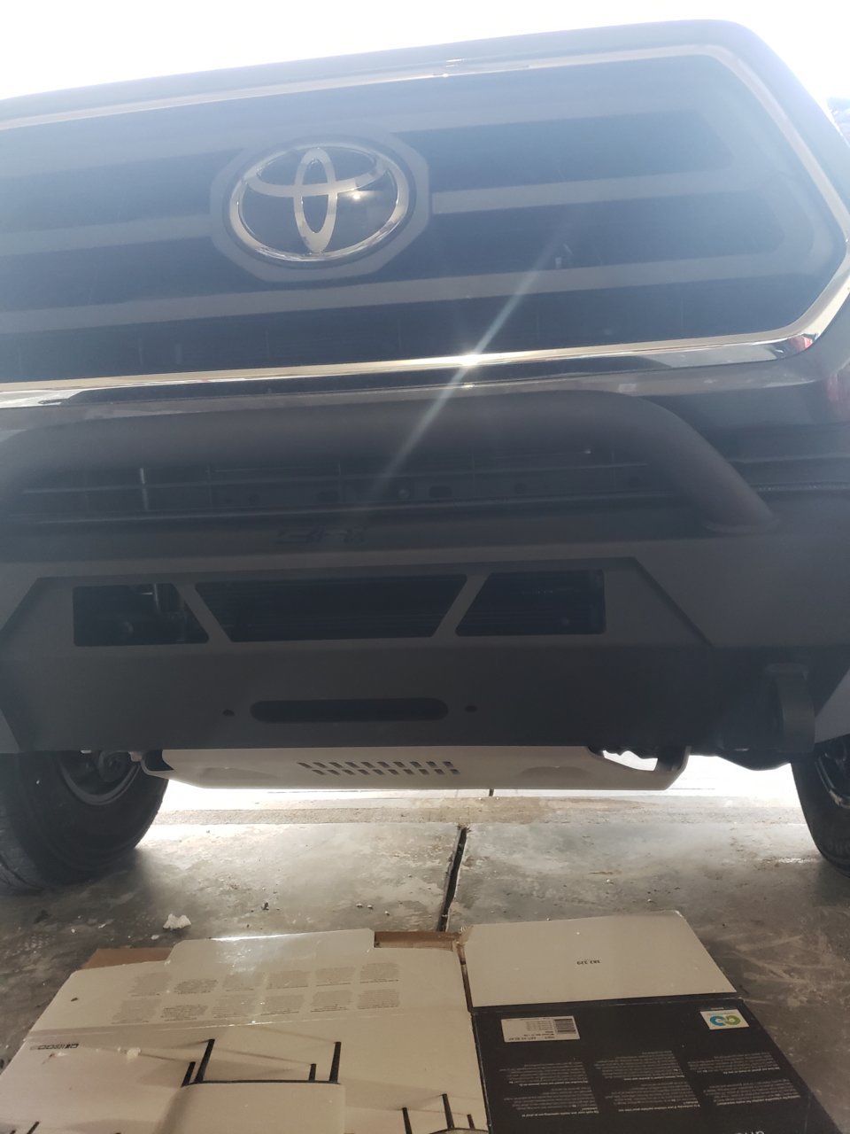

    Installed my bumper yesterday came out great, bracket to relocate power steering cooling unit was missing but made it work. but the question is the metal piece on the side should that be inside the bumper or outside of the bumper? it is angled like OEM bumper I wasn't sure about this. OP installation was outside but google picture was not shown?

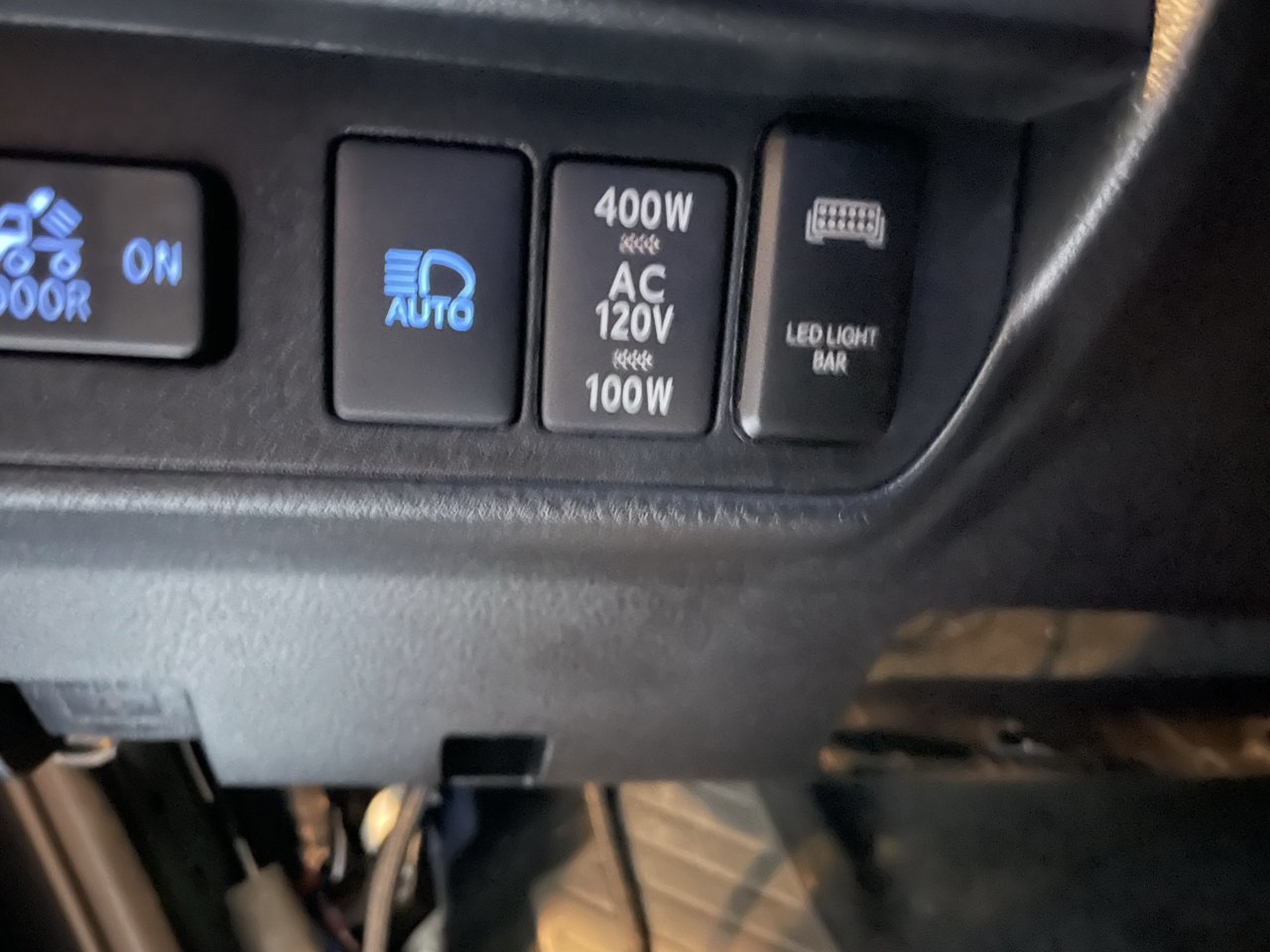

    Sorry if this is a dumb question but what did everyone do for the light control? Is it a switch that gets installed inside? I assume it’s on its own switch/control?
  19. Dec 7, 2022 at 3:51 AM
    #479
    Mikro
    Mikro Well-Known Member
    Oct 11, 2019
    #307708
    170
    2020 MGM TRD Pro
    I purchased a switch that went into one of the panel blanks. I forget where I got it from.

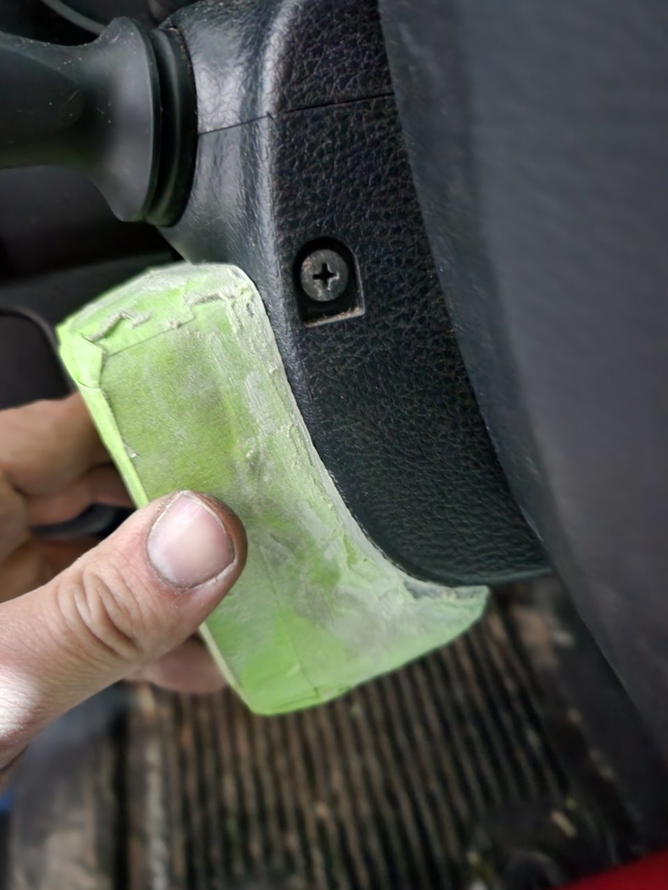

  20. Dec 7, 2022 at 9:27 AM
    #480
    CalvaryBlueTRDSportA.C.
    CalvaryBlueTRDSportA.C. Well-Known Member
    Jul 19, 2020
    #334986
    55
    Jordan
    '19 Cavalry Blue 6spd TRD Sport Access Cab
    Eibach suspension, nitto ridge grapplers (factory size with 1" spacers), Ripp coils, k&n blackhawk intake, magnaflow exhaust, magnuson sc, j&l catch can, optima yellow battery. ARB onboard twin woth tank ordered. ECGS front and rear with 5.29 and arb lockers coming next.

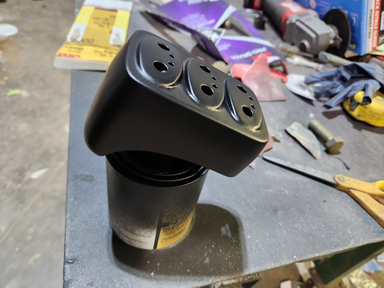

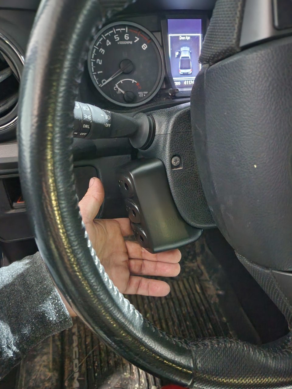

    Probably not the option you're looking for, but this was my solution for lighting with proprietary switches.
    I dismantled the proprietary housings and incorporated them into a custom glass housing to mount at my steering column with dbl sided tape. Wires feed under the column through the adjustment lever. Permanent looking install but no damage to factory parts.
