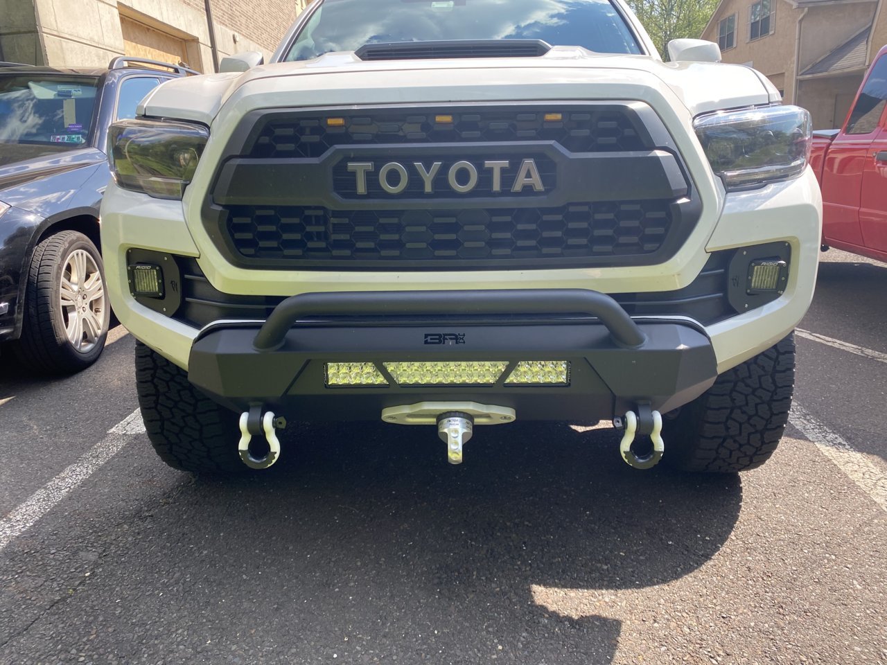

    i couldn’t get the aluminum bumper bar out with out dropping the plastic bumper down a bit.

    i installed mine with a Smittybilt X20 10K winch with synthetic line and a Rigid 20” lightbar. i’m on Bilstien 6112 set at 5/6 and i lost a bit of lift after the install. Going to upgrade to the heavier bilstien springs.051BD040-2609-4AD7-8B48-39ECAA18CCDE.jpg
