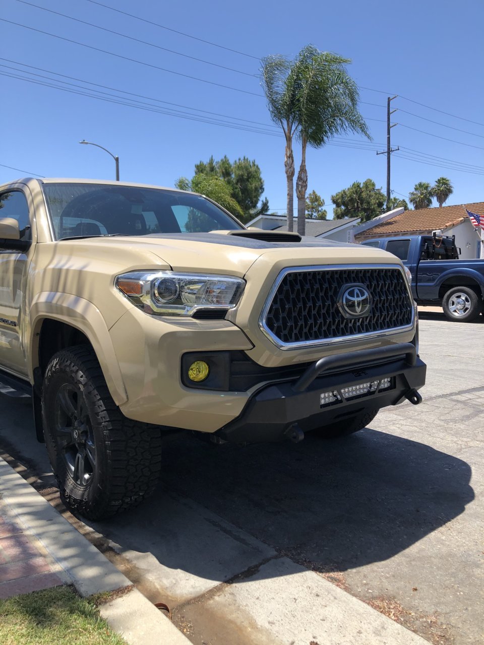

    B73B314F-9425-484A-93B1-5FEEBE90FB91.jpg 9FE95508-BAB1-4CD2-AE28-D851C8BECCC9.jpg
    here’s a couple shots don’t mind all the bugs she needs a wash badly.
    4x4Gaspar likes this.

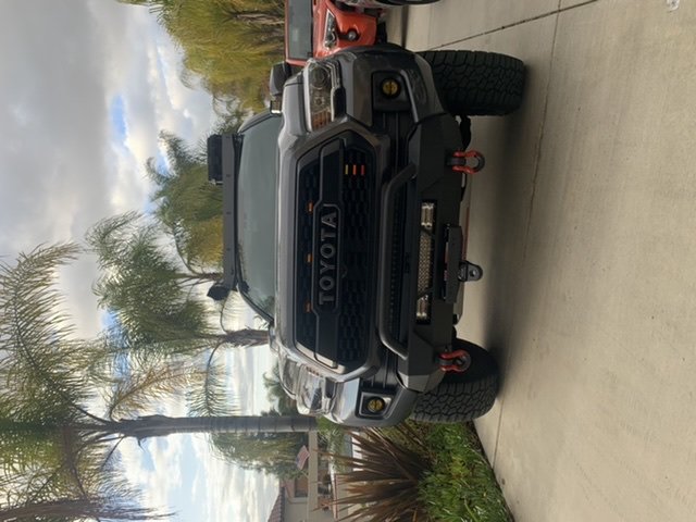

    Joined the party!! (she's dirty I know)
    treyfive likes this.
