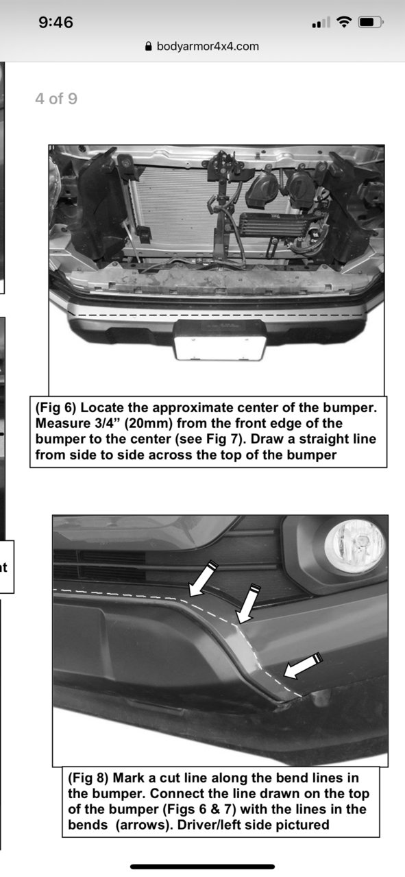

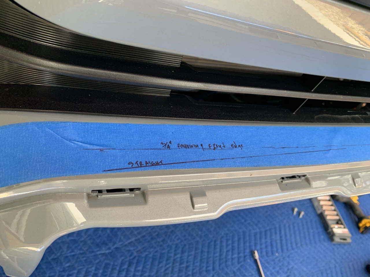

    Hey guys, I’m about to cut. The included photo here shows two lines. One is straight across, starting at 3/4” from the center of the bumper, the other line follows a parallel 3/4” all the way across.
    The instructions say to cut straight across, which would result in the very odd line you see in my photo.
    I’m assuming the curved and parallel line is actually correct and their instructions aren’t quite clear...? Also included.

    I would just cut it to their spec and cut more after if you have to and even if you don’t cut it perfect you can barley tell with the bumper and edge trim on

    The second diagram from body armor is on the money. It matches up with your top straight line. Your curved-ish line is not going to work. Take the straight line you already did and carefully look for the creases in the bumper like that second diagram to connect your line to.

    Do you have a pic from above? Also, how did you cut below, the line doesn’t follow crease once you go below the part that angles back. Underneath, that line stops.

    To cut below just go straight back and use that circle as a guide to where to cut. You can’t really mess this part up. It’s basically unseen.
