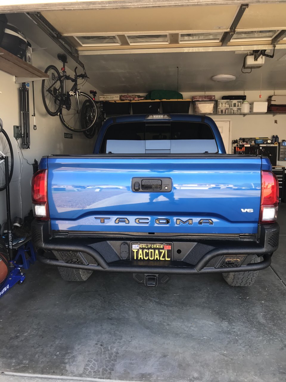

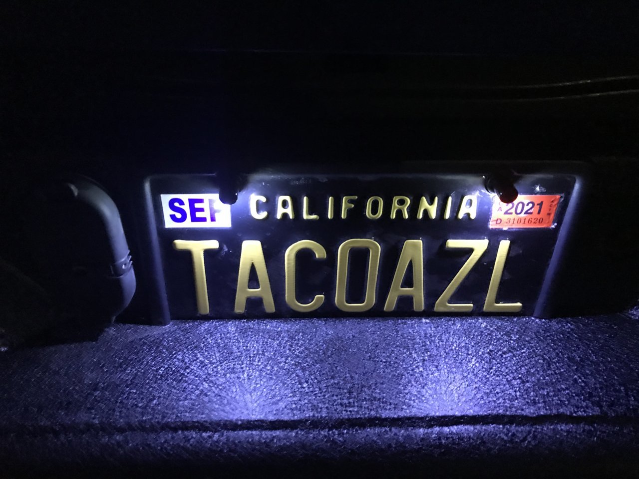

    099C330D-10F4-4859-8B67-65DA17EE63F8.jpg I went with led bolts for the tag lights. I will probably use that "fairlead" hole to run a 120 outlet from the one in the bed.

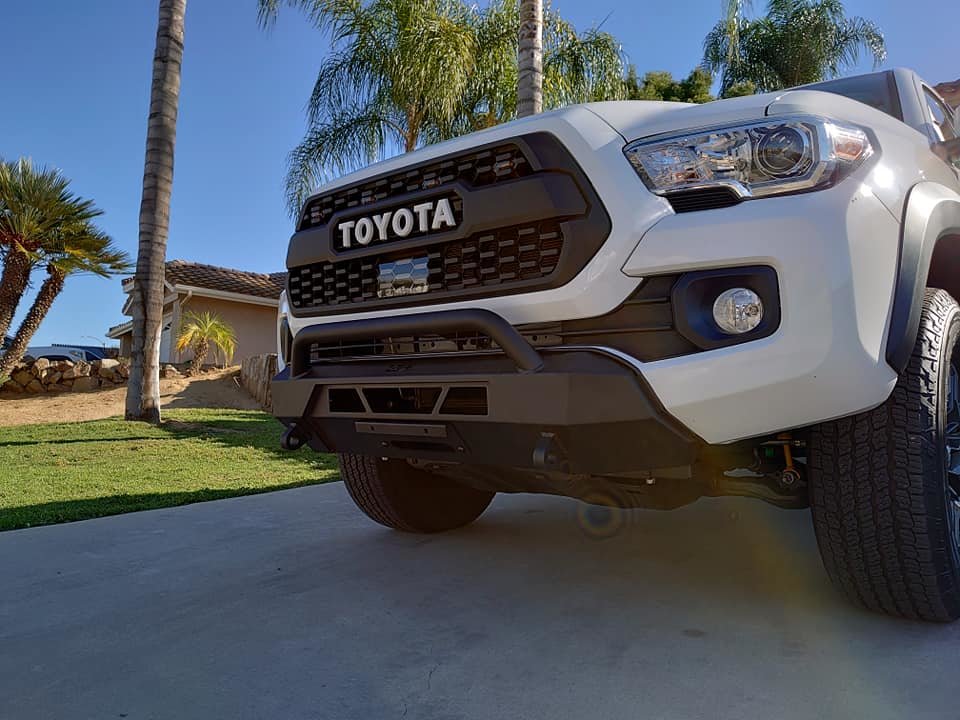

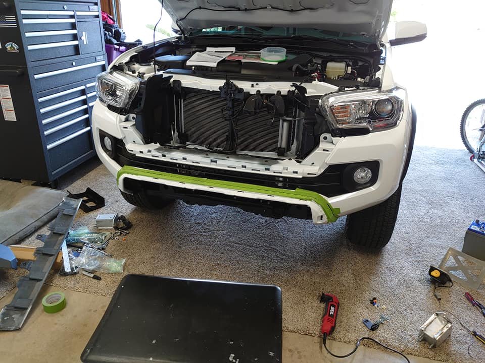

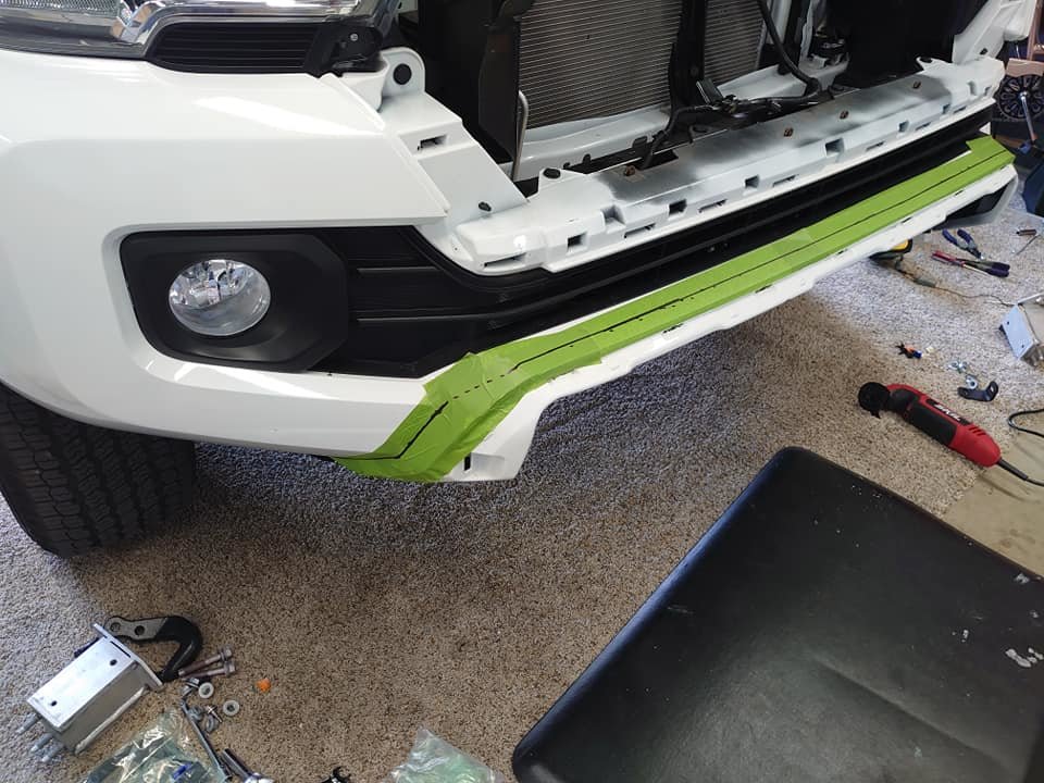

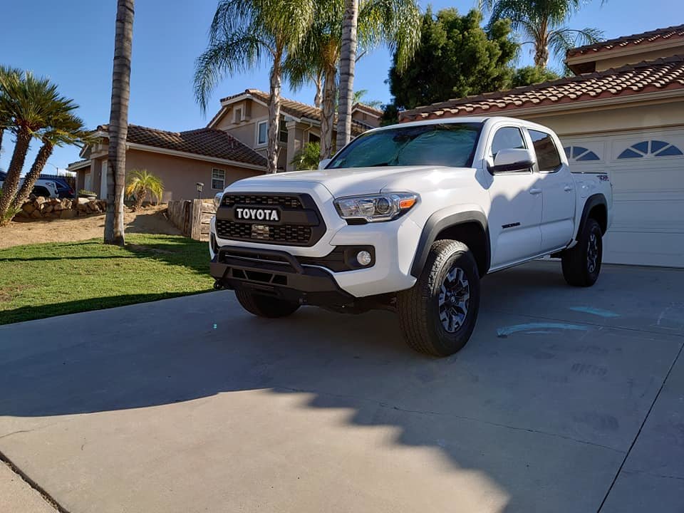

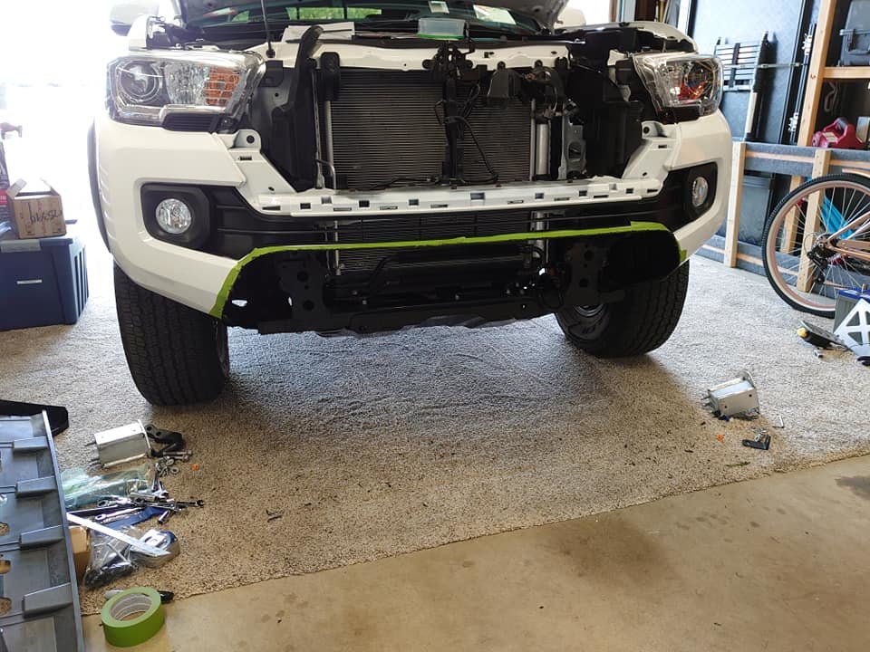

    I pulled the trigger on this bumper and installed it last weekend. This thread was a huge reason I decided to do it, so I wanted to share my photos in case it helps anyone else take the plunge. I think I ended up cutting a little too much from the sides, but it still looks great. There is quite a bit of metal still covered by the remaining plastic on the factory bumper after you cut, so the design is actually pretty forgiving if you make a mistake and cut too much. If anyone is in Southern California, there is a guy on Craigslist selling a few of these for $375 new in the box. That's where I purchased mine, and it was exactly as advertised with no funny business.

    It is definitely genuine. Came in the box from BA. The box was a little beat up, but the product inside was perfectly fine. The smaller box with all of the mounting hardware/plate bracket/rubber trim wasn't even opened. The guy's company does displays at the SEMA show every year. He had a few of these for that show from a few years ago, then they just got put back in their boxes and have been sitting in his storage ever since.

    Not difficult at all. It's about 3 to 5 minutes of the total installation process. The hi-line bumper comes with two small metal brackets. You simply remove the two bolts that currently hold down the cooler (both very easy to access from the front once the aluminum crash bar is removed), and then you attach the brackets with those same two bolts that you just removed (right back into the same holes). You do have to remove one more bolt which clamps one of the power steering hoses and prevents the cooler from moving around. You access it by reaching through the passenger side fender well. I didn't even have to turn my tires or anything, just reached right in and got to it with ease, although you may need to pop off the little floppy splash guard if yours is still there (it's attached with 4 little clips. I just popped off the upper right clip with a screwdriver, and pushed it right back in when I was done). With that bolt removed, the whole cooler is kind of loose and can wiggle around. You just push it backwards an inch or two and rest it on the threaded studs of the new brackets, then install the new nuts that hold it down. The bolt that was clamping the hose does not go back in.
