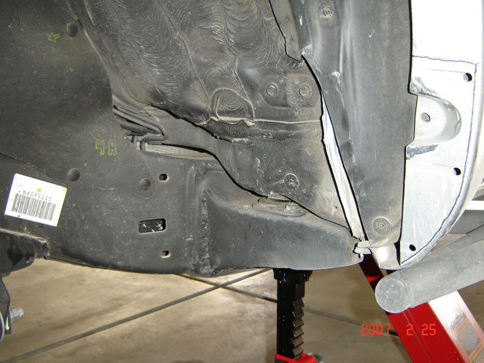

    It wouldn't hold water in there, but in the same region is the drain for what I assume is the rocker.
    cab mount is the black mount coming out from the frame 90* (above the jackstand)
    I can't for the life of me figure out where water would be especially if you pulled the plugs.
    I need to wash my truck this weekend to get rid of the salt and mud so Ill take a good look to see where any water could be hiding in yours.

    Thanks for info, I will check that tommrow. Great pics also!
