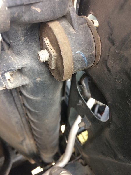

    Great write up! Quick question, the radiator support bushings are to replace the factory bushings pictured below correct?
  6. Dec 25, 2016 at 9:01 AM
    #206
    Sandman614
    Oct 26, 2010
    #45273
    35,895
    Tim
    Garner, NC/Boone, NC
    '06 SR5 Off Road
    Wrong ones. It's the ones holing the radiator core support to the frame.
    Crom likes this.

    You pretty much had your hand up against the bushing that gets replaced to take this photo lol

    Gotcha! Thanks for the clarification
