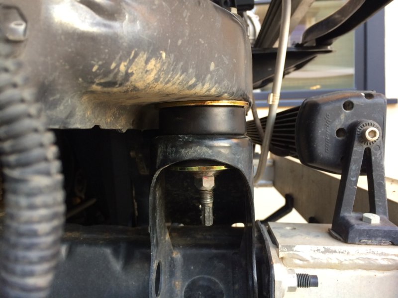

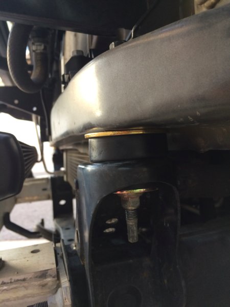

    Hey guys just did the radiator bushing swap for the energy polys and man what a big difference! My trucks has 50,000 mls on it and every time I'd park my front end would make a little metallic clink when going from reverse to drive to straighten out the truck...came across this thread and figured sh*t for 25$ might as well! The sound is gone and the truck feels much more stable doing little things like pulling over curbs and what not. I dont offroad too much but love to camp and drive some back country roads and this is what my bushing were looking like before:
    FRONTS ON LEFT BOTTOMS ON RIGHT
    AFTER INSTALL:
    PASSENGER SIDE:
    DRIVER SIDE:

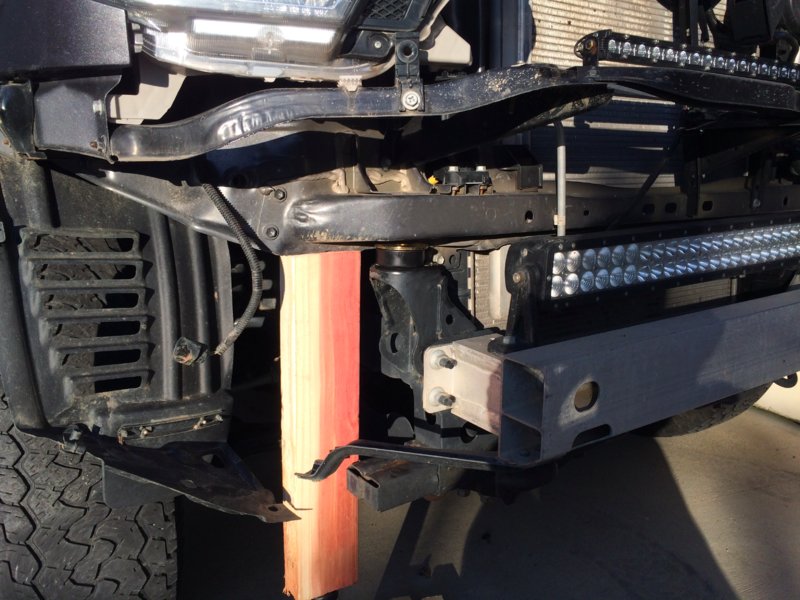

    Some woods helps! Once you get one side out do yourself a favor and take the bolt out the other side! Otherwise when you go to jack it up on one side you'll be pulling on the other end up as well

    Yea...and if you fail to remove the bolt (like me), you run the risk of binding a side and breaking a headlight bracket. Maybe others didnt have an issue, but I did. Just gives me a reason to buy some Depot's, reseal them and improve my current cloudy headlights. Good photos OP.

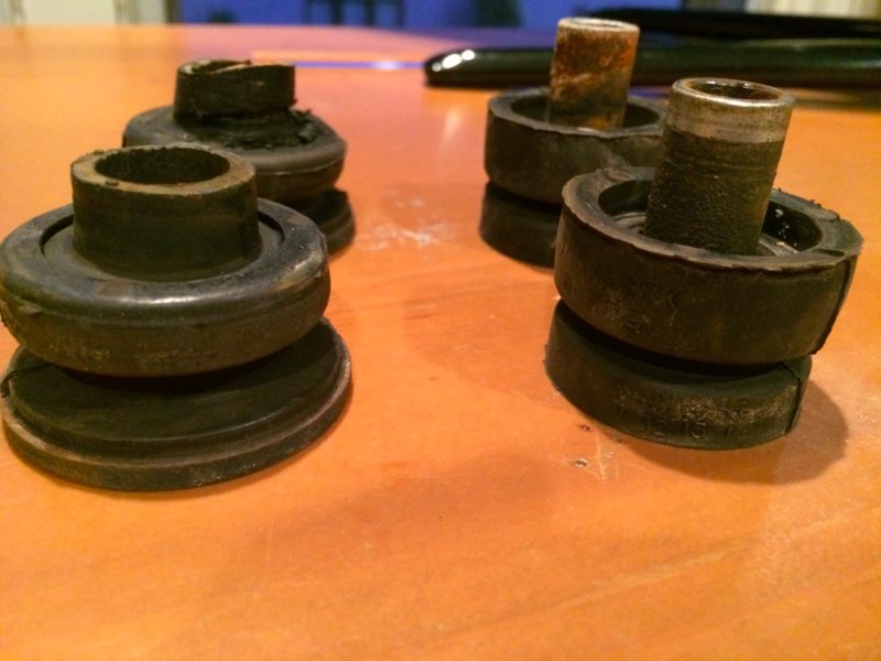

    Changed mine with 145000 miles and they practically crumbled coming out in pieces... Best mod I've done for the money.

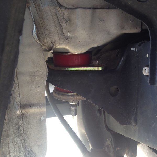

    After looking around the garage scratching my head, I found a use for the old bumper support(little brackets drilled off). Not pictured, I did use one 2x6 block to space it up a little further.
    Went with red to be different, and match my future Total Chaos LT bushings. Yeah, yeah, black ones have a "lube" quality to them. Well these are cab mounts and don't move so...
    My driver side radiator bolt was skewed to the side, preventing me from easily inserting the sleeve from the bottom. After raising and lowering the body a few times to try and take weight off the bolt, I finally had success by using the jack and a block of wood as a reverse press and the sleeve slid right in without damaging the bushing.
    The rears weren't tightening down all the way. I think the main culprit was the thread of the bolts were gunked up with corrosion above where the nut used to sit with the factory mounts, so I figured I needed a washer. Looked around and decided to use the lower plate washers from the factory mounts. Snugged right up, good thread protrusion. Went ahead and did the same on the fronts just to match.

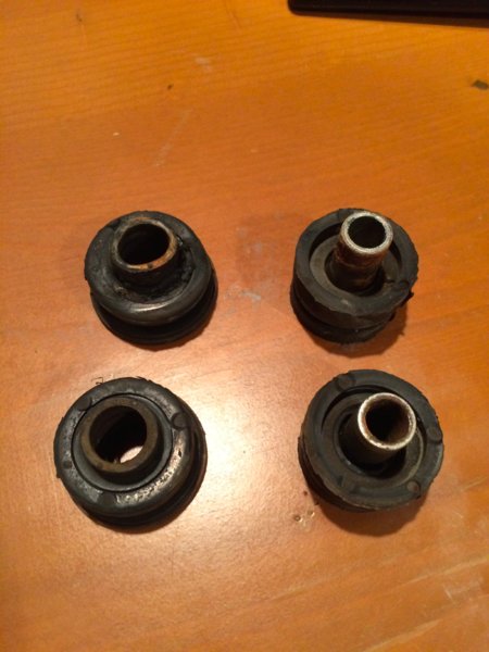

    i bought the whole kit today i tackled the body mounts
    front radiator support mounts mine were easy to get to because of the aftermarket bumper
    yup they look a bit torn 135000 miles
