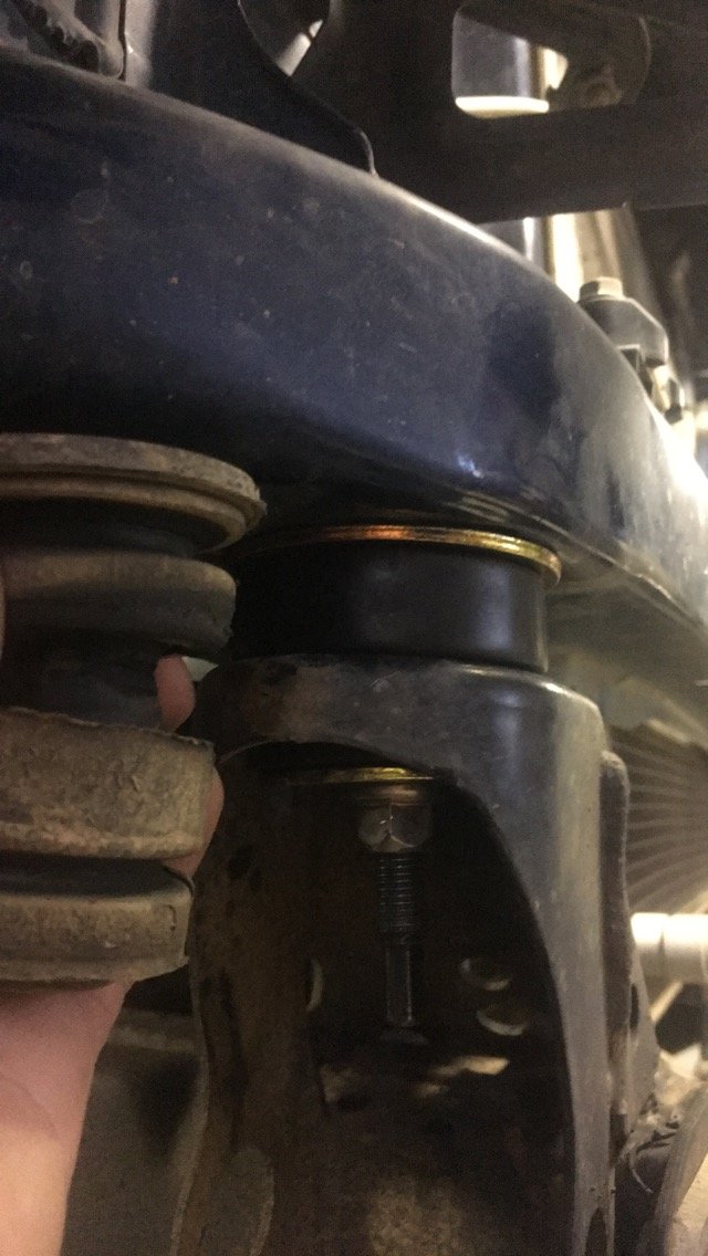

    I did large washer small poly on top. No issues, maybe flip the poly.

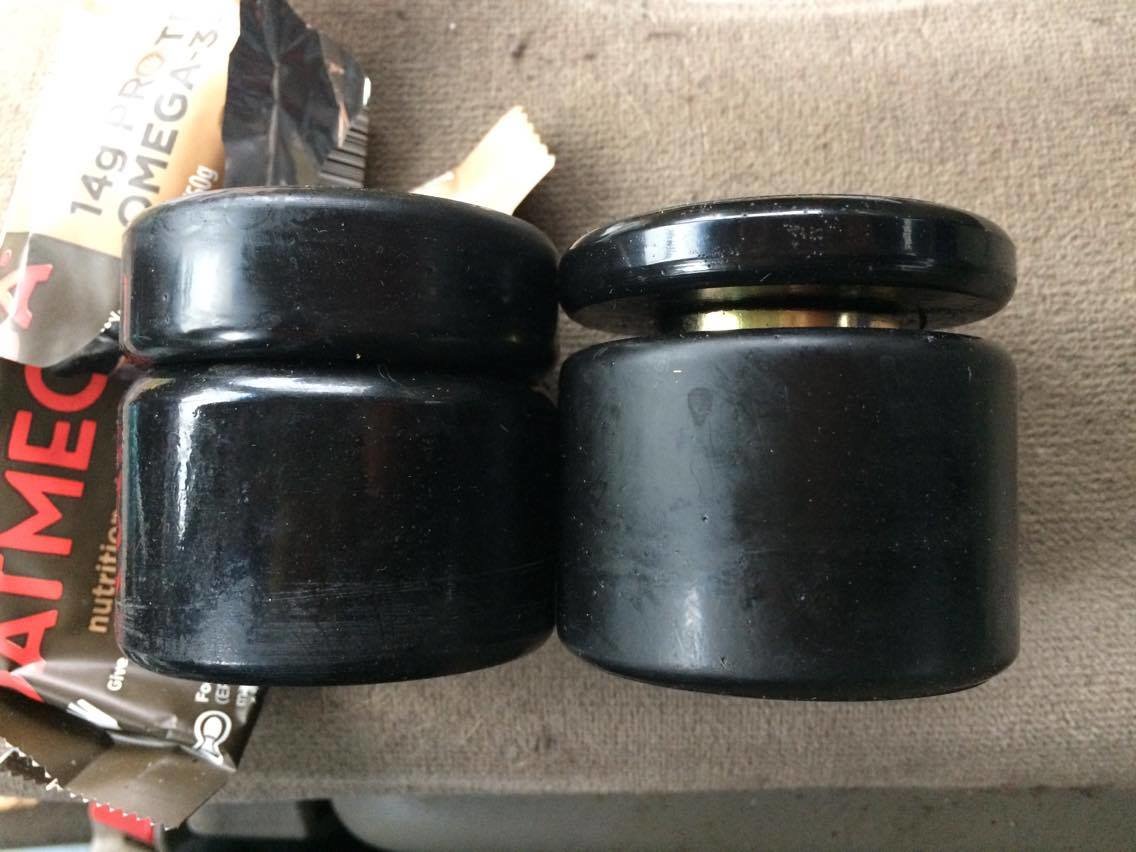

    Flipping the bushings fixed my issue.
    From top to bottom I have new OEM bolt with captured washer, body, big washer, small poly, frame, big poly, small washer, new OEM nut.

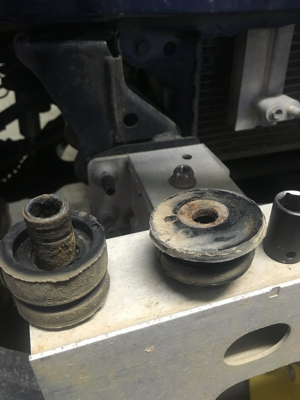

    Ok. Well the pic I posted is the position 2 (left) & 3, 1st gen. Apparently there is a method behind the madness for why the overall height of mount 2 & 3 are the same, yet the individual bushings are varied in height. Position 2, the one on the left, if installed per directions, would have a thicker top bushing than position three, but a thinner bottom bushing. Again, why? Wish I knew right about now because in my logical, yet thoroughly confused mind, since "they" seem to want a thicker bushing for position 2 top, than position 3 top, if I were to flip the mounts as is, this would no longer be the end result. With the bottom bushings on top as is, position 2 would be thinner than position 3. If I switched the mounts & put position 2 in the 3 position, it would then be the thinner top mount, which seems to be what energy suspension wants for the 1st gen. & I am not sure that made any more sense or if I just stated the same thing just using more words. I routed around in the first gen & online with no luck. I was tired though.
    If I were to flip these & switch the positions, there is the difference in the space between the bushings. Position 3 cannot be hand compressed to where it shows no metal, as can position 2. While I understand the frame would be taking up that space, again method behind the madness? I suppose though, if I were to flip, whether I switched positions or not, the bottom ones can be easily-er played with later.

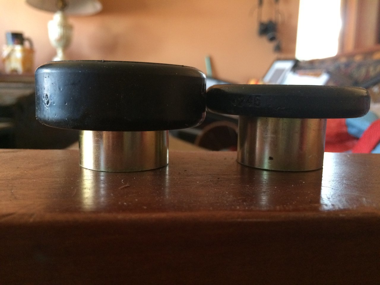

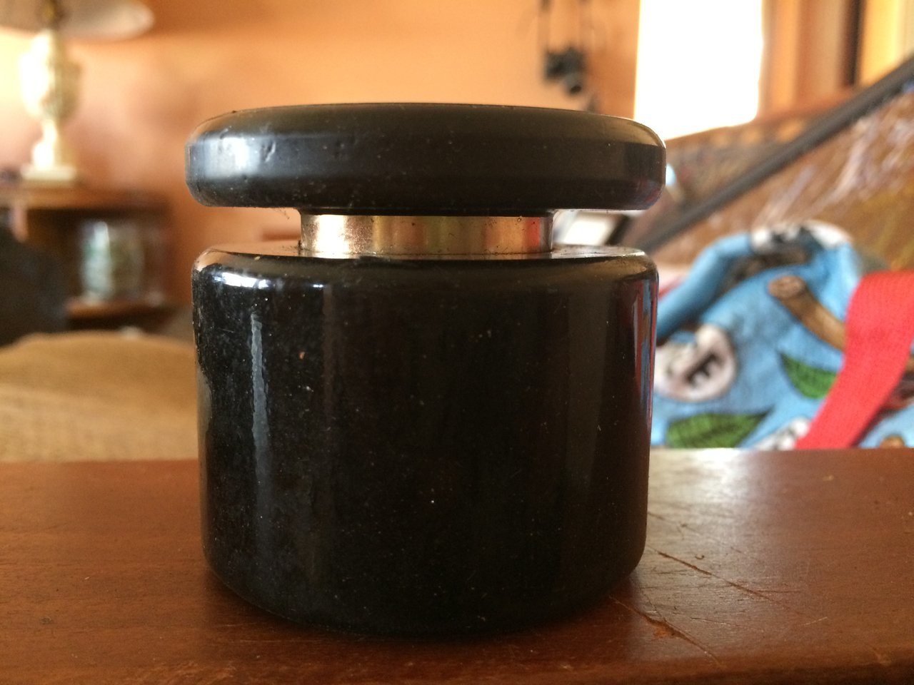

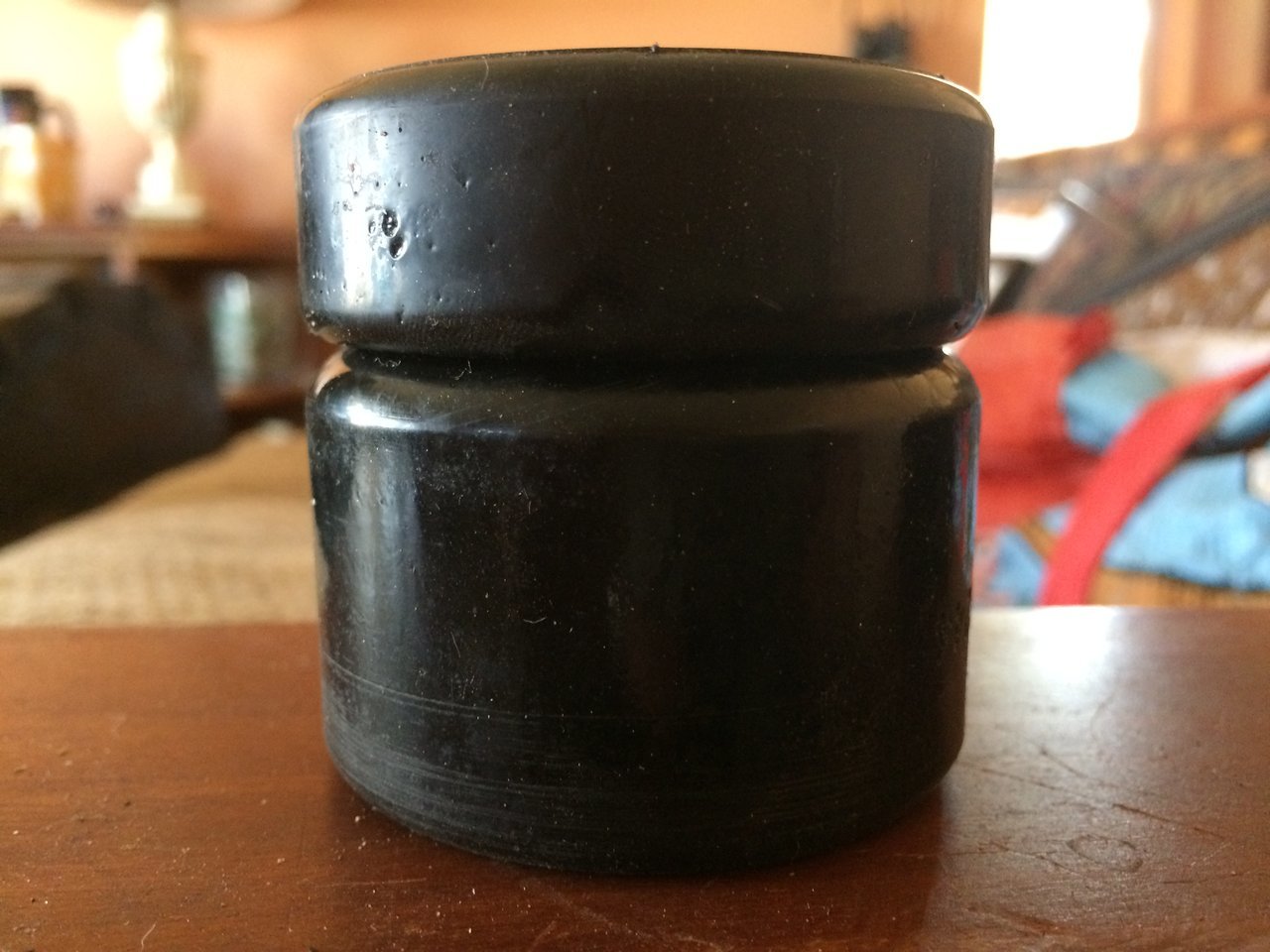

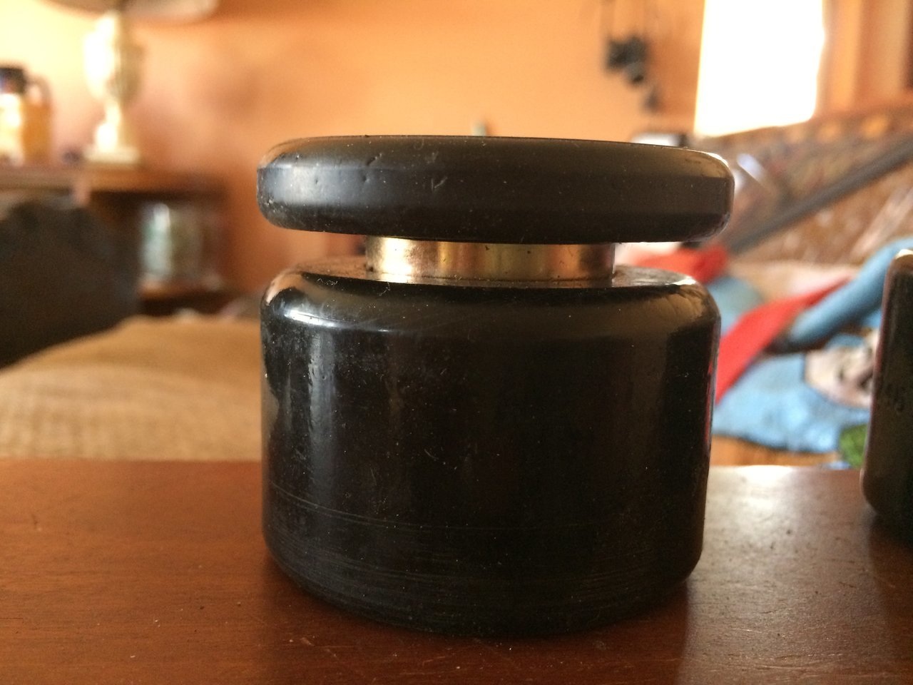

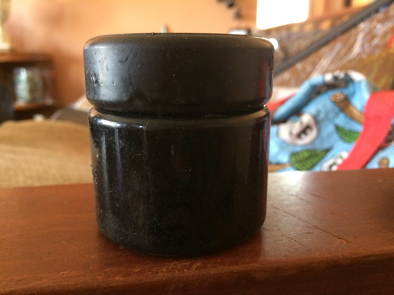

    There are three sizes. 2 radiator, 2 middle, 2 back. So hmmmm, I guess I might have to look at that as well. The two in the middle are 2.275. Back are 1.96.
    Regardless, the metal you can see in the position 3 mount is not the sleeve. It is the part of the top bushing itself.
    Middle rear top bushings - note difference in metal height
    It makes no dif if it is on the middle bottom bushing
    Or rear bottom bushing, that space is there.
    It is not there for the middle top bushing when it is paired with either bottom bushing.
    Question is why is it there & will that matter if I switch the entire mount to position 2 - middle?
    I am not necessarily expecting you to have the answer, although that would awesome, do much as hmmmm.... ing. Now I suppose if I need to make sure the 2.275 sleeve is in the middle, well, that's sort'a going to delegate where things go. Eh?
