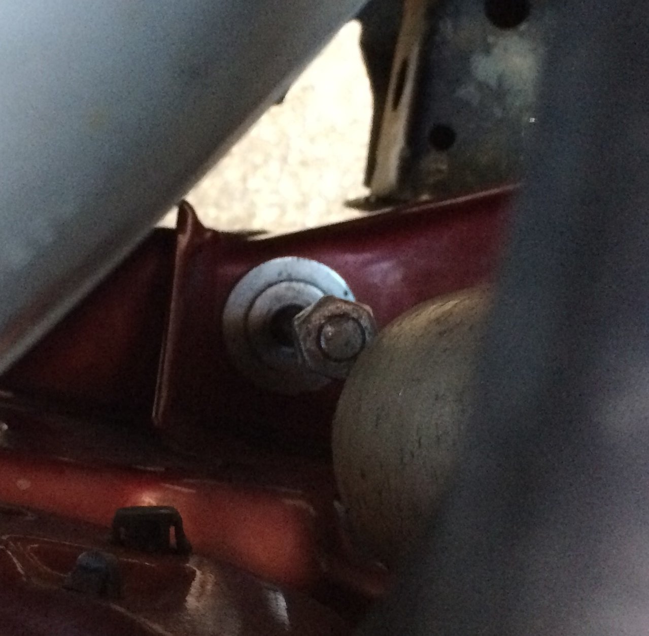

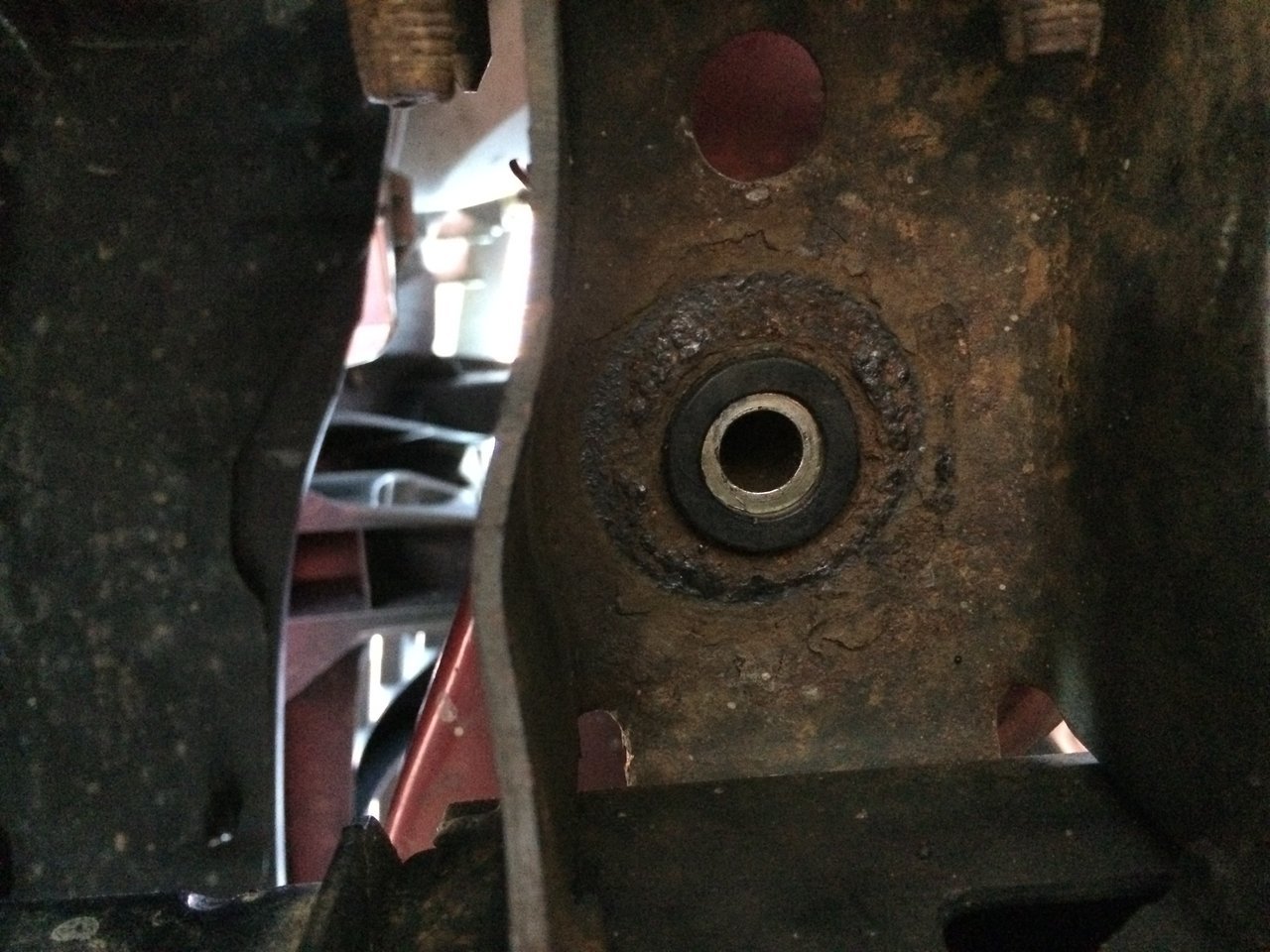

    I might have a big idea, but welcome something bigger.
    From the top. The bolt can't come out any further. If it could come out that would most likely solve the problem. Although then I'd have to get it back in....
    From underneath. The sleeve is so jammed up that it is flush with the bracket. Nothing to grab hold of.

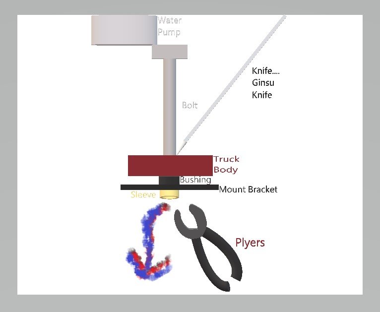

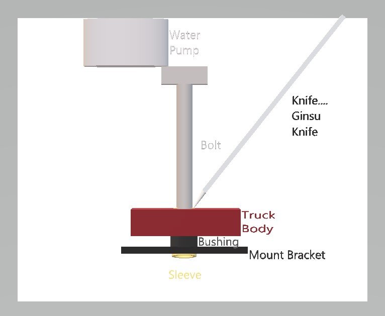

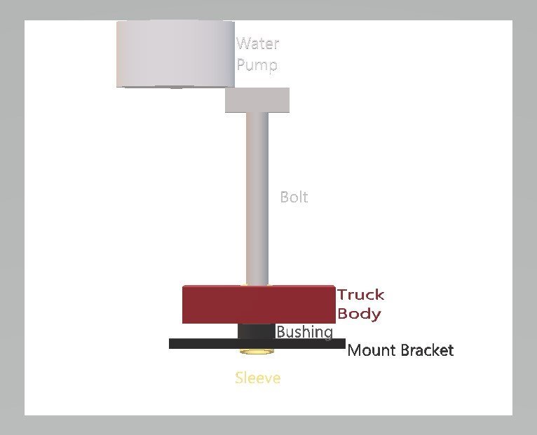

    No. This is it without being jacked up at all. The bolt clears the top bushing, so if the sleeve wasn't stuck in there....

    This is my big idea - I was hopin' you'd come up with a bigger one.... You still might.... :fingerscrossed:

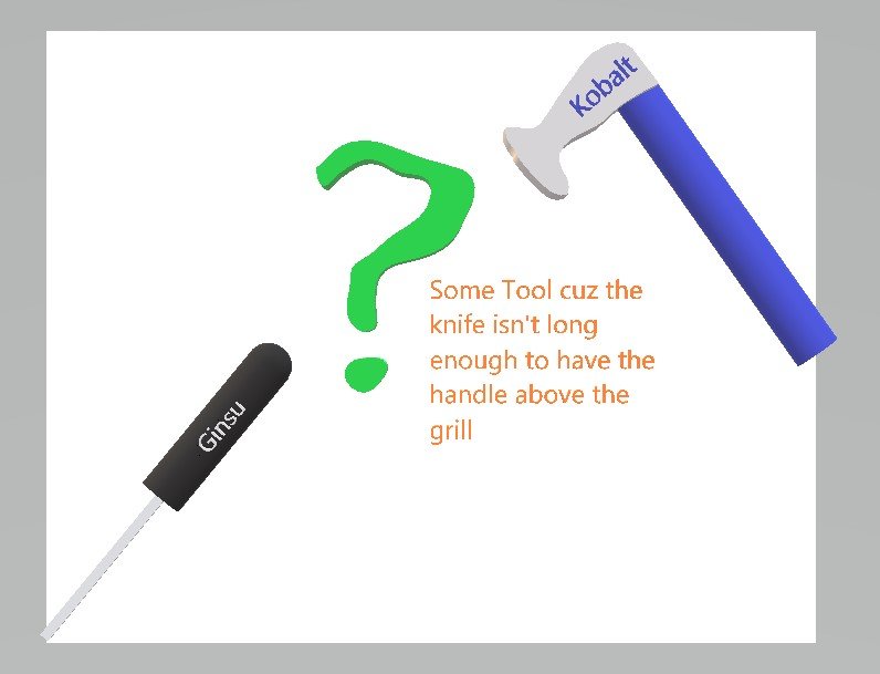

    How about a long screwdriver? Ginsu knives fuck people up.
