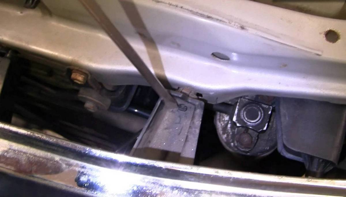

    Has to have a super thin, pointy or flexible, in that it can turn corners or round circles, tip. The Ginsu is super thin & pointy. Also flexible, but can't round circles. That would be the ideal. If I had something to wrap around the bolt that was super thin, yet would keep it's shape under pressure. Then crank down on the bolt.
    If my idea doesn't work, it's gonna have to be bolt cutters. I'm not dismantling a bunch of stuff to get at it.

    Got any old pipe laying around that you could hacksaw and put in there to tighten the bolt down on?

    Sorry. Missed the notification for this. Nothing thin enough. That was more of a big idea pipe dream :) "Hey! I know!" .... Then a few minutes later of seriously scanning the odds & ends in the garage slowly it dawns on you that the likelihood of finding anything that would work in the garage, never mind at a hardware store or the guy up the road who's been doing this for a bazagillion years, is next to nil....
    Think I got the fix though. I'll let you know. I just typed it out & then lost it & I was rambling anyway cuz I am tired, so I am signing off.

    So finally last night I decided to look for a pic of the thing in my way (too dark to take one of mine). I posted it to the other thread I asked for help on cuz there were three of us posting & confusion as to what the part was was requiring clarification. Anywho, while I really knew somewhere in my melon that it was not the water pump, I still named it that? Not my style, but I was on research overload. Not an excuse, just a reason. Next time I'll ask first. Anywho, I wanted to get it straight & call it what it is, so posted & now I have a fix. I was nervous about detaching said misnamed part yesterday cuz it's hard-tubed in. I guess if I undo the bracket bolts I can lift it, hopefully enough, & clear the bolt head.
    Wish I had thought to post this pic sooner. You probably would'a had the solution in a jiff....

    Did you get it?

    Yes! I tagged you in the other thread.... You get it?

    Well all went according to plan, which is of course, make it up as you go along, improvise, improvise, improvise....
    Story time -
    So once I removed the ac reservoir bolt (by breaking it :( ) I found that the mount bolt hole was just big enough for the bolt, in other words, no edge of the sleeve in sight so I could not "simply" drive the sleeve out. Think, think.... aha! I found a big ole drill bit that's a pinch wider than the bolt. Then since the hole was down a foot or so behind the grill I needed something to extend the bit. Think, think, think, think.... (this one took a little longer) aha! I took the middle section of my truck jack kit handle & inserted the bolt into the open end of it & clamped it in. It held good & I drove the bit into the hole, widening it just enough to be able to drive the sleeve through & grab it from underneath. Of course the bit was stuck now. Only needed one "think" this time cuz the bolt was right there & was the perfect size to drive the bit up & out. & for now, the ac reservoir is wired in. Oh, & the hood is giving me more guff than usual. PB blasted it, used the screwdriver to reset the hook.... no luck.... funny, out of all the hiccups along the way, this is the one that got me to uttering full sentences made up mostly of words I don't typically use.... anywho, guess I best see about a fix for the hood.
