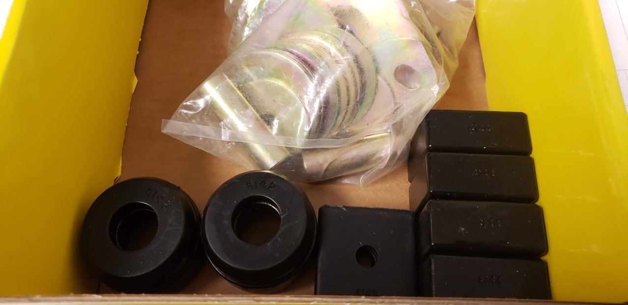

    Finally ordered these off Amazon after having them in my cart forever....
    Box is labeled correctly (8.4109G) but every single polyurethane part is off by one digit.
    Instead of 4241, they sent 4141. Instead of 4244, they sent 4144.
    Caught it right away as they're square instead of round. Energy Suspension guy said it looks like they're for a Subaru or something o_O

    But are they just as good as OEM or better?

    Looks like they got it right this time :thumbsup:
    Now to scour this thread one more time for all the little tips and tricks.
