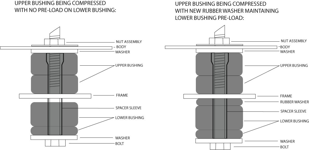

    I am going by "front" you mean cab & not rad.... If so, I would ask someone to put their hand on the bolt head as you are driving. They may/should? be able to feel if there is any vibe. Also, I have read some stuff about pre-load & knocking/clunking, the solution being to add 1/4 inch spacers (I use neoprine washers) on top of the bottom mount. & I am sure you are torqued to specs, etc. My mounts are funky, or rather, my truck is as far as how the cab sits (I have the opposite of the tacoma tilt) & a botched mount install caused problems, so I am becoming anal about keeping an eye on them, measuring body to frame, frame to pinch weld, etc.
