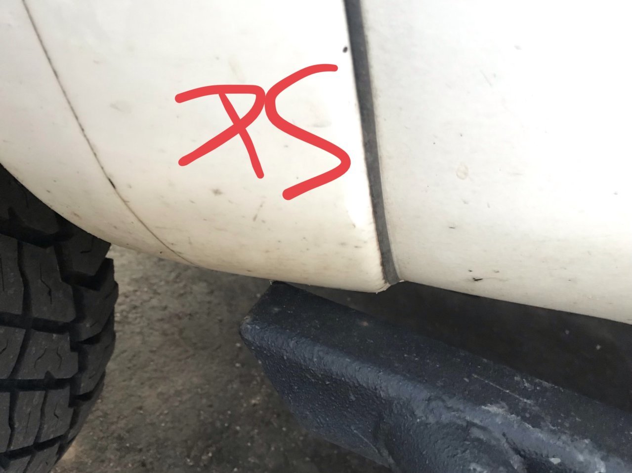

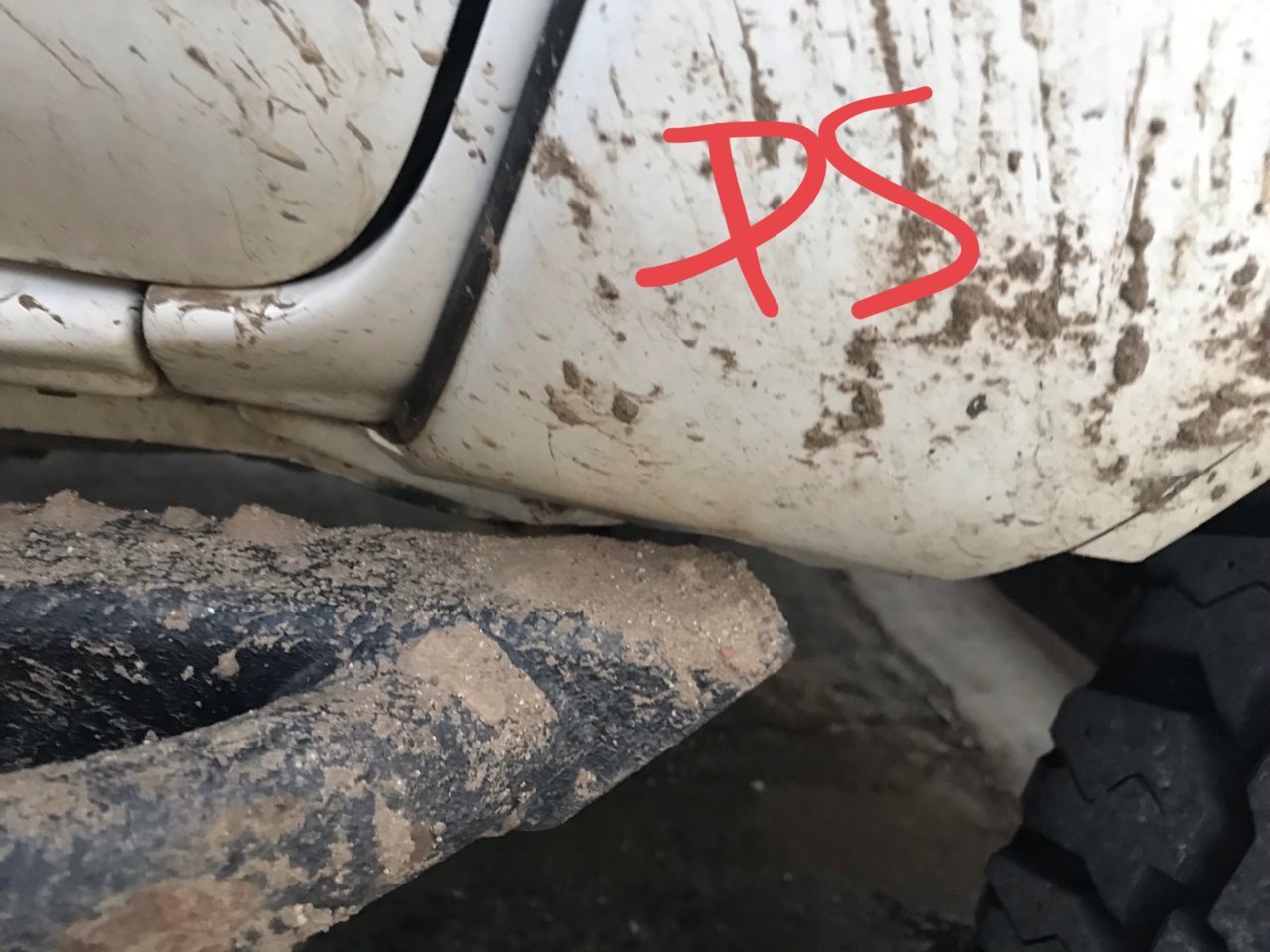

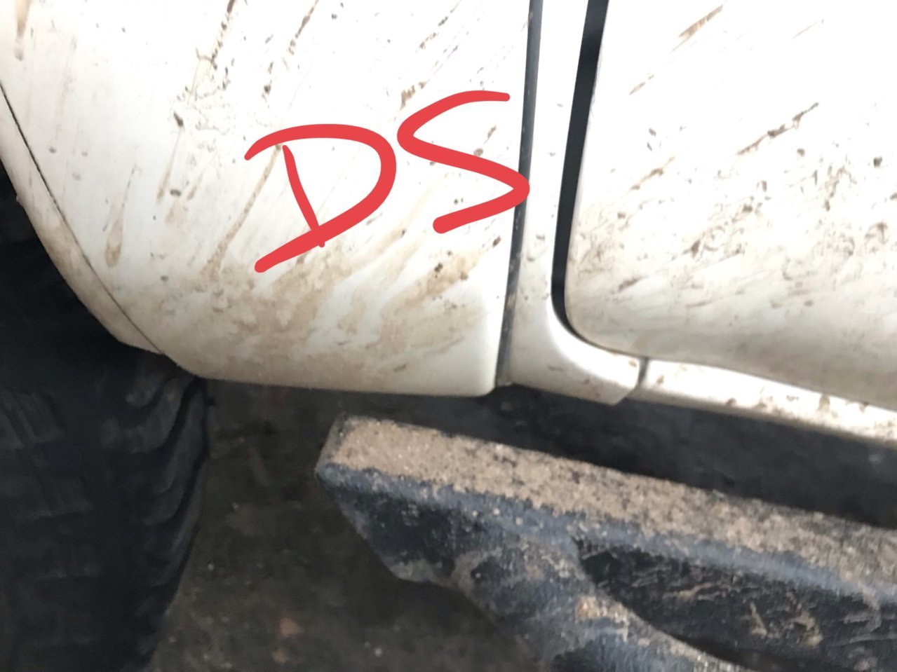

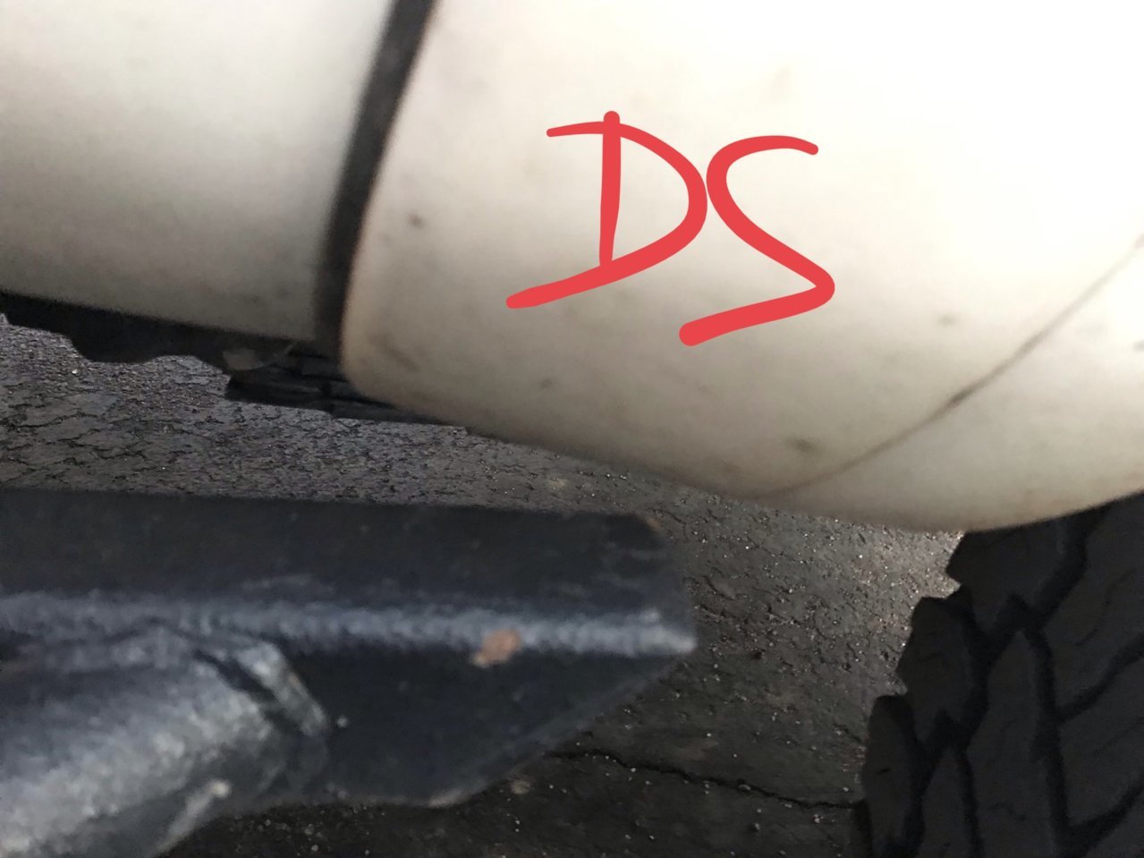

    I have an issue where my passenger side slider is touching my fender when my driver side is not. I wheel fairly hard and use my sliders so what are the chances that this is a cab mount bushing issue or a bent slider issue? Below are pictures front and rear of driver and passenger side sliders.

    Also, check to verify your bed is still mounted squarely.

    This wouldnt affect the front tho.. so what makes you think this would be an issue? Seems drastic

    I was just thinking if the cab/bed gap was not even side to side, the bed could have moved slightly.
    It's easier to adjust a crooked bed than bent sliders or frame.
    I am not saying the bed has moved, just check it.

    Ahhh it is on both rear and front on pass side. So I dont think it is a shifted bed. However, that is a valid point and I will inspect the bed.
    I also doubt the frame is bent. It is either the bushings are giving or the slider is bent. I will put my money on bent slider because well wheeling and these arent the best sleeeeeders. I wonder if there is a way to measure the angle of the sliders

    The bushings will only help up front. Judging by how close the rear fenders are to the sliders, I'm guessing you bent your sliders a bit. The compass app on most smart phones has an inclinometer to measure angles too, or there are plenty of free apps to download.

    So i did measure and confirmed that I bent my sleeeder. so I am opting to not go through the trouble to replacing body mount bushings... its cold in CO rn ha
    Thanks for your input! The level in the measure iphone app was a good idea
