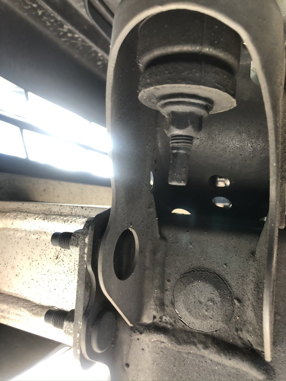

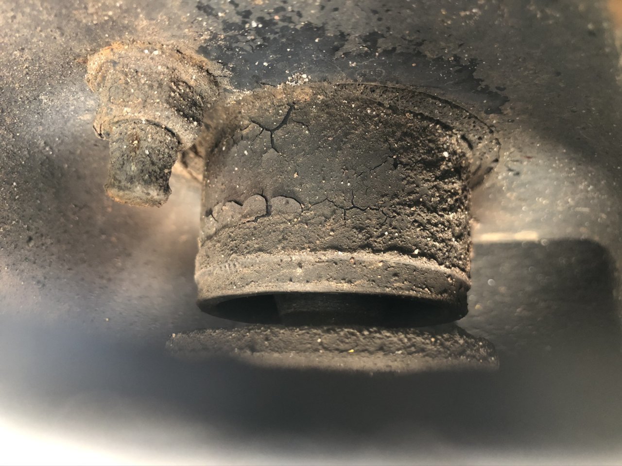

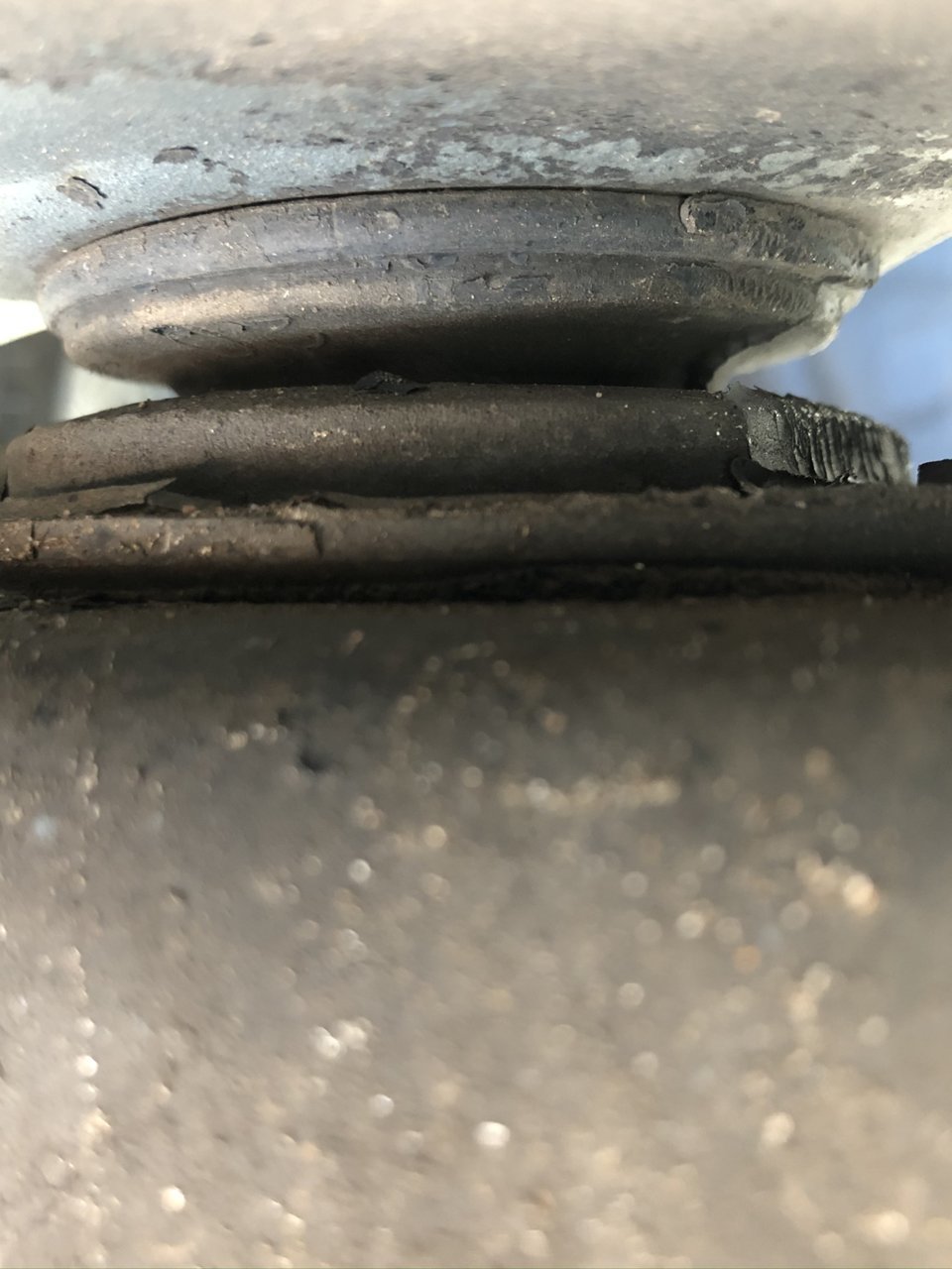

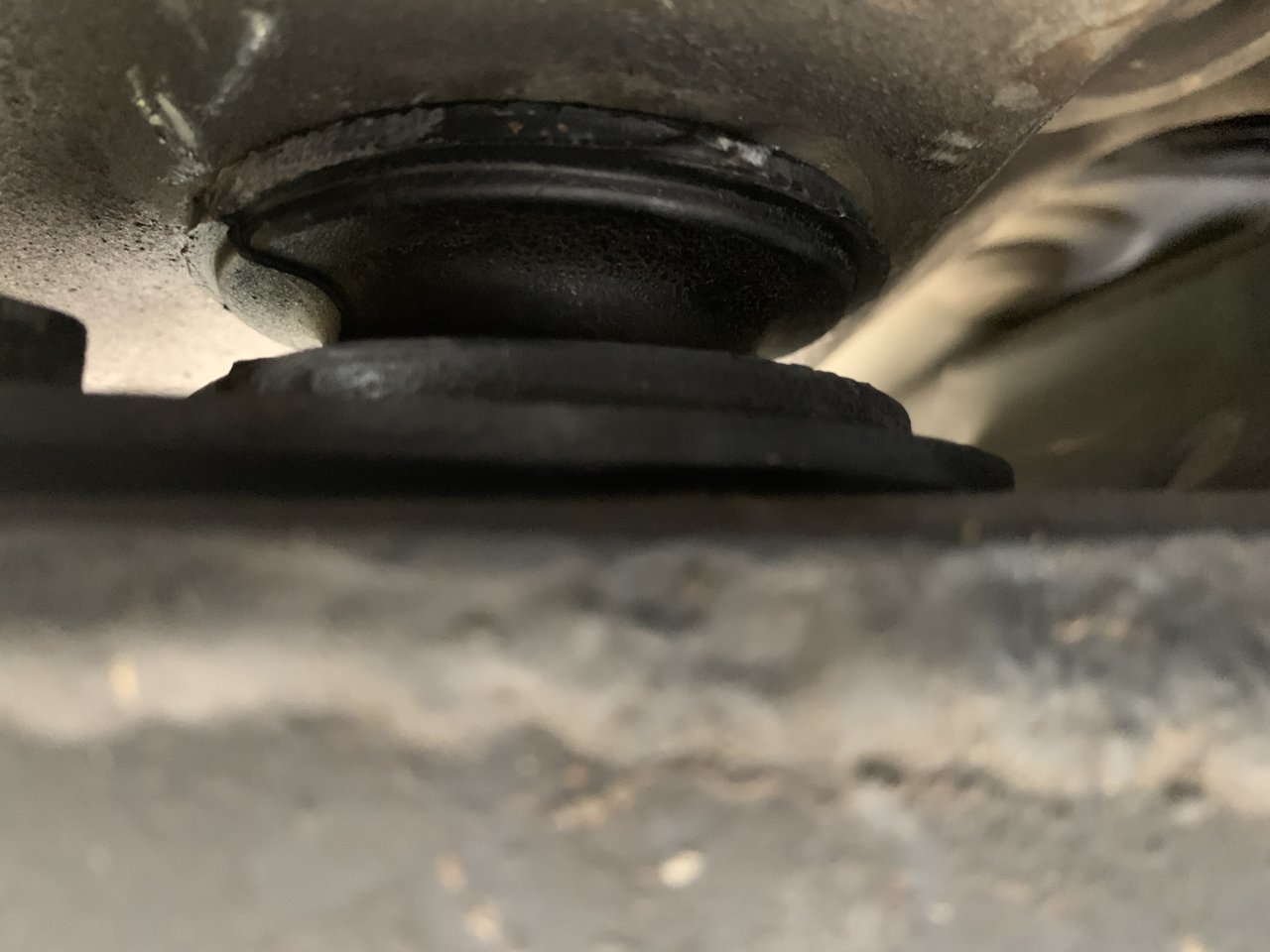

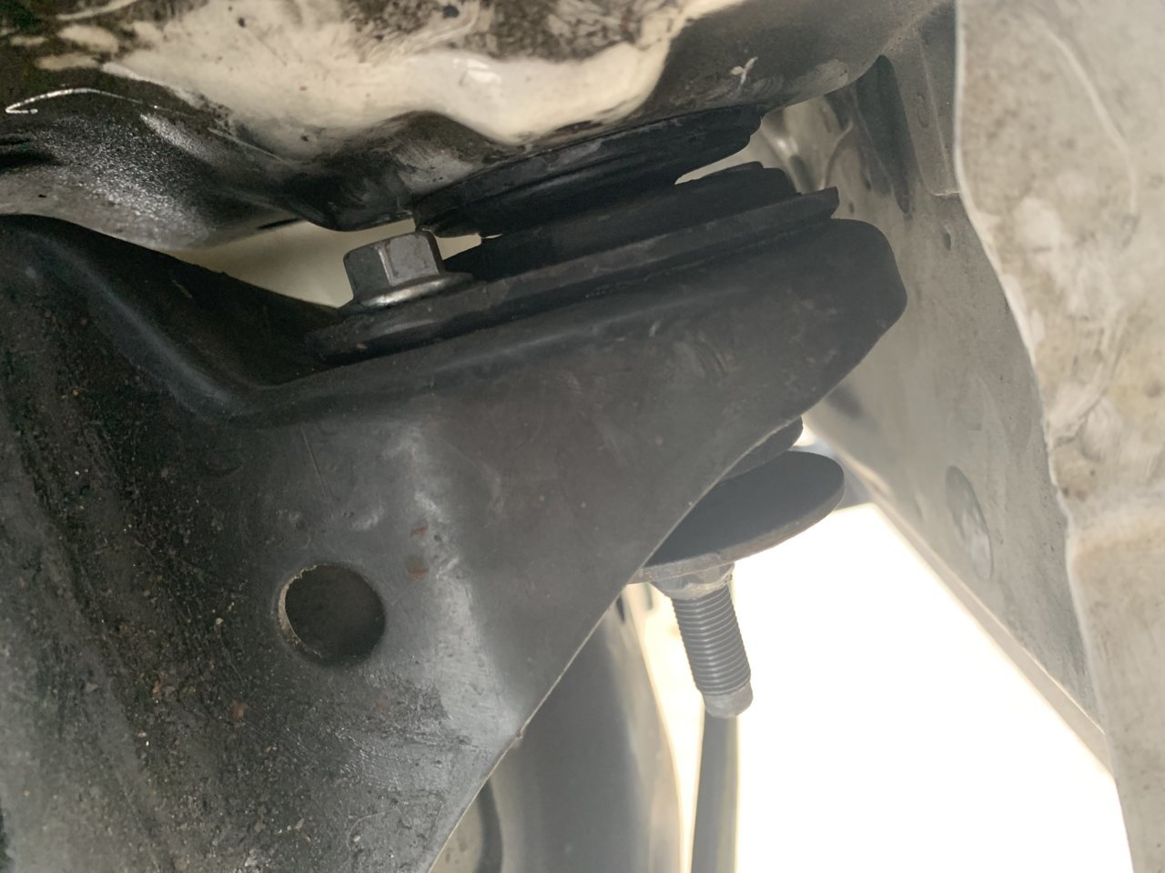

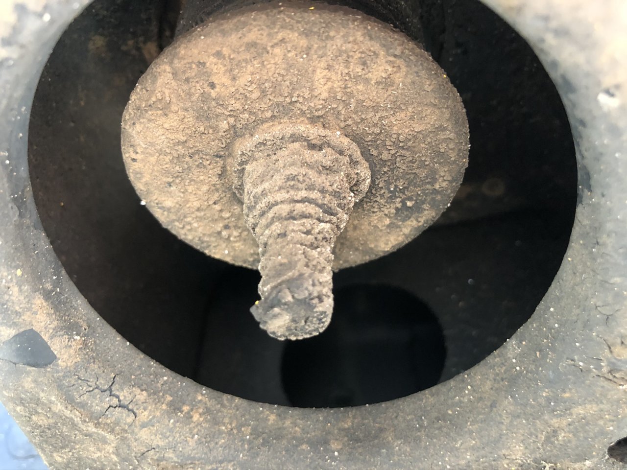

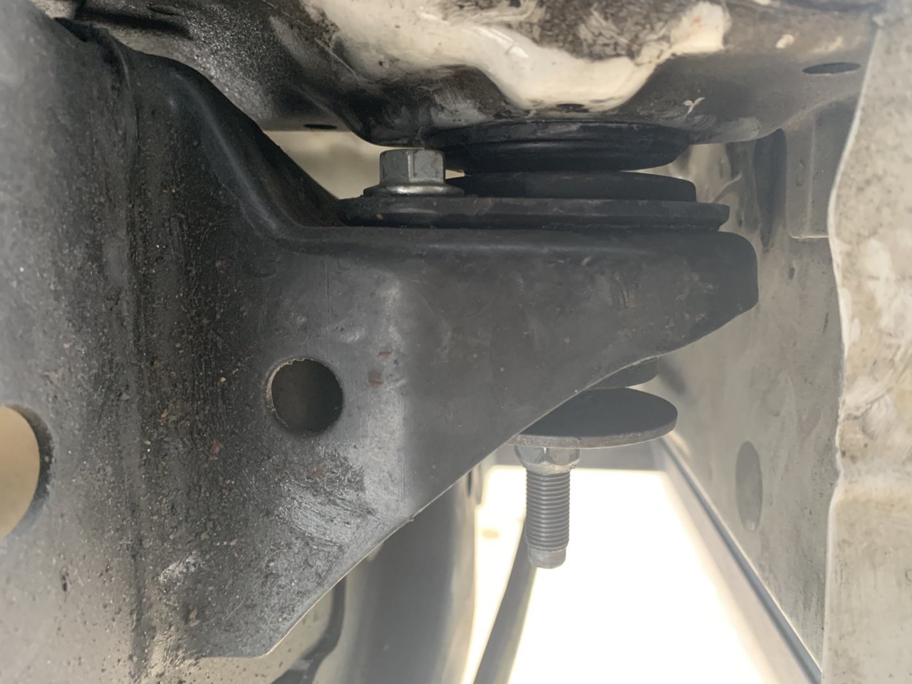

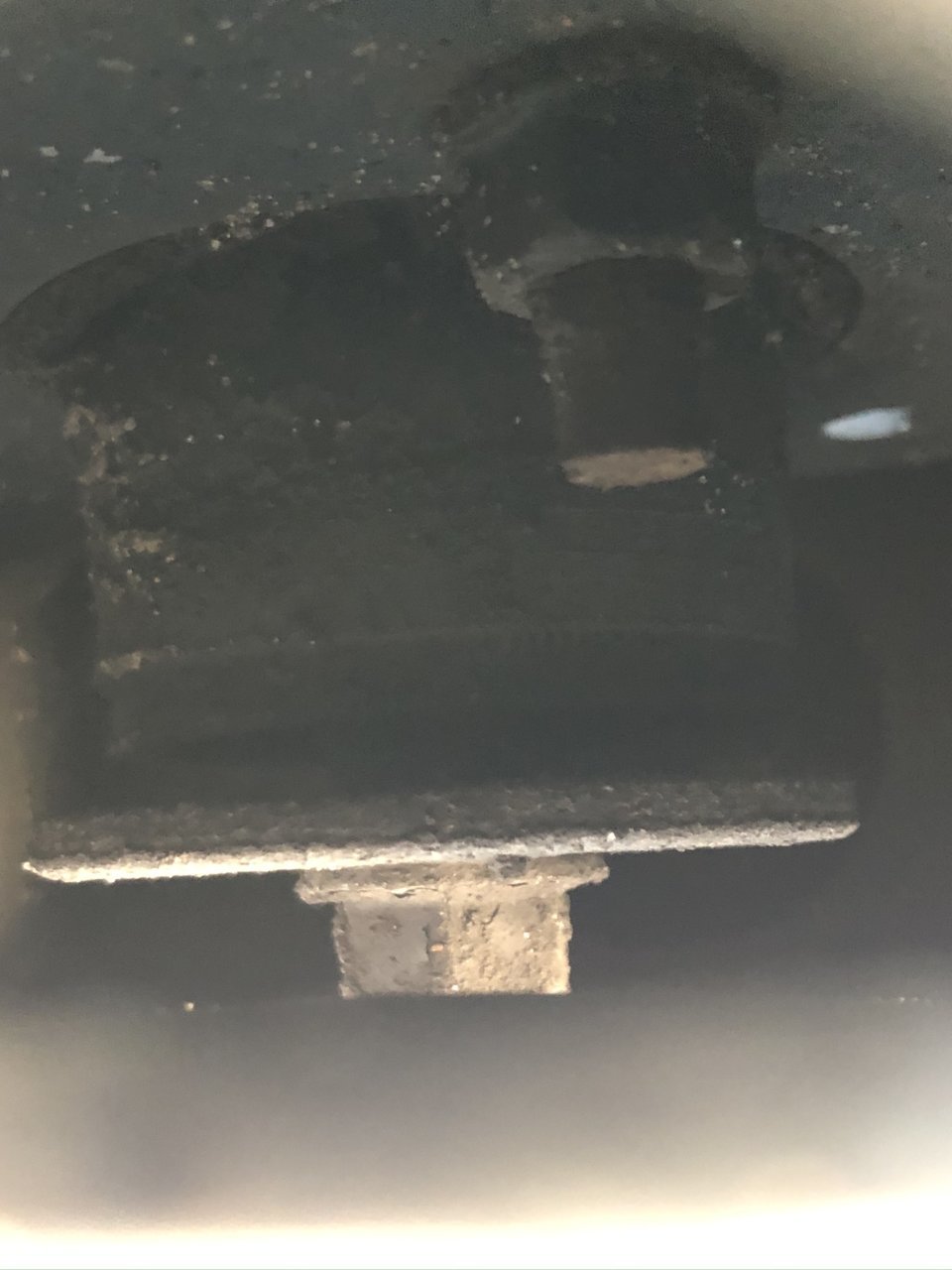

    I replaced mine a week ago with OEM parts. Hope this will give you an idea.
    pics in order are:
    Front
    Rear
    Rear
    Front
    Naveronski and Chris(NJ)[QUOTED] like this.

    Thanks @doorsidedown! That is a big help. Do you happen to have the rad. support part number handy by chance? I found the cab mount cushions, but working on find the radiator.

    no, sorry man I replaced those with poly bushings from energy suspension.

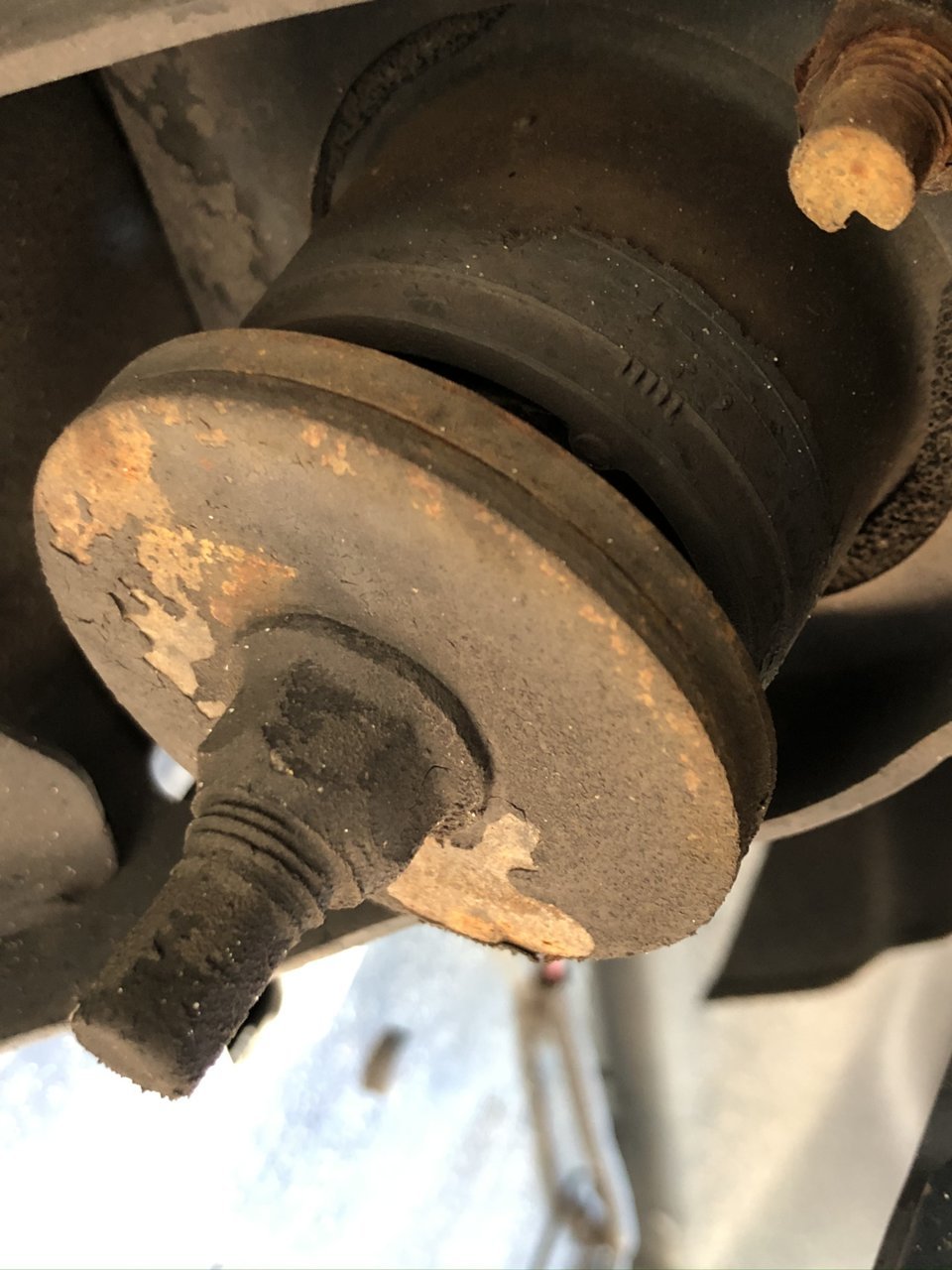

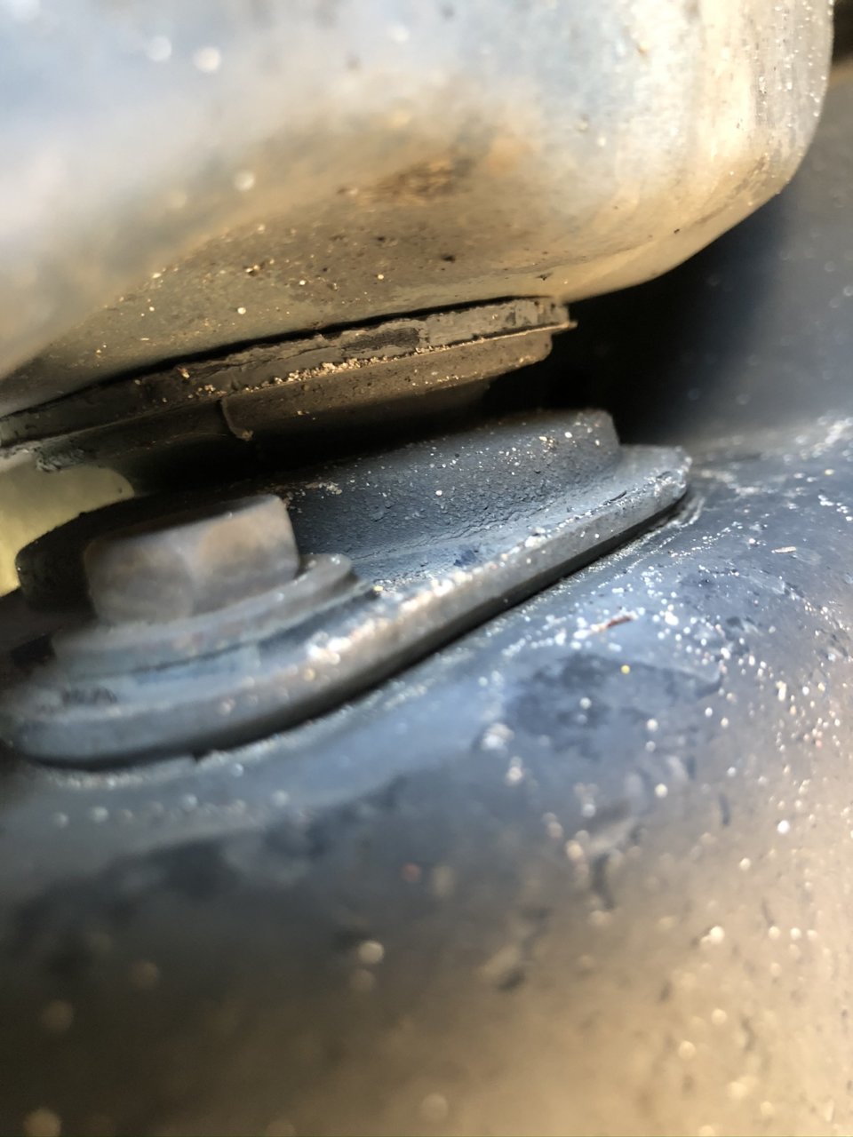

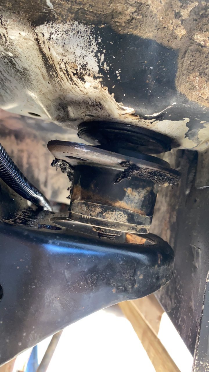

    Anyone have some suggestions on how to get this out? I can even turn the bolt and yes I took the nut off and banged it with a bfh
    And I don’t have air tools or a torch

    You can’t get the long bolt out thru the cab?

    I tried to bring it out but no avail. Tried to screw it out and nothing either.

    i have a sawzall just didn’t want to cut it without having a replacement

    MAPP gas burns hotter than propane and is a good, inexpensive alternative to an acetylene torch. HD or Lowe’s should sell the bottles and then you just need to buy the flame nozzle. Splurge and go with the auto lighting nozzle instead of the twist on/off for gas flow. Bernzomatic has a good quality nozzle. Amazon sells one for $40.
    Edit: You won’t believe all the things you will end up using it for.

    This sucks. Assuming you already fingered this out and got it done, but HEAT, OIL, REPEAT was my recipe for success. I had the luxury of a daily driver and several days to do it. Both my rear cab mounts were seized inside the sleeve. Impact gun wont do shit to break it loose against a rubber bushing. Twice a day I hit it with PB blaster and set the the bushing on fire with a propane torch. Finally one day, it broke free.
