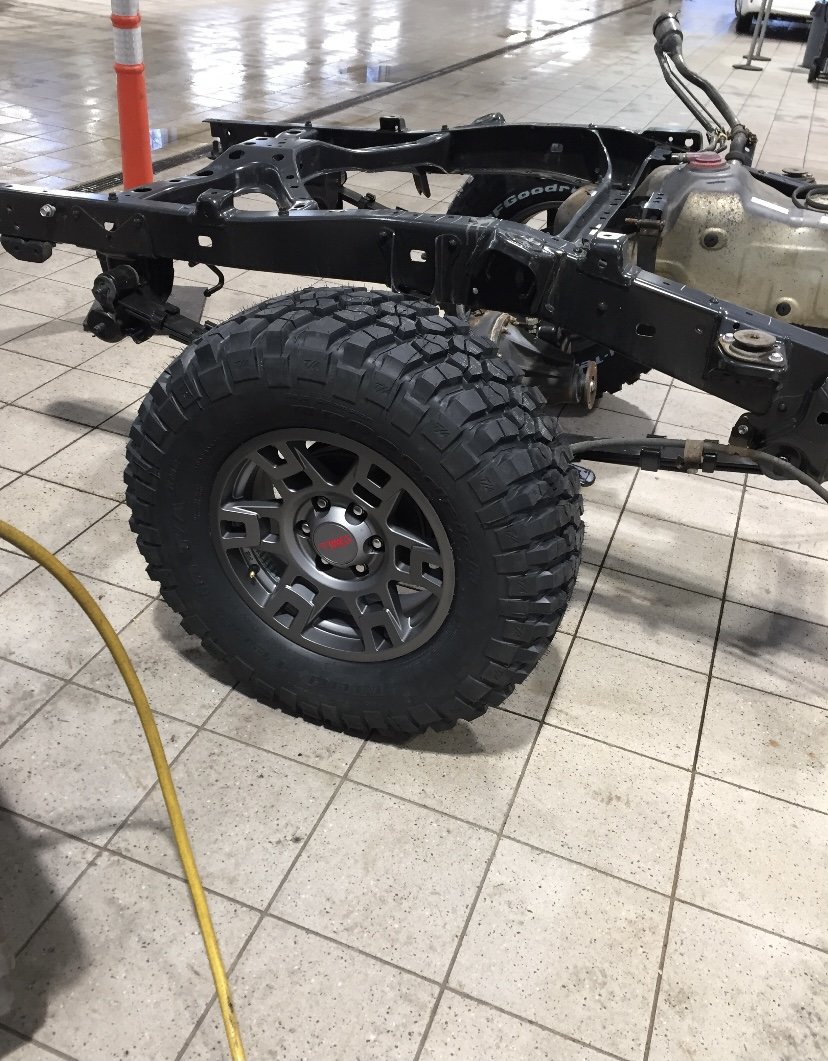

    found a pic from when the frame was getting done and saw the damn bushing the bolt is seized in eyeing me lol666FD4BA-2F3D-4586-8D11-E8BF1E6E62FA.jpg
    Finished quickly today. I should have just cut the bolt in half to begin with

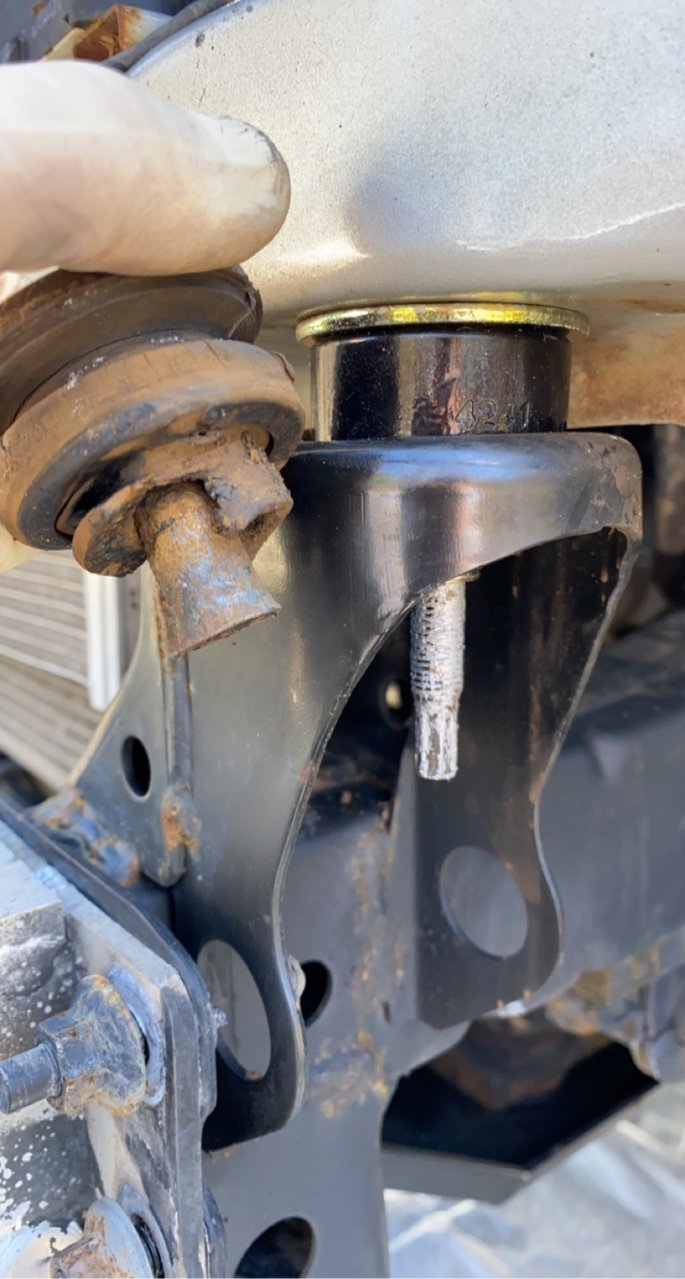

    Wondering if that's a crack in the rad support in your pic to the right.
