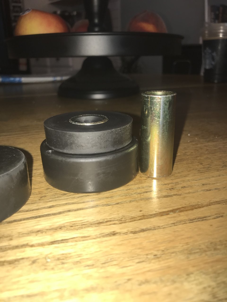

    So, tried installing the universal rad mount kit yesterday afternoon… Did not go well.
    I loosened both sides and used a block of wood and the bottle jack to lift the body. Started on the DS and got the old bushing out and inserted thicker puck bushing and washer - No issues.
    Went to drop the bolt in and it didn’t line up. Pulled, pushed, pried, and cussed and finally got it to drop down a little.
    Success! So I thought… I went to insert the inner sleeve and lower bushing and the inner sleeve does not fit in the upper bushing! Double check the set that was supposed to go in the passenger side and nope… Not even close!
    I think Energy may have supplied the inner sleeve for the truck specific bushings in my universal kit.
    Moral of the story, double check everything fits together out of the box before trying to install!

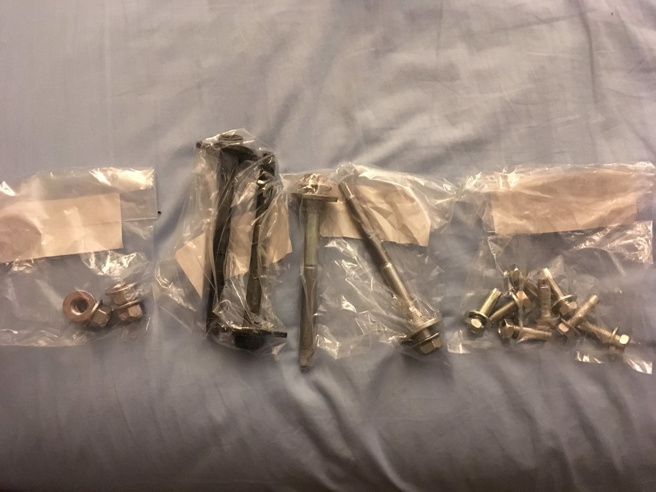

    so i read a lot about the universal and then more talk about complete kit.
    I found the universal 9.4101 but when i look up part 8.4109 it has a third pair in there that per the instructions look like they go no where near the radiator. what exactly do i need to buy to do this?

    The radiator is a single bolt. All the cab/body mounts take 3 bolts each

    I was just worried about the 3rd set of mounts that looked weird in the kit but after more research they are the radiator mounts. Im more confused on their website where it shows number 1 being behind the front wheel area.
