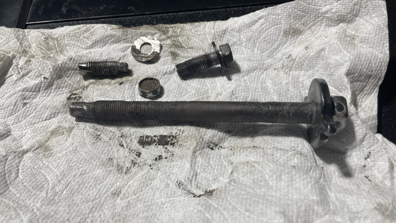

    Honestly. Out of the 3 days I spent working on the rear driver. Cutting out the little bolt was the fastest and most efficient thing I did. But seriously. SOAK those bolts in penetrant. 24-48 hours beforehand minimum. I’m trying the other side tomorrow.

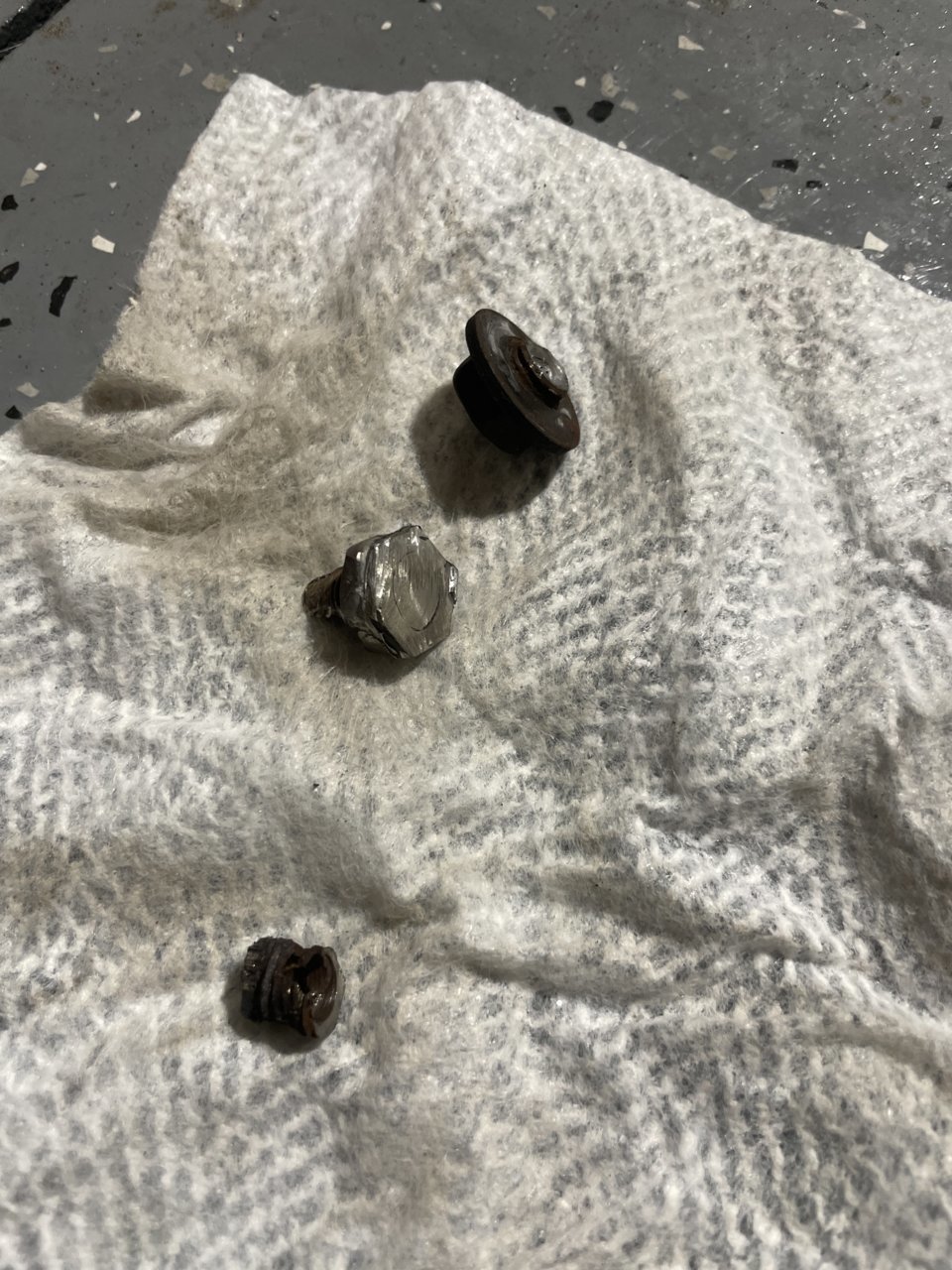

    To document the chaos. Here’s the old and new bushing and the mangled long bolt, cut little bolt and one surviving little bolt

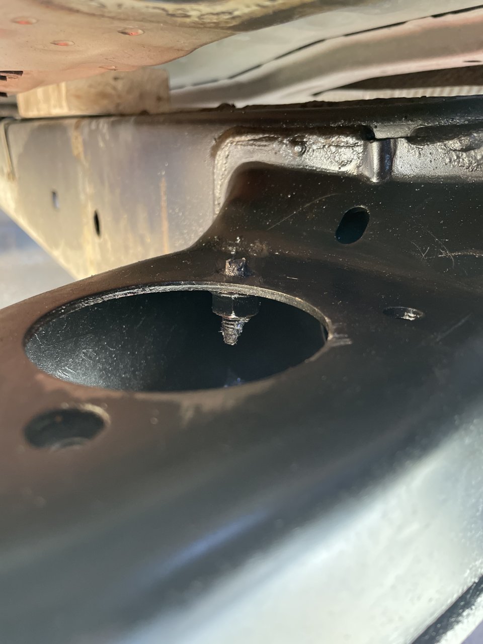

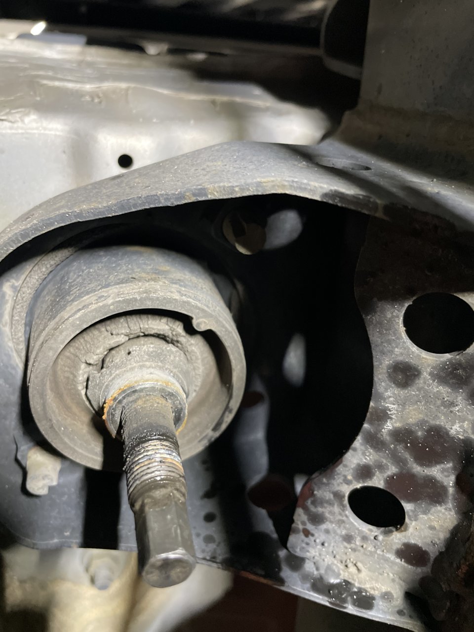

    Alright. After 7 days, almost a full BIG can of PB Blaster… all 4 body mounts are done…
    I took some pictures and hopefully can provide some better tips for others too.

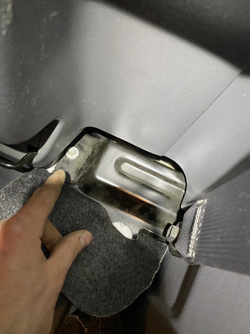

    Buzzkill, for the back ones, I thoroughly recommend taking those back covers out. They block about 1/4 of the hole. I could only take the driver out, so had to deal with the big passenger one staying in. I did it, but it was a struggle not getting a lot of leverage on the bolt and also actually getting the bolt out once it was loose.
    Here’s what the passenger side looked like.
    Getting those out is not fun. Drenched in on blaster. You really gotta just work that bolt back and forth. The little 9mm hex on the bottom just twists and warps after a while.

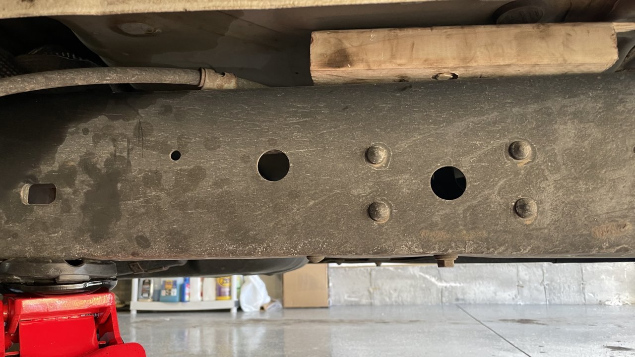

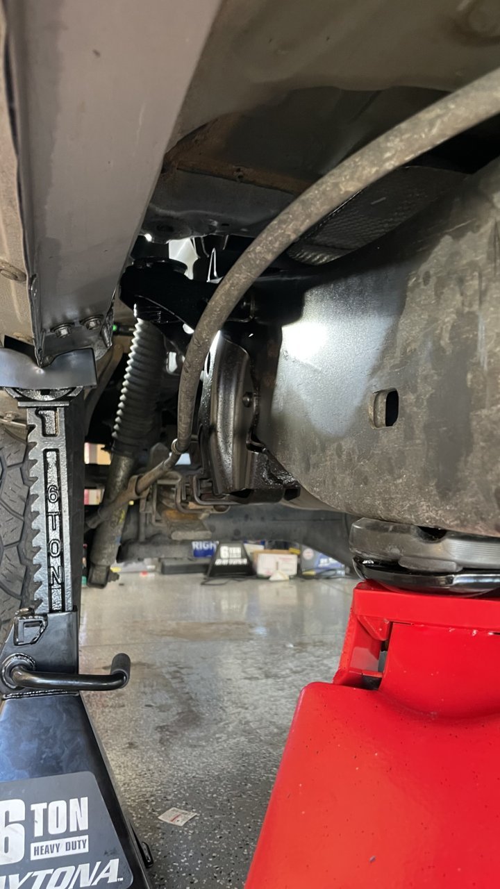

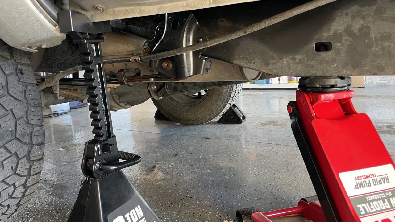

    Also, I hunted for pictures of lifting points and jack points and where wood would go. So I obliged.
    This is the rear passenger, but you do this on each corner with the stand and floor jack as close to the bushing as possible on the strongest pinch weld.
    And just shove the wood between the body and frame as you can. It’s just for safety.

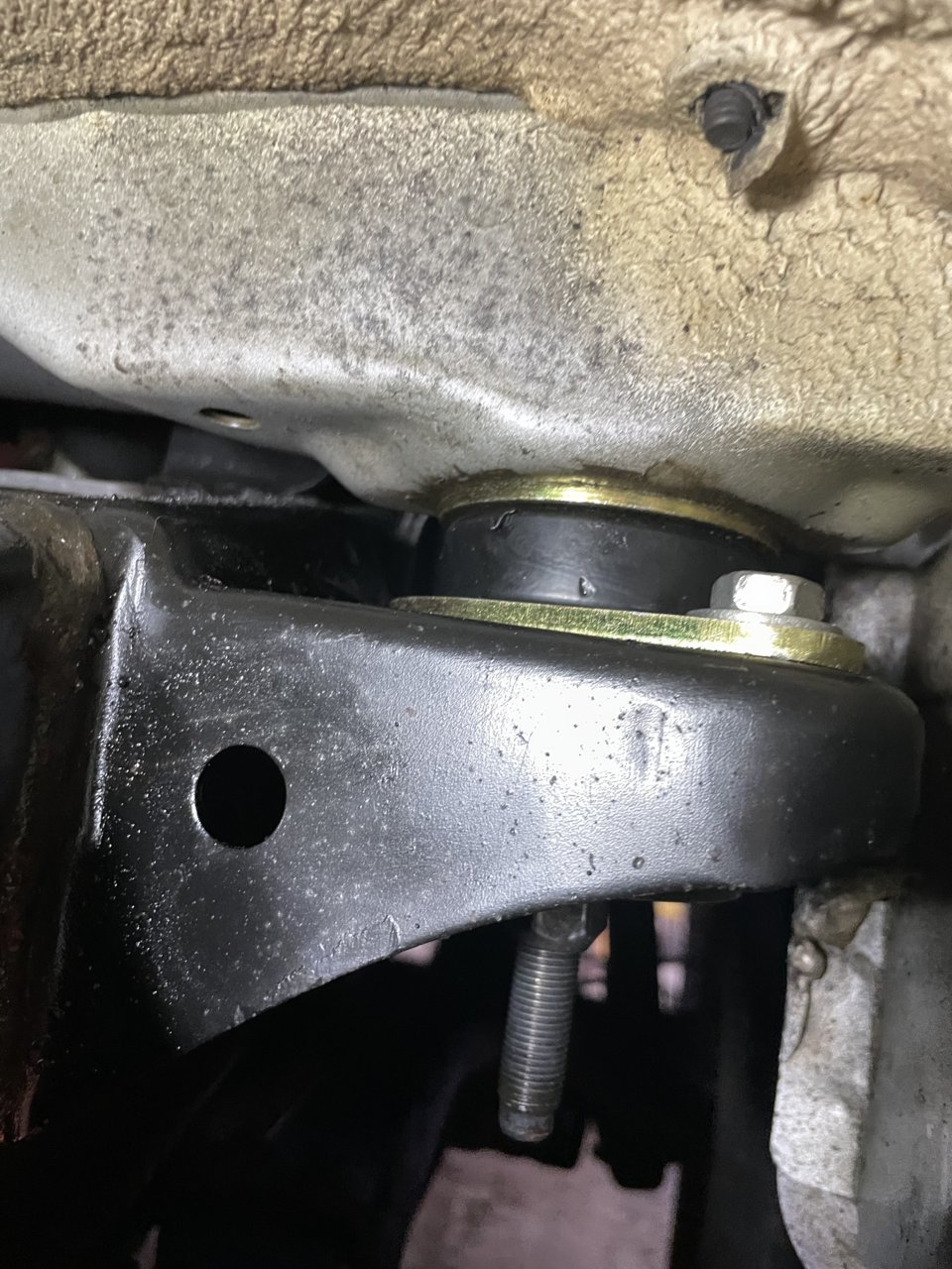

    Now for the fun of the day. So I get to the front passenger. Cruising along. Front big bolts are cake…. I take one 14mm just fine. Start on the second aaaaaand
    Not fun. I have no welder… So. After trying to file it to get a crescent wrench or something on it and then trying to drill it out. I was stuck. So, the old man thought. Hey. Let’s just take the welded nut off. Stripped that super easy with the impact… So out came the Dremel. Cut the nut off as close to the frame as possible. Drilled it out a little more and twisted the rest out.
    Had to go get another nut to fit but put a washer and locking washer on and but it’s good to go.

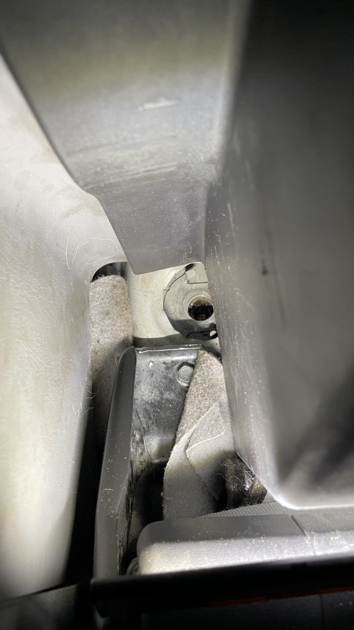

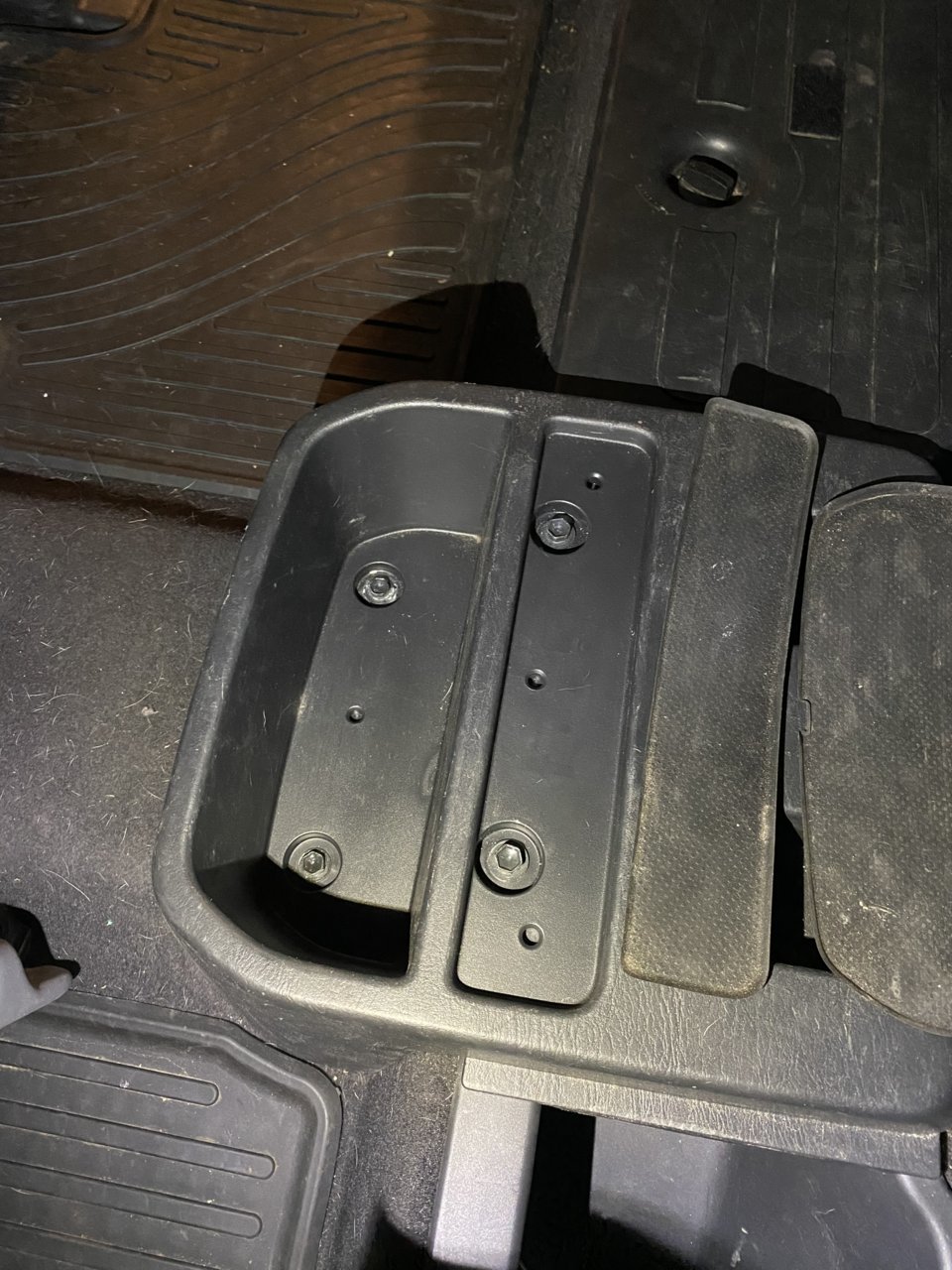

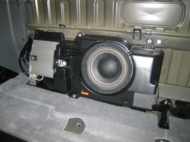

    Absolutely. So you shouldn’t need to take the whole woofer out, just the cover. Should look like this after your covers are out. You should also be able to leave the seats in as well, you do not have to remove those. I didn’t when I did my audio system.
    And it luckily wasn’t, but very stuck. The more room you have for a BFH the better!
    If ya need any other words of wisdom on it, don’t be afraid to reach out. Good luck!

    thank you so much for that subwoofer picture. I have been trying to figure out how much to pull out. I will tackle it ASAP.

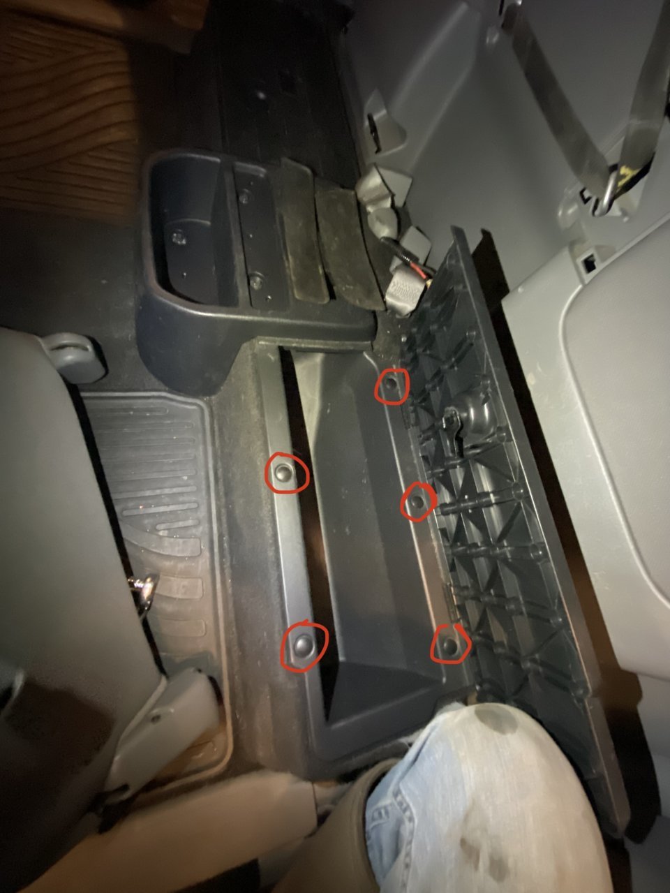

    It’s a mixture of both. I do believe 5 screws? And the covers clip to the side body. Check this out, is a 3rd gen but all the same stuff still. They do remove the seats but like I said, you don’t have to. Also. That drivers one does come off independently. Watching this makes me regret not doing sound deadening before my amp went in…..

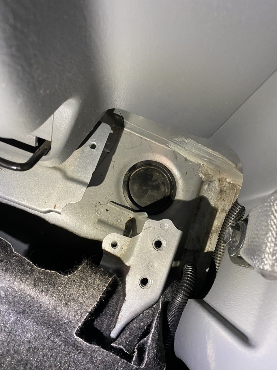

    I’ve had a really bad rattling sound/clunking behind the drivers side front seat of my 2012 access cab. I think I narrowed it down to my cab mount bushing (the sound was similar to my Dodge when it’s cab bushing failed) and sure enough, after removing the lower lock nut I saw that the bushing was pretty cracked and there wasn’t much rubber left. My dumb a** thought you accessed the bolt from the top. So here are some pictures in an access cab for those wondering. I can’t wait to take it apart again when my bushings show up in the mail.
    (Sorry for no pics I’ll add them when I do it again in a week:rofl: ), using a 12mm socket remove the 3 bolts securing each fold down seat.
    Then with a 10mm remove the 4 bolts that secure the center plastic piece in front of the rear seatbelts.
    Then remove the plastic rivets holding down the storage as well as your jack.

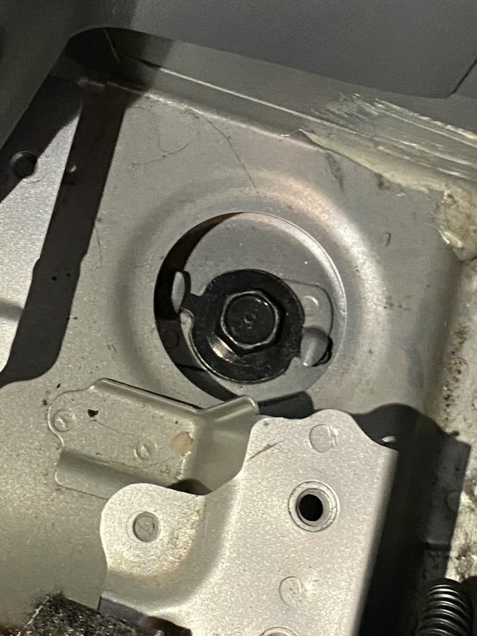

    BFA69E66-AB25-4740-AD59-0FB47DA8A8D1.jpg Once the bin/seats are removed you will have access to this piece of metal underneath the carpet. Two 10mm bolts hold it down.
    Under it you will see a plastic plug, and below that is the winged body mount bolt.EA69AE03-C071-43CD-B504-14101CB1560E.jpg
    Hope this helps for access cab owners!
