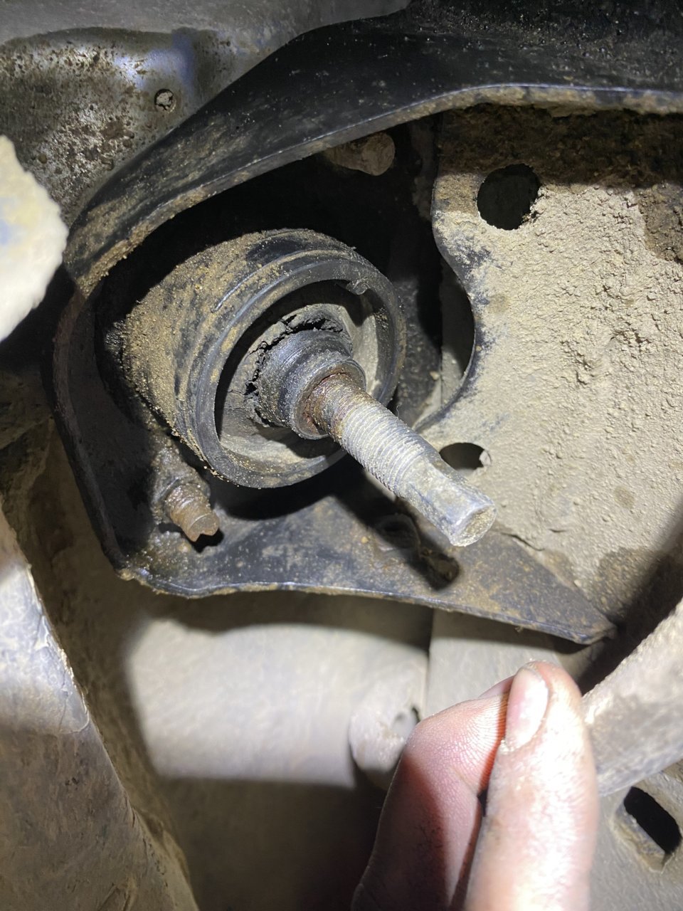

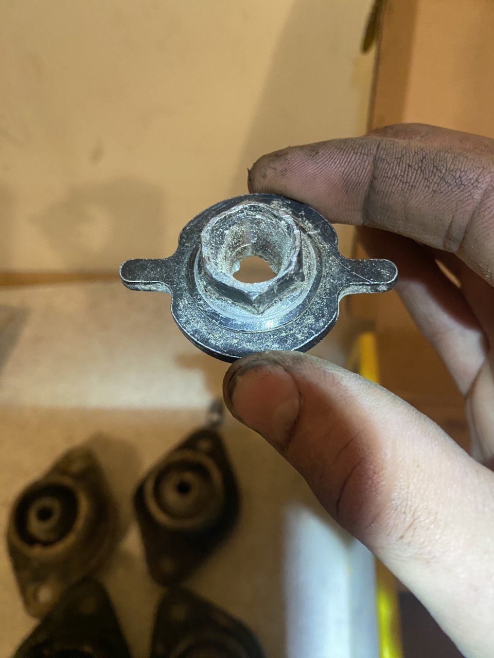

    Has anybody had issues with the rear body mount bolt being stuck/seized? My rear driver side mount has been the culprit of a lot of clunking. I think it may have like welded itself to some metal in the bushing sleeve or the frame if it wore through enough.
    I got the whole front bolt and the rear bottom 17mm nut off fine, I tore the whole back area of my access cab apart again to get to the the top of the bolt and was able to put a breaker bar on the 19mm bolt head and turn it a quarter turn (clockwise) to unlock the wings. And after using a BFH and a really big BFH (Sledge), and even the jack with a nut/socket on the bottom I was unable the get the bolt to pop out upwards. The jack actually lifted the whole drivers side of the truck off the ground. I started soaking all of the bolts like a week ago in PB blaster from the bottom side, today they soaked for like 2 hours from the top before trying to get them loose. I am kinda stumped by this.
    Tonight, both rear bolts are drowning underneath like a 1/4” of PB and I am borrowing a torch to try and heat them up from the bottom.
    Any plan b suggestions if heat/penetrant doesn’t loosen them?

    I have a rattle in the back like that. Brutal. It’s never consistent but I’m very sure it’s the lead bushings. Hopefully… if not. I’m stumped.
    100% was in the same boat. Passenger rear will probably be very similar… they’re a bear. Period. Soak em overnight. Crank on em. Repeat. What I learned is when you can get the bolt, from the top, to spin 180 and back smoothly, you’re home free.
    But literally. Soak. Sit. Crank the bolt (from top is best) back and forth and back and forth and repeat. The part that’s spinning the most is the rubber. The bolt and metal sleeve are seized together and that sleeve is attached to the rubber. So, ya gotta get that rubber to start pulling that sleeve.
    Absolutely the biggest PITA upgrade/project I’ve done to my truck…
    Plan B. Sawzall. Also. Be prepped for those 14mm. Soak them on all 4 corners of the truck deeply. 2 I had to cut out. 1 snapped completely and the other just never budged.

    Well that dang bolt turned this whole project into quite a lot of work. It took me 3 whole days to get it all done and put back together.
    I tried several methods to get the bolt out, but the solution for me was drilling the head out from the inside so we could lift the cab a little bit. I then took a sawzall and while holding it inside the rear fender, I was able to cut the bolt between the top of the factory bushing and the bottom of the cab. I also had to cut the bottom of the bolt to allow me enough clearance to pull the whole bushing out the top without lifting the cab too high.
    I then replaced the bolts with grade 8 7/16” x 5” fine thread bolts with a normal sized washer and a wide/thick washer up top. On the bottom, I had to reuse the thicker factory bushing washer to take up some space on the bolt, so I was keeping the nut in the threads topped off with a washer and a nylock. I did it on both sides.
    The funny part is I had the other side knocked out in under an hour.
    I will keep it this way for now, but if the rear bolts start loosening I will order some factory bolts with the lock wings.
    the ride is nice and stiff now and no more rattling!
    If you have the same problem as me you will need some high quality drill bits. I don’t know how many cheapie bits I destroyed because that steel was hardened. Luckily my buddy had a nice set and they chewed through it like butter.
