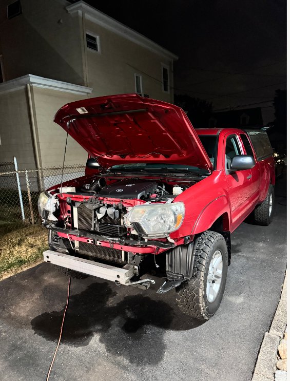

    Completed my cab mount bushing job last night, well mostly - still need to reinstall the front bumper/grille/trim and reinstall the interior trim. Didn't feel like doing all that at 2AM in the dark driveway with a thunderstorm rolling in.
    Thankfully it was a pretty straightforward job and I didn't strip/break/round any bolts or need to break out any cutting tools. Came really really close to rounding off the last bolt on the last forward cab mount I went to remove, though; didn't have the socket fully seated on the nut. Whoops.
    Ended up using the front bushings that came in the kit, despite ordering the alternate bushing kit mentioned by the OP. Didn't like that the alt bushings don't sit down into the bushing location pocket on the frame. Overall my factory bushings were a mixed bag - forward body bushings were a bit misshapen, not in great shape, but not terrible. The forward cab mount bushings looked almost brand new, even the hardware looked newer. Rear cab mount bushings were totally blown out and separated with big cracks.
    Sourcing any new hardware was a major challenge. Ordered a full hardware set from toyotapartsdeal.com and USPS blew open the box and only the 2 rear cab mount bolts showed up when it arrived.
    Filed a lost/damaged package claim, and now the replacement reorder is floating in the USPS ether with an 'arriving late' status, last update 3 days ago. Ended up sourcing the very front bolts/nuts from my local Toyota dealer at a stupid cost and reused the remaining hardware. The nuts are on backorder and unavailable at this time, too.
    Hopefully this helps fix the phantom clunk I've been trying to track down. If not... well, I've got a full set of tie rods sitting on the workbench.

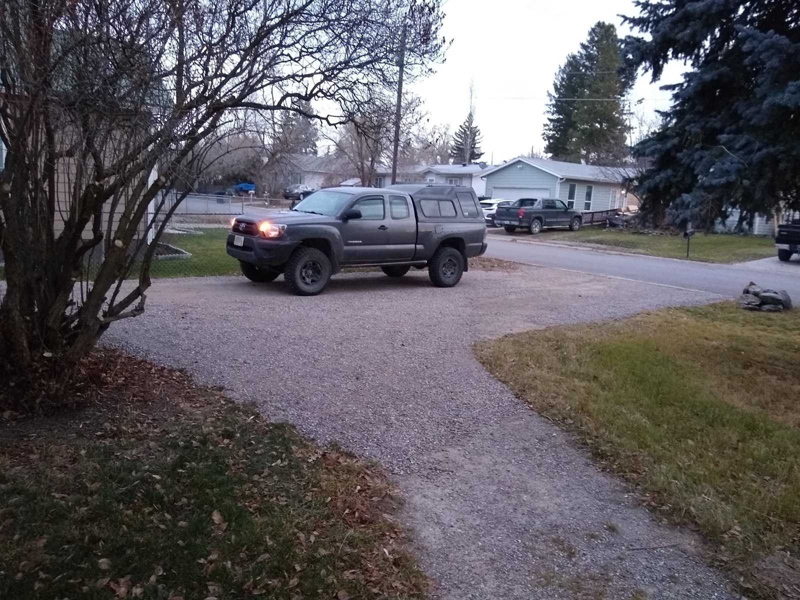

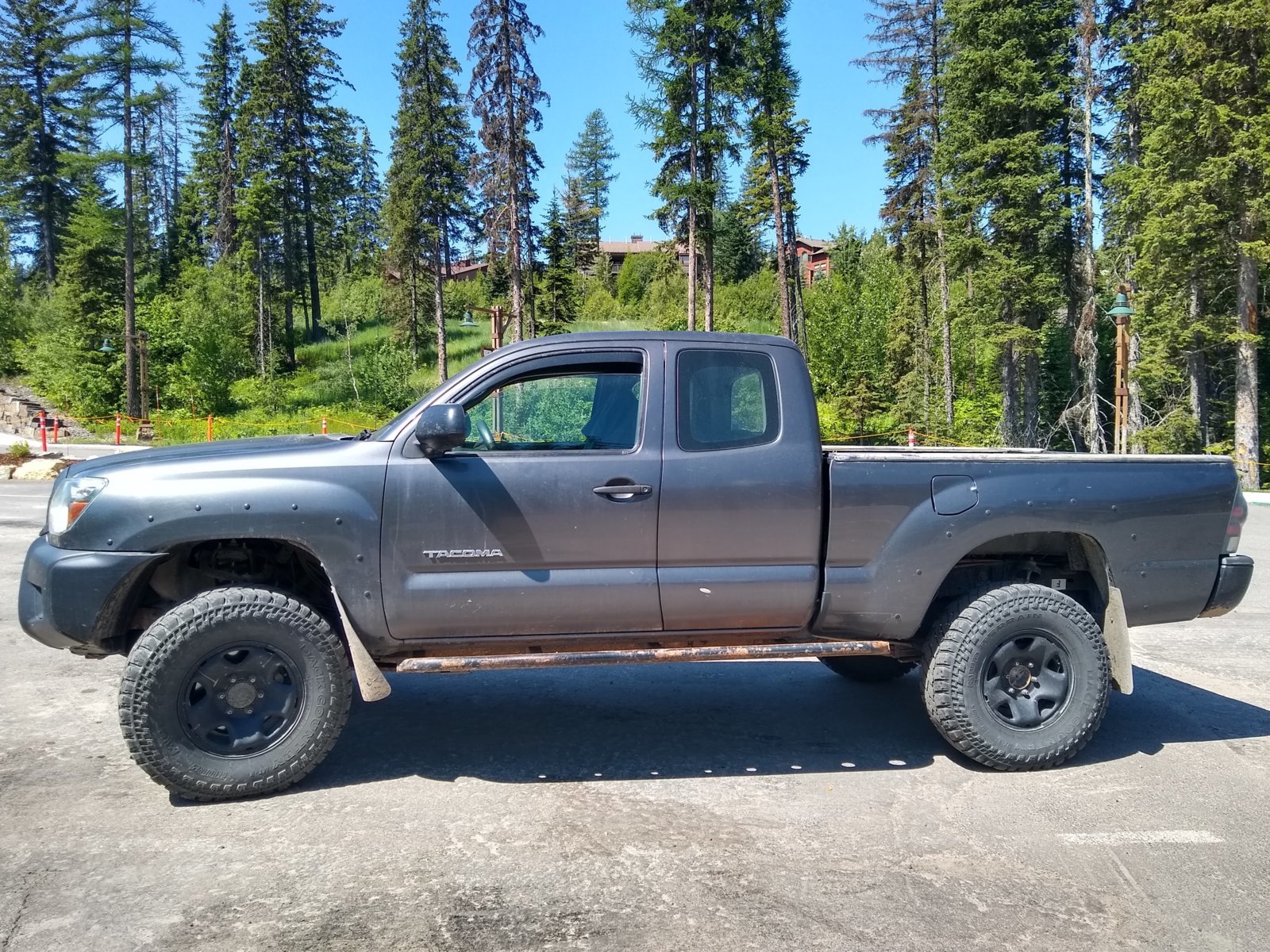

    Its been some years since I created this thread. The new body mount bushings definitely reduced my lean, but these trucks are driver side heavy and suspension is the "fix" for that. As I wrote in the OP, my body was hitting the sliders and new bushings, flipped, was the solution.
    As to my taco lean saga...
    I have been through 5100s on stock springs, 5100s on Old Man Emu springs, and a full Emu setup. I've gone back in to add a 1/4"spacer to each of these when the lean eventually returned. I still have OME Dakar HD leaf packs in back and 885s up front with OME shocks on all corners. Driver front still has the extra 1/4" puck AND I still have a little lean. It's inevitable , I just live with it these days. I still love this truck, and I'm getting back into the build.

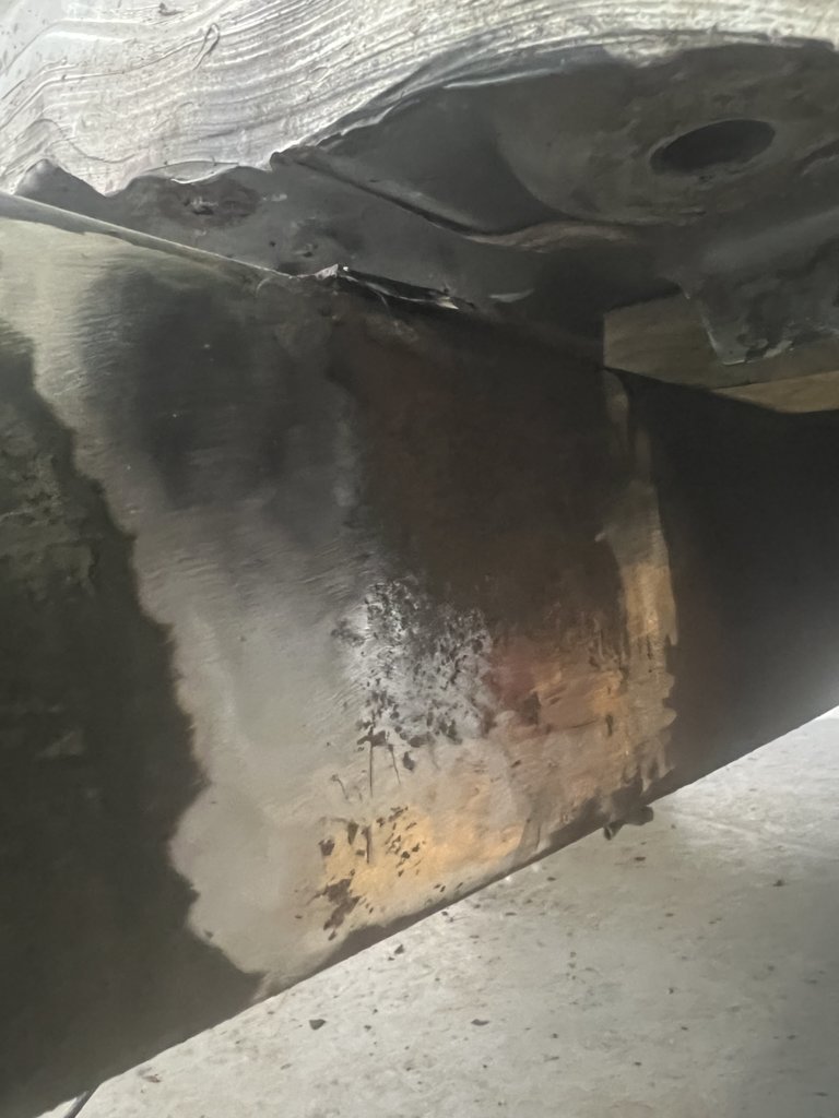

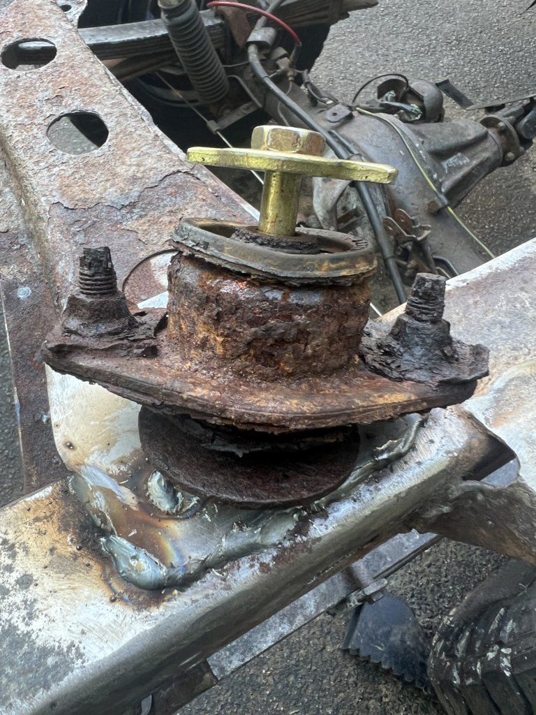

    I am going to do this swap as well. My passenger rear body mount rusted away, so I have to weld in a new mount, and figured it just makes sense to replace all the bushings with the ES ones.
    I have all the long bushing bolts out on passenger side. There is no rear frame mount anymore, so I don’t have to worry about those plate bolts. For the front cab mount, I have to lift the body to get to head of bolt. Do I need to loosen driver side long bolts to do this?

    I have to replace body mount bracket here. Also need to get body up a bit so I can grid off remains of old bracket

    Here are the remains of the passenger rear mount. Truck was clunking really bad. lol.

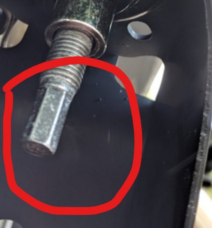

    Also, on some years like my 2009, you can get to the mounts without having to remove interior panels if you are using std length bolts.. Just use a 17mm wrench (I use a ratchet wrench, while holding the hex part of the bolt the extends past the threaded part with a wrench - I used an adjustable just because it was there. :)
