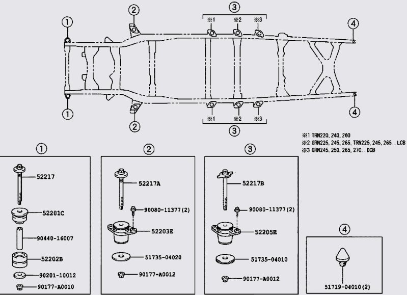

    If I torqued mine to 46 the would sing like the crickets of Capistrano being tortured by angry seagulls

    Says you only torque to 34?

    Yes
    Oops yup sorry was reading it on my phone, Whatever snug plus a half turn with two fingers using a box wrench equates too or they sing like a clapped out hoopty

    Oh shit! I'm torqued to about twice that!

    In a case like this I'm tempted to replace the bottom nuts with some Nylocks and just tighten them to snug and call it a day

    Mine are pretty quiet now. They talk a little when the truck flexes, but apparently I'm way over torqued. I'm going to buy new nuts and torque properly. Should be quiet then.

    Gonna go back mine off and torque em. Pretty sure mine are hammered on at about 85ft/lbs..

    That's where mine are, and the diagram says 34 ft lbs...:eek:
