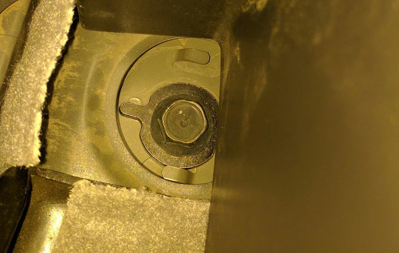

    Looks like my cab bolt was trying to self loosen?!? :eek:

    Is that tab supposed to be under the retainer clip thing?

    Yes. I think so. My rear drivers one is. That bolt has never been wrenched on by me, so it's factory.

    One of mine was that way. Just means they actually tightened it with a wrench at both ends

    It could be. I'm thinking vibrations rotated it out from under those tabs.

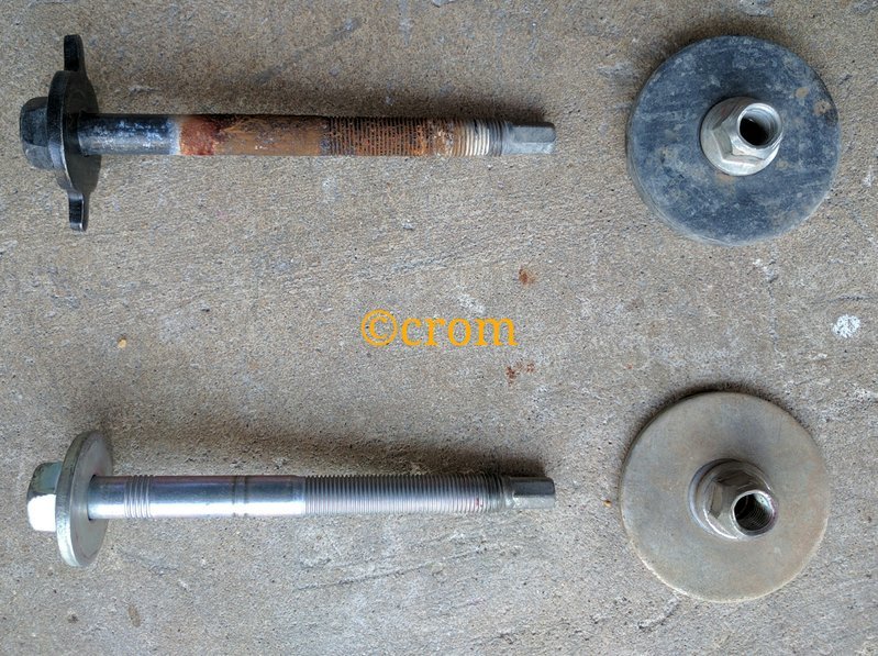

    Just got the pass side cab bolts off. My little 36 lb helper held the breaker bar from above, while I hit it with impact gun from below.
    Zipped the nuts right off.
    And holy crap, what is it about the rear cab bolts that make them corrode so bad?! No zinc coating?
    Front cab bolt looks like it's brand new!
