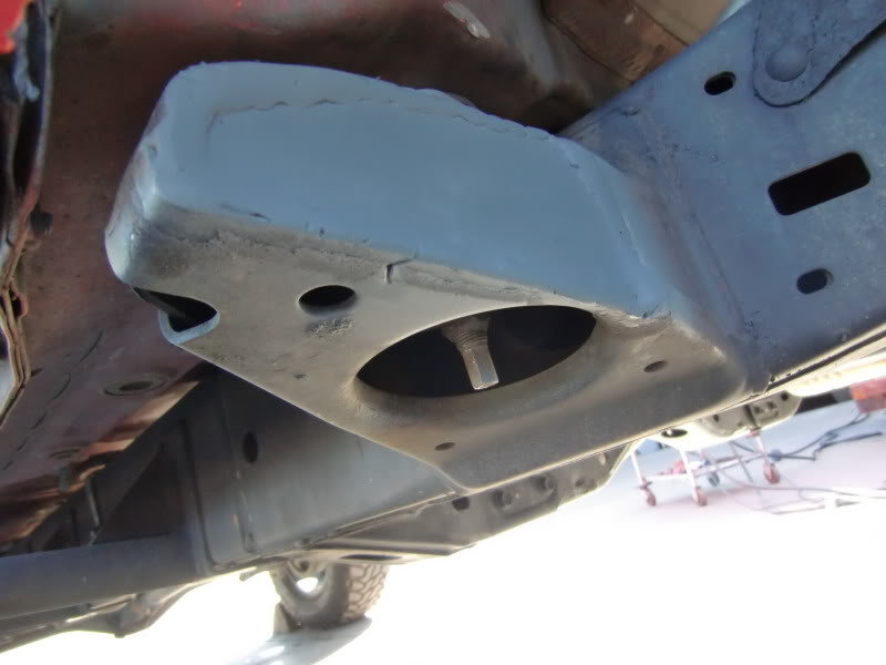

    Here are pics of a cab mount mod we did at work:
    :cool:
  4. Nov 5, 2010 at 5:43 PM

    Very nice and clean. Do you happen to have any pics from the bottom?
  5. Nov 5, 2010 at 5:45 PM

    I'll look in my files for more pics right now

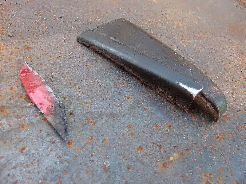

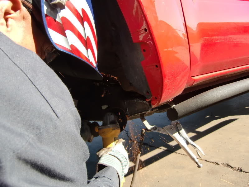

    :cool:
    and the amount we cut off:

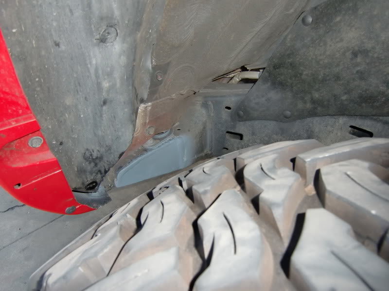

    Here's mine. Just had it done today at The Truck Shop in San Diego ($100).

    I like the angled ones. I think it would be easier to weld it from the top that way. Thanks.
