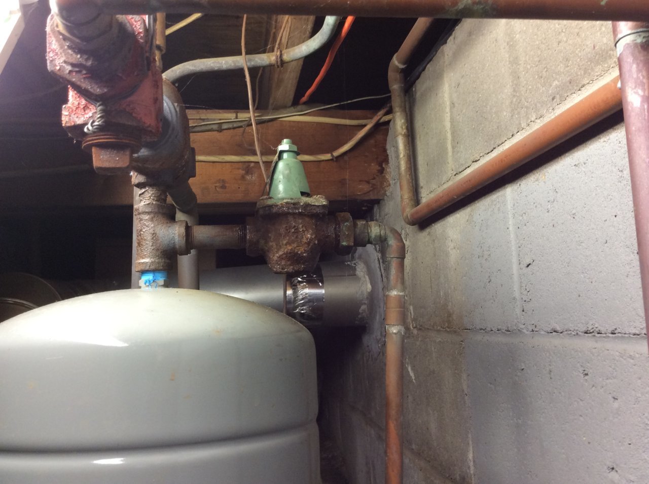

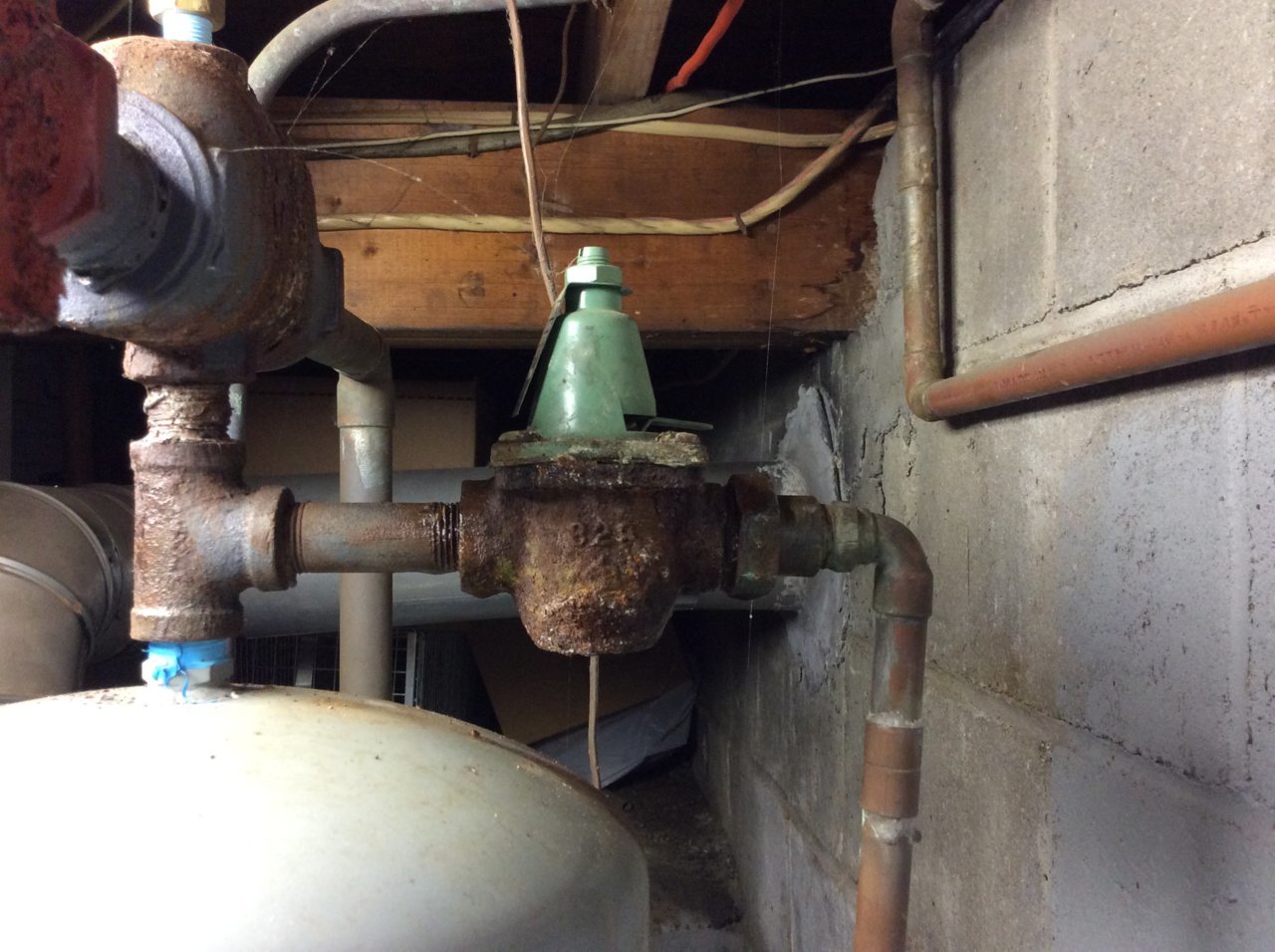

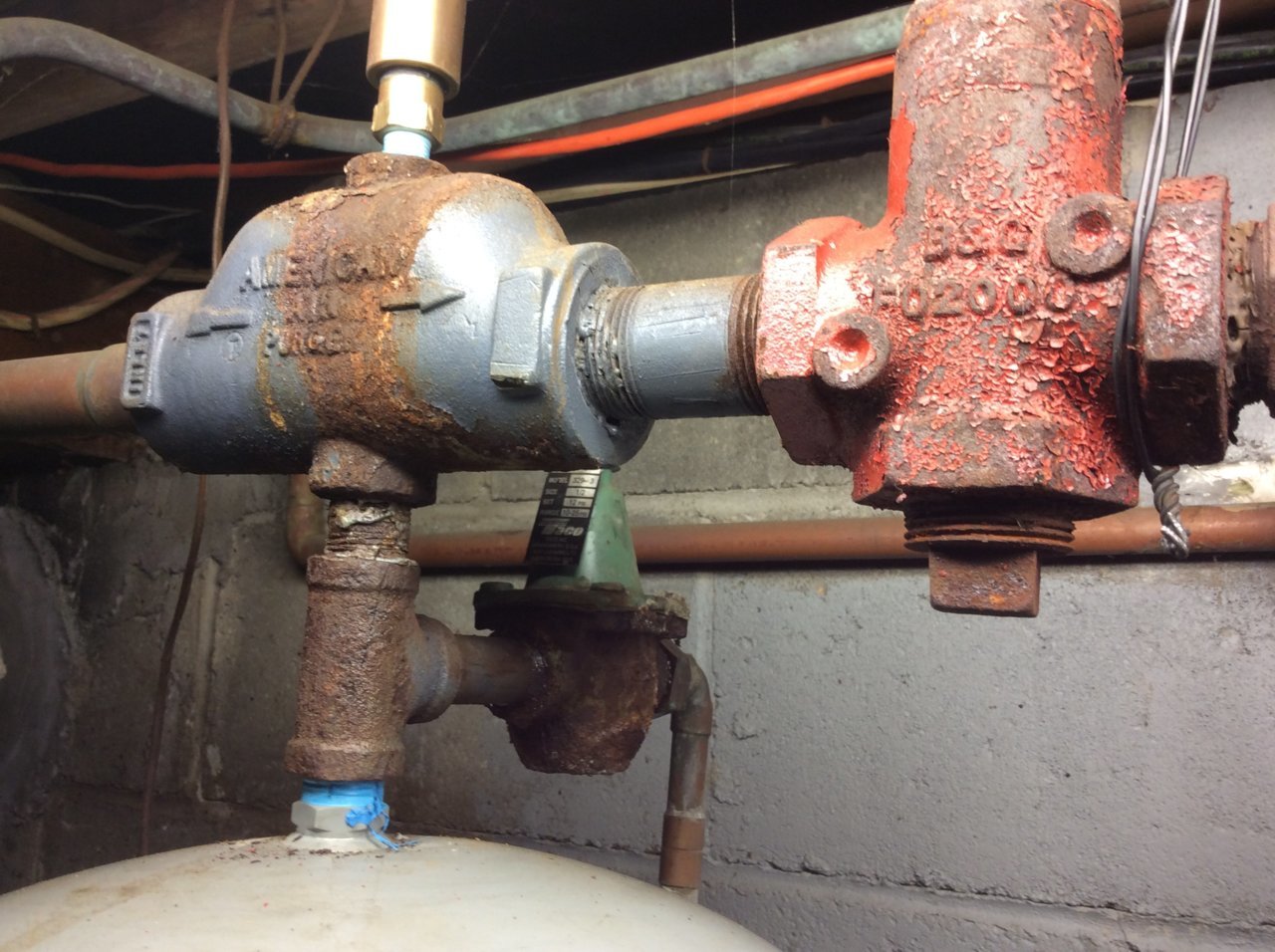

    36AA9639-38C3-4792-A19C-0EE2E46E4E16.jpg 955B5788-5D7E-41F1-AFB1-278460293ADB.jpg 85EC7CB2-8A0C-4D1D-9CDA-2D85F0BFB743.jpg
    I’m getting a pic now, back in a sec

    Wow you got a lot of rusty parts there. I would change the FB38, the nipple, tee and the short nipple above the expansion tank. you already taking it apart. do it one time do it right.

    I've seen a lot worse.
    I'm glad to see you have a union near that prv.
    Do you have valves isolating the boiler from the piping to and from the house?

    Your system has an air scoop and an air elimination valve. Those things will help getting rid of the little bit of air you let in when you change the prv.
