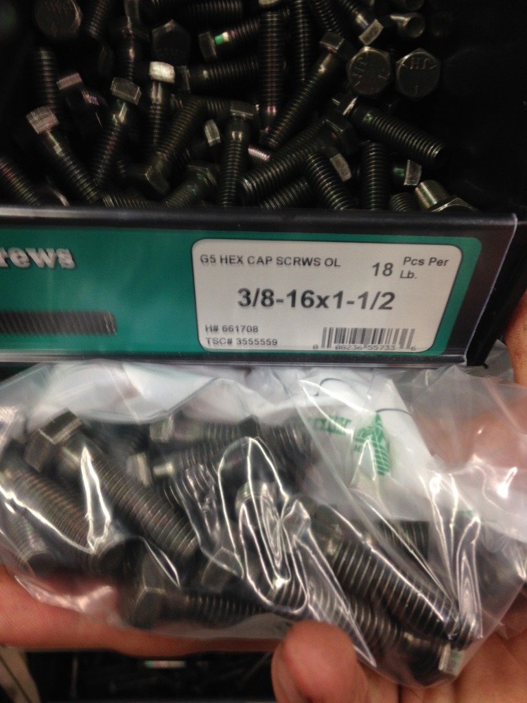

    (34) 1.5in 3/8s bolts

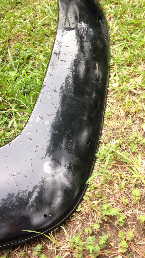

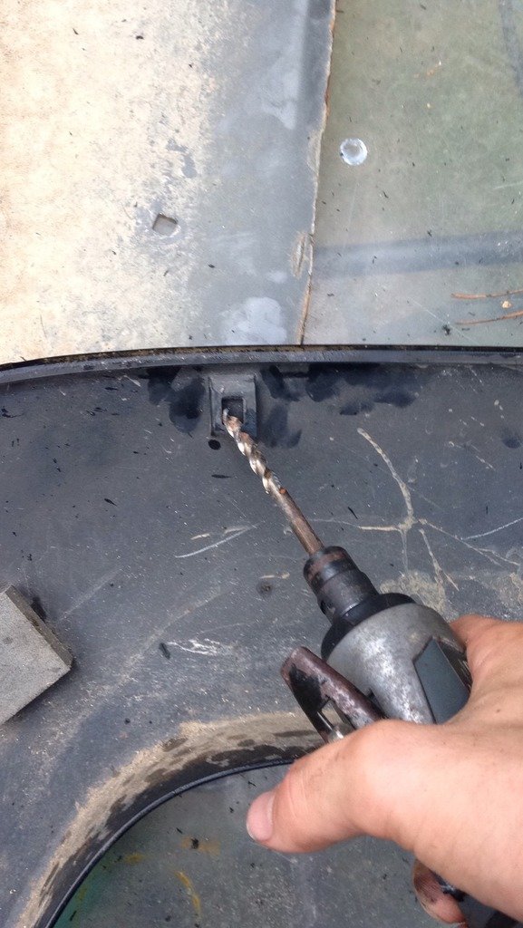

    now that they're out break out the drill. drill from the inside of the flare out using the clip holders as your mark to drill. if they're missing a clip holder like a couple of mine just skip it and we'll come back to it.
    don't judge my makeshift drill. I'm impatient and couldn't find mine.

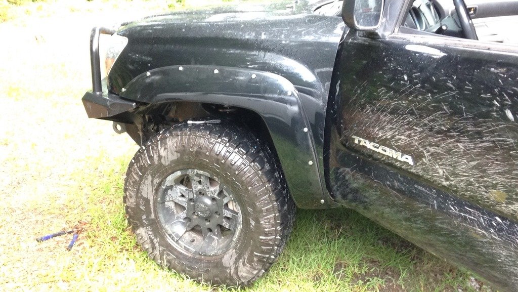

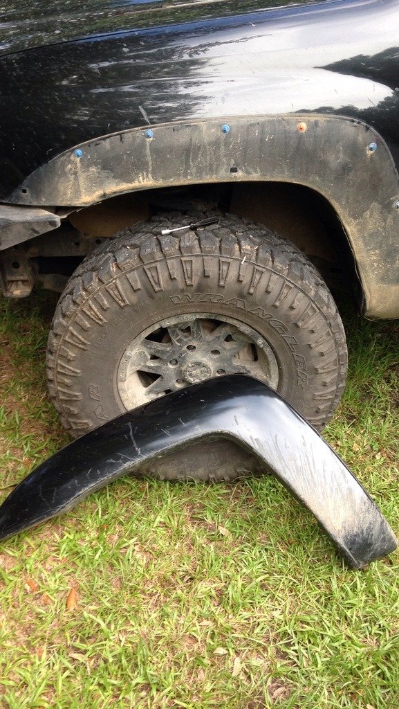

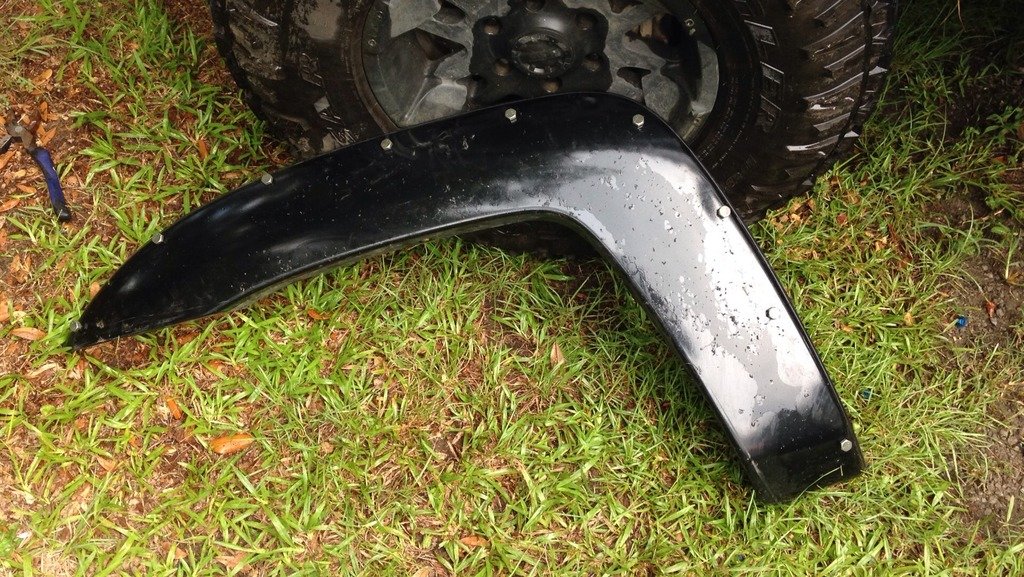

    the front side of the flare should now look like this.

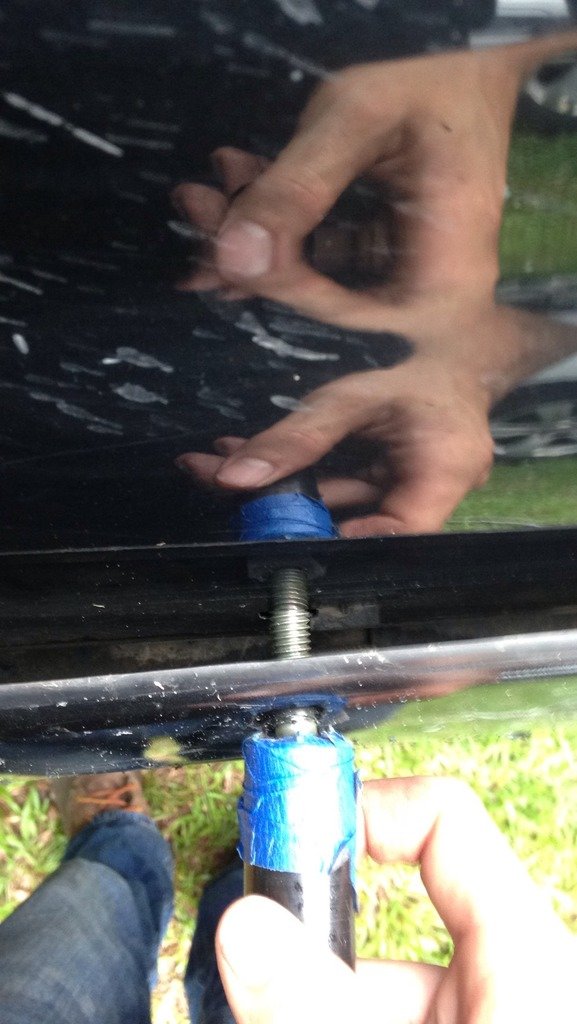

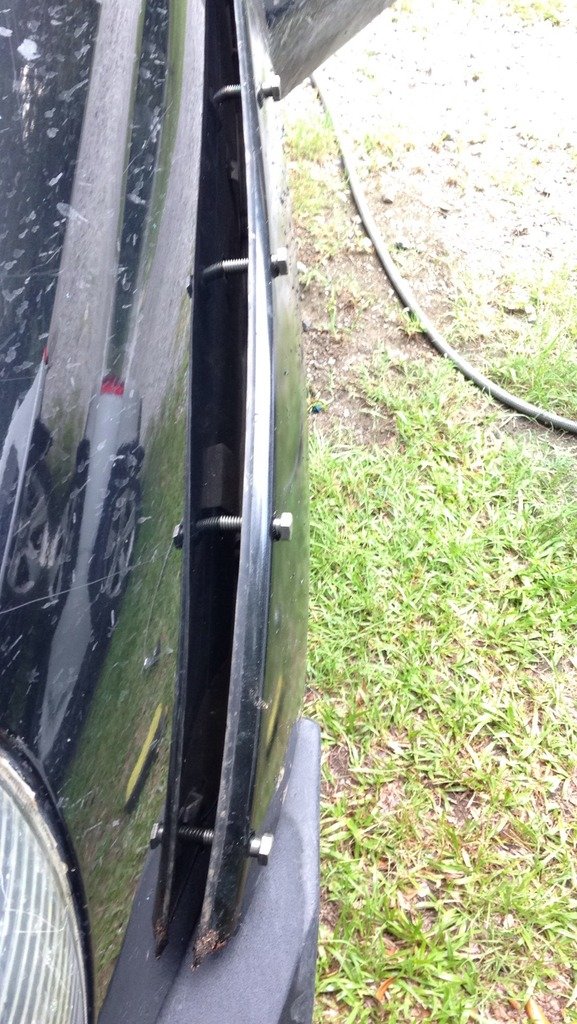

    make sure all the bolts fit into the holes you drilled and align the flare and turn the bolt into the fender. the threading of these bolts grip the fender and you won't need any nuts unless your paranoid. I've gone about 1k miles now and they're still solid.
    if you have any broken bridges take a sharpie and mark from the inside of the fender holes onto the flare. then remove the flare and drill where you marked from the inside.
    now tighten them down securely. i tightened mine just enough not to warp the flare. i used a socket with tape on the end so i didn't scratch up my flares too badly.

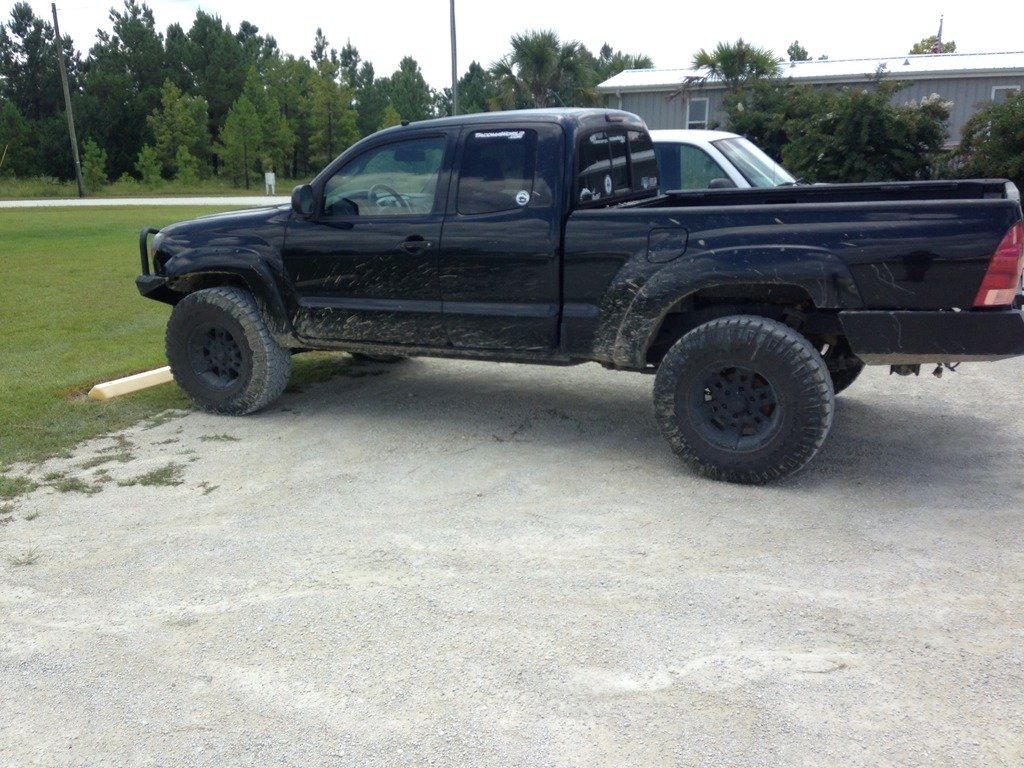

    now do the other 3 the same way and enjoy your removable flares

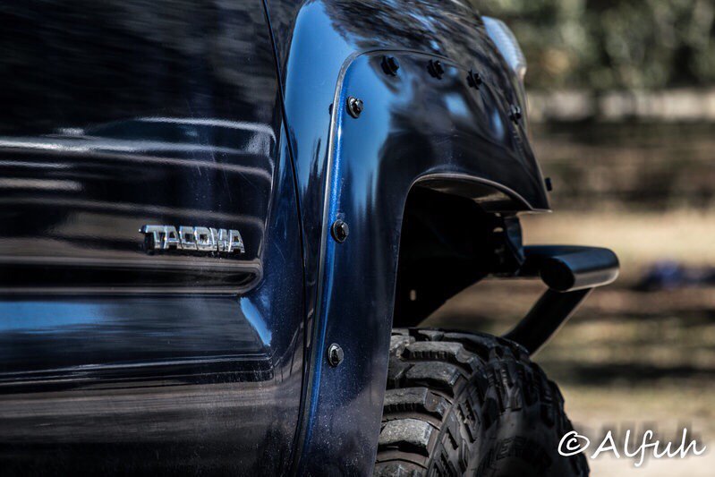

    shoulda used these :cool:
    or
    or better yet :D

    So the bolts thread directly against the paint and body in the holes? Potential rust locations?
  13. Aug 26, 2015 at 8:06 PM
    Boogyman
    Boogyman [OP] Black Tacomas Matter
    Aug 17, 2012
    #84975
    13,225
    Phoenix
    Chesapeake, VA
    BSP 06 4x4 SR5
    Fox 2.0 IFPs, superbumps, LR UCA, Walker Evans and Dakars
    Maybe if you scrape all the paint out of the fender clip holes when threading but I didn't see any getting scraped off. I'm in SC so rust is far from a problem here. You should be fine as long as your bolts don't rust
