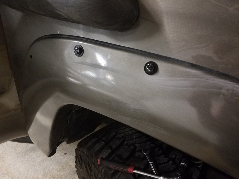

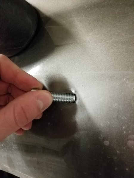

    1st a 3/8ths bolt without a nut on the back will grab but not nearly enough imo.20160423_173521.jpg

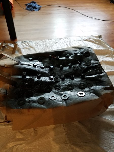

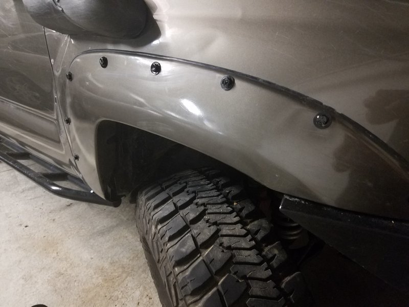

    2nd, a close up of with and without washers plus the stainless look if you're into that sorta thing.
    Paint is curing now but will update with pics of them on soon
    Crom, Rattletrap66 and Boogyman[OP] like this.
