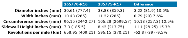

    Can someone explain this stuff to me? Looking at different tires and wheels and their sizes and I see stuff like bolt patterns. Does it really matter other than how it looks or does it affect the ride? I kinda understand offsets, but to be clear, does the offset basically mean how far in or out compared to the vehicle the tire/wheel sticks out (aside from how the vehicle will handle)? 5 lugs? 6 lugs? I had no idea choosing a good tire and wheel set was so "complicated". Right now I have 265/70/R16 and would like to go with something like a 285/75/R17. Thanks in advance.

    Yes it matters for wheel fitment. If you don't get the right bolt pattern (6 x 5.5), the wheel won't bolt on. Without the proper backspacing, your rims may rub the CA's and the tire may rub the wheel well.

    Yes because those 33" s probably won't fit with out it.
