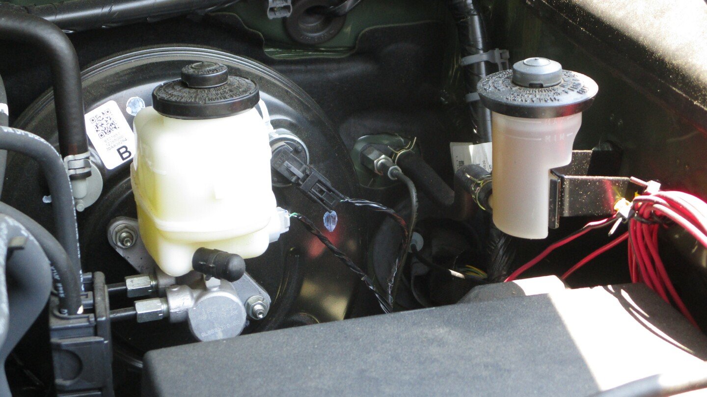

    The two M8 bolt holes on the driver's side are for the clutch fluid reservoir on certain models (manual OR's, for example).
    My Sport did not have a separate clutch reservoir. It was combined with the brake fluid reservoir. I thought it might be a good idea to have the two reservoirs separate. So I located a near-new clutch reservoir from a wrecked European Land Cruiser, in a junkyard in Bulgaria, of all places [!]. A cheap price on ebay, but I wasn't sure I'd ever receive it. Well, it finally arrived, and I installed it, capping off the outlet on the brake reservoir (see the picture below).
