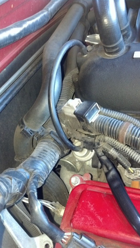

    Here you go -> OEM FPR Mod

    I tried the simple FPR mod of attaching the vacuum line from the intake tube to the boost port for about a week - however I didn't really like the throttle response change that I got from it. For me it seemed like power, while feeling more linear, was slower to come on with throttle input. I put the line back on the intake tube and I feel my setup that way gives me the best throttle response.

    yes I completed it on my truck, 2013

    Can someone explain how this mod is an advantage? Normally the for gets vacuum only from intake correct? How does sending a positive pressure affect it?
    My 2010 with s/c runs full rich at wot and I would like to slightly lean it out, already running 2.85 pulley and volant CAI with ram air scoop

    Normally the FPR sees neither vacuum or boost.
    I would completely explain everything over again, but right now, I just don't feel up to it. Your question has been answered in the link that I posted. :thumbsup:

    Read the entire thread but don't understand why I would need more fuel pressure if I am running full rich...
    This mod seems to increase fuel pressure/flow right?
    I don't want to be running full rich... And already am, so I don't want more fuel pressure...

    You understand the part about being an '09+ then correct?
    This mod increase what you said, so that you increase the effective flow rate of the injectors so that they can support a little more HP, with out hitting MAX IDC.
    Basically, add a 2.7" pulley to get more air, or get a wire in aftermarket ECU of some sort that will allow you to tune it for proper AFR's.
