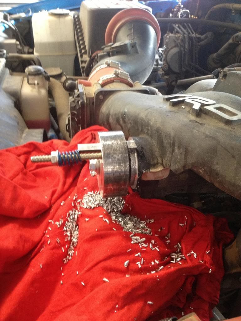

    Roger that, anyone have a snout turning tool they could loan a brother?

    I have a question about that snout tool. Why would one need to machine the supercharger down? Why wouldn't you just machine the pulley to a larger id? I assume im not the first to ask this, but wouldn't you just pull the old pulley off, measure its id with calipers, measure the of the snout, figure your press fit tolerating and then apply it to the machining id of the new pulley?
    I would rather be running tools on the pulley not the charger snout, but thats me.

    If you make the OD of the pulley .25 or .5" smaller than stock the snout is too big, the snout was designed for a 3" not a 2.7 or 2.5".
    The 2.825" needs no mod to the snout just only slightly decreases clearance.

    When the O.D. of the pulley gets smaller, so does the I.D. When the pulley gets to a small enough size, the snout has to be cut.
    URD sells the tool. Super simple to use.

    The snout cutter cuts the snout, not the shaft. But like tor said, as you go smaller the clearance becomes an issue between the inside of the pulley and the body of the supercharger unit aka snout. It would be easier to show a pic i guess

    Here's an example of the tool in use, you would have found this in my build thread

    Ahhhhh this makes sense now, I didnt know it was that close of a fit to the housing, I never really looked at it that well. I always thought they were changing the shaft diameter and was like "well thats effing stupid".

    Yeah you really need a picture to picture it in your mind way better lol glad it helped
    I would have gave you mine, but I sold my cutter already
