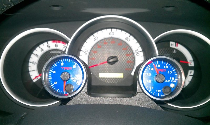

    Got my gauge and wideband installed. Not completely sure of its accuracy tho as I am not sure how it is supposed to behave. It is at 14.5 (supposed to be 14.7) at normal driving, but that could be due to the sensor's location. When I floor it it goes down to about 11 and then bottoms at 10 near redline. Also notice that it doesn't really drop the AFR unless you are really getting on it. Is this normal behavior of the ECU for detonation/knock regulation? Either way here are some pics of it installed.

    Sounds just right to me.
    Play with your throttle more. You'll be able to notice when it goes from Closed loop to open loop, by AFR change.

    Yeah I mess with the throttle and it will wiggle up and down by about .2 unless I mash on it and once it gets up in rpm is will work its way down. I can get it to hover in between at like 12-13 by playing with the throttle, but as soon as it shifts or if I floor it it will go down or up. Also when I let off and the tranny does this thing where it feels like its "disengaging", the AFR will peg at 18:1. I was expecting this somewhat, but I am not sure if this is exactly normal either.
    I guess i was just thinking it would be more lively overall like the boost gauge but then again its not based on throttle input, Its what the computer decides right?

    How did you fasten the speedhut gauges to the cravenspeed pod holder?
    They are loose when you set them in and don't have studs for the backplate.

    I wrapped a little black electrical tape around the gauges thread area so that they were snug enough when I slid / twisted them in to craven pod. Has worked well for over a year or so.

    sweet, i'll try that too. thanks

    This is the exact same method I used as well.
