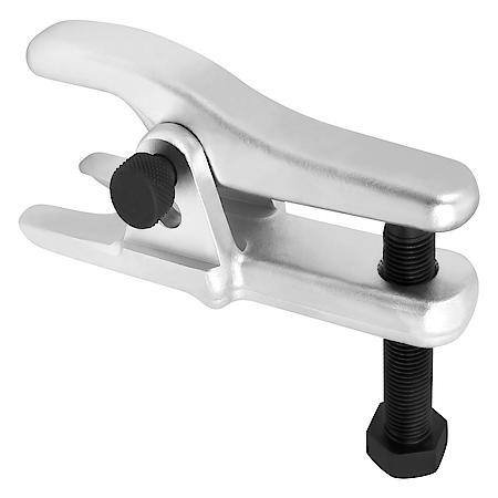

    With one of these I do a boot a side in 5 min......and count your revolutions when u take the outer off......or just 'set' that nut at correct stop.....so you dont have to get an alignment.....
