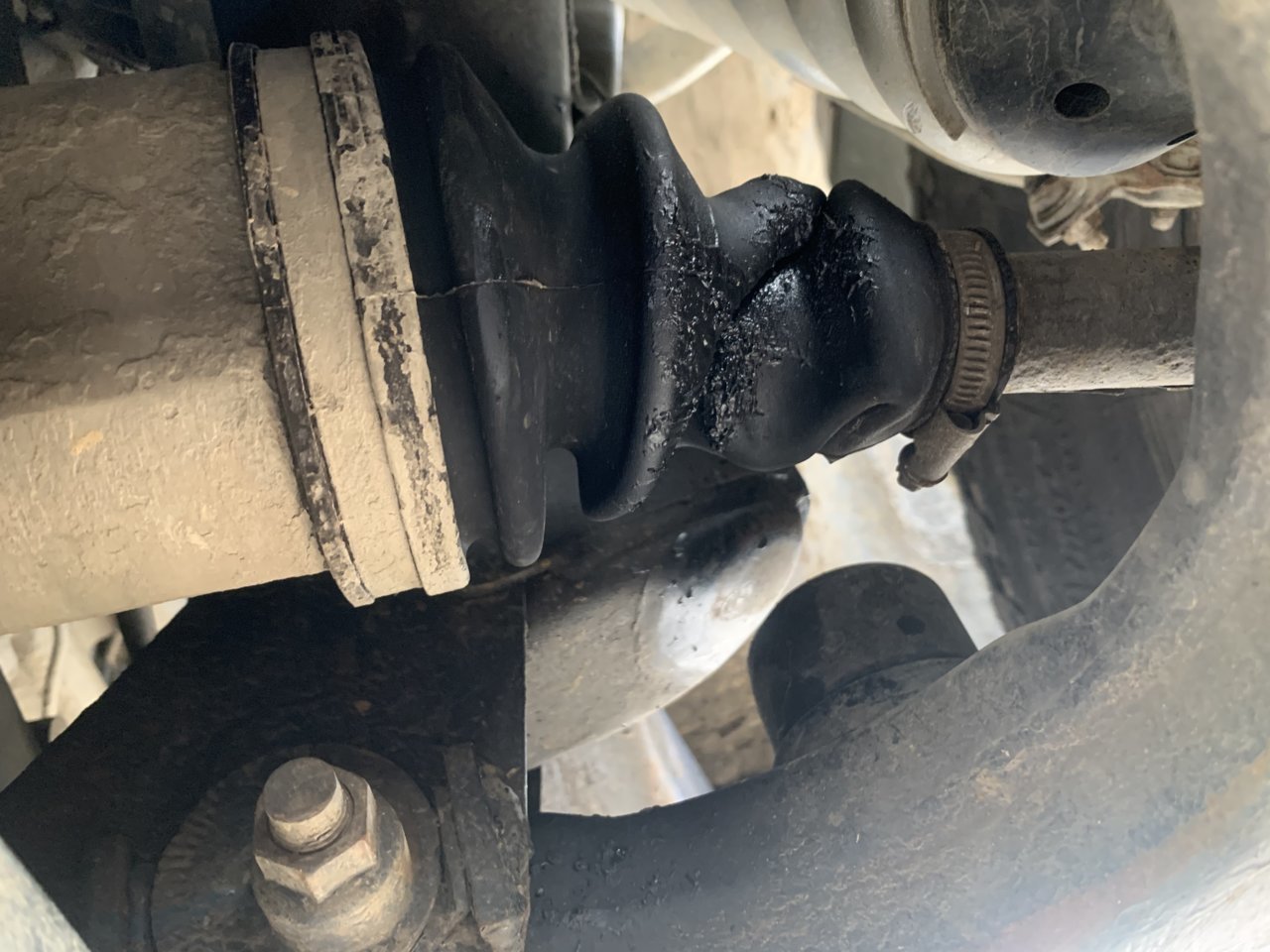

    Both sides have the boot slide mod but now this happened, and the clamp busted off the other side of the truck and split the end of the boot.
    thinking about cvj boots instead of sdhq
