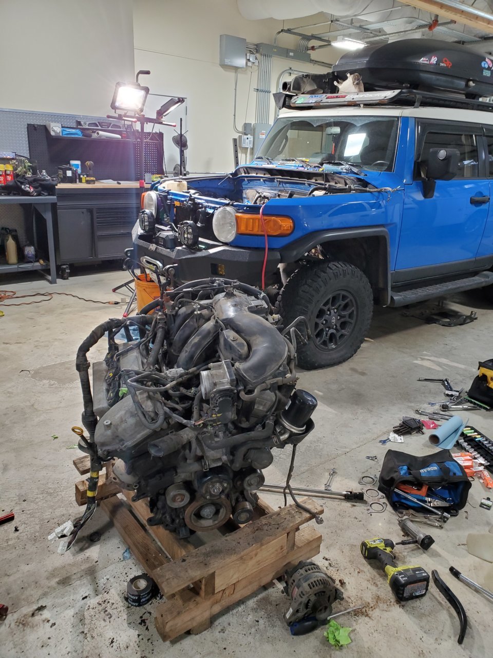

    Long, long, long weekend. Swapped a motor in a Fj Cruiser with 270k miles on it. Took about twice the time I gussed, due to bolts being corroded, stripping bolts, breaking bolts, and bolts being siezed. Head gasket started to leak, so picked up a motor with half the miles of the original and shes a good runner! Spent probably 20 hours wrenching on it.

    Let me guess…a couple of those bolts were in the end of exhaust manifolds.

    Yup! Broke 3 off on the manifold to downpipe connection and stripped a starter bolt, fun times getting that out post-cuss fest :rofl:

    One of the big starter bolts is not like the other bell housing and is a short bolt. I only know this because I ran mine in and it bottomed out before I realized I grabbed the wrong bolt and I gave it a little extra beans with the impact trying to suck it up. Then snapped it off in reverse.

    After I had my headers installed I kept my manifolds. For shits and giggles I tried to remove the only stud not drilled out after heating it with my acetylene torch with it in a vice. It still broke. They guy that installed my headers said he soaked them for two days before removing them. He also told me 4.0 Tacoma headers are the second hardest headers he’s ever installed in 20 years of being an exhaust guy.

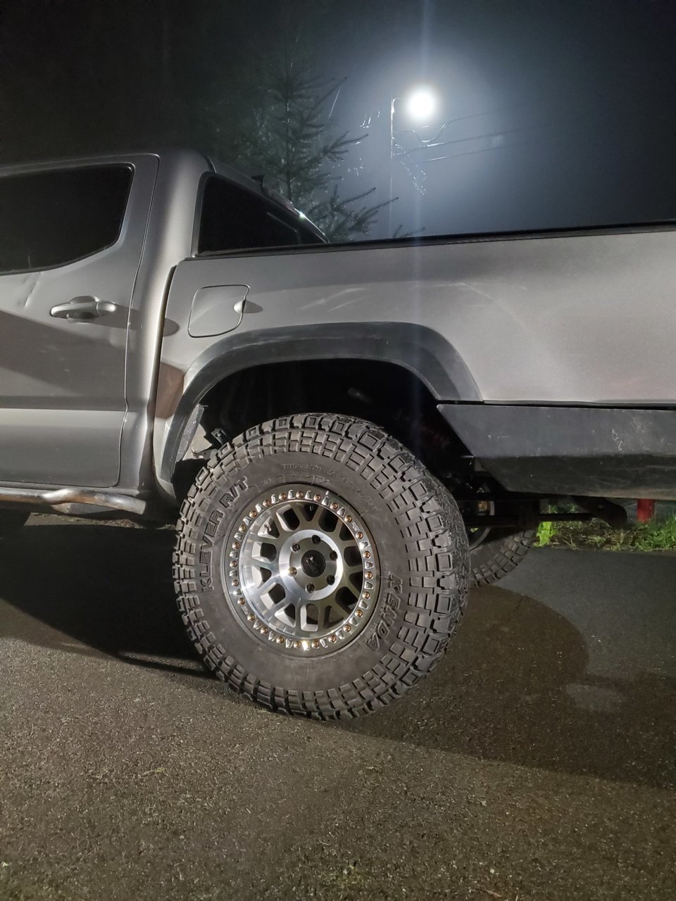

    Also did a thing late tonight! Hand dis-mounted my tires off of my old wheels and had these all mounted up in around 5 hours. Balance is suprisingly good for how worn/beat up my tires are, just a little shimmy in the front end from a worn tie rod end.
