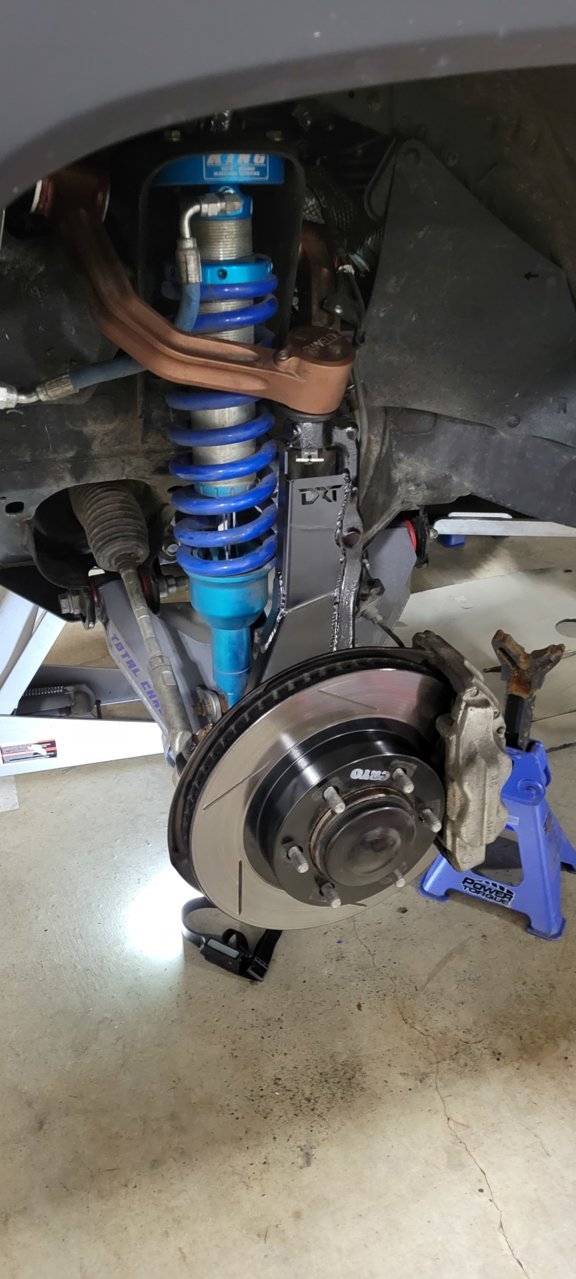

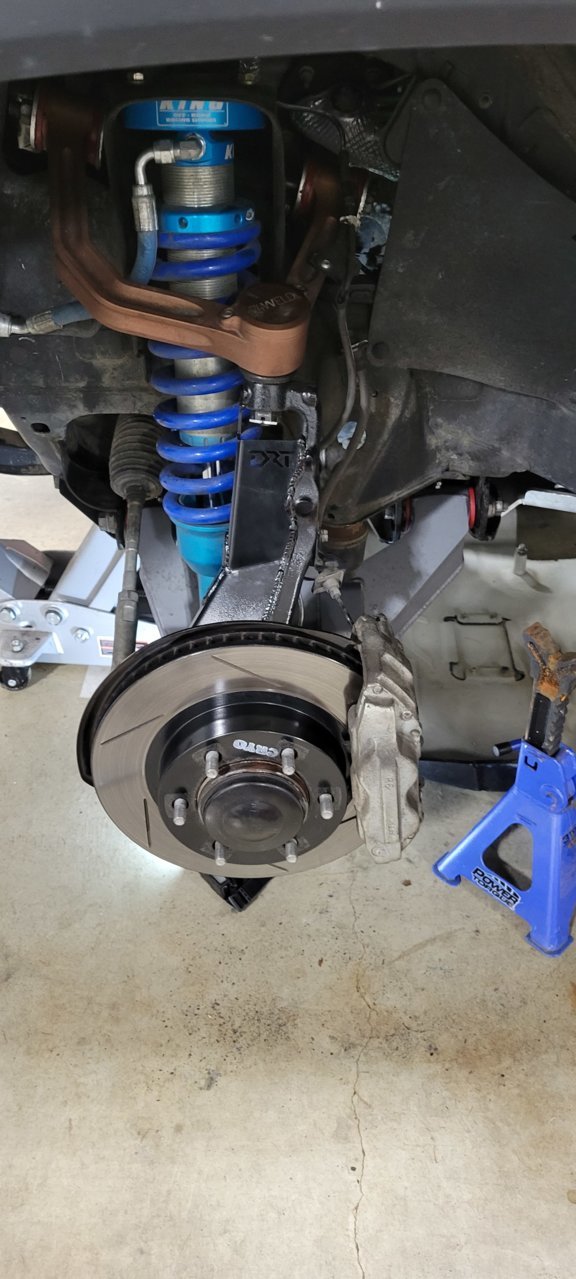

    Nope... standard travel TC LCA's (stock geometry). I'm just a sucker for nicely fabbed parts. Not the most practical investment.

    Sorry... yes, it's a mid travel setup. Extended front coilovers and modified rear Tundra shocks for extra extended rears.

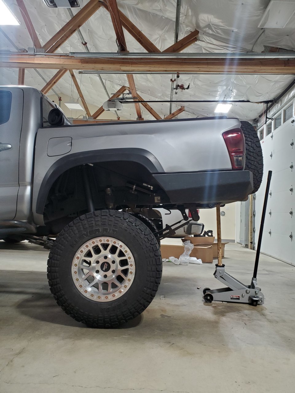

    Threw in my new 16s in the rear, and just got a bunch of misc gussets/tabs so I can start my new bedcage sometime! Pulling 14.5" of vertical travel, should gain another ~1" after I redo my upper shock mounts so should be getting 16" or so here soon.

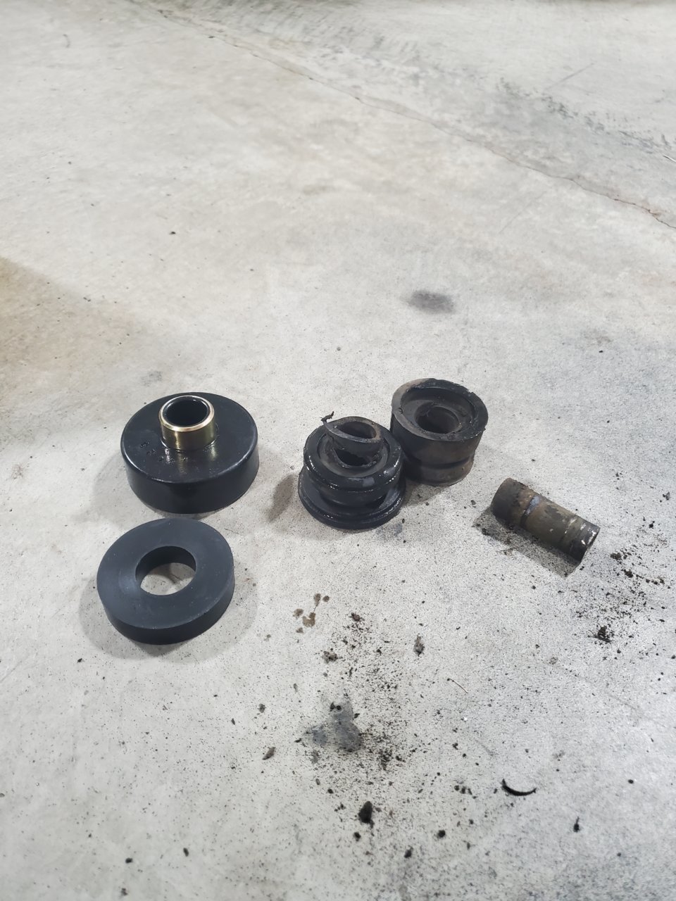

    Quick 10 minute job, poly core support bushings! No more rattley front end.

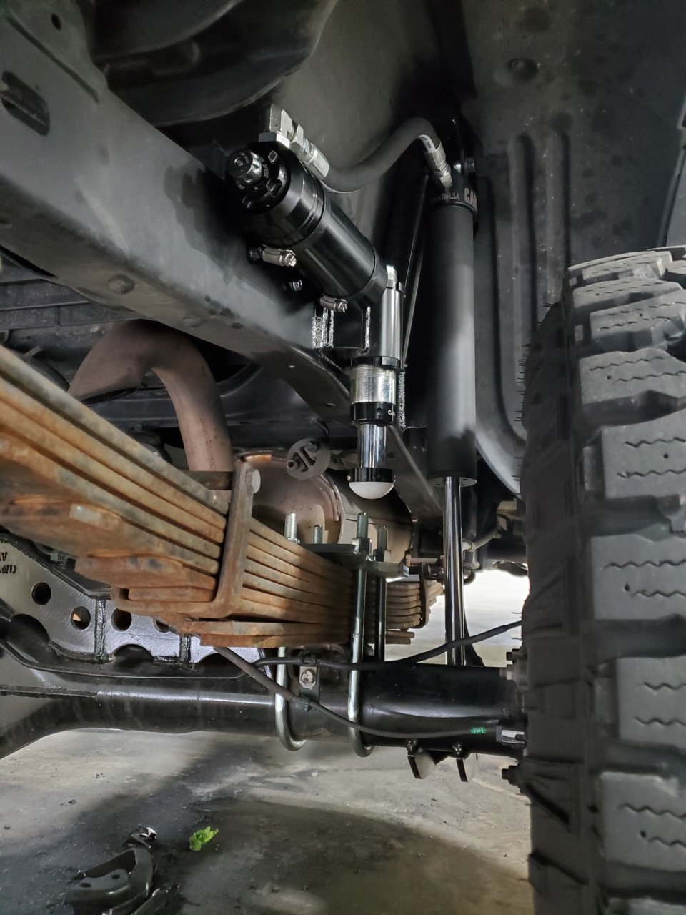

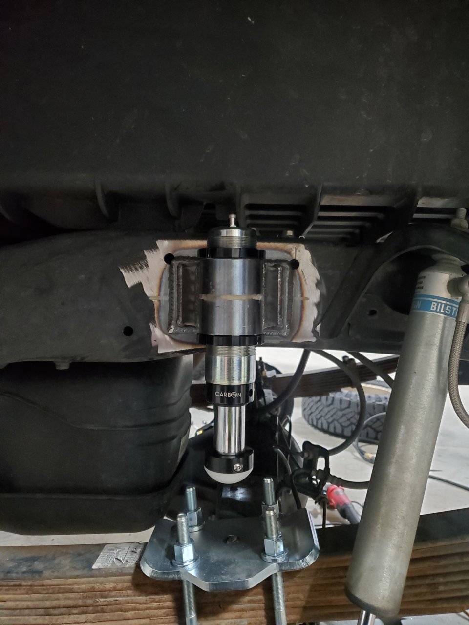

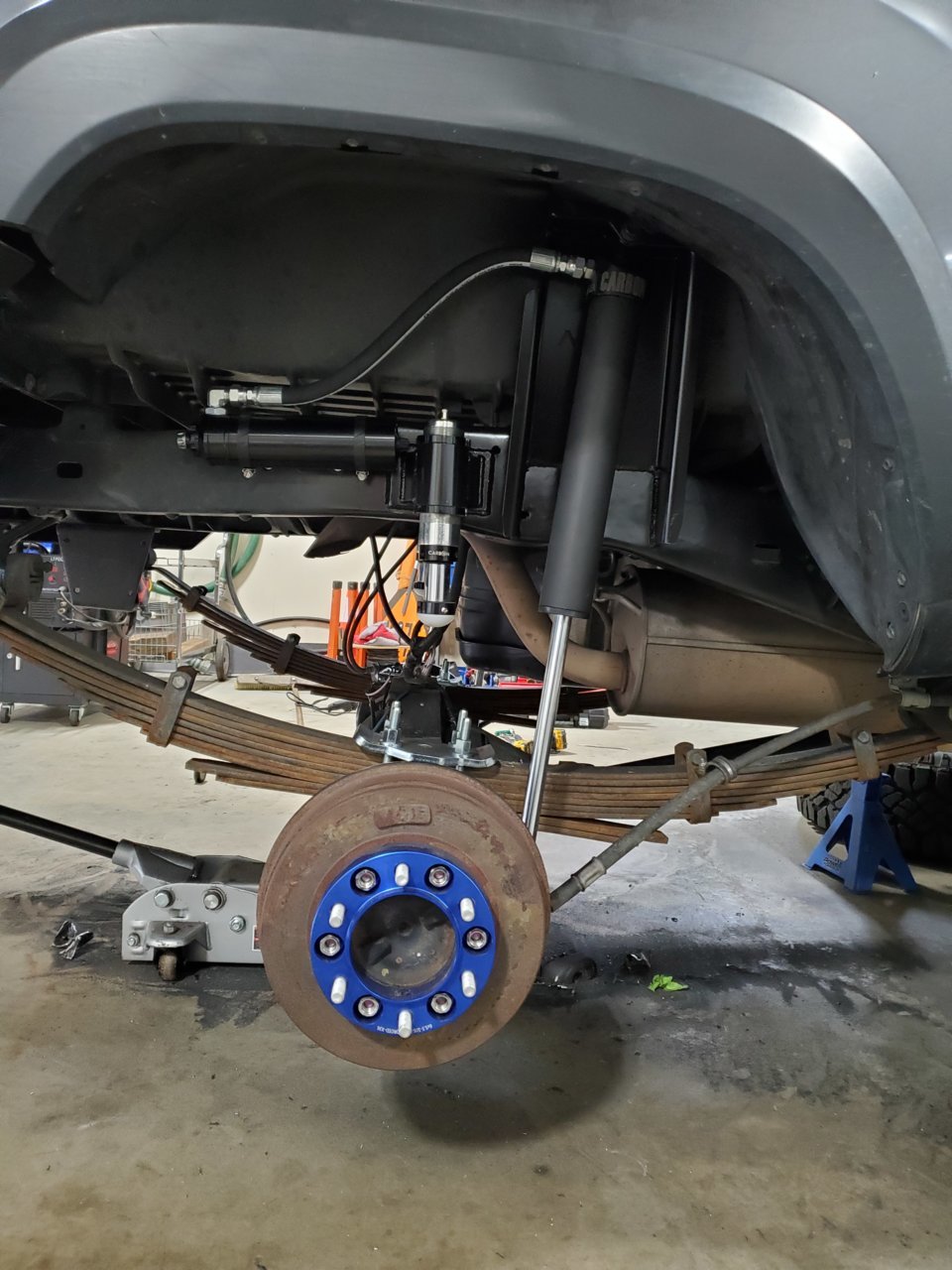

    Some 2.5x12" Dual adjuster Carbon shocks mounted via @ARCHIVE shock towers and 2" hydro bumps/homemade mounts for @lefty9206 the other day!
