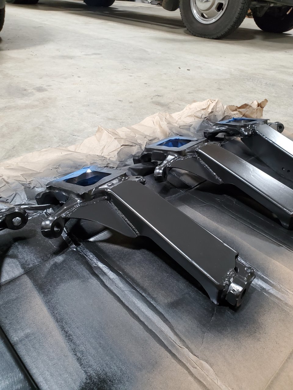

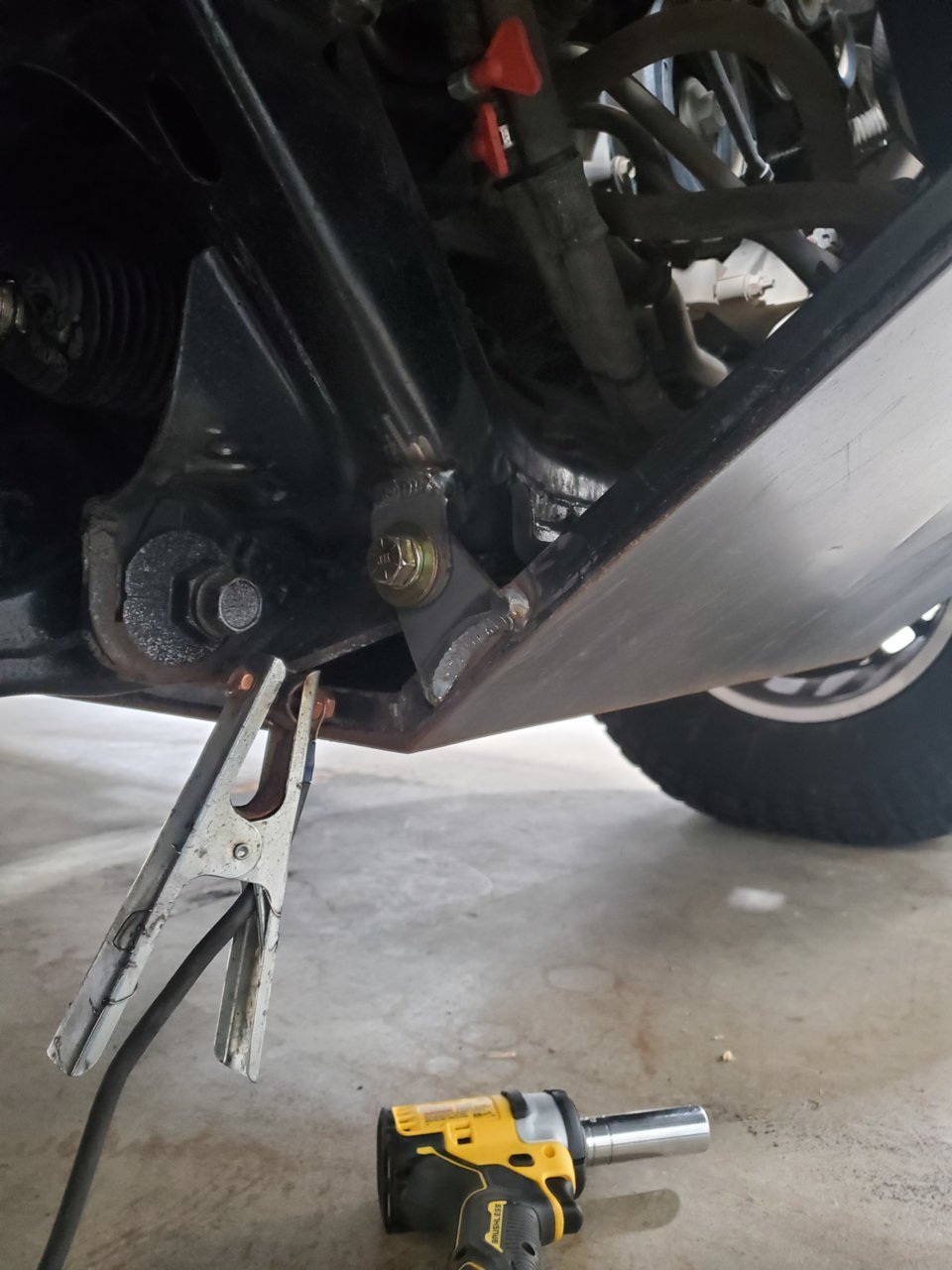

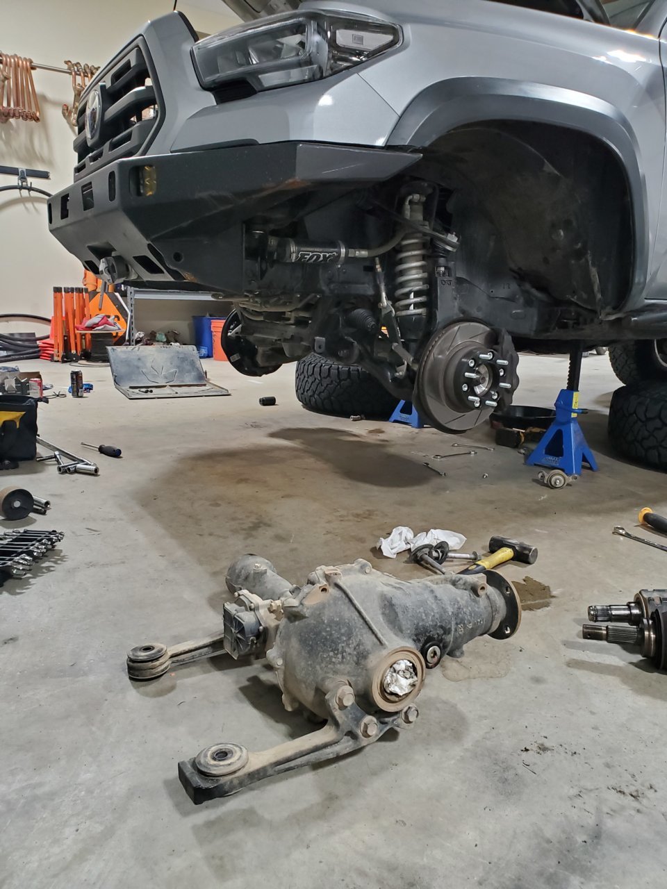

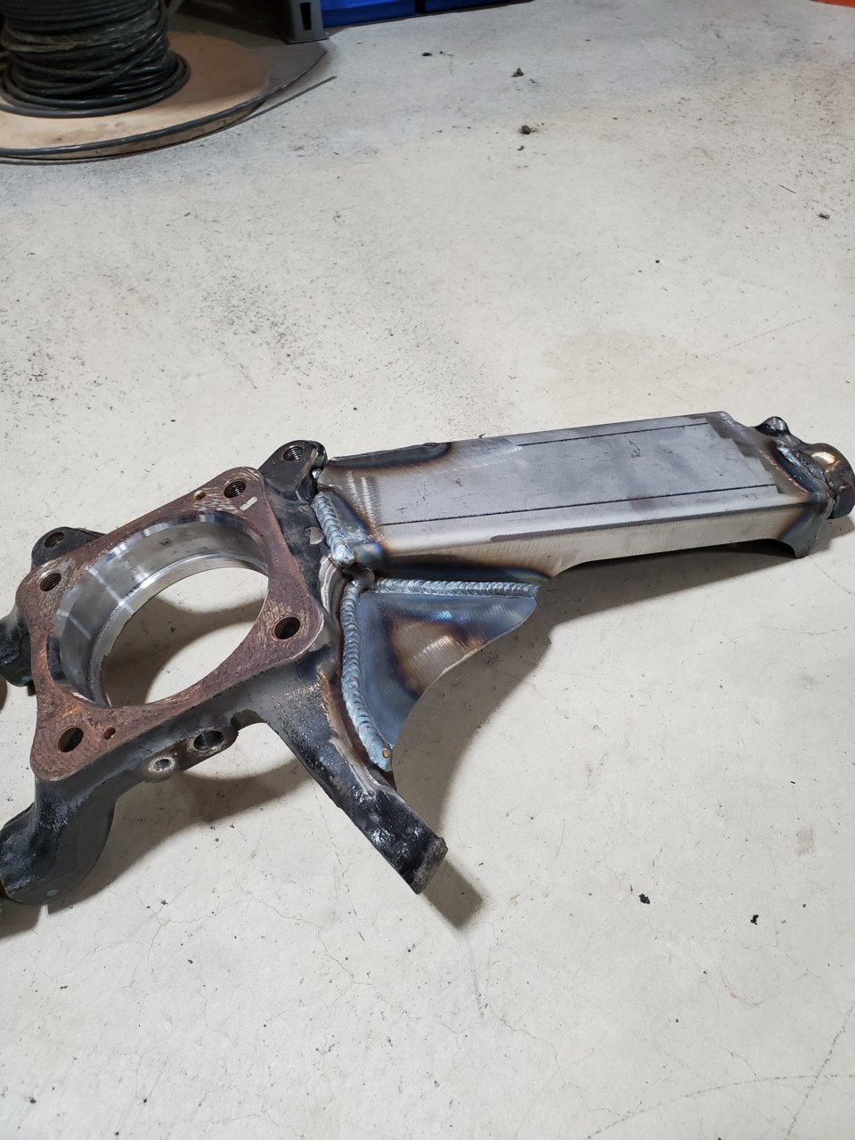

    Finger is pretty much healed (still cant feel anything in it) so taped it up and pulled my diff last night. Front locker going in this week, then just gotta slap the diff back in sometime. Also doing some more gusseting to the frame, skidplate, and also the rear diff mount while its out.

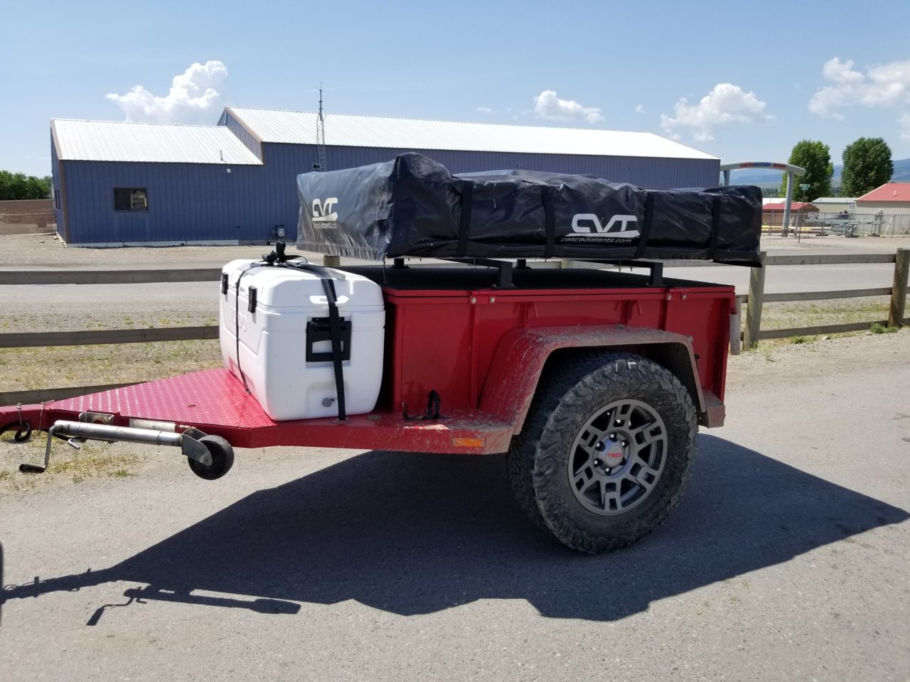

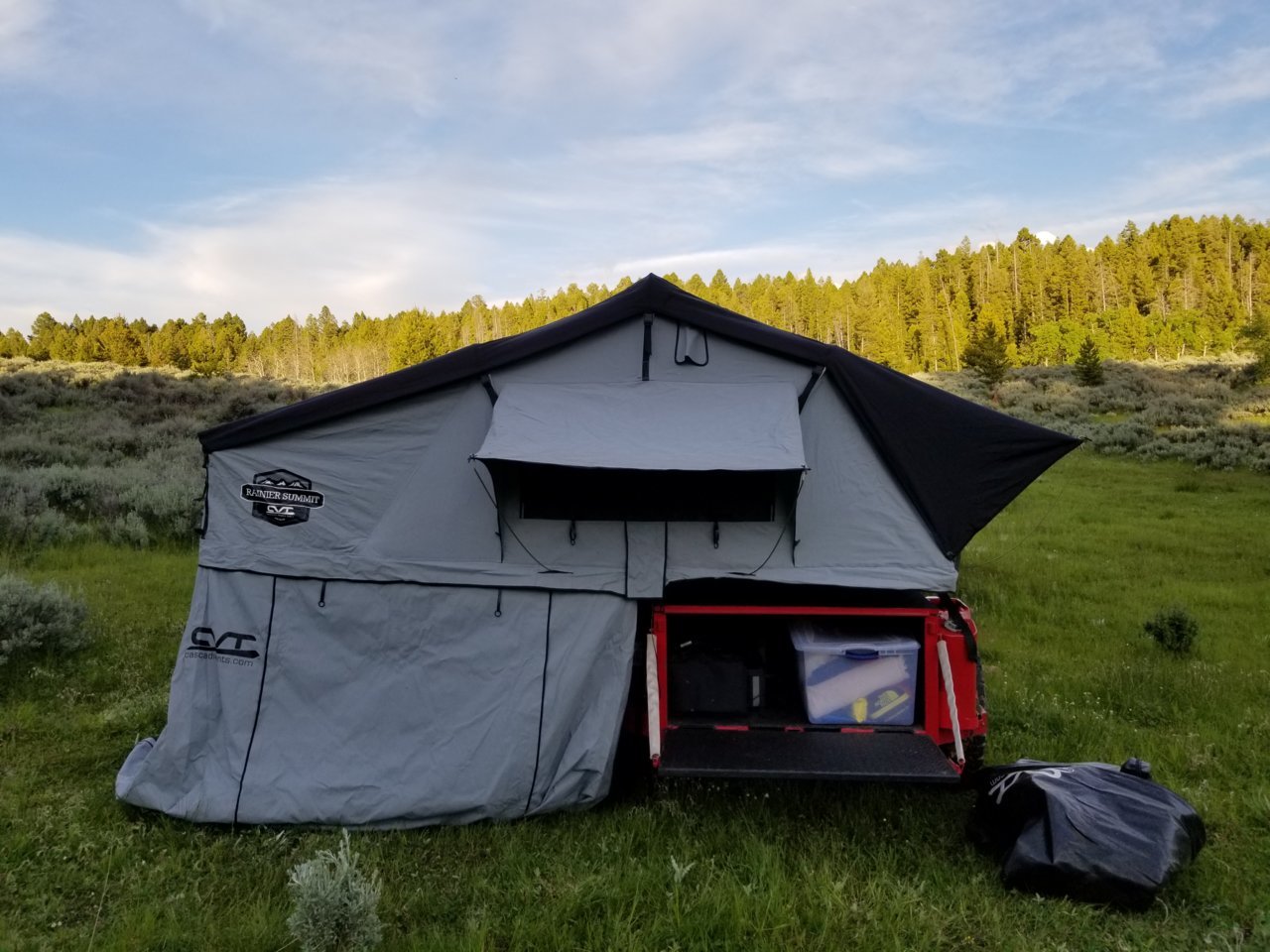

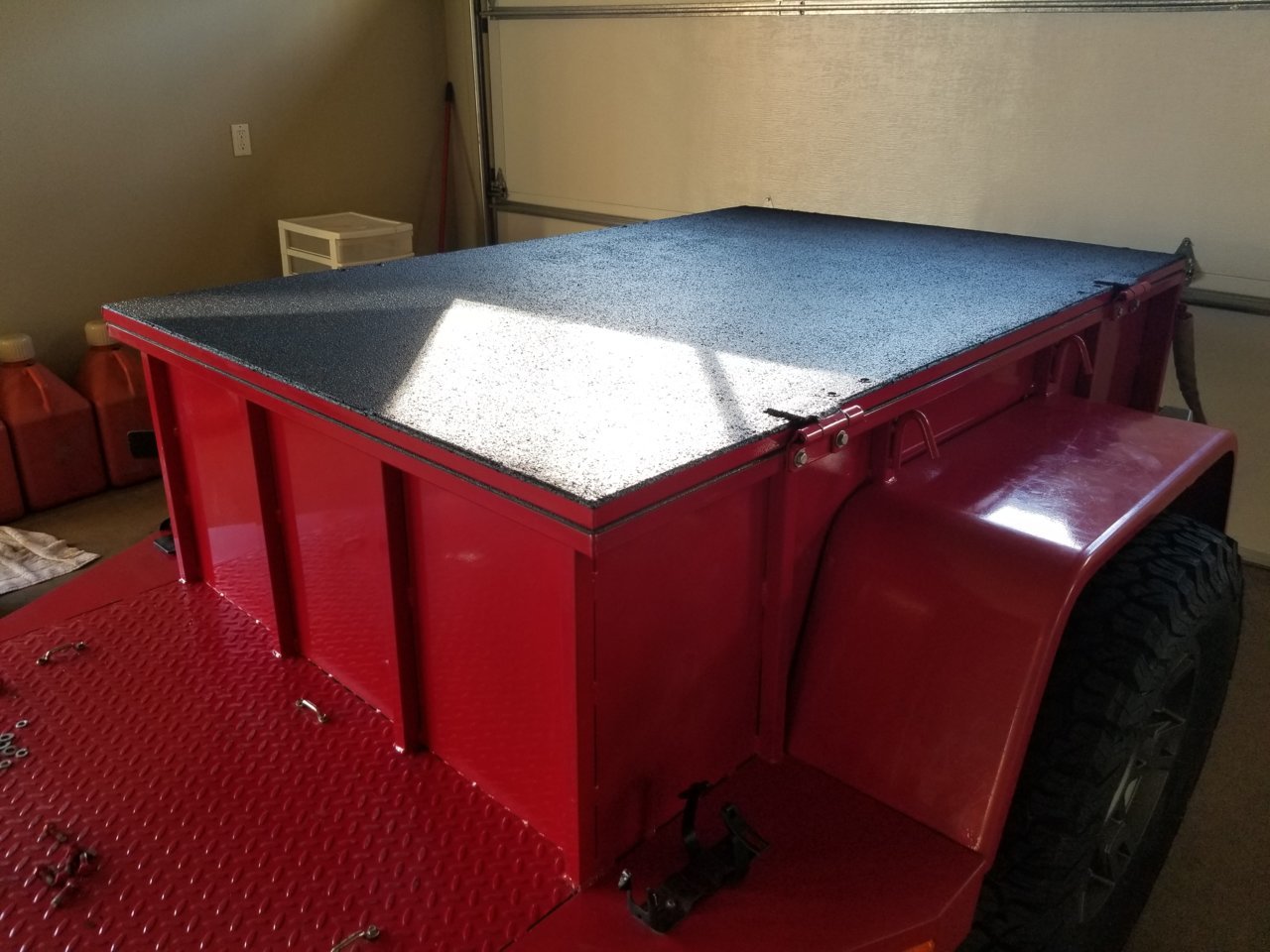

    Any interest on working on a new tent rack for my trailer? At a bare minimum, I'd like a rack that provides 18" of clearance from the bottom of the rack to the top lid. Ideally, I'd like a rack that provides that 18" clearance, but can also raise up to provide more clearance when the tent is deployed.
    The issue with the current height it that it doesn't allow the tent annex to fully deploy. You have to duck into it and it's a PITA. I'd also like to transport my kayak below the tent rack on my way to camping.
    Let me know what you think. I have a few ideas floating around...

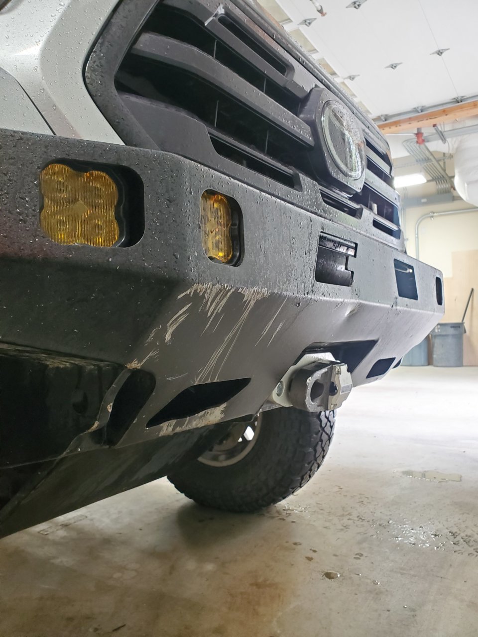

    Plated front frame with 3/16" and extra mounting bolt added to the front bumper.
    Put it to the test :oops: Bumper bolts didnt move, plate dented/bent

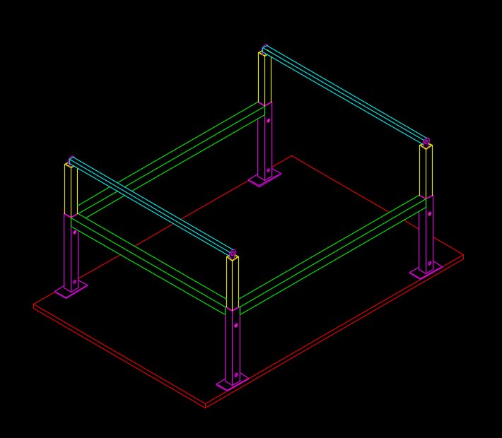

    Here's what I was thinking...
    Initially, I was considering telescoping tube steel for the legs (size required TBD).
    https://www.mcmaster.com/telescoping-tubing/telescoping-weld-together-rails/
    But I'm concerned with the wall thickness. As an alternative, perhaps I could use 2" receiver tubing for the legs... I'd also like to place gas struts on each leg, so it could all be raised and lowered by hand.

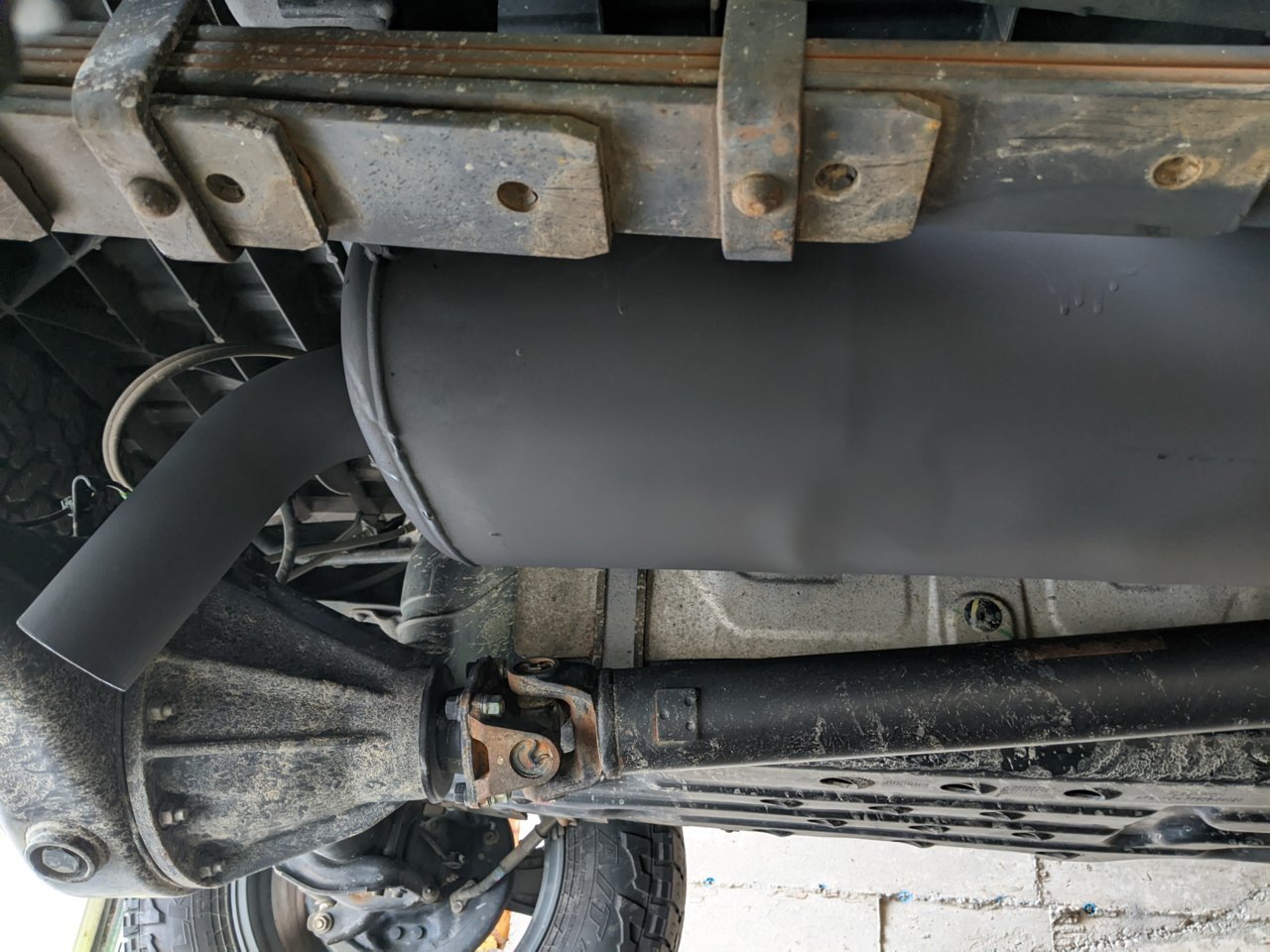

    @Buttskevin21 working his hot snot magic.
    I really appreciate the excellent work and the killer exhaust note. I was blipping and playing with the throttle the whole way home.
    Thank you!

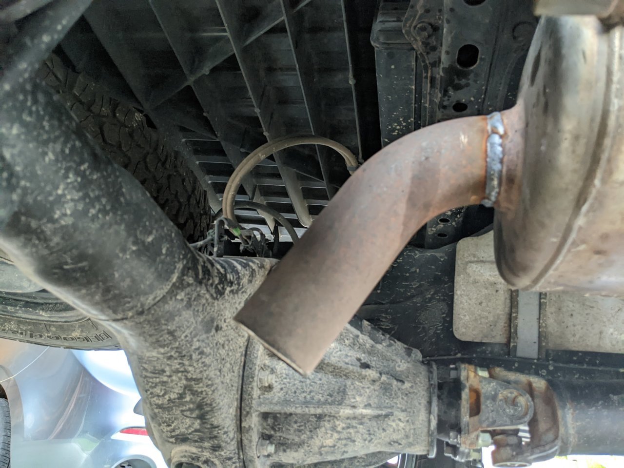

  18. Apr 19, 2022 at 8:38 PM
    #118
    tonered
    tonered bartheloni
    Sep 25, 2017
    #231055
    31,243
    tony
    Lynnwood, WA
    Long and gerthy? :rocket:

  19. Apr 21, 2022 at 3:39 PM
    #119
    Buttskevin21
    Buttskevin21 [OP] Well-Known Member
    Dec 14, 2020
    #349654
    2,490
    Kevin
    Washington
    2019 Brocoma, 37s, Lt, Dual Tcases, blah blah blah https://www.instagram.com/kevinjbutts/
    Stock-ish
    Whoop whoop! Another thing I could do that I didn't think about, is trim the tip so its level with the ground. Might look a little nicer!
  20. Apr 21, 2022 at 4:58 PM
    #120
    tonered
    tonered bartheloni
    Sep 25, 2017
    #231055
    31,243
    tony
    Lynnwood, WA

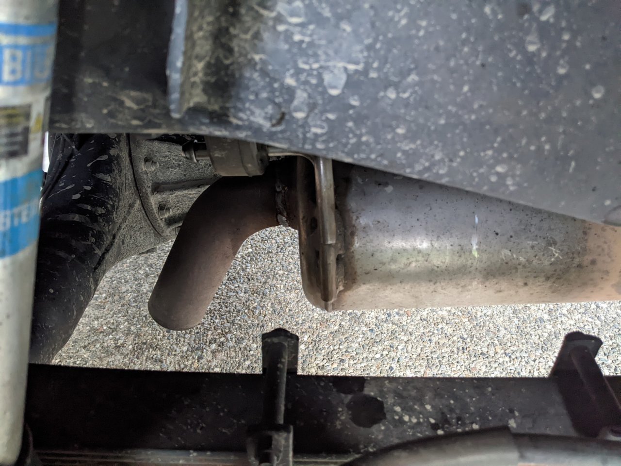

    I do have a ding in my old muffler. If I get a scrape, I'll trim it back.
    It is in a great spot DD-wise.
