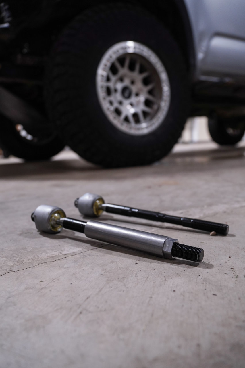

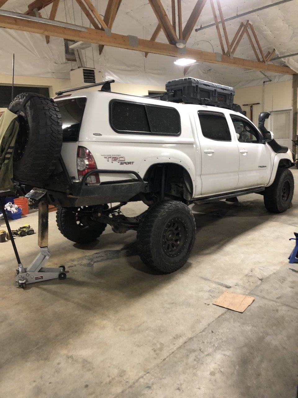

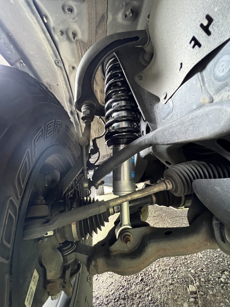

    Rubicon in just over 2 weeks, so going through the whole truck/fixing a couple things.
    Picked up some Warfab tie rod sleeves, good piece of mind. Intent is to strengthen them just enough to not bend the tie rod as easily, but not strengthen the tie rod assembly so much (like a heim setup) that the rack becomes the weak point which is bad/not as easy to change as a bent tie rod.
    In theory the inner cup area should break/bend or the outer should go, before the rack grenades.

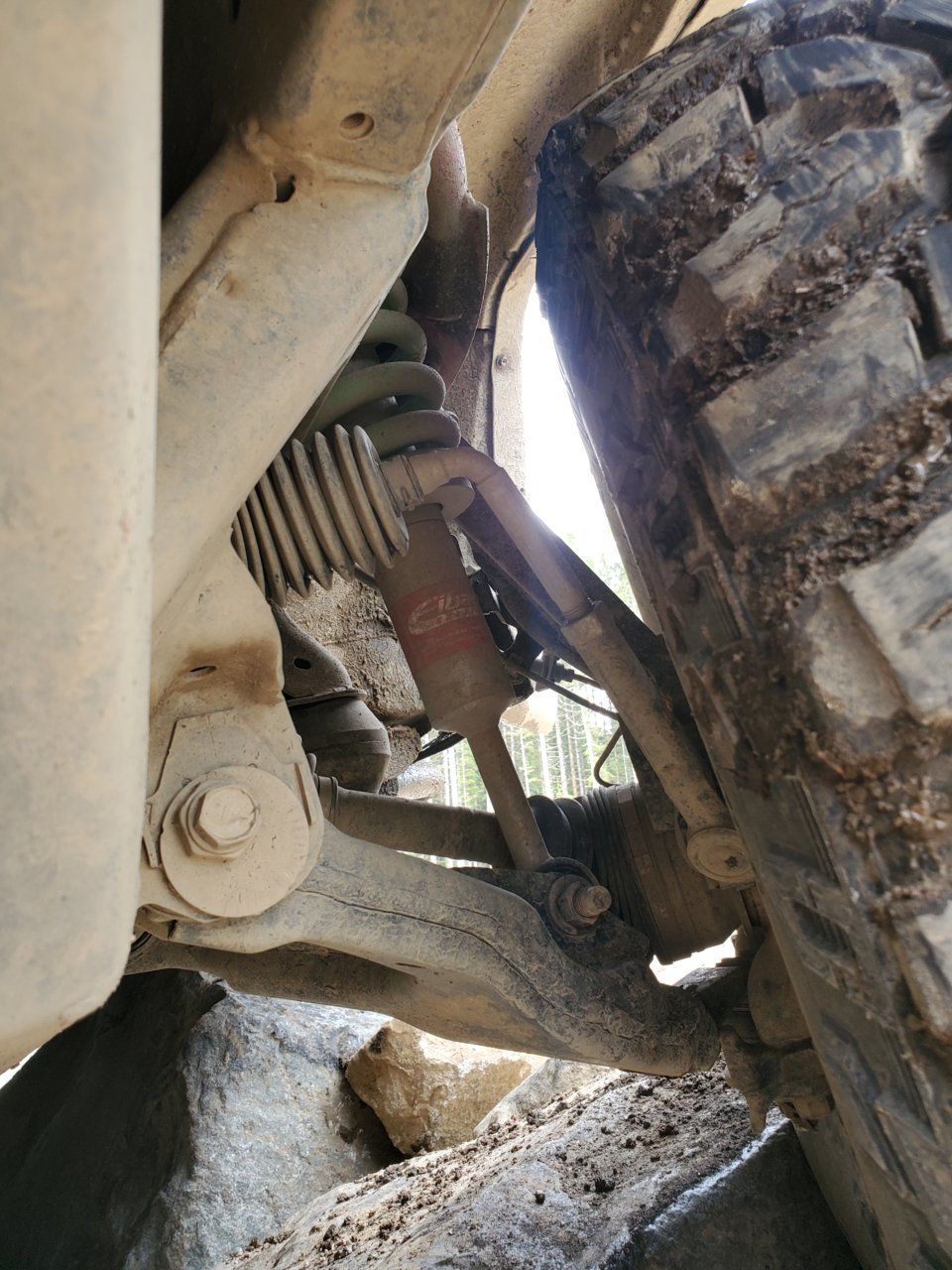

    And a photo of a tie rod a buddy bent this last weekend, in turn binding the cv and breaking the diff mount, and eventually breaking the outer as well. Pain in the ass to change it in place as we couldn't just winch him out.

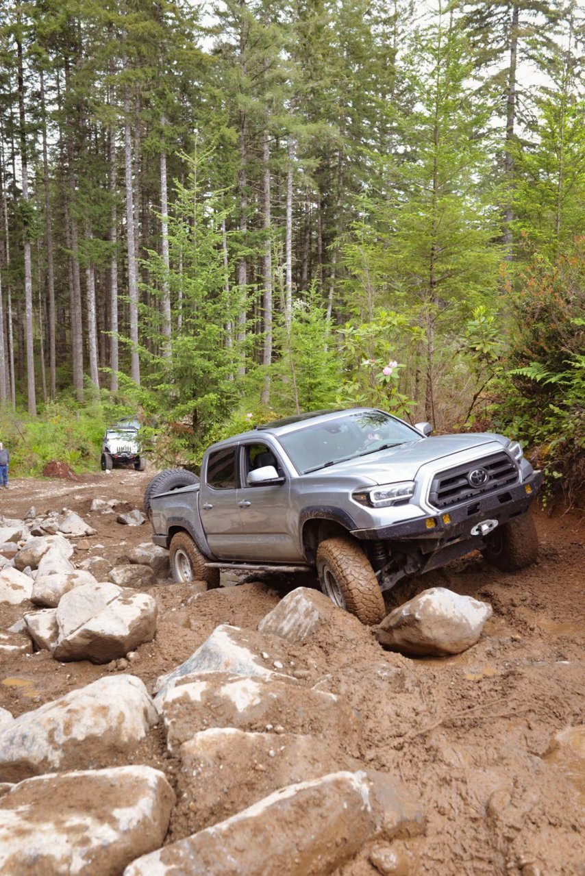

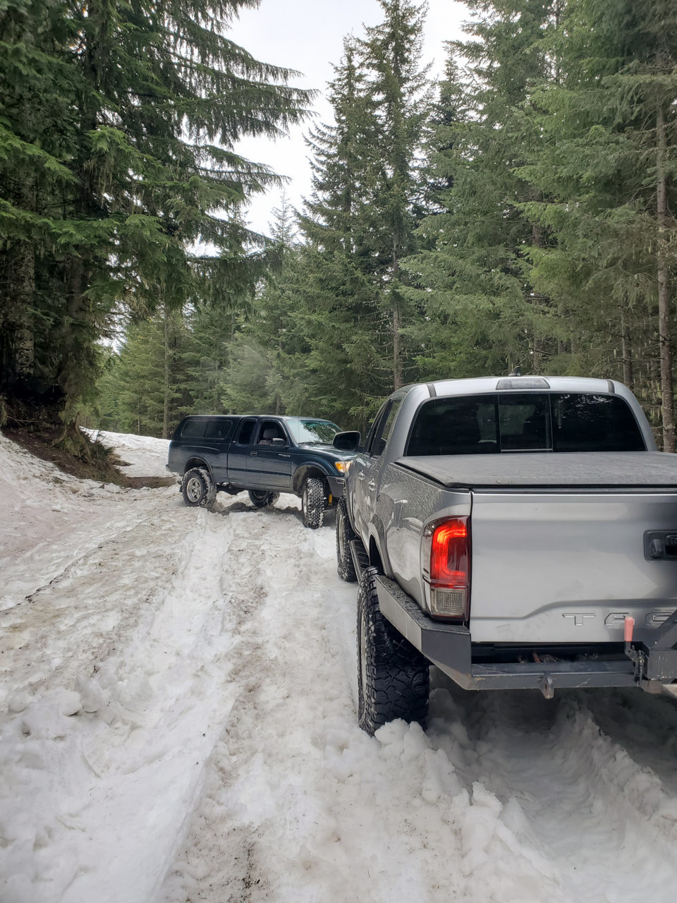

    They kick ass, probably the best all around daily driven tire I've had out of probably 20 different tires.
    Just this last weekend I took them through sand, shitty spring snow, mud, slick rock, and dry rock. They have 45k miles on them with lots of negligent wear from either bad alignments or doing burnouts while stuck lol. Think Im going to get 55k out of them before I jump to 37s, in either the RT or their new MT if its out around winter time.

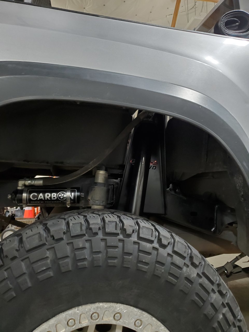

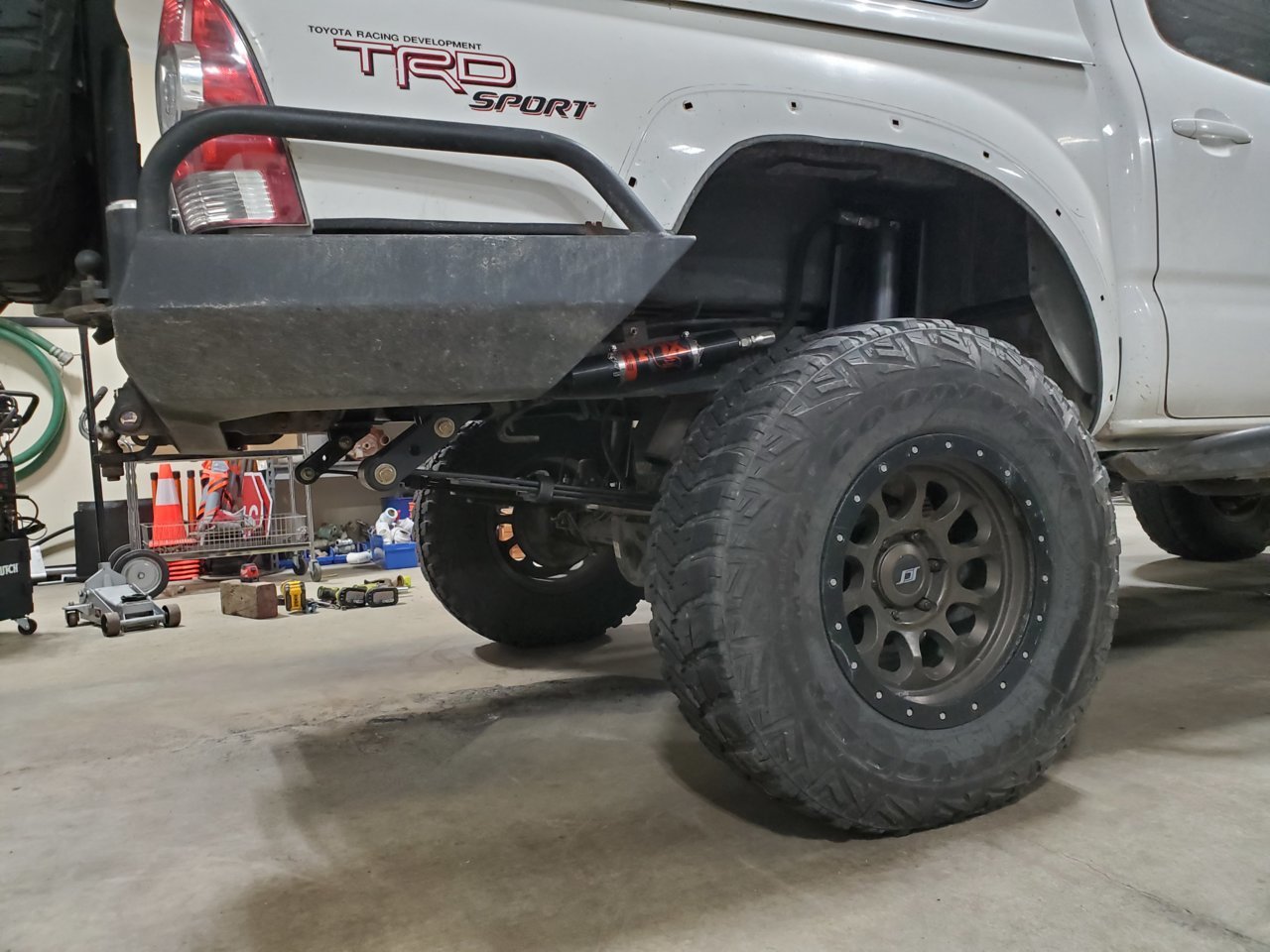

    Also played shock stuff on my truck. Old towers were cut/modified a couple times to my liking, so they looked kind've haggard. Cut them off and went with some Barnes towers, which helped tuck the top shock mount closer to the frame so now I'm finally rub free at full flex. Going to touch up the bed holes someday and make some nice covers.
    Went through the entire truck, changed every single fluid, fixed a couple things, and reconfigured my bed setup. Still need to make another shock tower brace, but it'll do for now. Ditched the tire swingout since it kept breaking and bending, thus also denting my tailgate. Might recess my license plate into the tailgate to basically cut out the dented portion.
