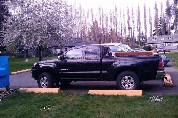

    So I went and got a yard of top soil last weekend and I've discovered that I was way overweight like double the rated payload :eek:. Friend of mine went to the same place with his 1ton dually and the wouldn't give him any more than 2 yards cause he was overweight. Looking back had I known I wouldn't have gotten a full yard. But having driven with a ton of dirt in the back I now know that my truck can handle it, for short distances anyway. The dakar leafs helped a lot I wasn't bottomed out handling was good so was acceleration and braking. As a disclaimer i am going to say I don't recommend or suggest overloading your taco just sharing my experience.

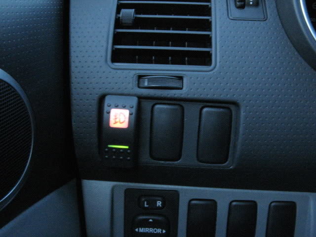

    Hey jeremy sweeeeet build. I wanna learn from u how u did the puddle lights mod. Thinking of doing the same thing. Want them to come on with dome light

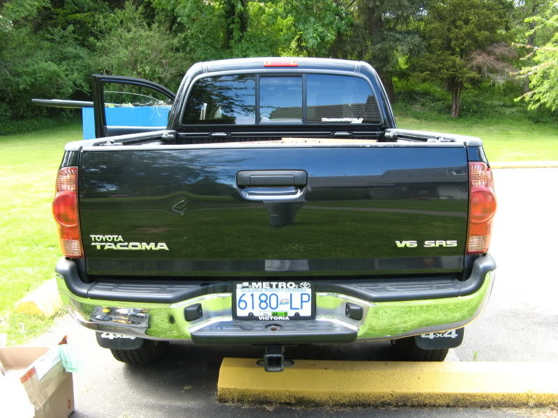

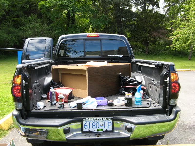

    Alright more cosmetic crap.
    Since a buddy of mine decided to roll his boat into my passenger side tail light I got some 09+ tails from a member on here. Then I figured what the hell I might as well tint them too.
    Ignore all the crap in the back.
    Before
    After

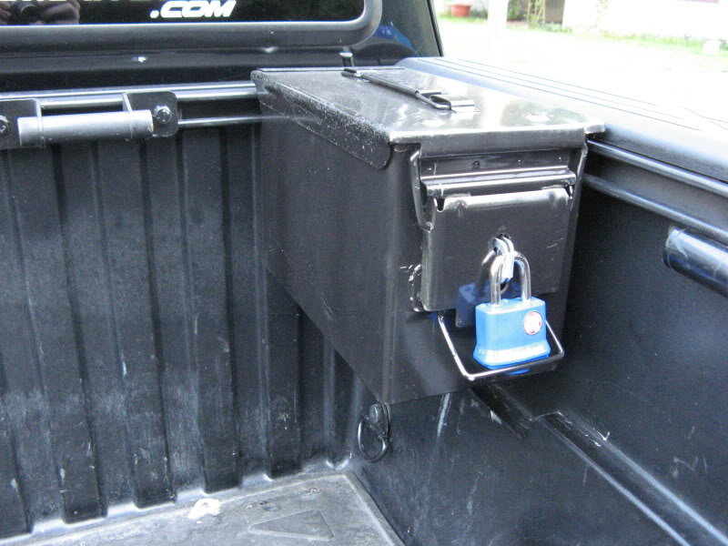

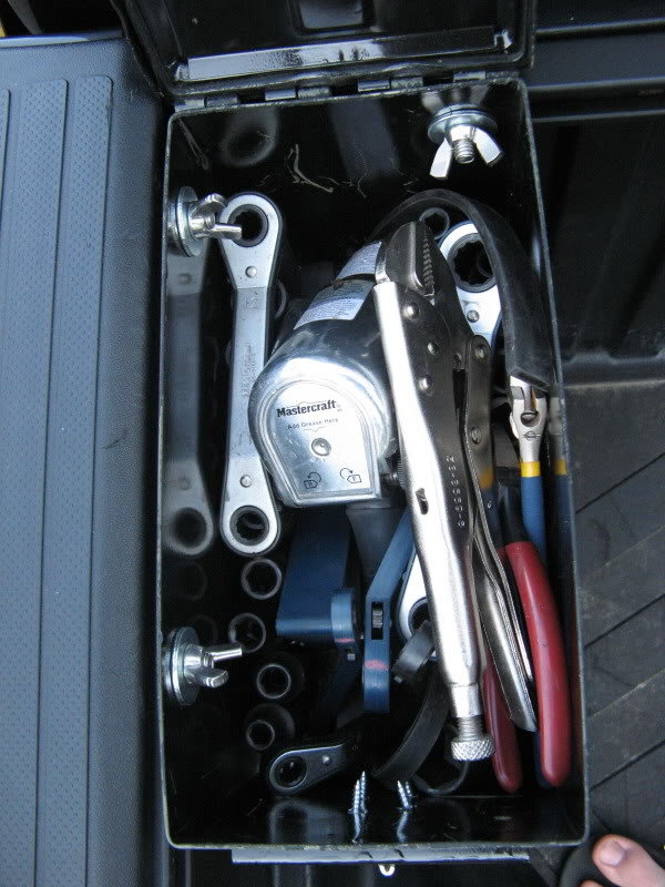

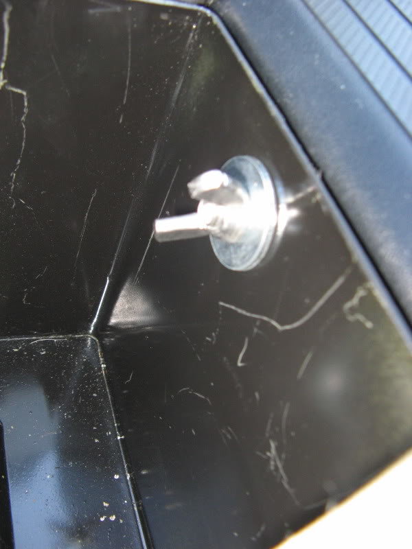

    ***UPDATE***

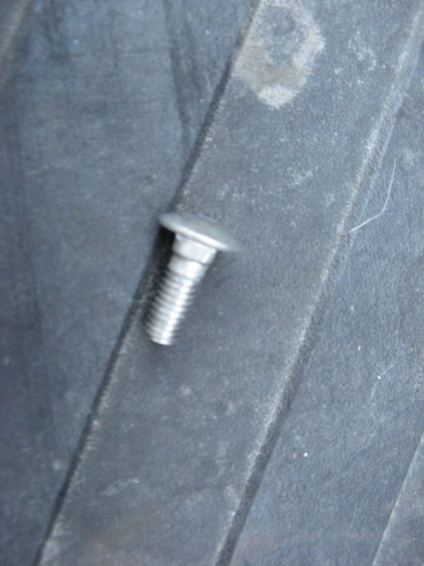

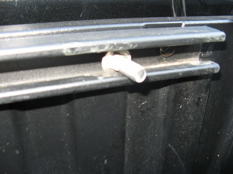

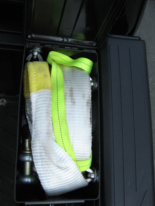

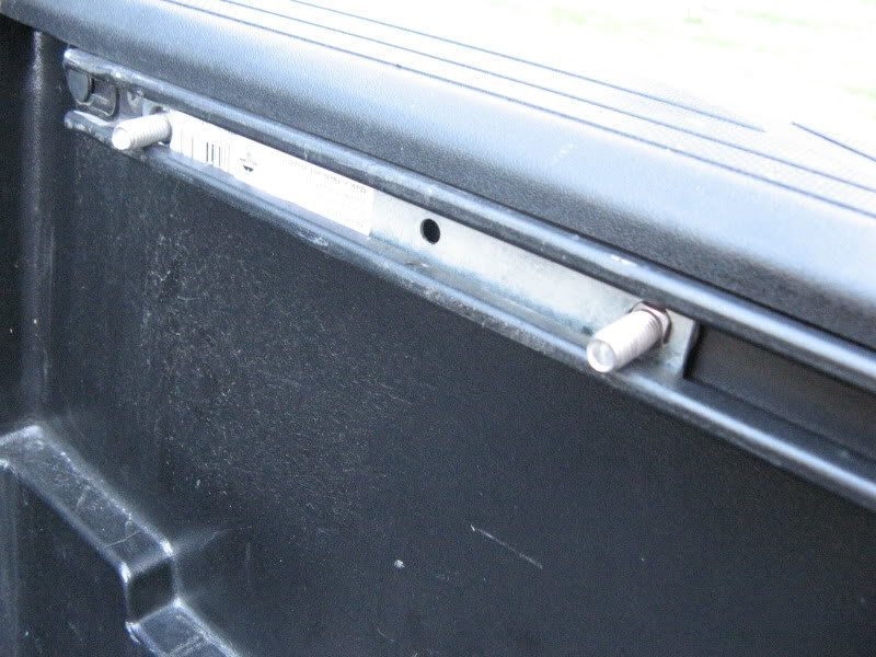

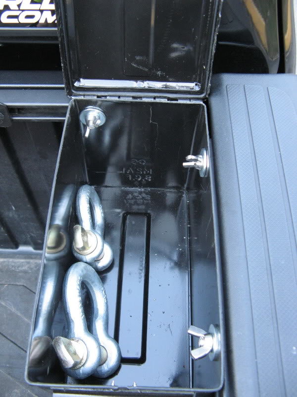

    I finally found some ammo cans spent more on the hardware to install them than the cans themselves.
    $12 each for the cans and $40 for hardware and locks.
    So I picked myself up some carriage bolts, washers and some wing-nuts for easy removal.
    put a plate in the side to keep the bolts evenly spaced and threw one in the track at the front.
    drilled some holes in the can in the appropriate places.
    bolted the cans to the rails and voila fill with crap.

    How did you set up the puddle lights with your keyless entry? also where did you get those switches I am not able to find any decent ones in my area.
    Great Build
