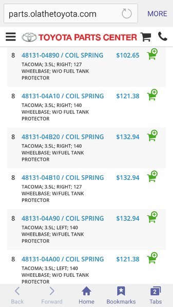

    Taco lean= drivers side lower than pass side. Due to excess weight and driver all on left
  8. Oct 12, 2016 at 3:21 PM
    #128
    brich999
    brich999 Well-Known Member
    Jun 18, 2016
    #189910
    1,404
    Bryan
    16 Tacoma TRD Sport AC
    all tore up already
    They did do left and right side coils. Not sure exactly the "weight" difference, but they were the same height. Only difference was the paint markingsdownloadfile.jpg
